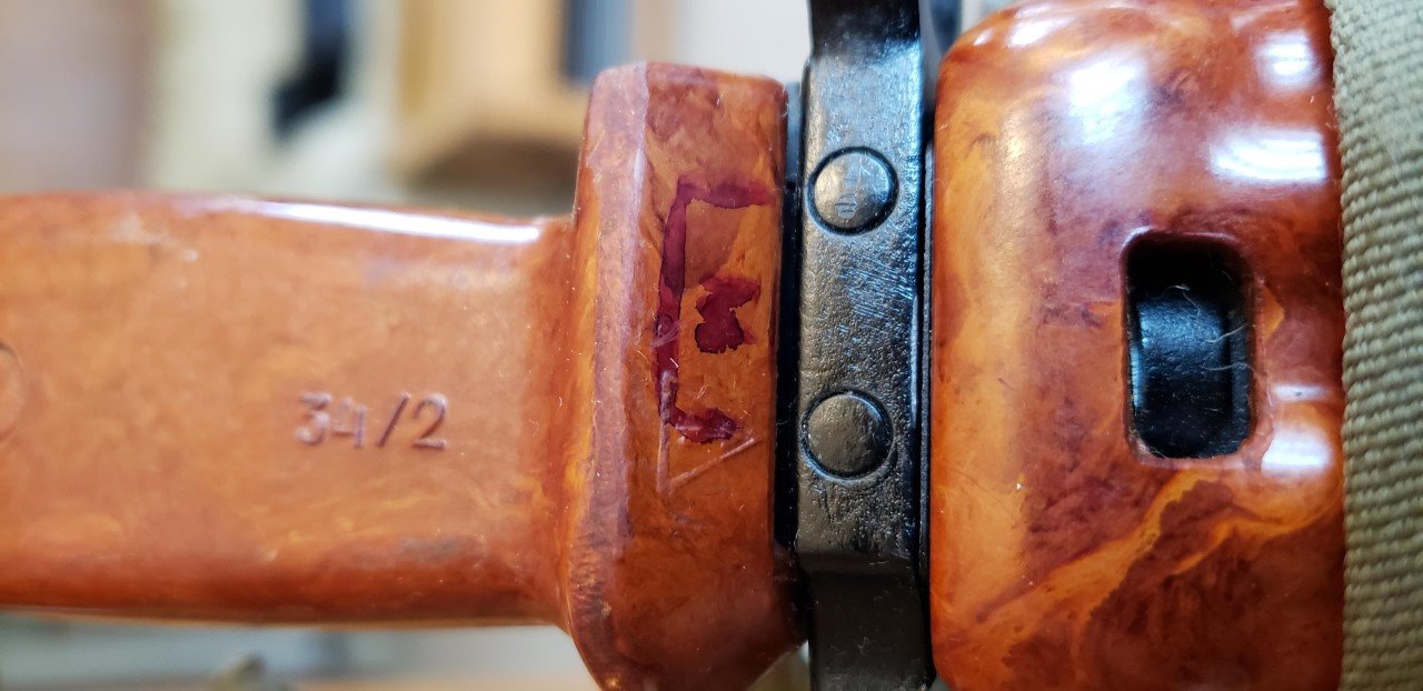

Scored a couple of bayos while on the road. This one is a nice condition Izzy Type II and the other is a good used condition ((10)) 6x5. Great price, both $90 shipped.
I'm wondering if this one has been forced matched.
Re: Izmash TypeII
A nice bayonet and in decent overall condition for the price. According to the latest references it is actually an AKM 6X4 Type I late version. It has a machined cross guard with smooth ground rivets and should have the arsenal mark on the front of the cross guard. Yes, this bayonet has been inspected, reworked and reissued with forced hand etched numbers at least twice. What may be the original number on the cross guard is lined out and painted over, (note paint on the front of the grip). The next number was hand etched on the grip and has since been ground off and replaced by yet another hand etched number forced matched to the hand etched number on the scabbard. The scabbard is a Type II. It has also been inspected, reworked and reissued at least once. The original number has been ground off and replaced by a hand etched. Below are pictures of the original numbers on an early and late AKM Type I for comparison. Definitely forced matched. Mike

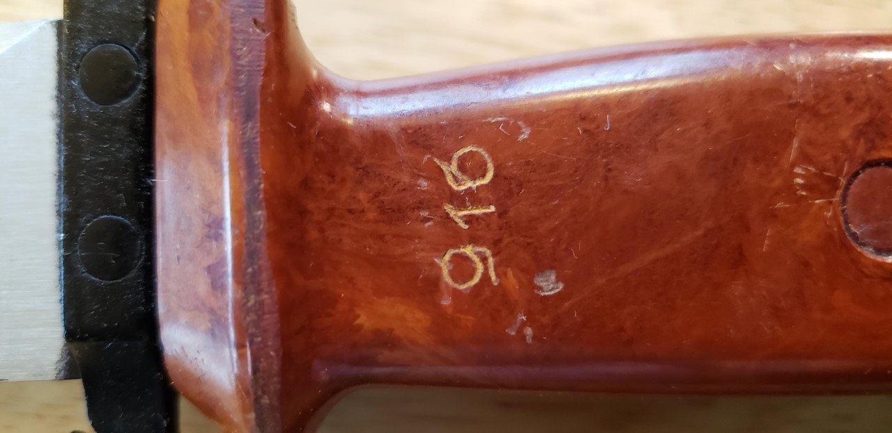

This is an AKM 6X4 Type I late version from Izhevsk. It is in new condition with original matching numbers. The arsenal mark is on the front of the cross guard by the blade. Notice the matching fonts, size and spacing of the numbers on the bayonets and scabbard. Machine etched vs free hand. Mike
Re: Izmash TypeII
This is an example of an early AKM 6X4 Type II bayonet and scabbard from Izhevsk. Notice the exposed counter sunk rivets on the cast cross guard. Also both the arsenal mark and the original numbers have been moved to the grip. On this bayonet and scabbard the original matching numbers, (454), have been lined out. New matching hand etched numbers, (6182), have been added. This indicates the bayonet was turned in, passed inspection and reissued without being repaired or reworked in any way. Mike
Re: Izmash TypeII
This is an example of a later version AKM 6X4 Type II bayonet and scabbard from Izhevsk. It has matching original numbers. Notice that at some time between the late Type I and the early Type II bayonets the numbering changed from 4 digits to just 3 digits. Mike
Re: Izmash TypeII
This is an example of a AKM 6X4 Type III lightened pommel bayonet and scabbard from Izhevsk. It also has matching original numbers. These last several posts and pictures represent the placement, style, fonts, etc., of the original arsenal numbering on the Izhevsk 6X4 bayonets and scabbards. Mike

These posts seem to have gone off topic with the Russian AKM 6X4 Type III question. However I will continue with that discussion briefly. No, I do not believe Tula made any Type III bayonets. Yes, it is possible they could have. They could have cast their own L.W. pommels or used the ones cast by Izhevsk or a sub-contractor. All the ones we have seen appear to have the same mold markings. There is also the possibility that parts could easily been mixed during repair and rework functions. Specifically pommel and grip replacement. Like most Kalashnikov designs, parts interchangeability was a requirement. Tula and Izhevsk used the same basic specifications to make the bayonets and scabbards.
Do Tula Type III bayonets exist? The question is it original, or reworked or just a result of someone like me playing around with parts today. One of the bayonets below is a Type II Tula the other one is a Type III Izhevsk. The pommels interchange! Mike

I'm looking your last pics strange mix for sure, that round hook, Izhevsk arsenal logo on the grip and Tula acceptance paint plus Tula arsenal piedestal mark? wow
Re: Izmash TypeII
Marc, The Isky Type III is the correct one in the pictures. The cross guard hook is actually angular not circular. The cross guard is cast and the rivets exposed. The extra deep beveling and paint wear make the hook look round in the picture. It looks like I grabbed the wrong Tula hilt, I have 3 or 4 different ones, Type I and II, in a drawer. They all have white Tula marks. The one pictured is a Type I with the star behind the muzzle ring. It also has the machined pommel and cross guard with flush ground rivets. Regardless the pommels do interchange as long as they have the grips with the flat ends. Mike
