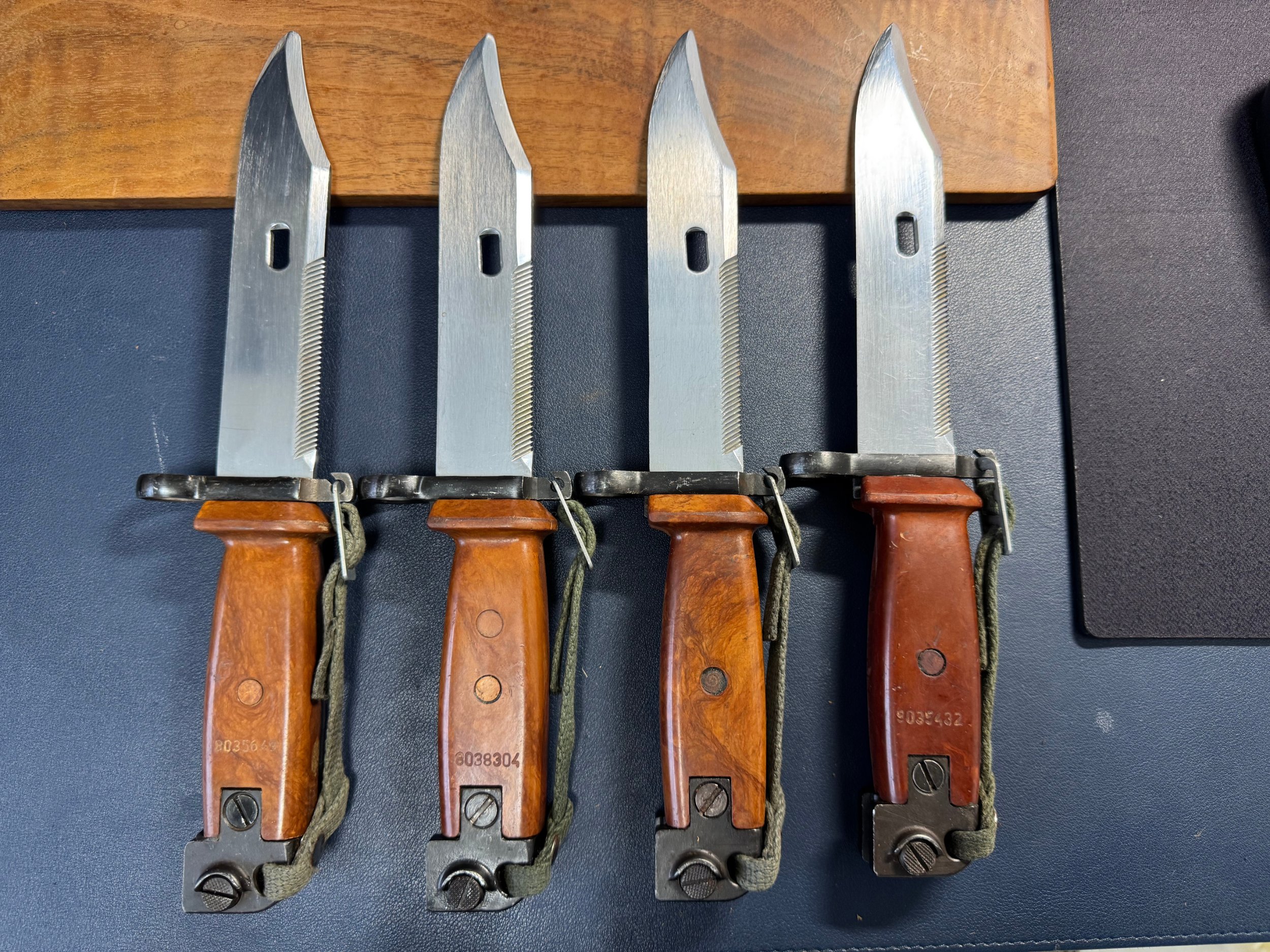

Received four Iraqi Tabuk bayonets
Post by corgi »
It's nice to have these things, and one of them is unnumbered

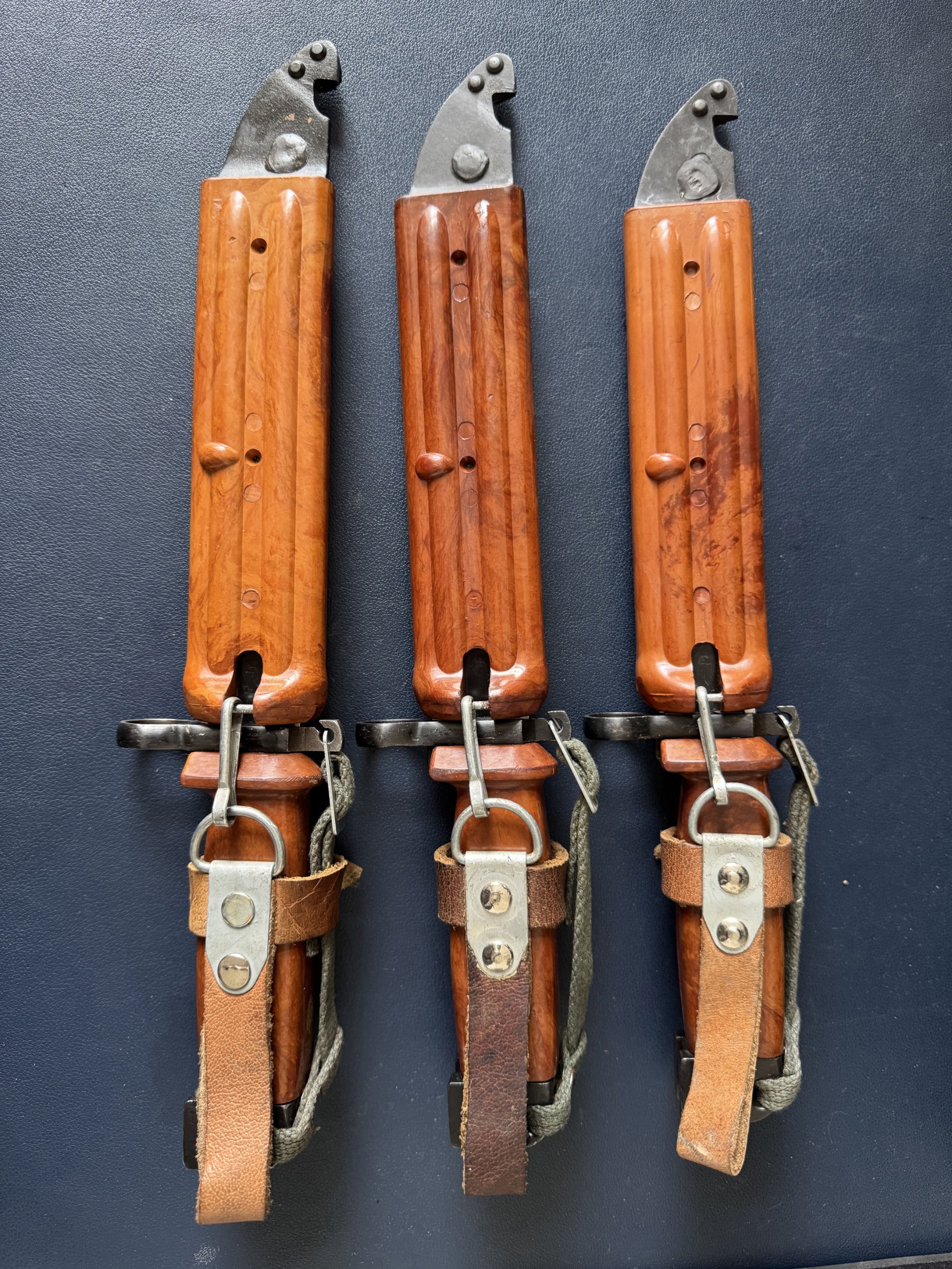

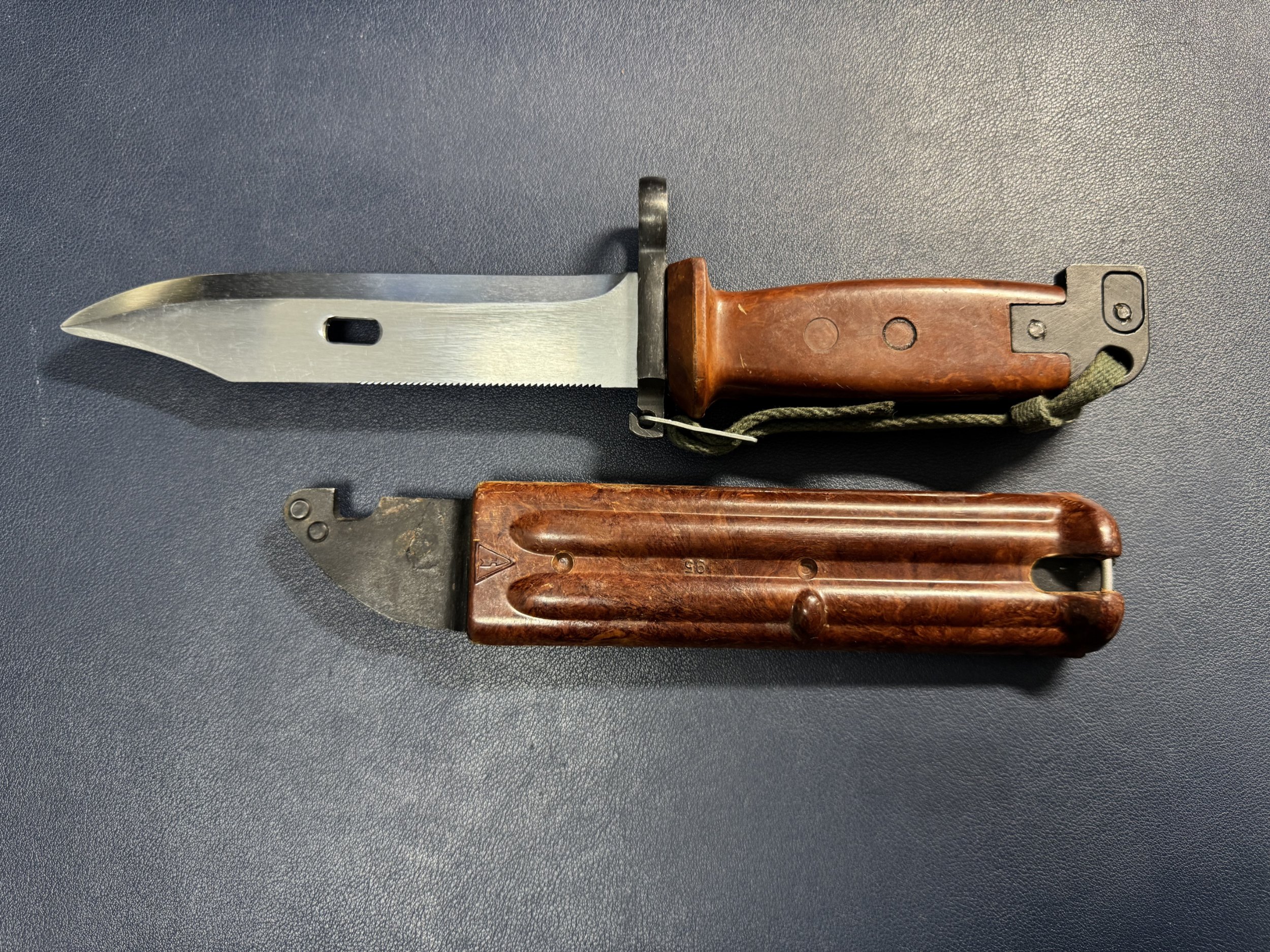

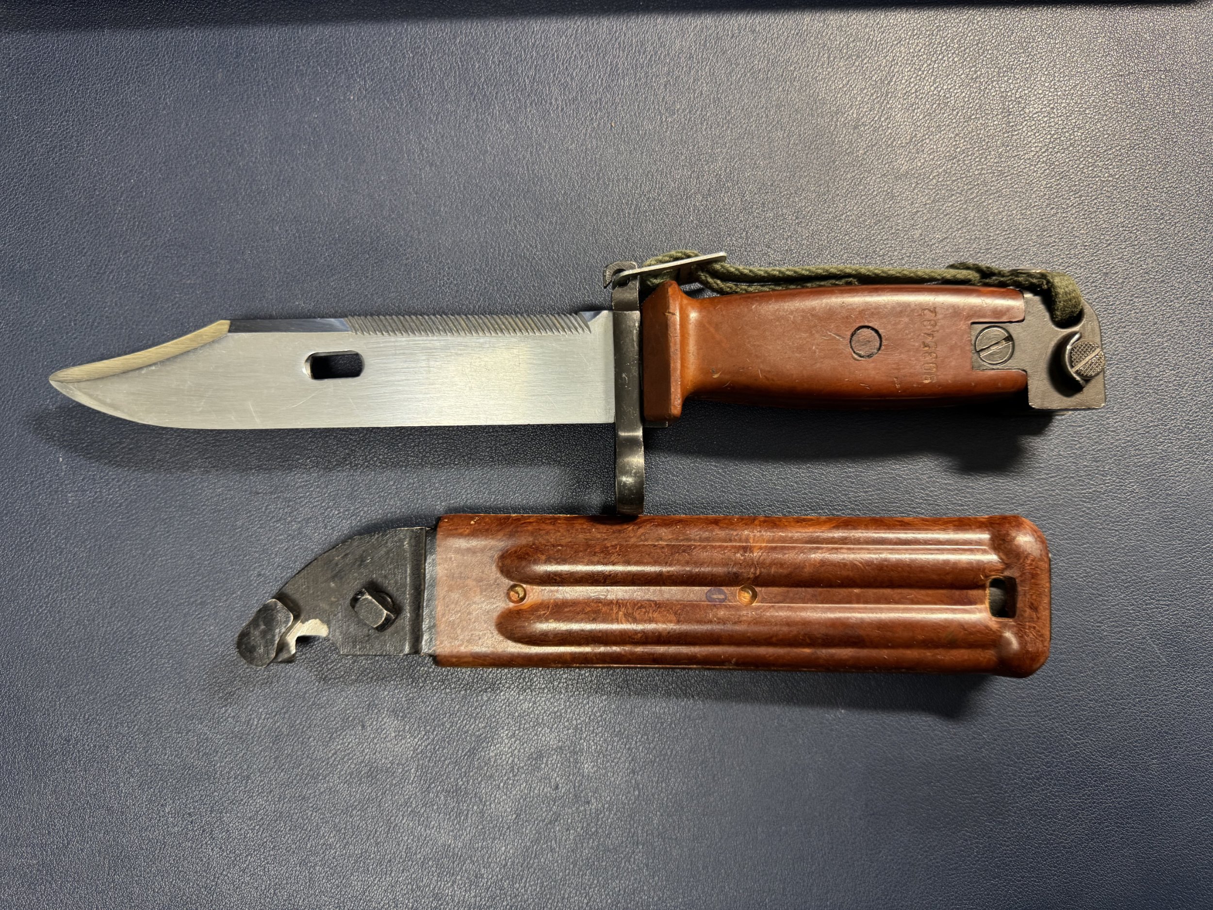

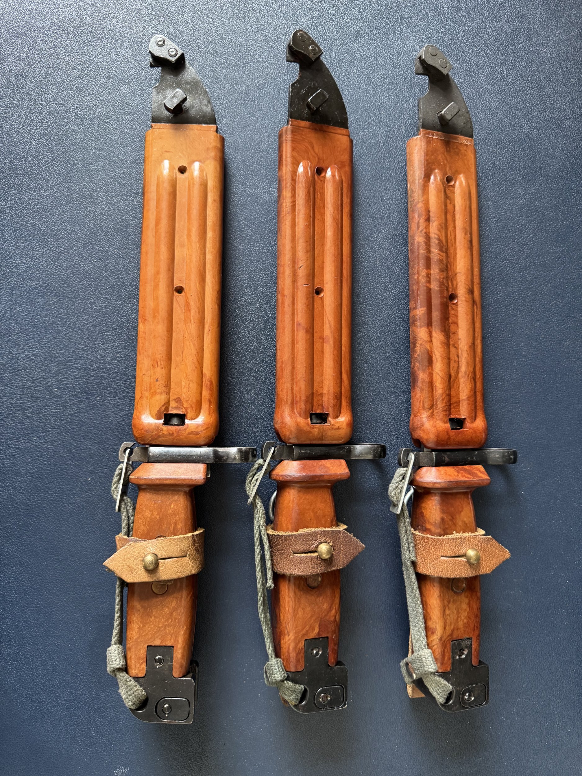

Three of the Tabuk bayonets have original sheaths and lanyards, but the sheaths are not numbered, and one red Tabuk has a Soviet sheaths

As for the accessories. Iraq acquires the technology, equipment and materials to make the Tabuk bayonets and scabbards From Yugoslavia. This also included the wrist straps and belt hangers. It appears that the Iraqis imported some. But also made their own. Most of the Yugo straps and hangers were very uniform in appearance. The later production, (Iraqi?), had minor differences in materials, dimensions, and assembly. As an example, in your pictures above. Note that the belt hanger hilt strap on one crosses in a different direction and belt loops are different lengths. There can also be different style leather and other hardware. All very minor, but fun to observe. Mike

Yes, Mr. B, one of the Tabuk has a Soviet scabbard. I thought I made a mistake at first, but after your explanation, I suddenly realized that it is a very matching color

Some iraqi bayonet can be find with matching number on soviet made 6x4 scabbard, here it's just a mix.
Re: Received four Iraqi Tabuk bayonets
Both of you are correct. It is a Russian Izhevsk scabbard. It has the correct Russian mold and inspection marks. In the pictures it appears to be un-numbered. Most Russian bayonets are paired and number matched to rifles at the arsenals. A small percent of bayonet and scabbard production is not numbered to be reserved for replacement and repair. Sometimes the un-numbered unused ones end up in our collections. It is very possible that some un-numbered one could end up in Iraq. It is also possible that Iraq would throw them in with Tabuk bayonets and scabbards to be numbers matched as original or replacements. Mike
