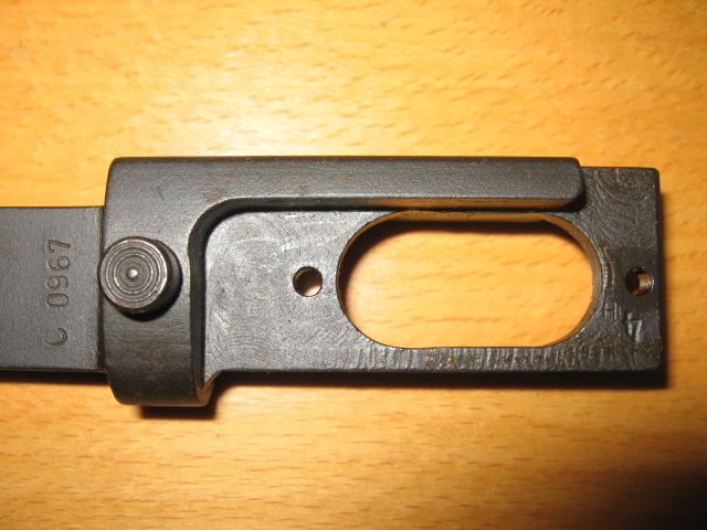

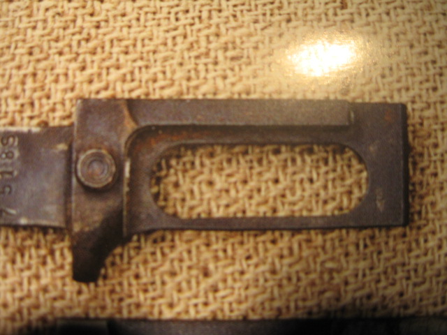

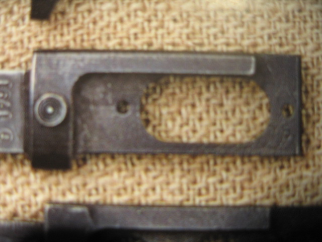

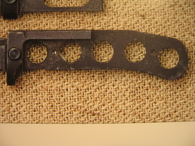

Type I had a small, rounded cross guard shape, a short blade tang. The tang had a small oval lightening hole and two small specific grip mounting holes. The original grips were shaped from a single piece of wood, usually Beech. Grip color varied from light yellow tan to darker brown. These wood grips were a weak point and subject to damage and frequent repair and replacement and soon recalled. A new set of molded wood chip and glue panels were designed to replace them using a specified rivet placement. These grip panels and rivet placement were carried over to the Type II production. Note the small original factory rivet holes. M.

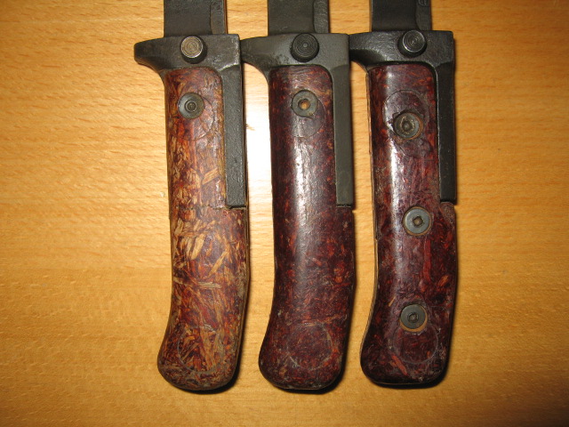

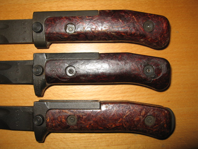

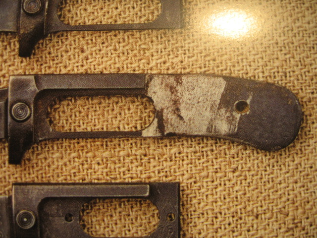

Type II production was basically the same with a few needed improvements. The cross guard was extended on the bottom to help gripping when installing the bayonet and when using as a knife. The area around the locking lug was strengthened and improvements were made to secure the molded wood chip grip panels. The short tang was retained, but the lightening hole was lenghtened and the grip panels were redesigned to fill this extended oval. No small holes were drilled for the rivets, but the rivet placement was specified and standardized. Note the picture with the Type I with replacement grips and the regular production Type II. M.
Re: Czech VZ58 Bayonet 3 basic Varietions

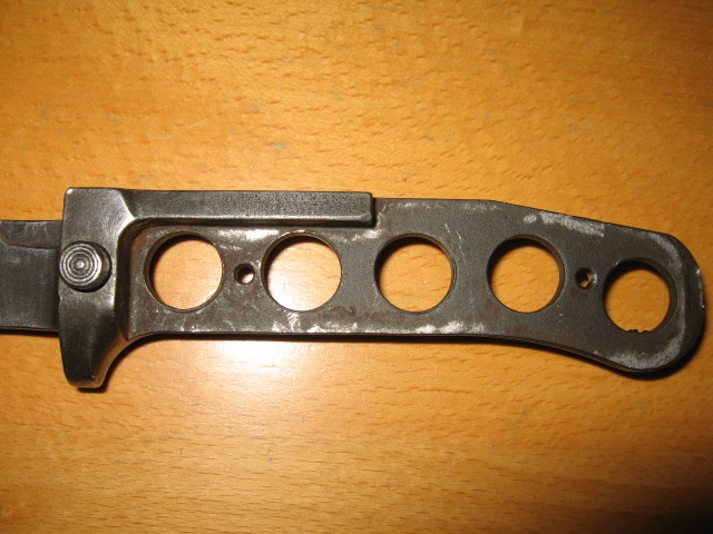

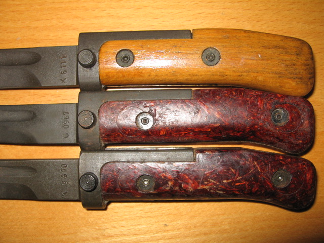

Now for the Type III. It retains all the features of the Type II but has a redesigned full length tang. It has better balance and heft as well as the tang extending past the two flat panel molded grips to protect the pommel. Note that the two rivet placement holes are drilled between the 1st & 2nd and 4th & 5th lightening holes. This placement is now standardized and the same between all three Types. Note the picture of all three Types. M.

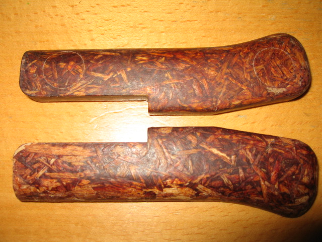

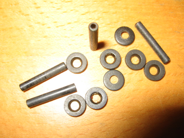

Note: The grip panels and rivets shown with the Type II and III pictures above are new unused production types and are some that came from an armorers VZ58 field/unit repair kit along with all the parts to repair the VZ58 rifle. Also note that all the grips were also glued together as well as being riveted. Also note that the original VZ58 rifles had wood furniture like the Type I bayonets. The rifles had the wood stocks and grip replaced with the new wood chip and glue parts at about the same time as the bayonets.
The correct method of repair as well as rivet placement was in the instructions along with the necessary tools and adhesive. However these instructions were not always followed out of convenience or availability. I have seen one, two and three rivets in all sorts of placement and alignment as well as different style of rivets, with and without washers as well as machine screws and nuts as retainers. I have also seen several without any retainers, just glued. Hard to tell by by whom and where these non-standard replacements/repairs were made M.

The one authorized rework of the bayonet itself was made to a few of the Type I and II bayonets. The tang was extended to the contours of full length Type III tang by welding on a preformed extension. When properly ground and refinished and with new Type lII grip panels in place these are hard to detect on the Type II conversion, but it is possible to find a Type I short cross guard on a bayonet with a full tang. Note that is has a drilled rear rivet hole to conform to the others in rivet placement. M.

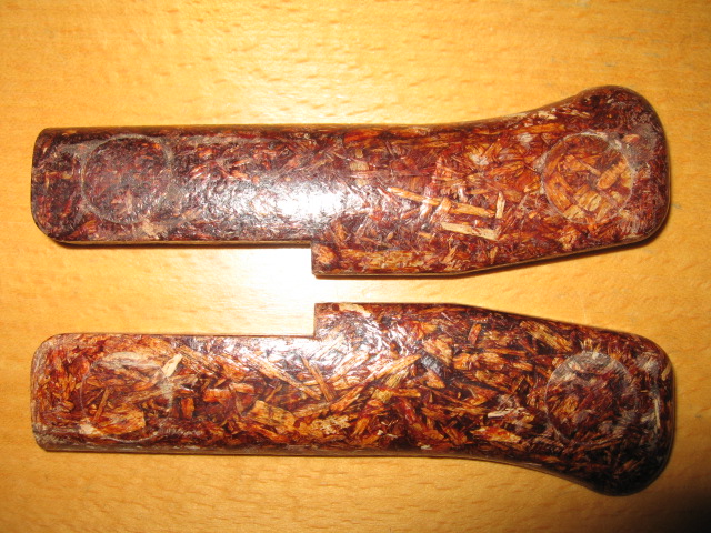

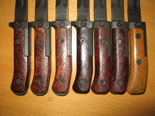

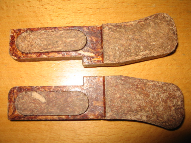

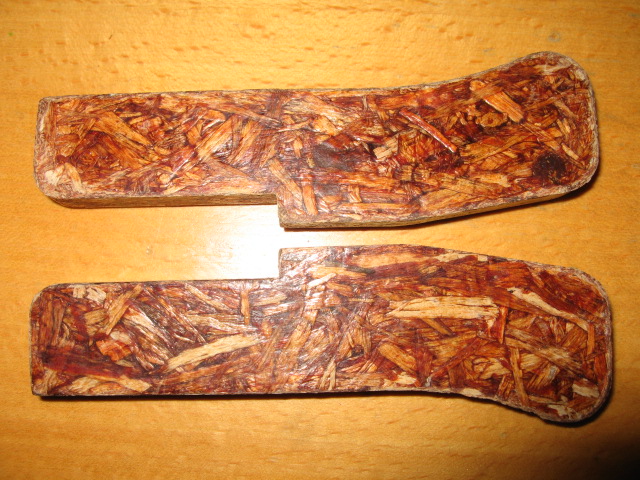

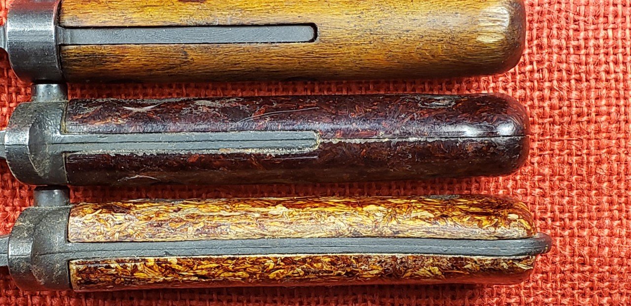

Here are some groupings to show grip material and color variations. The 1st group has the standard authorized rivet placement. the 2nd group is of a few non-standard replacement/rework grips and rivet placement. There is no end to these non- standard alterations. M.

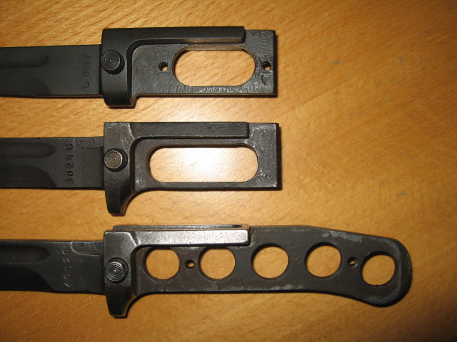

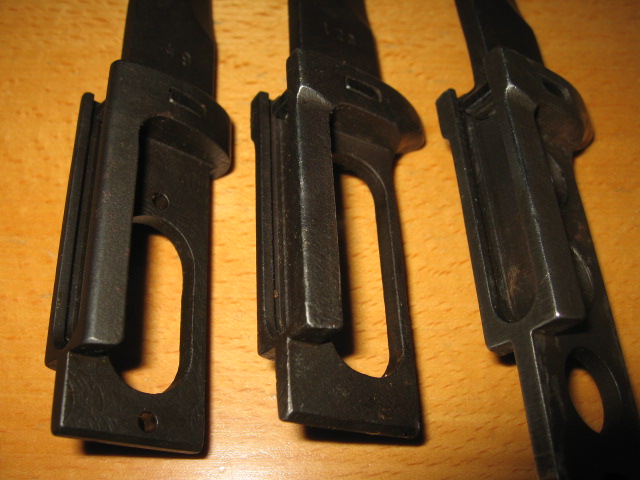

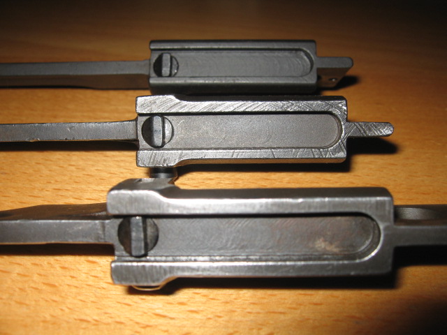

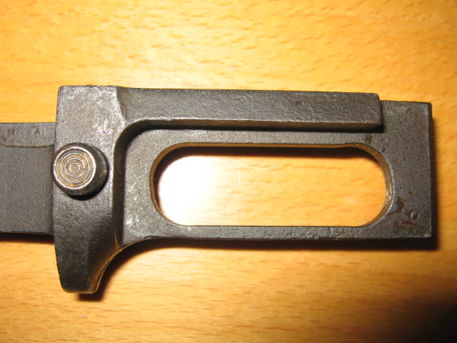

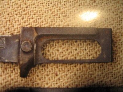

Here are some better pictures of the differences between the three different basic VZ58 bayonets. The earlier pictures I posted were barrowed. These are pictures I striped down to display in my collection. M.
First pattern Type I. Second pattern Type II. Third pattern Type III.
Re: Czech VZ58 Bayonet 3 basic Variations

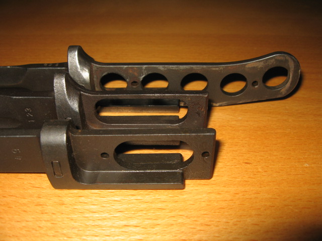

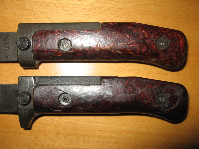

Here are some comparison pictures of the three basic VZ58 patterns. Note the differences in the blade tangs, the reinforced mounting slot next to the lock pin, and the bottom of the cross guard. M.

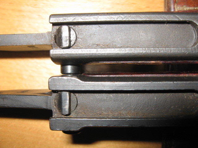

This post is a correction for the first post under this topic. I stated that all the VZ58 bayonet were CAST and machined from a single piece of metal. Recent research has proven this wrong. The original Type I design was for the one piece blade, cross guard and hilt tang to be FORGED and machined to specifications. This forging required a large amount of machining. One of the reasons for the redesigned Type II was ability to change to CASTING the metal. This saved time and expense by reducing the amount of machining. The Type I was forged, the Types II and III were cast.
The picture below shows, top, the forged and machined Type I bayonet. Note the circular machining on the bottom of the hilt tang. The middle is a cast Type II bayonet. Note the casting line where the mold halves met along the length of the hilt tang. The bottom is a cast Type III bayonet. Again note the mold line on the bottom of the hilt tang. Mike
