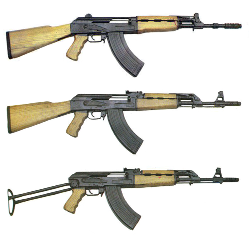

Re: Is this a bayonet for an AK?
Hello guys. Very interesting thread and bayonet variant.
I just remembered the early Yugo AK Variants... and if i look at pictures, this discussed bayonet could be for a Zastava M64 version. See the middle and last version in the attached picture. The long muzzle break and the old style attachement, but in the back of the bayonet, not in front at the ring would work here.
If the yugo origin is for sure.
Maybe also a "AK similar prototype" for the M56 SMG?
Otherwise a polish or east german prototype bayonet for the early and milled AK variants is also thinkable for me.
I am not a pro, but i wanted to share my thoughts.

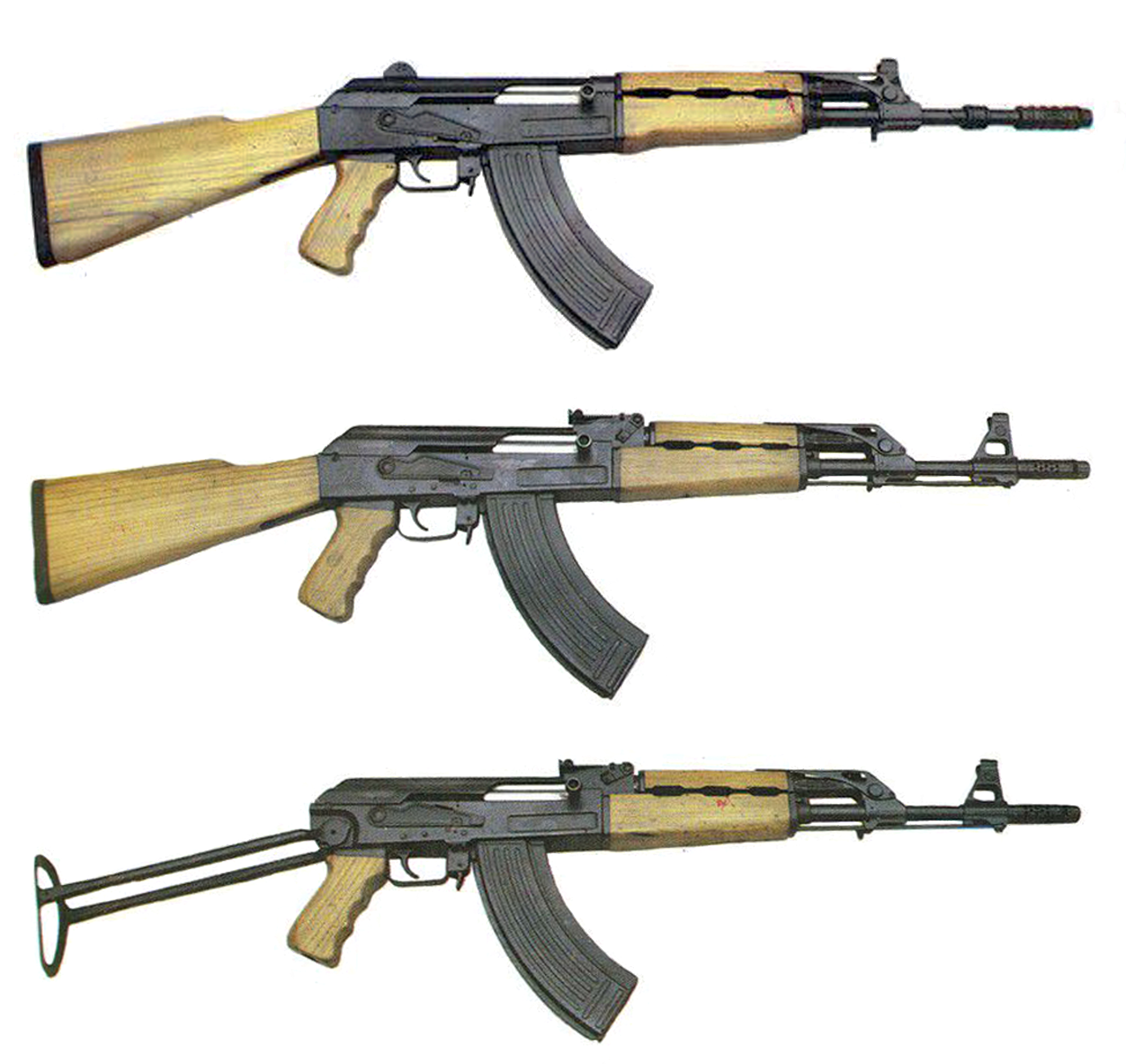

For me this is the best information so far regarding the mystery bayonet! The early M64 above looks like a possibility. I’ll have to do some more research. Not to sure about the M56 SMG. Will study some references / pictures. Mike
- Posts: 146
- Been thanked: 2 times

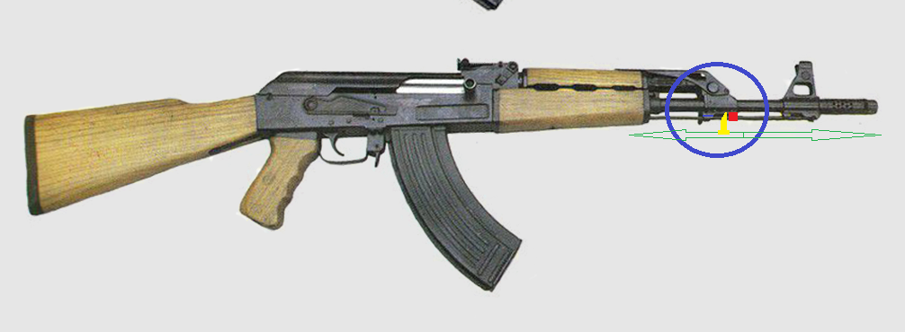

I also considered the Yugo M.64.
As far as I know, there was no bayonet intended for this, but you never know what the Yugo. had been tinkering with.
If the gas pickup bracket (circled in blue) has a rail at the bottom (blue line), there is still about 2.5cm missing from the gas pickup bracket to the mouth, the lock (red square) in the claw of the bayonet (yellow column) blocks a horizontal movement (green directional arrows).
I marked it in the picture.

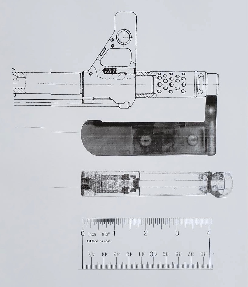

Hello Beryl,
Thanks to a suggestion from Benni it looks like we may have an answer. Yes, it appears to be an AK bayonet.
To be specific, possibly a test or prototype bayonet for an early Yugoslav Model M64 rifle.
This picture is not quite to scale, but does show the relative attachment points. Everything seems to line up. The muzzle ring fits the muzzle attachment. The teeth at the front of the front sight base would align with the teeth in the bayonet handle. The slots in the ears on the pommel would slide onto the ridges on the rear of the front sight base.
The early M64 rifles had a cast receiver and were the equivalent to the Russian AK47. It appears the Yugos borrowed the early style AK47 bayonet as well. Maybe even used a Polish AK47 bayonet and scabbard as a sample. That would explain the Polish style scabbard body?
Sorry for the terrible picture! Back to literal cut and paste. No photo shop, just iPad and cheap printer.
Cheers, Mike
If the front sight carrier in the picture below has a rail at the back, the bayonet can be securely and permanently attached to it. Only the muzzle compensator is a bit very short, it may be that it does not belong to the M.64 variant shown and a different compensator was screwed on just for photo purposes.
I have seen many Yugoslavian M.64 variants in pictures but I have not seen the variant with the special front sight carrier. I think that the origin of the AK 47 bayonet and the corresponding rifle are 99% clear.
Why Yugoslavia made such a complicated bayonet is just speculation.
I can only imagine that this circumvented patent rights.
The scabbard is also a mix of Polish with Russian ring bands.

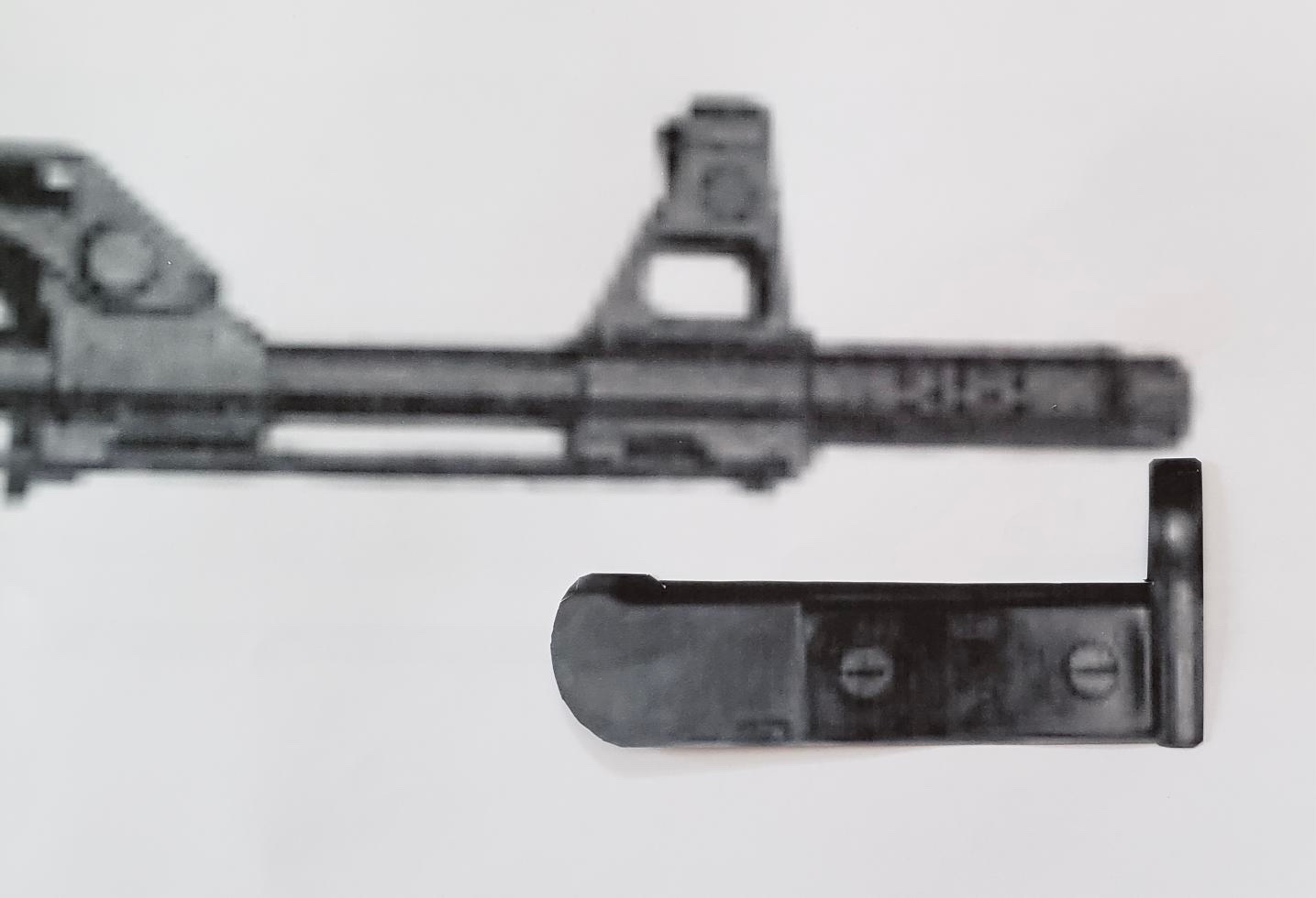

Hi Marc,
Yes, These drawings help confirm what we could visualize from the enlarged pictures. From the one on the left we can “see” the standard muzzle attachment and a full section. On the right we can “see” that the bayonet would not mount over the granade launching spigot. However, the one on the right with the cut away section, we can “see” the exterior of the front sight base with the bayonet attaching points.
From an engineering stand point these confirm for me that this is a match for Rafal’s bayonet. Three dimensional pictures of the front sight base would be nice. It would also be nice to have pictures of the bayonet on a rifle.
Thanks to Benni and Marc for your contributions in helping solving this “mystery”.
Congratulations to Rafal for his RARE find and persistence in finding a documented identification.
Here is a better picture that shows the relationship of the bayonet to the rifle. The line drawing is to Scale 1:1. The two pictures from Rafal, side annd top view, are scaled as close as I could get them. One of his pictures had a tape measure along the hilt. This indicated that the hilt measured 4” from the back of the muzzle ring to the end of the pommel.
It sure looks like a good match to me. Any questions or concerns? Mike
