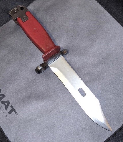

Here are the only pictures of the bayonets in question, unfortunately no shots of the release button side.

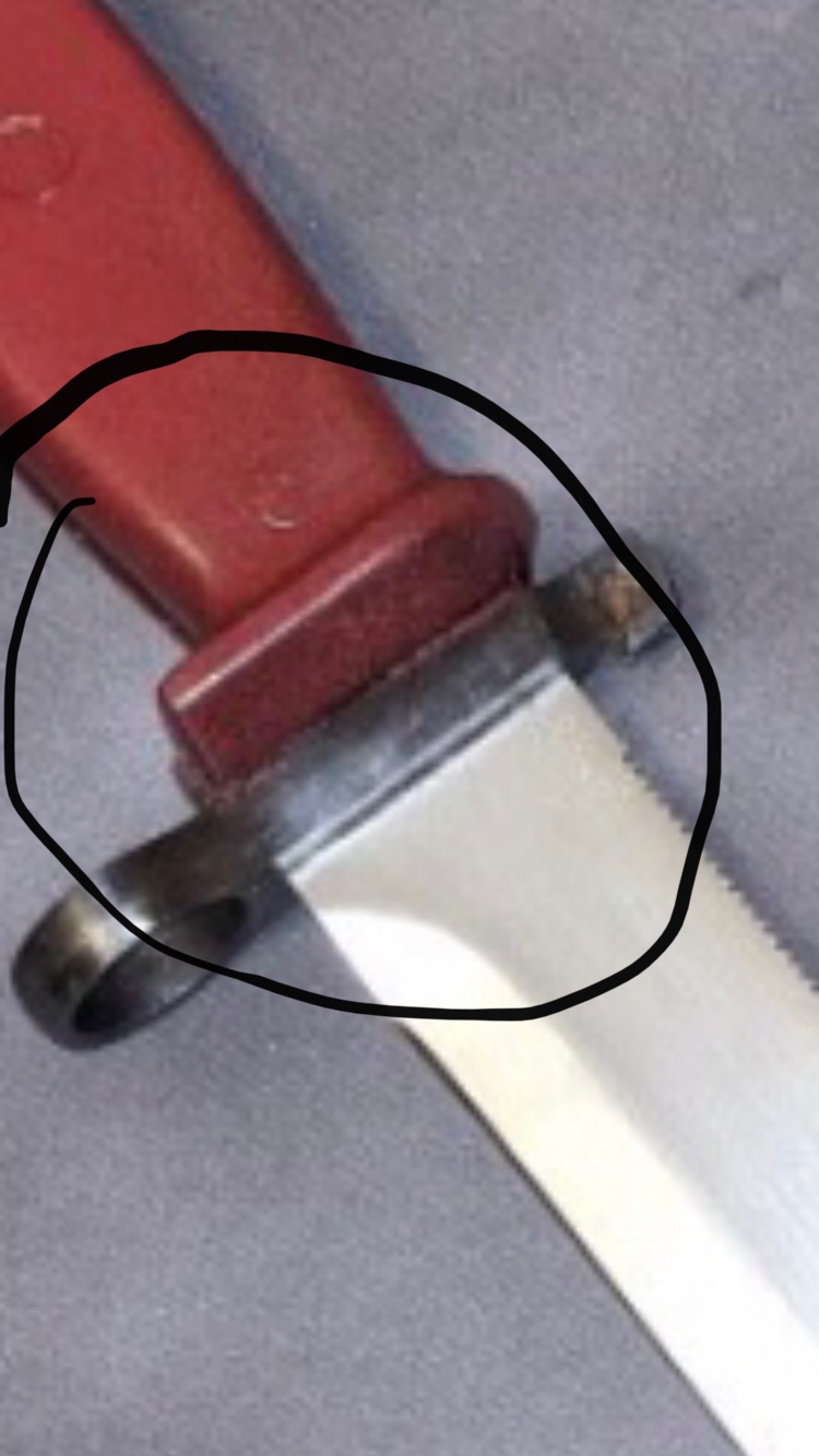

Upon closer inspection of the photographs, I believe these have been painted. I see what appears to be section that didn’t quite cover the black, and what appears to be a small amount of overspray onto the cross guard. I’ve also looked thru my collection and cannot find a single example where the handles retaining pin perfectly matches the handle as these do.
Here is his description:
“ GENUINE ZASTAVA OF SERBIA FIXED BAYONET SAWBLADE TOP STAINLESS IMPORTED EXCEPTIONAL. WILL FIT ANY M70 AK-47 CLASSIC & MODERN LINE. ** SERBIAN RED LIMITED ISSUE **”

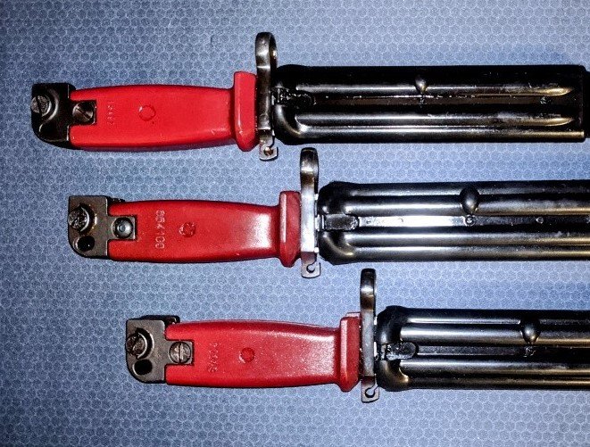

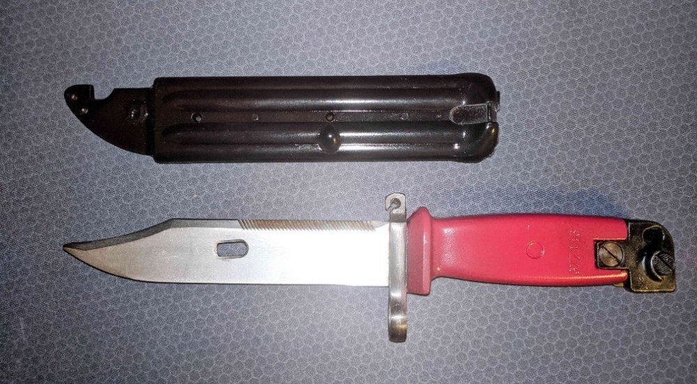

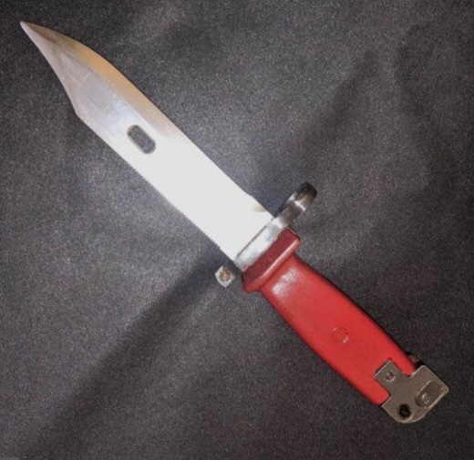

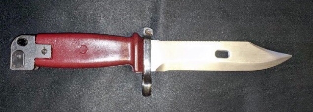

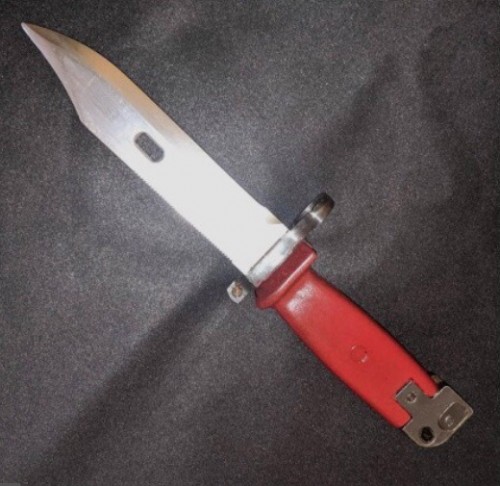

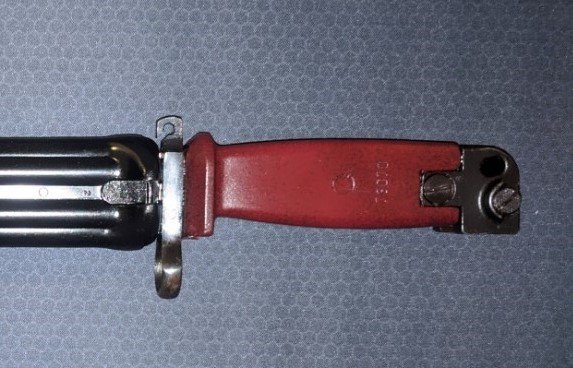

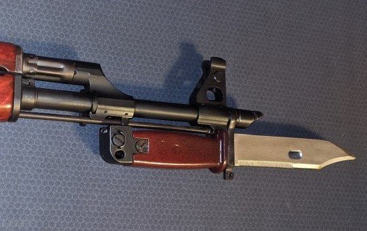

Still not much information available about these Serbian or Yugoslavian AKM 6X4 Type II bayonets and scabbards with "red" grips / handles. I found some pictures of the other, (right), side of the bayonets. Anybody have any knowledge, information or opinions about these bayonets? Any one own one?

furtium
Location: North Idaho
Re: Red/orange Serbian 6X4s?
Post by furtium »
Look at the torx bit type screw that is attaching the handle on the middle bayonet in the three bayonets picture. That's weird and leads me to believe that the pommel was removed to RIT dye the handle. I am skeptical that these are "real".
Hexagonal socket button head screw to hold the pommel, so it's seems, like Furtium said, that the pommel was taking off the handle but why?
To remplace the handle, or to remove it and to paint it in red?
Seller told me after an enquiry that it appears to be a coating. Hence I think these are outright fakes, and likely removed to Cerakote or something. I'll be passing on them. Don't think this is official anything.
