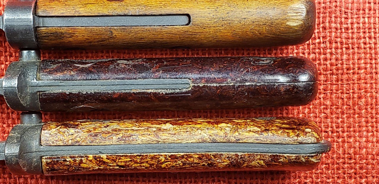

Posted: Mon Nov 02, 2020 2:44 am
This post is a correction for the first post under this topic. I stated that all the VZ58 bayonet were CAST and machined from a single piece of metal. Recent research has proven this wrong. The original Type I design was for the one piece blade, cross guard and hilt tang to be FORGED and machined to specifications. This forging required a large amount of machining. One of the reasons for the redesigned Type II was ability to change to CASTING the metal. This saved time and expense by reducing the amount of machining. The Type I was forged, the Types II and III were cast.
The picture below shows, top, the forged and machined Type I bayonet. Note the circular machining on the bottom of the hilt tang. The middle is a cast Type II bayonet. Note the casting line where the mold halves met along the length of the hilt tang. The bottom is a cast Type III bayonet. Again note the mold line on the bottom of the hilt tang. Mike
