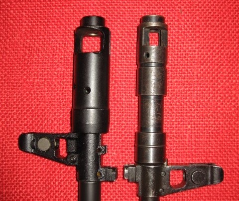

The final step in the AKM series is the AKM series is the AK74 which introduced the smaller 5.45x39 cartridge in place of the 7.62x39. It also incorporated an extended muzzle device requiring different points for bayonet attachment. The pommel mount stud was moved forward and included in the FSB the muzzle device has a false barrel extension to engage the bayonet muzzle ring. Pictures are of Bulgarian and Polish muzzle devices and a Polish 6H4 bayonet.
When first introduced the AK74 rifles were intended to continue using the 6X3 and 6X4 bayonets already in use. It also should be observed that slightly redesigned FGB still has a secondary bayonet stud so that these bayonets can still be attached when the muzzle extension is removed
NOTE: A small groove is machined into the bottom of these muzzle extensions to engage the anti-twist lug on the bayonet cross guard.

"It also should be observed that slightly redesigned FGB still has a secondary bayonet stud so that these bayonets can still be attached when the muzzle extension is removed "
This may be true on a Polish Tantal, even if it is the barrel diameter is too small and the bayonet will flop around, and that was not the intention. For a Bulgarian Ak74 or Russian AK74 this is not true because the section of the FSB where the brake attaches is 24 mm in diameter and the ring will not fit at all. The actual reason the lug was left on the GB was to mount under-barrel grenade launchers such as the Pallad (Polish) or BG15/GP25/GP30 Bulgarian/Russian.
Other than this one line, an outstanding write up and optical illustration.

Thanks Martin. I stand corrected. I have not done much research on the actual variations of the AK rifles and I have limited availability to the many variations. There are many different muzzle attachments from simple muzzle nuts/thread protectors to slant cut extensions, flash hiders and compensators, even Blank Fire Adapters. Those that use the common 14x1mm reverse threats usual allow the mounting of the AKM bayonets. But as you point out there are exceptions and the FGB stud would rarely be used to mount a bayonet, but it is possible, as it is the same dimensions as the one on the FSB and previous AKM variants. The muzzle ring fitting would be the restricting factor. Mike
