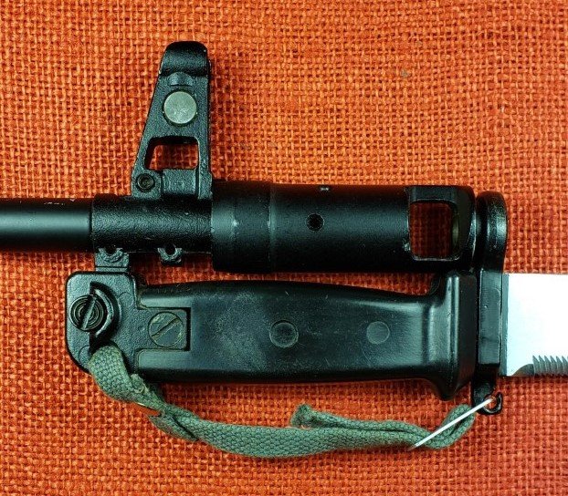

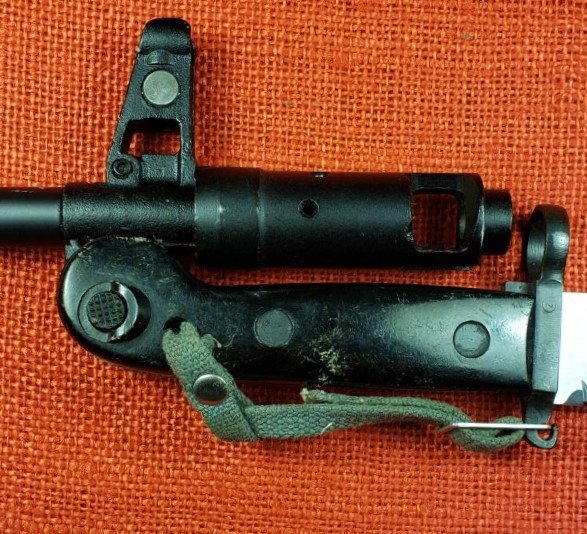

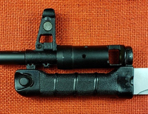

Hi Carlos, you got me thinking with your comments above. I decided to do some testing of my own. I do have one of these modified East German, DDR, AKM 6X3 Type I bayonets. Mine has the small points like the one pictured above. Pictures and story are posted on this Forum under "Germany" and a different heading. Mine was cheap and in a box of other used DDR bayonets.

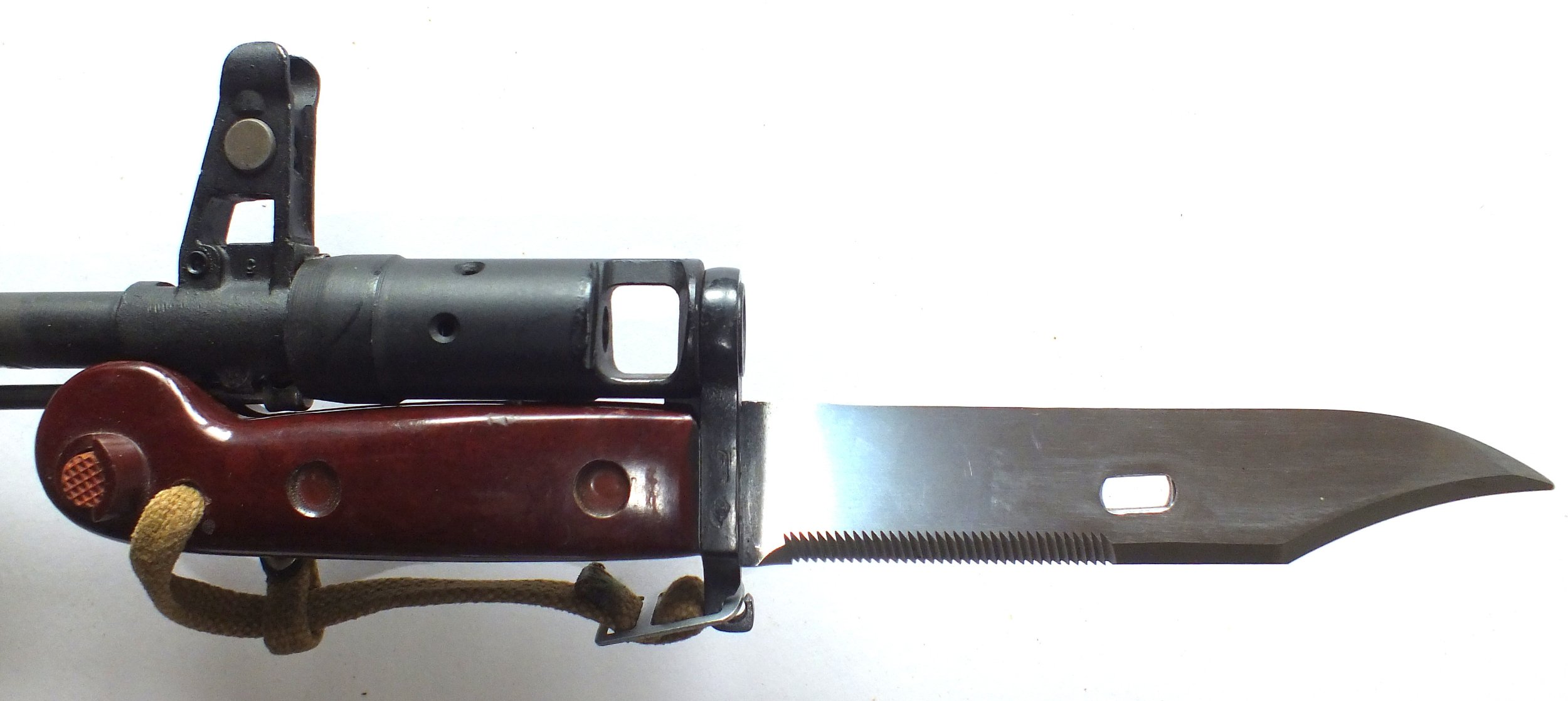

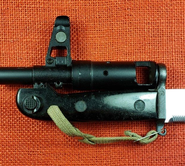

I do not have a Russian or DDR AK74 rifle, but I do have a complete Bulgarian AK74 front barrel end I use to display how a 6X5 bayonet mounts. I grabbed my modified DDR 6X3 bayonet, a standard DDR 6X3, a standard DDR 6X4 and a standard Bulgy 6X5. I tried them on. They all mounted normally except for the standard DDR 6X3. The top of the standard 6X3 pommel interfered with the pin lugs on the bottom of the front sight base. The modified one did mount with no problem! Pictured below, top to bottom: 6X5, 6X4, Modified 6X3, Std 6X3 FAIL, (would not mount).
This answers the questions about these modified 6X3 pommels for me. I also question the need for the Hungarian version, but they did produce and sell a lot of commercial 6X3 bayonets to different countries that may have converted to AK74s. A simple and cheap modification to be able to use up surplus 6X3 bayonets. In the past other collectors have said that the ones they had did not mount on standard AK74 rifles. I believe a legitimate one would fit and that is the purpose of this modification. Nothing else makes sense. Still easy to make fakes / replicas, but they should at least mount on a standard AK74. Mike

Carlos, I referred back to the two East German, DDR AKM 6X3 Type I bayonets with modified pommels that you originally posted. From the pictures, I believe they appear to be able to mount on an AK74 with no problem. The flat top ones would be easier / simpler to make. I do not know why some, like mine, have the small points. I guess as long as they fit on an AK74, they could be legitimate. I would definitely want to make sure they would before spending much for one. Mike

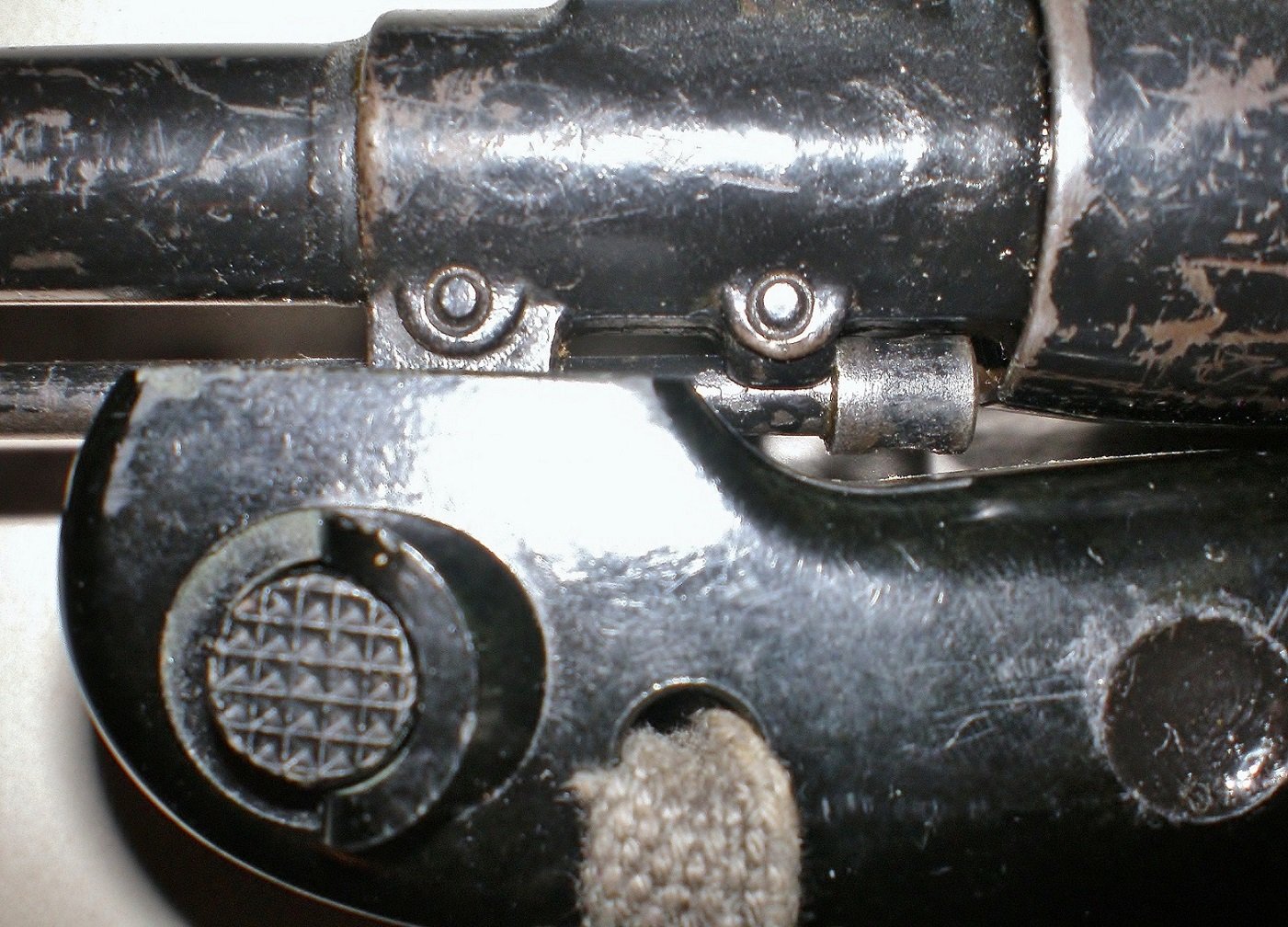

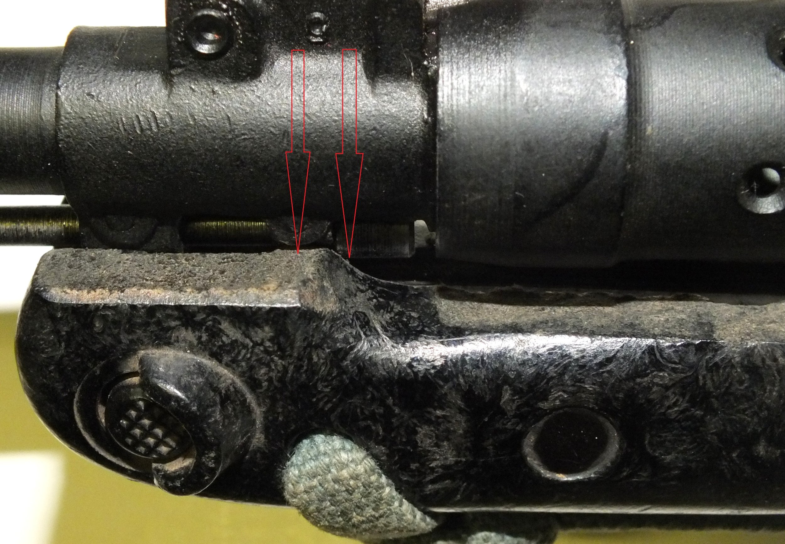

I have my concerns about this DDR M.59. Modification.
This type of modification is known for the Hungarian M.63 bayonet and intended for the Hungarian AMP-69, although I haven't found any real evidence of it yet.
As far as I know, Hungary has not imported any bayonets from GDR productions, I only know of Russian 6X4 bayonets in the Hungarian army.
Mike has already done a lot of preliminary work and documented in pictures which variants fit the AK 74 without any problems.

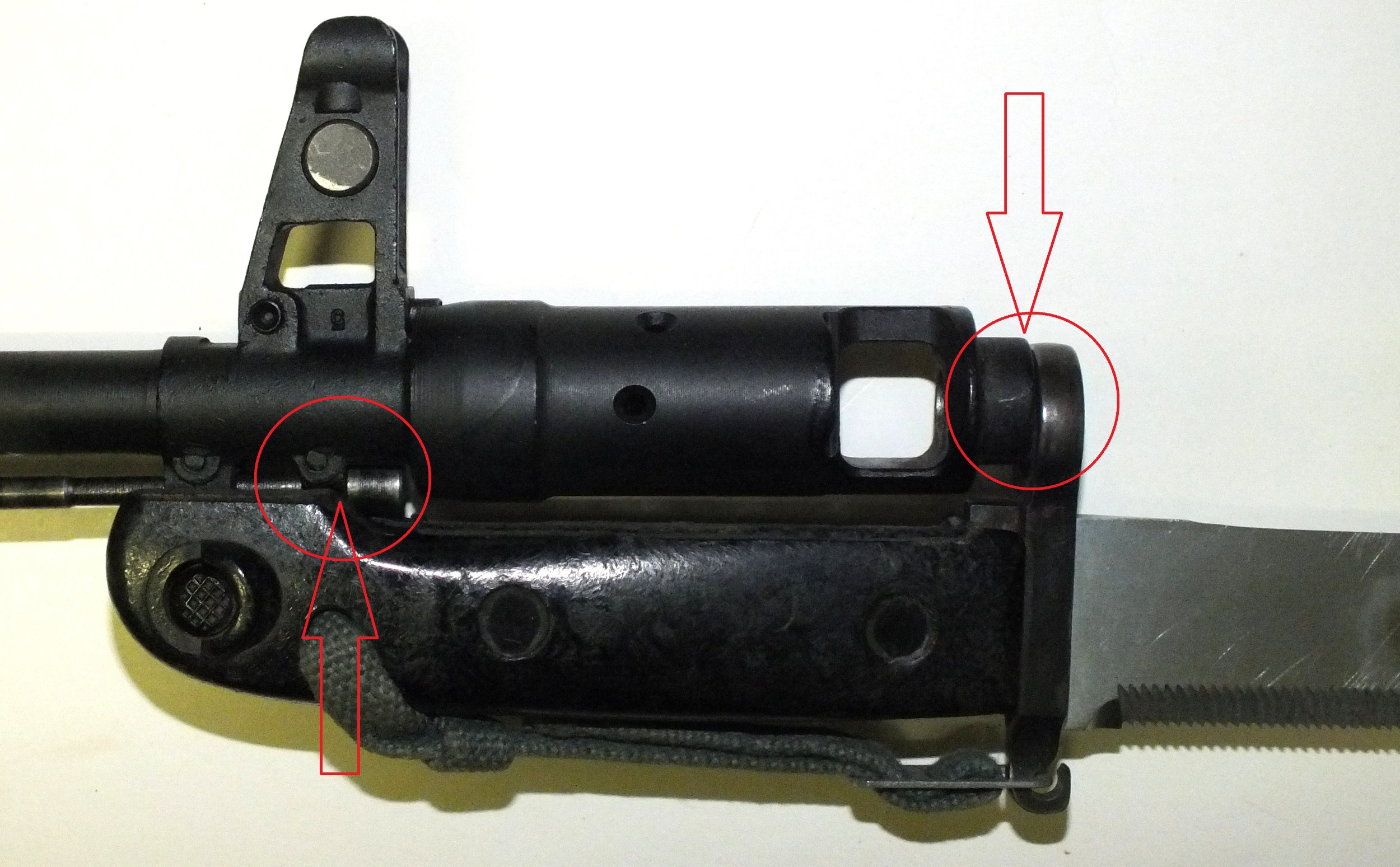

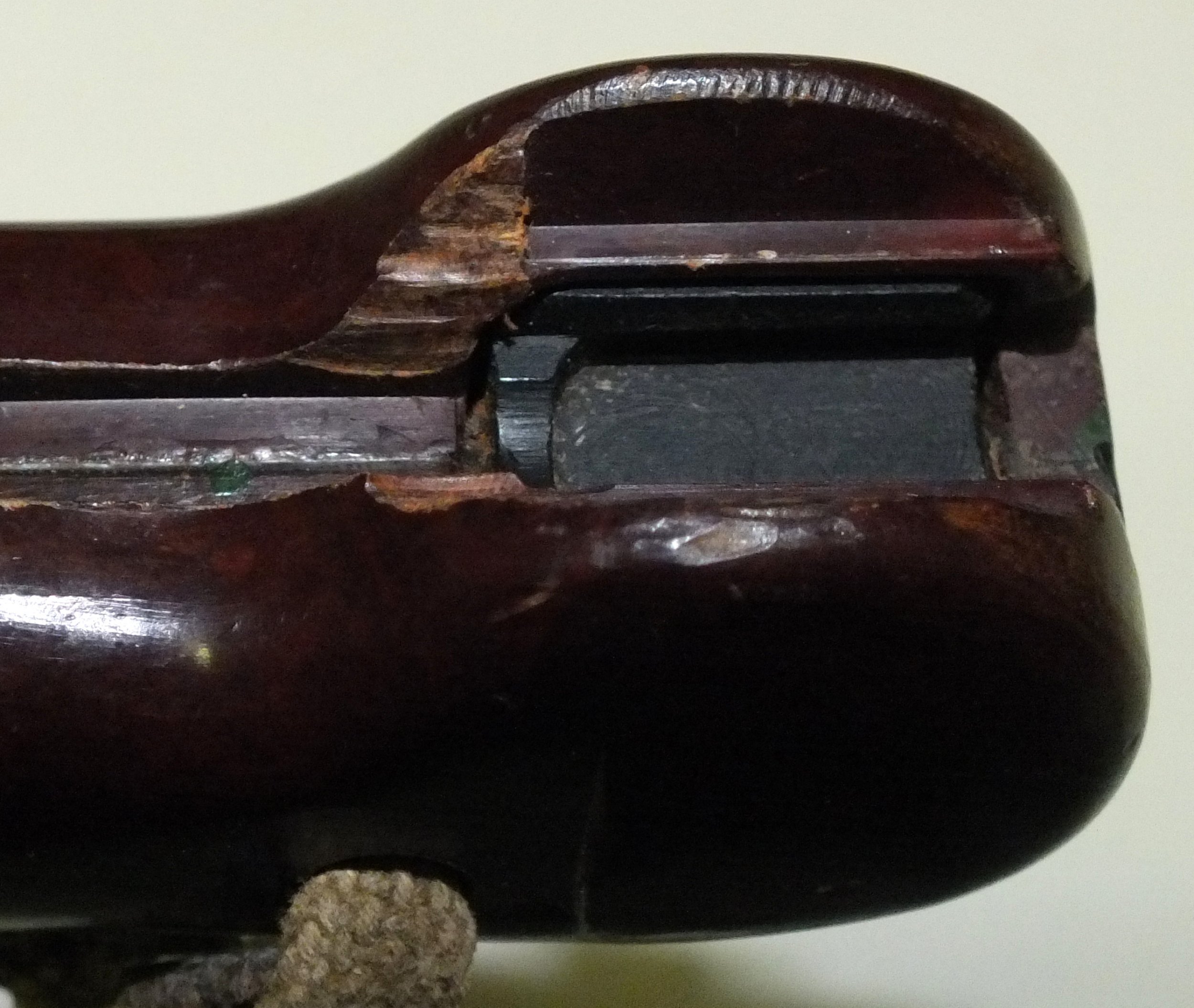

The DDR M.59 modified according to the Hungarian pattern does not fit an AKM 74 without problems, the groove is much too narrow, the front eyelet of the front sight carrier and the head of the cleaning rod block the placement of the bayonet. All other modified variants of the DDR M.59 also have the same problem.

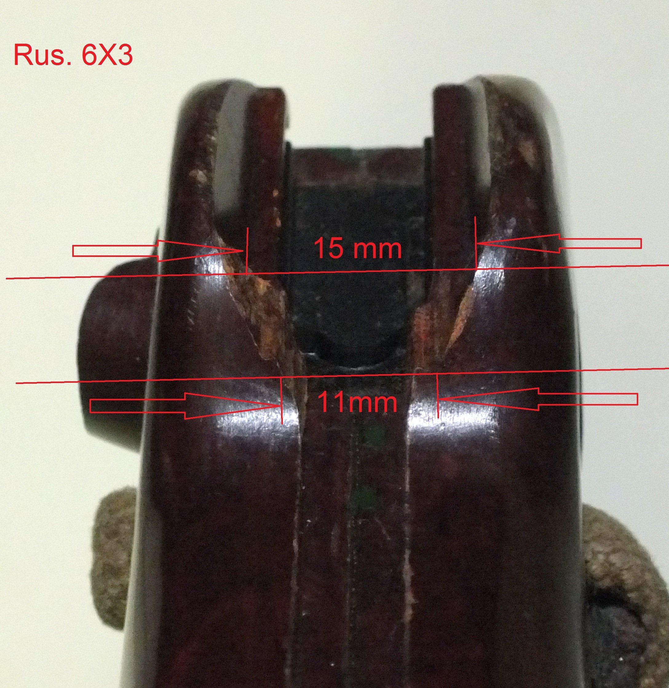

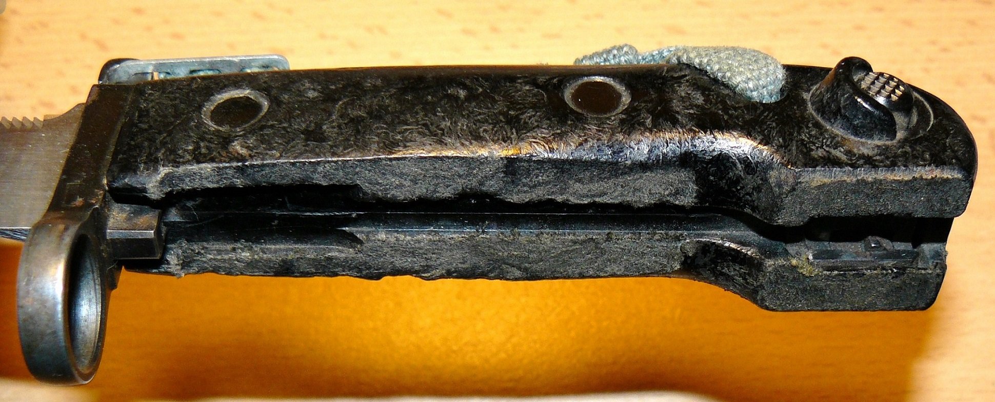

To attach a 6X3 bayonet to an AKM 74 without problems, the large and narrow groove below the handle must be widened. The groove on the head to 15mm and the longitudinal groove below the head to 11mm then it fits.
I have a russ.6X3 bayonet to show that was adapted for an AKM 74. Unfortunately I forgot where I got it from, I noticed the adaptation very late.
Pictures 3.) 4.) 5.)

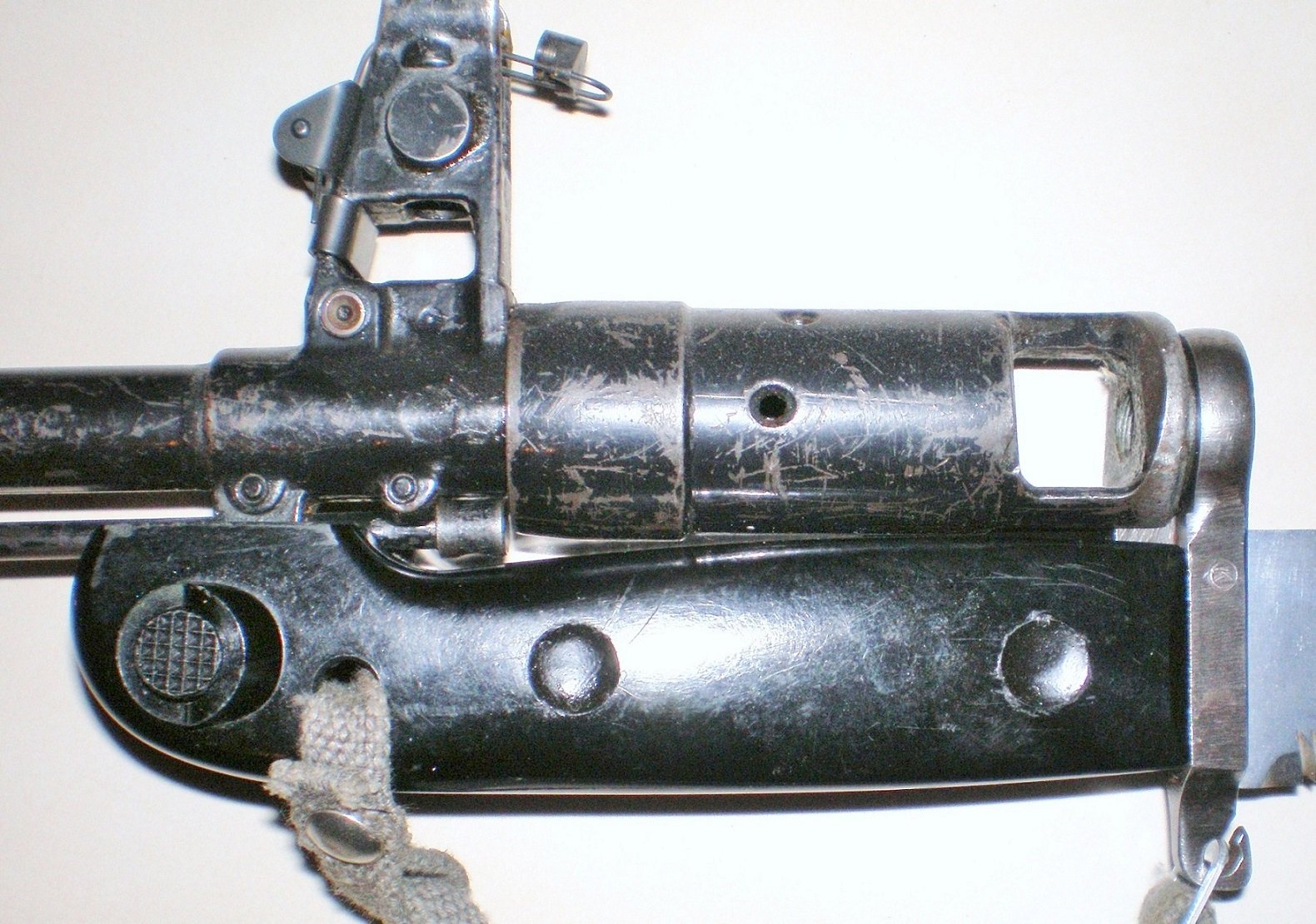

Pictures: 6.) 7.) Modified DDR M.59 to DDR AKM-74

Postby mill_speer » Mon Feb 21, 2022 12:14 am
A few more pictures of GDR Modified M.59 that don't fit perfectly
