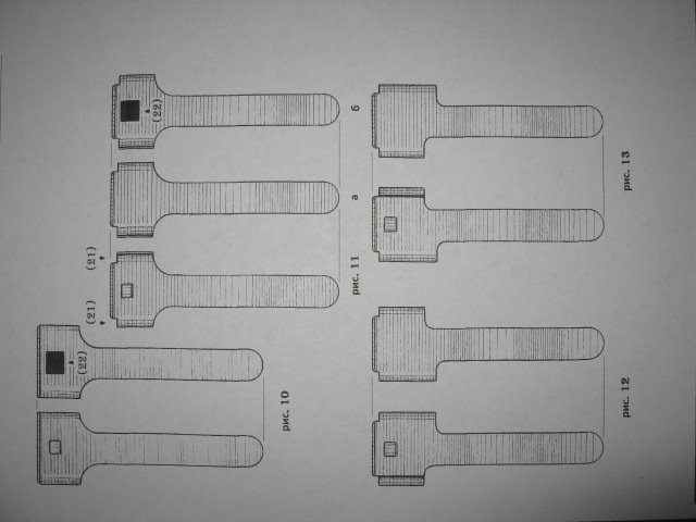

This is the next step in the variations of the Russian AKM 6X3 Type I scabbards. This is a result of some new information that has become available. For me personally, perhaps a step too far. It seems there are differences in the interior tension springs. The line drawing below show the different variations in the Russian reference book. Illustration# 10 shows the 1st (earliest) design. These have a full width folded lip at the top and a square opening on the back side. When seen from the front the fold is on the left and the gap is on the right. There are also differences in the metal finish, blued, phosphate, and paint.
I am not sure if I really care or not, but being curious I dissembled all my Russian 6X3 scabbards. Found a good mix of all the variations for the pictures below. Not sure what I will do with them. Maybe try to assemble them in scabbards from early to late? Below are a couple of the 1st (early) ones that I found. Mike
Re: Russian AKM 6X3 Type I bayonets and scabbards
Posted: Sun Jan 12, 2020 10:55 pm
The next step in the drawings is illustration# 11. These are the same as first ones except the folded lip at the top has been shortened, (cut away), on both ends. They can be found with and without the square openings on that back like the early version. This could be a separate transition or a result of reworking the first version by shortening the top lip by cutting or grinding. Again these have the fold on the left and the gap on the right. They can also be found with different finishes.
The last version, (latest), is found in Illustrations# 12 & 13. I have grouped these together as they are virtually the same only a mirrored version. There is a good possibility this was done to make efficient used of the sheet metal they were stamped from, Like using a cookie cutter. They install and function the same in the scabbard. They both have the shortened lip on the top. The # 12 has a long main fold on the right side and a short small fold on the left leaving the gap toward the front. The folds and gap on the # 13 are reversed.
Pictured below are the # 11 and # 12 versions. The last picture is of the three main variations for comparisons. Mike
