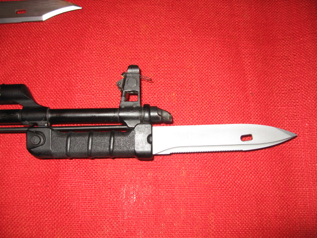

When the final design was approved and production was started on the original Russian AK47 rifles there was no means of mounting a bayonet. Several different bayonet designs had been considered and several prototype and experimental bayonets can be found in reference books. Most of these were similar to and borrowed from existing Tokarev and Simonov bayonets and were conventional designs with the catch on the pommel engaging a flanged stud under the barrel. These designs were not approved and it was decided that with the firepower, ease of rapid reloading and the overall compactness of the rifle that a bayonet was not needed.

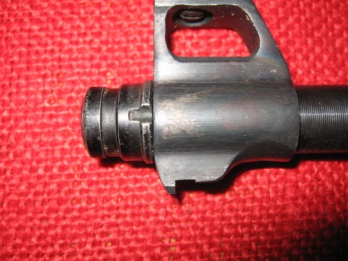

At some point this decision was reversed and a bayonet was retro designed to fit the rifle with minimal change to the rifle. This was done by designing the rear of the pommel to fit around the Front Gas Block. The cross guard incorporated a vertical sliding latch and a full muzzle ring. The only change to the rifle was to add to small hooks, ("Fangs") to the bottom of the Front Sight Base. Early production AK47 Rifles and various others where the fangs were omitted or removed to comply with import/export restrictions will not mount bayonets.

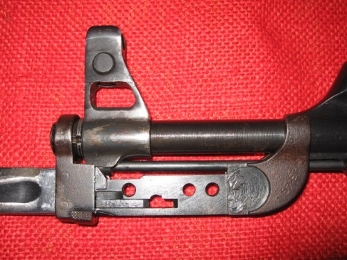

Maybe these pictures will help illustrate the means of attaching an AK47 bayonet to a rifle. The first picture shows the required "fangs" on the bottom of the FSB. The rifle pictured is a Chinese Type 56, (AK47) and the bayonet is a N. Korean AK47. I was using them to illustrate another post I am working on and they also represent the degree of interchangeability of all the ComBloc AK47 rifles and bayonets. Mike

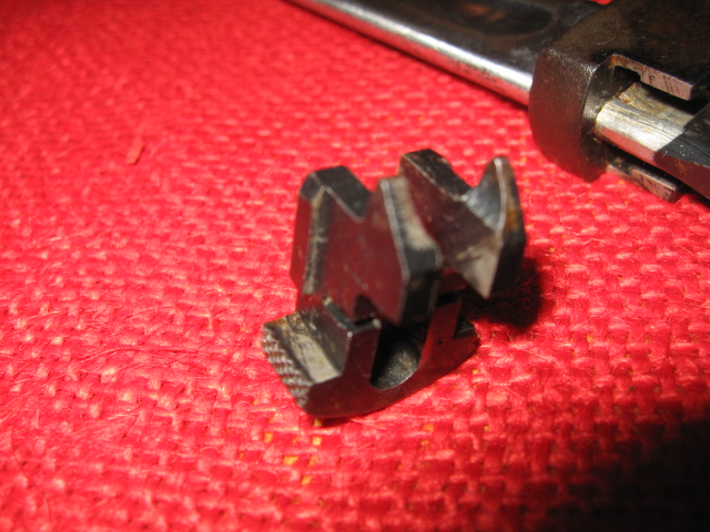

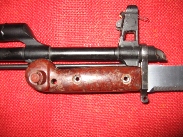

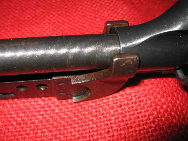

More pictures of the design and attachment of an AK47 bayonet. Note the complexity of the design and the extensive machining required on the cross guard, latch, blade tang and pommel. Mike

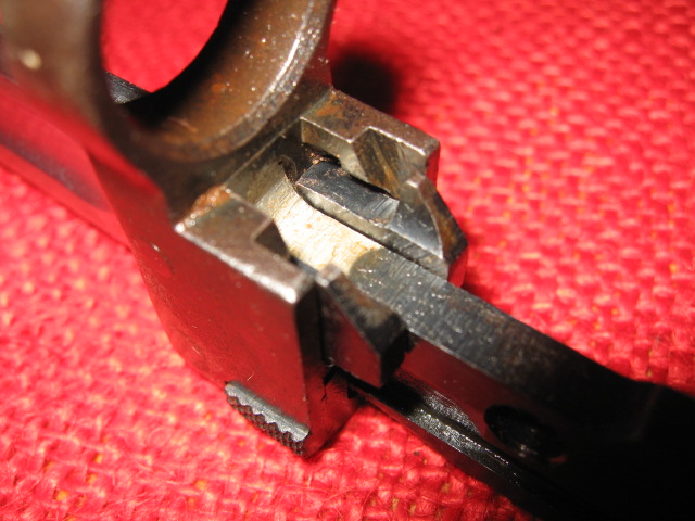

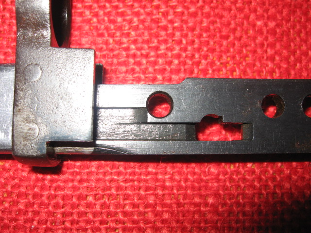

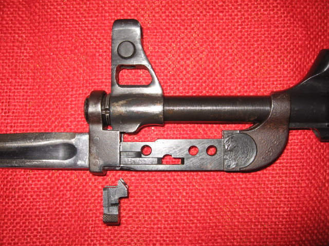

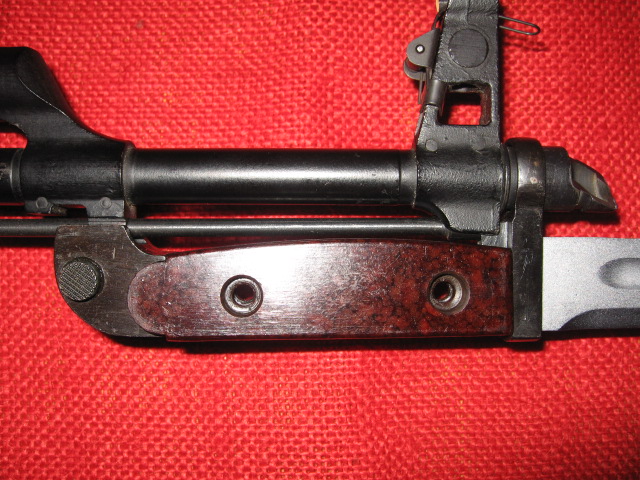

A couple more pictures of the AK47 bayonet design with the hairpin latch spring installed, (fun procedure!?). Note the small N. Korean star mark on the side of the cross guard between the rivets. This bayonet is in very used condition condition and has been excessively sharpened. It came with the correct red/orange grip panels, but no scabbard. It was picked up in Viet Nam in 1969 during a bomb damage assessment mission. Supposedly a NVA officers bayonet!? Mike

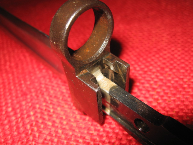

Eventually the AK47 was redesigned and upgraded and the AKM was introduced. The main change to the rifle was the weight reduction and ease of production with the introduction of the stamped steel receiver replacing the forged and machined steel one on the AK47. Also with the new AKM a more conventional method of mounting a bayonet was introduced with a mounting stud under the front gas block. The first model bayonet designed for the AKM, (6X3 Type I), had the catch in the pommel and a muzzle ring as attachment points. This design also incorporated a means to connect with the scabbard to form a wire cutter. With plastic like insulating grips on the hilt and a rubber insulator on the scabbard even electrically charged wire could be safely cut. A redesigned hanger was also developed with a snap hook to allow the scabbard to be detached for use as a wire cutter. Pictures are of a stripped Romanian 6X3 Type I bayonet and Egyptian made DDR AKM clone. This again shows the interchangeability of Kalashnikov weapons system.
NOTE: Of special interest it the way the small flat area behind the bayonet muzzle ring fits into the front of the cleaning rod bracket under the front sight base on the rifle. This fit helps stabilize the bayonet and keep it from rotating around the axis of the barrel. If you examine that flat area, you will notice that it is an integral machined part of the cross guard. It covers the top and sides of the blade tang as it protrudes through the cross guard.

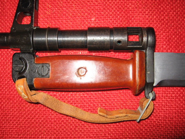

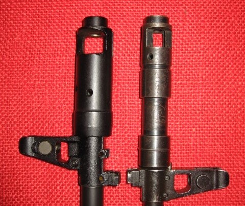

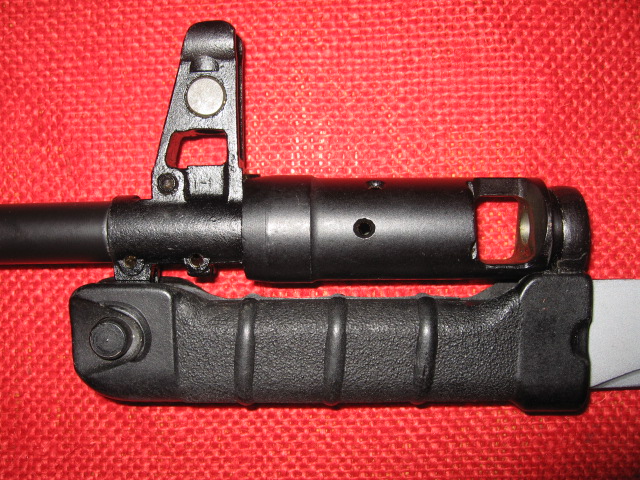

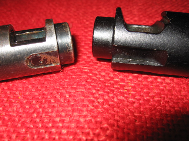

The final step in the AKM series is the AKM series is the AK74 which introduced the smaller 5.45x39 cartridge in place of the 7.62x39. It also incorporated an extended muzzle device requiring different points for bayonet attachment. The pommel mount stud was moved forward and included in the FSB the muzzle device has a false barrel extension to engage the bayonet muzzle ring. Pictures are of Bulgarian and Polish muzzle devices and a Polish 6H4 bayonet.

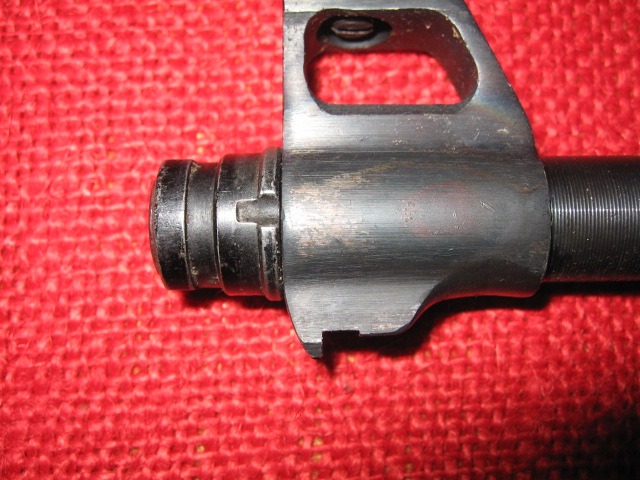

When first introduced the AK74 rifles were intended to continue using the 6X3 and 6X4 bayonets already in use. It also should be observed that slightly redesigned FGB still has a secondary bayonet stud so that these bayonets can still be attached when the muzzle extension is removed
NOTE: A small groove is machined into the bottom of these muzzle extensions to engage the anti-twist lug on the bayonet cross guard.

This may be true on a Polish Tantal, even if it is the barrel diameter is too small and the bayonet will flop around, and that was not the intention. For a Bulgarian Ak74 or Russian AK74 this is not true because the section of the FSB where the brake attaches is 24 mm in diameter and the ring will not fit at all. The actual reason the lug was left on the GB was to mount under-barrel grenade launchers such as the Pallad (Polish) or BG15/GP25/GP30 Bulgarian/Russian.

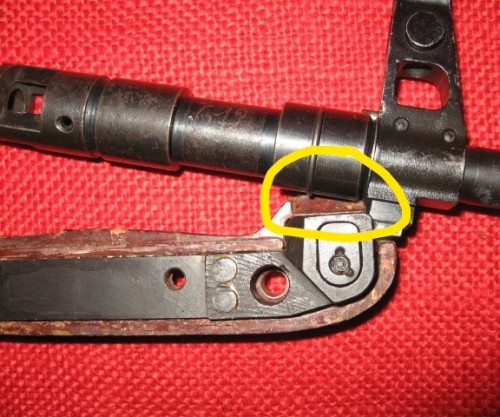

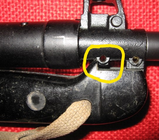

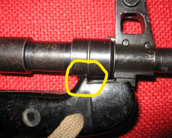

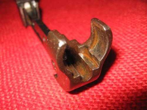

Could you try to fix your mofified pommel 6x3 bayonet on an AK74 please?
Re: Understanding AK Bayonet Attachment Methods

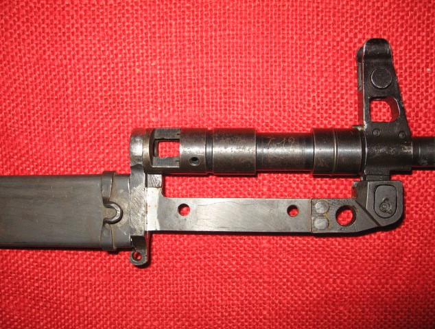

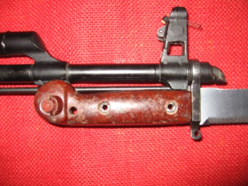

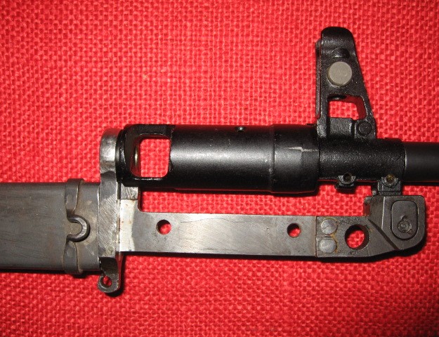

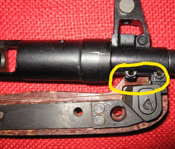

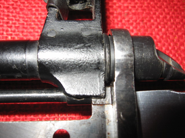

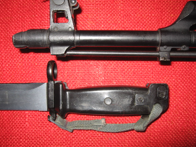

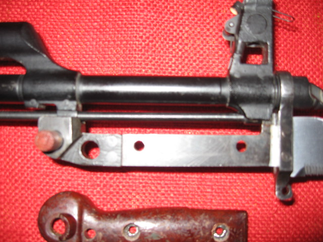

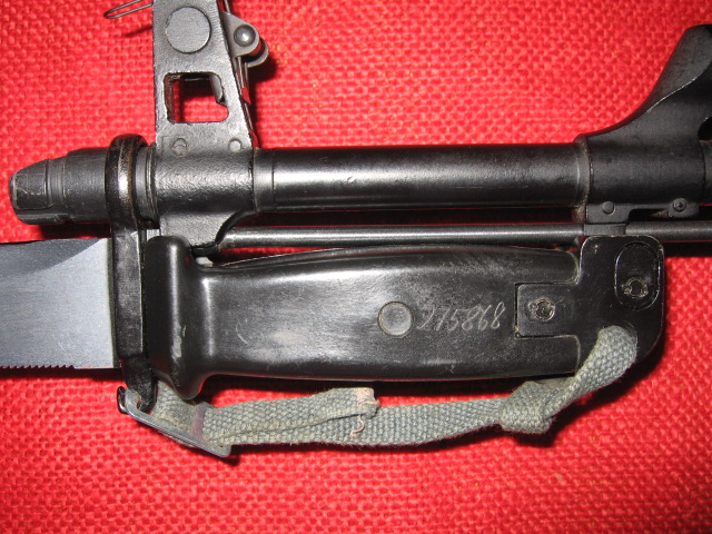

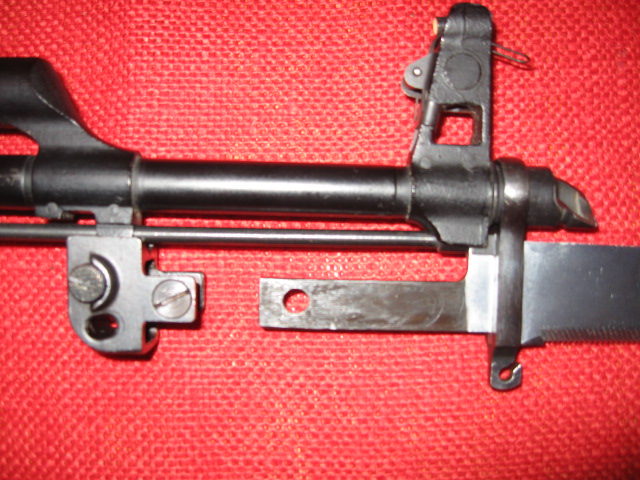

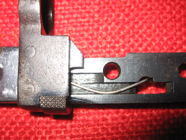

Good idea. Here are the results. I only have access to 2 AK74s, Polish and Bulgarian. My modified East German AKM 6X3 Type I does NOT mount on either one. That eliminates these 2 possibilities and we still do not know what the modified E.G. and Hungarian 6X3 bayonets fit on. I also took pictures of a cut away 6X3 to show the same basic interference on these 2 AK74s. As a side note I believe a modified 6X3 bayonet with the pommel cut flat, (without the points), would fit on either one. Mike

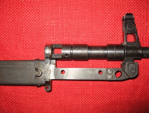

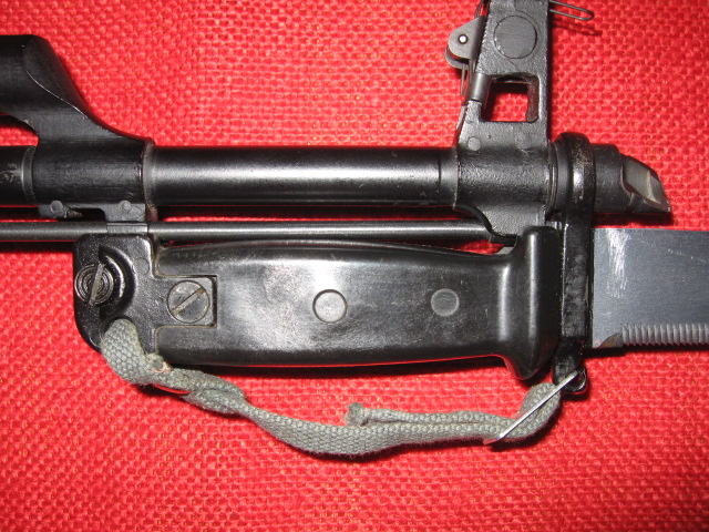

For comparison here are a couple of pictures of a stripped 6X3 on both AK74s. I believe that both would fit if the top of the pommel was ground/cut flat. Mike
