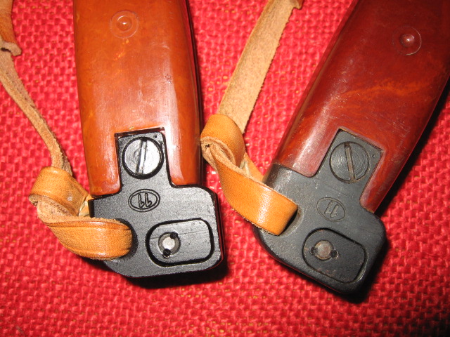

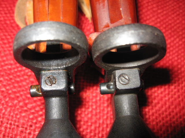

I currently only have two of these Polish trainers. My goal was to keep and display only two representative samples to display most of the main variations, as other than marking and colors, they are pretty much the same and some what expensive. There seems to be only one major change in the metal parts and that is the extra rivet hole in the cross guard, which was not used, disappeared sometime in 1987. In SIG_551_SWAT's 2nd picture above it seems this happened between Nr 3391 and Nr 4371. It is unknown if there is an actual cut off number or if this was a running change as old parts were used up. Another difference is the metal finish, blued or black painted. There are also differences in the head sizes of the small screws at the front of the grips to the cross guards. There are also different colors/shades in the grips from orange to dark brown just like the actual bayonets. Most obvious are the different shades of the rubber collars and tips from white to black. These rubber parts are easily replaced and switched around. Below are my 1986, (light colors, painted), and 1988, (dark colors, blued).

Here are a few more pictures of the WZ 85 bayonets. Note the molded indents on the grip sides and that the pommels are secured to the grips by machine screws with heads on both sides as they do not go completely through the pommel. Also for general information, none of the parts for these trainers interchange with standard 6H4 Type II bayonets. They may be manufactured on the same machinery and the same basic technology but completely different in final machining and assembly. Ooooops, the bayonet mounting catch assembly may interchange!?

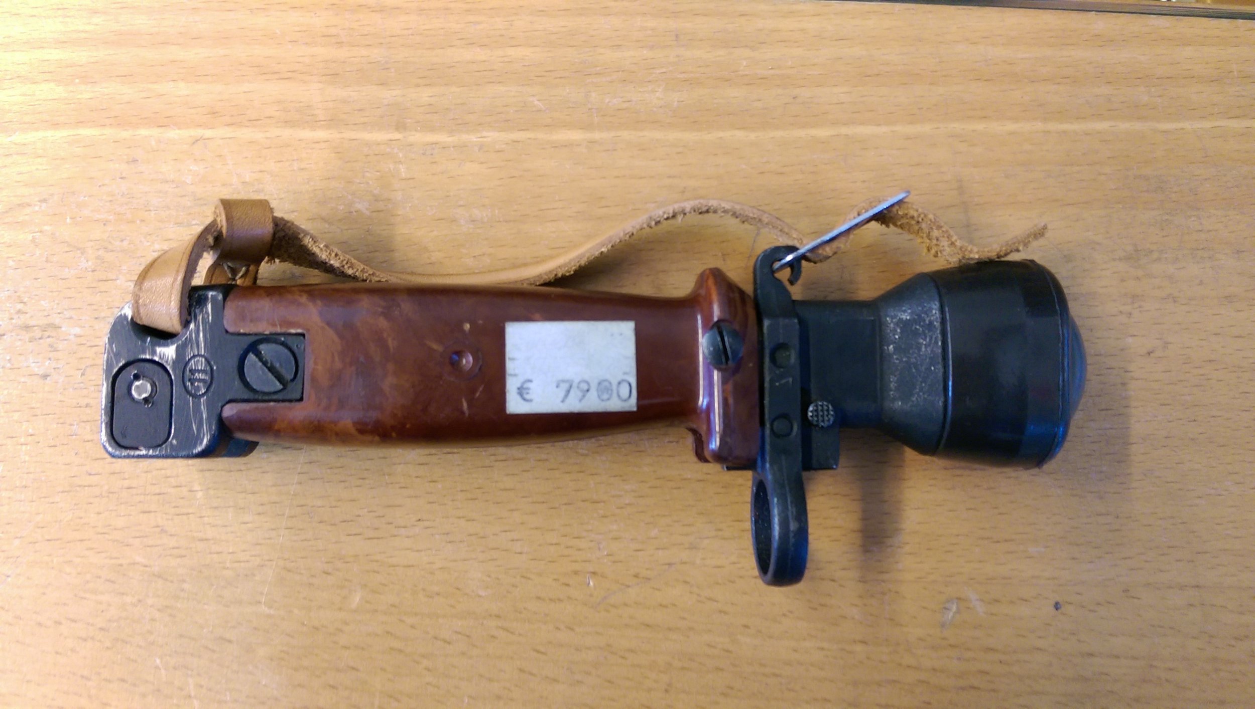

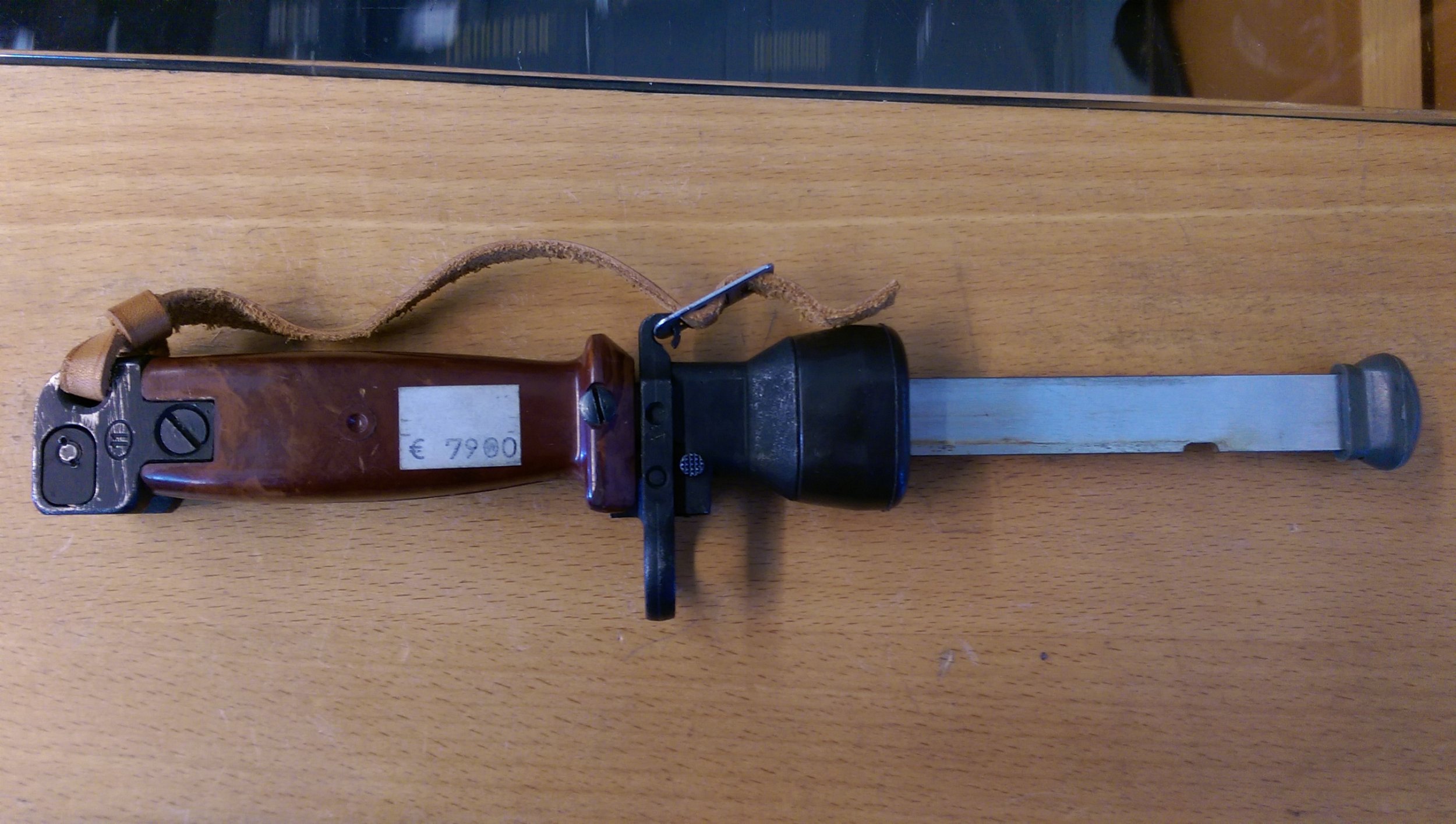

Picked up a Wz85 (Nr. 03372, 1987) in Germany recently, it's "insulator" (rubber collar) appears to be black whereas the "tip" is gray.
Got it and a subdued National Training Center patch for €65 ($72.50, seller was asking €79.80 or $89 for the training bayonet along), couldn't resist it at that price! It''s used but in pretty good shape!

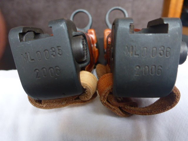

The ML 2006 versions in the collection are consecutively numbered, 0035 and 0036, and have been in my collection since 2007.
