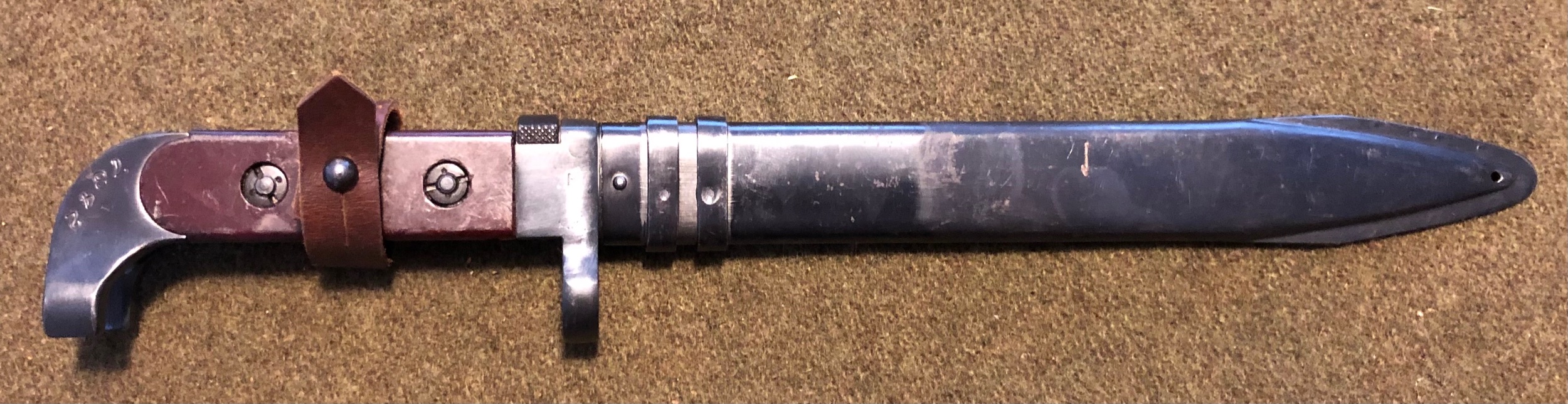

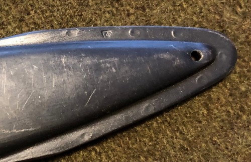

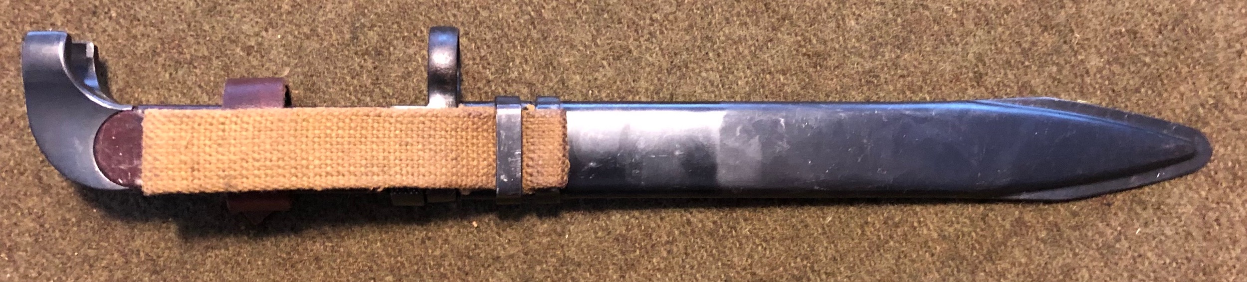

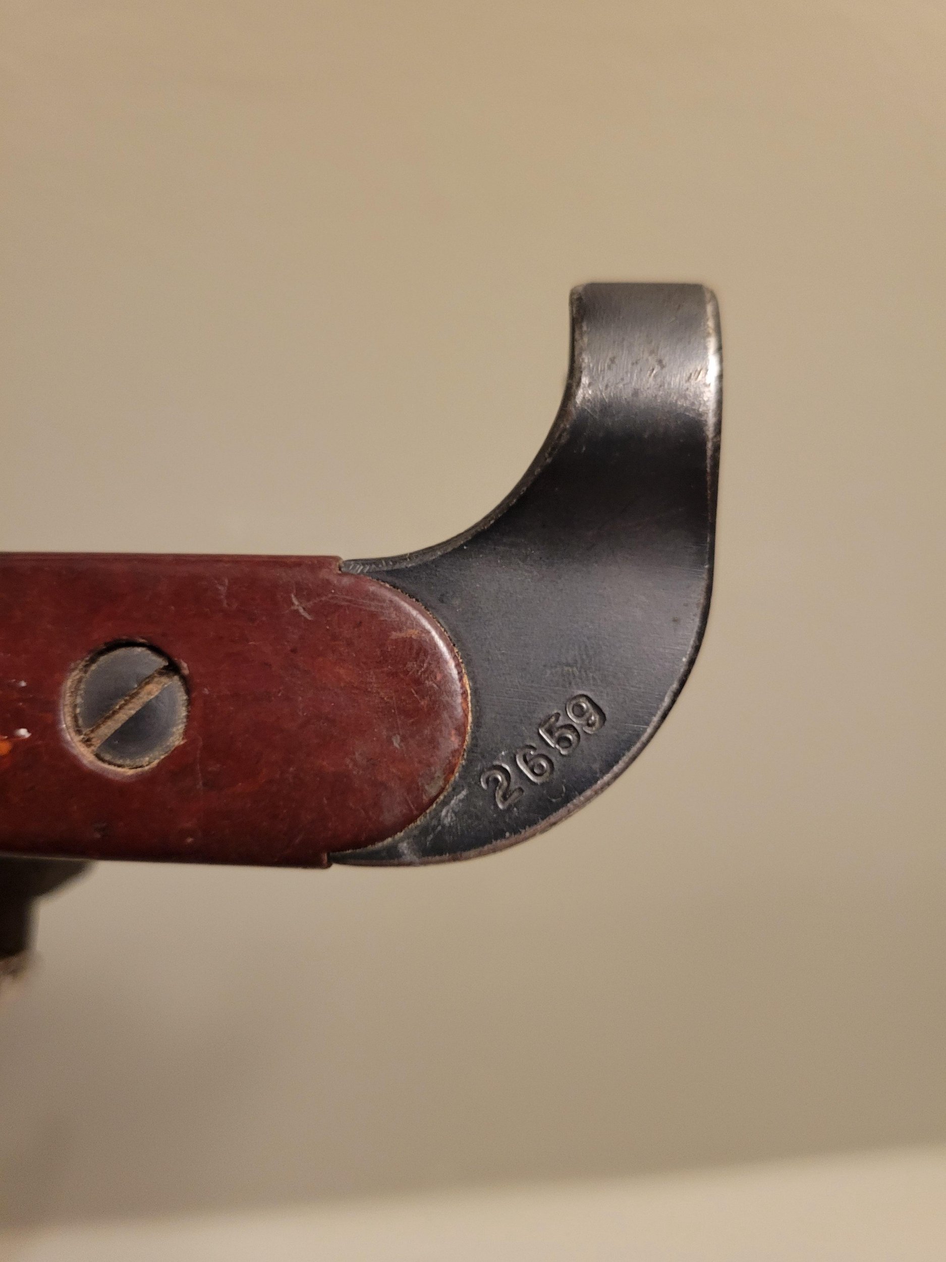

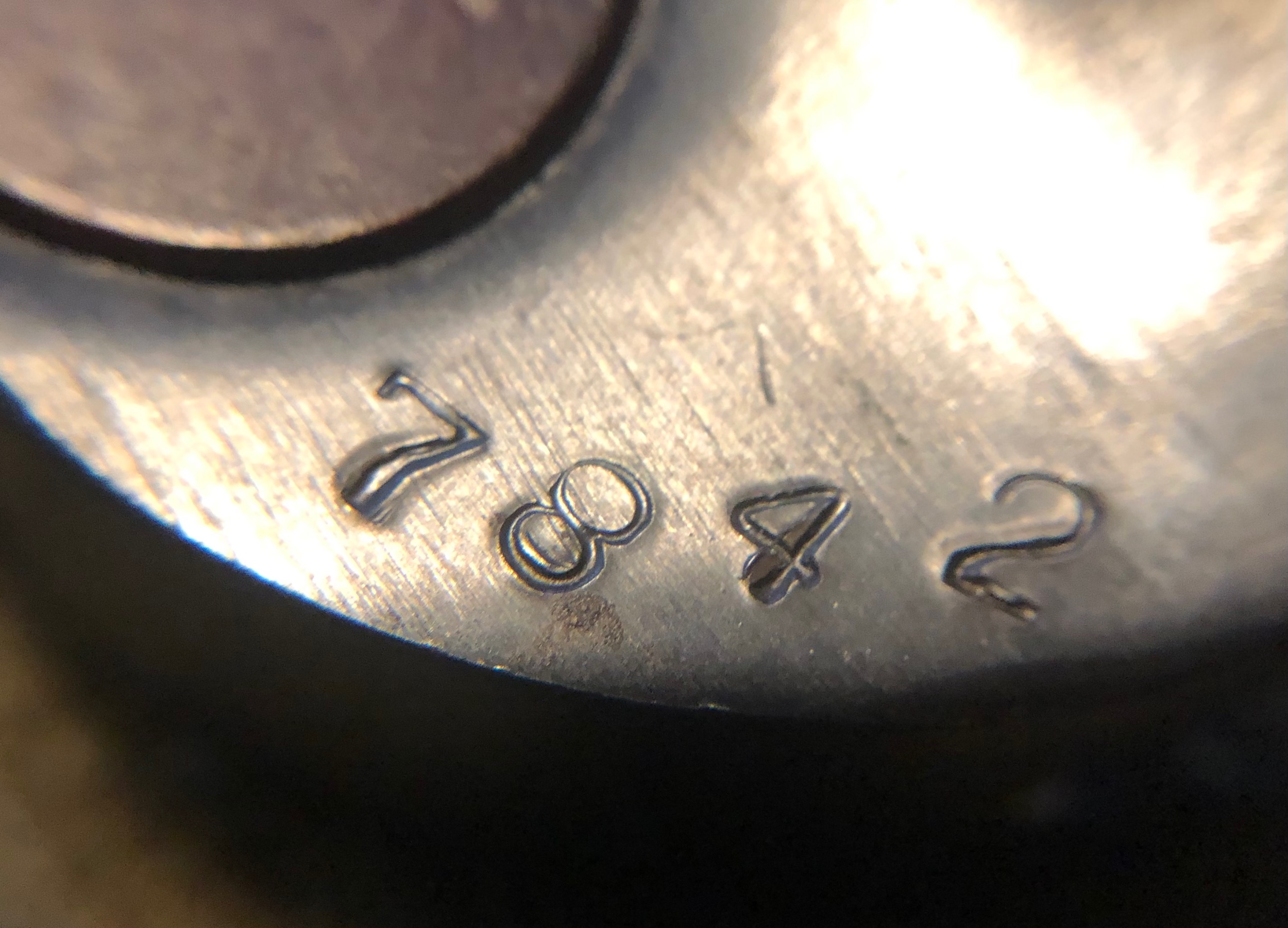

A recently acquired Russian AK47 for my collection. Initially I was convinced it is a Finnish example, after further inspection, I'm not so sure it is. The scabbard and hanger appears correct for Finnish but with a drain hole. The numbers on the pommel are not in a straight line as the other examples posted in the forum. No <CB> stamp. I’m not sure what to make of this bayonet.
Re: Russian AK47
Wow, another one of these Russian, Finnish, or other contract bayonets and scabbards. I have seen several similar to this in the last year. Ones like yours bring up more questions than information. They don’t seem to follow any of the identification clues we usually use.
1. Scabbard Body. Early Russian production with 2 bands and two-tone blued finish. All made on the same equipment and to the same specifications. Proof/inspection marks done by different people at different times during production. Supposedly the ones made for Finland 1st contract did not have the usual Russian drain hole in the front. Carry over parts at the beginning and end of a production is possible. A drain hole on a Finnish one would probably not make any difference. A left over one could have a hole added for Russian use.
2. Belt Hanger. Made separately, (sub-contractor?), attached and sewn or riveted in place. Supposedly the ones for Finland were all sewn, the Russian ones used a single rivet. There are references that sewn ones were also used on early Russian ones at times.
3. Bayonet. Standard Russian production. The only difference is in the stamped markings. The ones made for and accepted by the Russian military must have a “CB” in a flattened diamond on the right side of the pommel. Those made for others should not have this mark. The serial numbers style and placement have also been used as identification. This is also inconsistent as it is hand stamped by different people at different times using different dies. No exact requirements? (More to follow). Mike

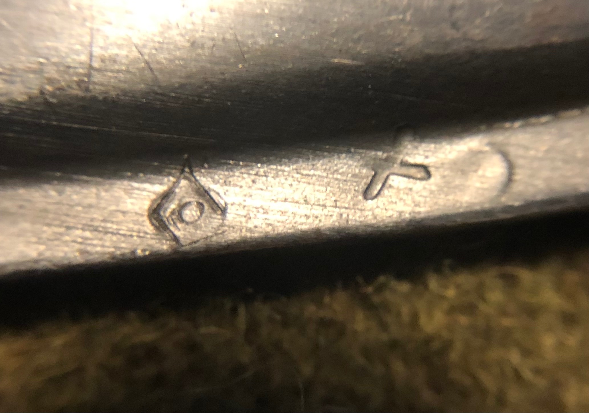

I just checked my 1st contract Finnish bayonet. I found only one “X” on the scabbard flange. Mine is in New condition and the are no other proof marks. It is one of the three in the last picture below.

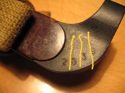

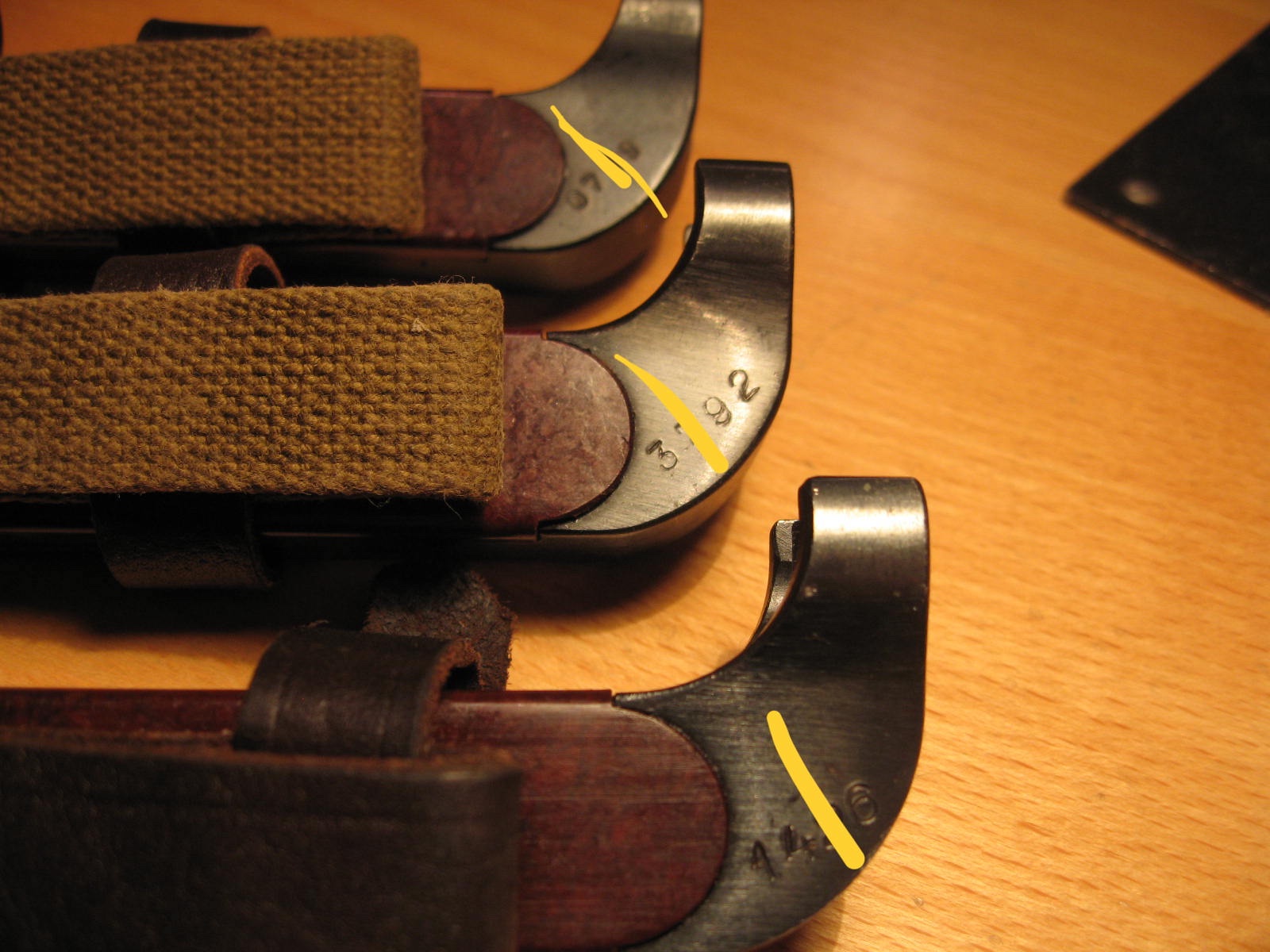

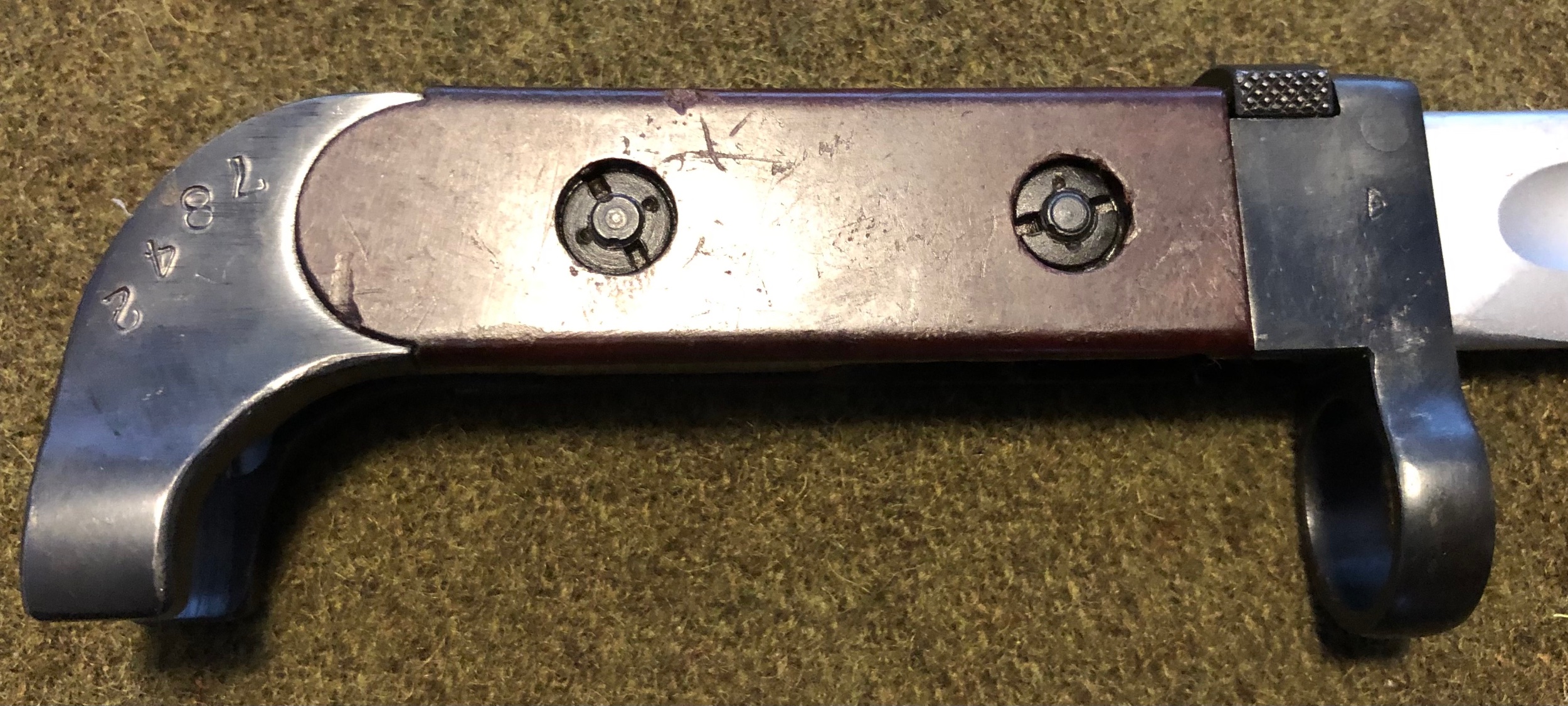

4. Serial numbers. Supposably the 4 digit serial numbers stamped on the left side of the pommel are different between the Russian an Finnish bayonets. The old rule was the Russian ones followed the curve of the pommel. The Finnish ones were on an angle and in a straight line. In my opinion they were somewhat random depending on when they were stamped and who was doing it. No actual specifications or requirements.
(The bayonet above is the 1st time that I have seen the numbers vertical and stair stepped.)
Below at top is the bayonet in this post. The next 2 are Russian. The last one is of 3 Finnish numbers.

Also remember that these bayonets and scabbards are not paired or matched with each other. They can be changed and switched around by anyone, for any reason, at any time. Without the Russian military “CB” stamp they are not for Russian issue or use. The unmarked ones could be made for export or contract or sales to another country. Unmarked ones also could have failed the inspection and be reused.
Re: Russian AK47
In my opinion the bayonet and scabbard at the start of this thread are from the Finnish 1st contract. Based only on the lack of the Russian military acceptance on the bayonet and the belt hanger on the scabbard. Just a guess, an unusual example. Mike

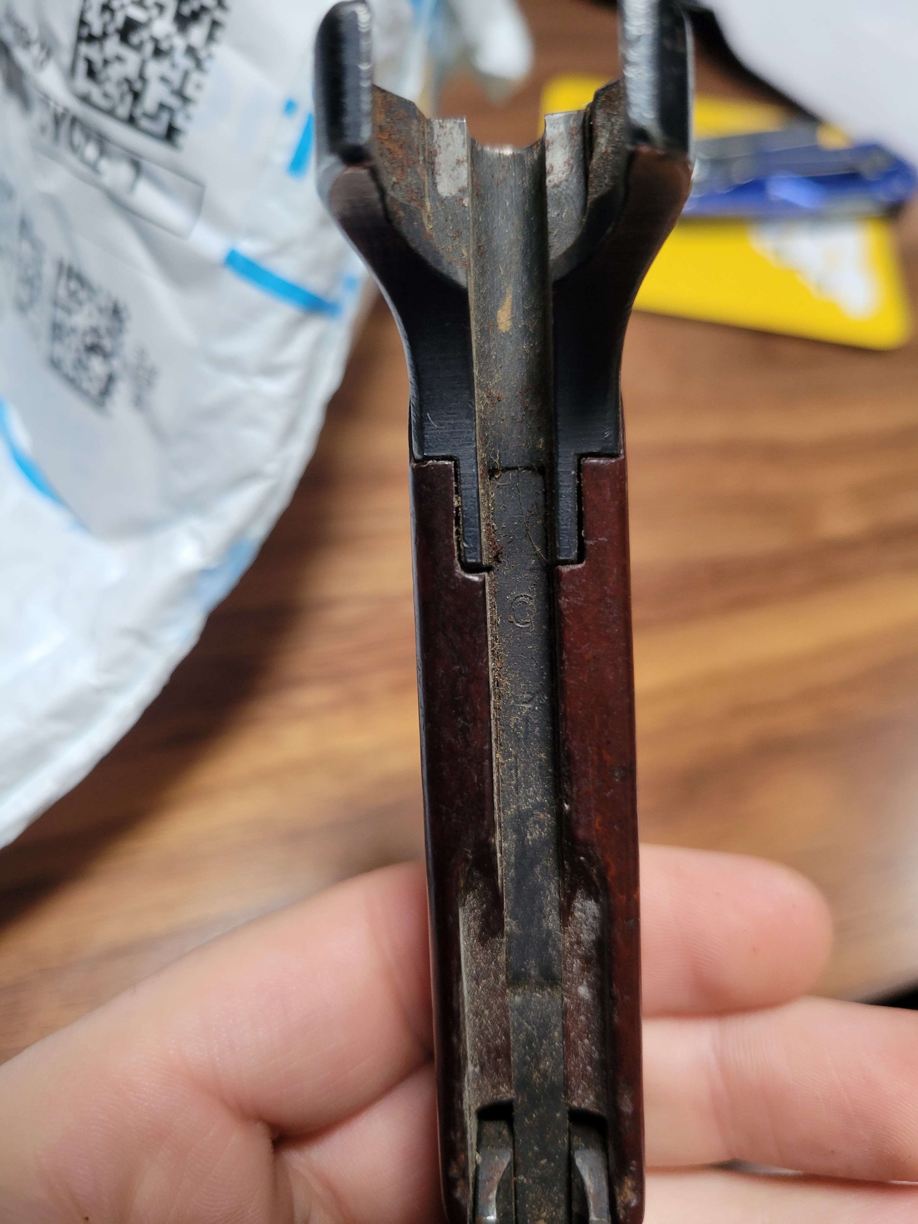

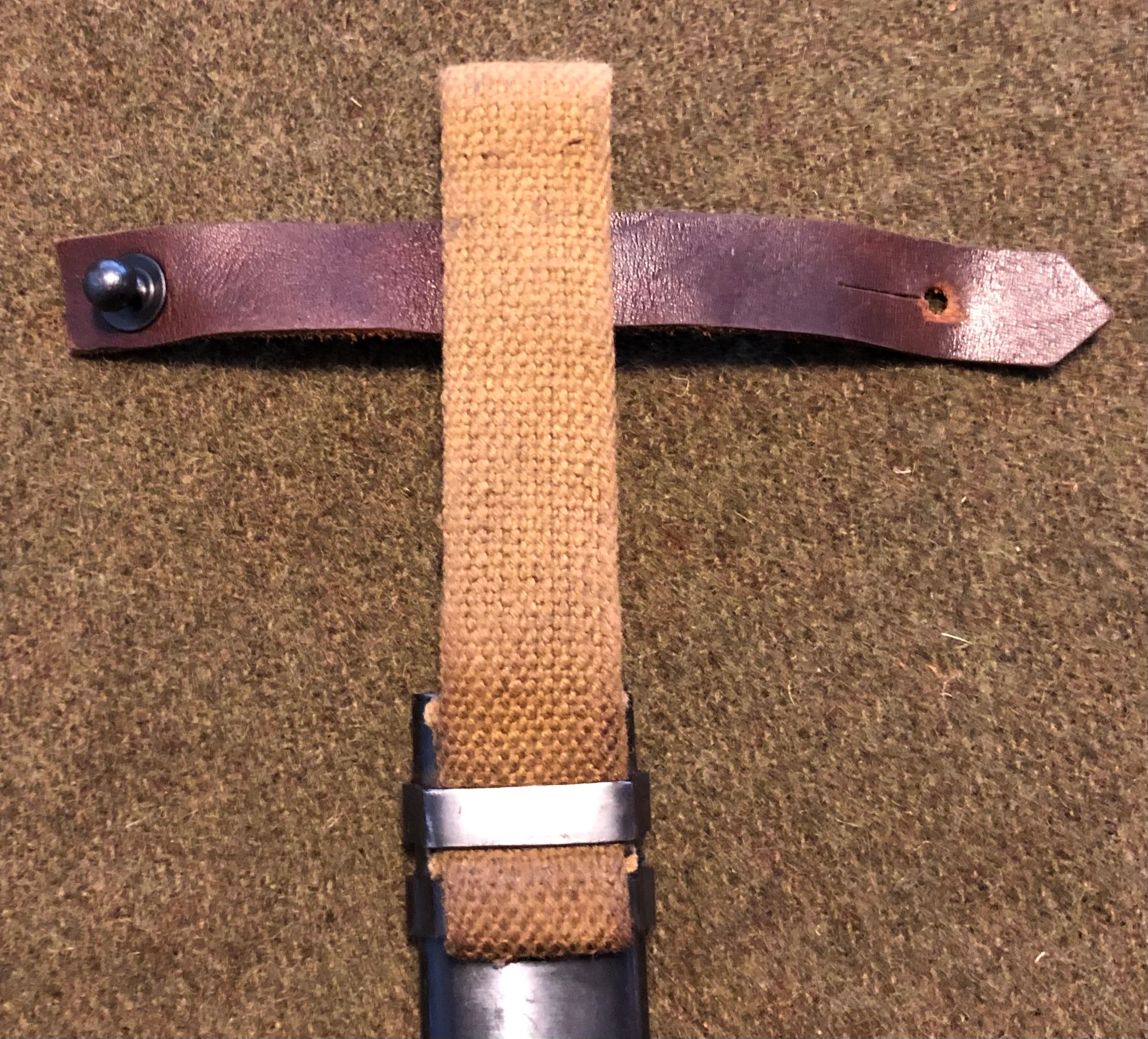

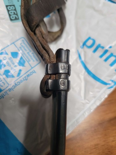

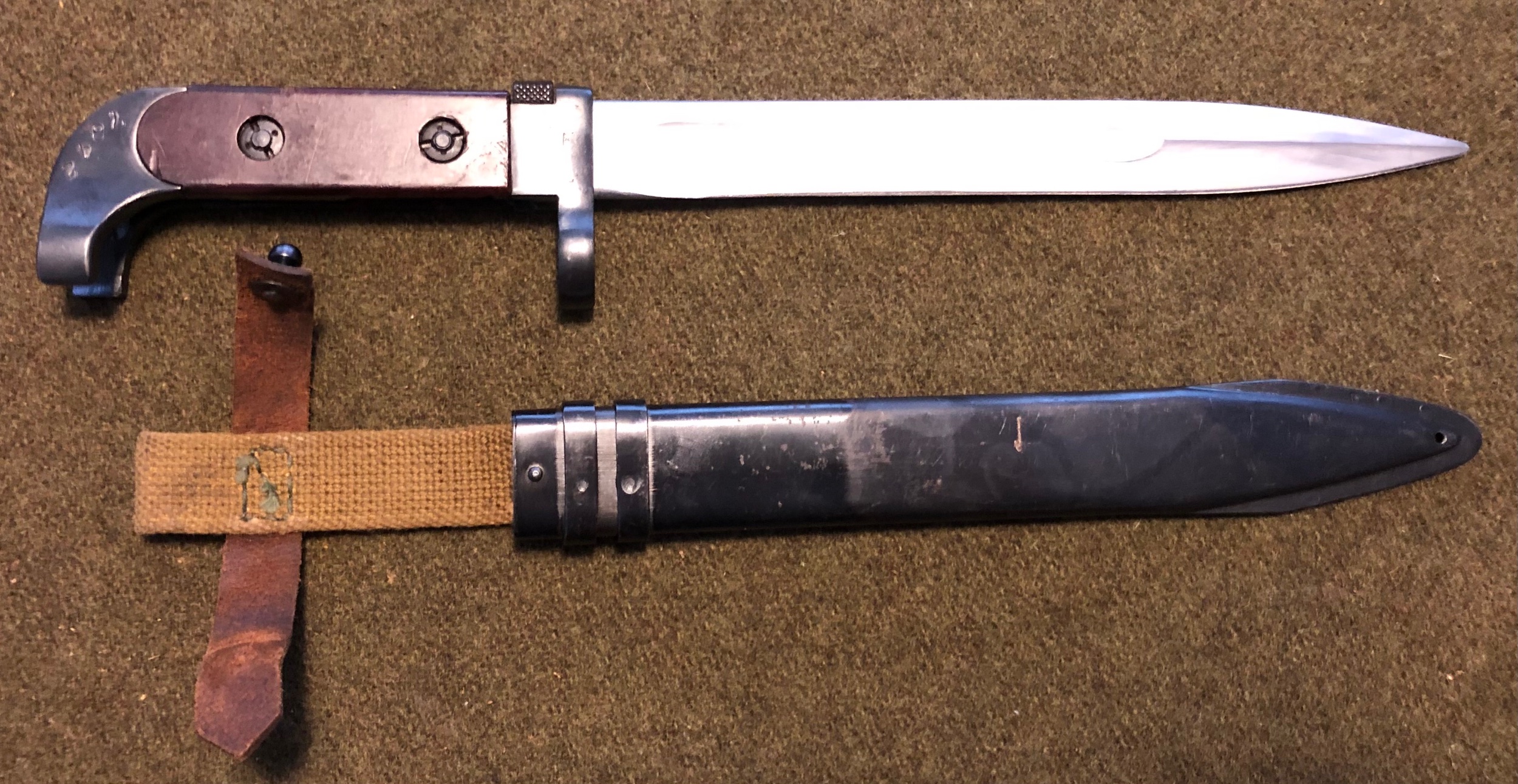

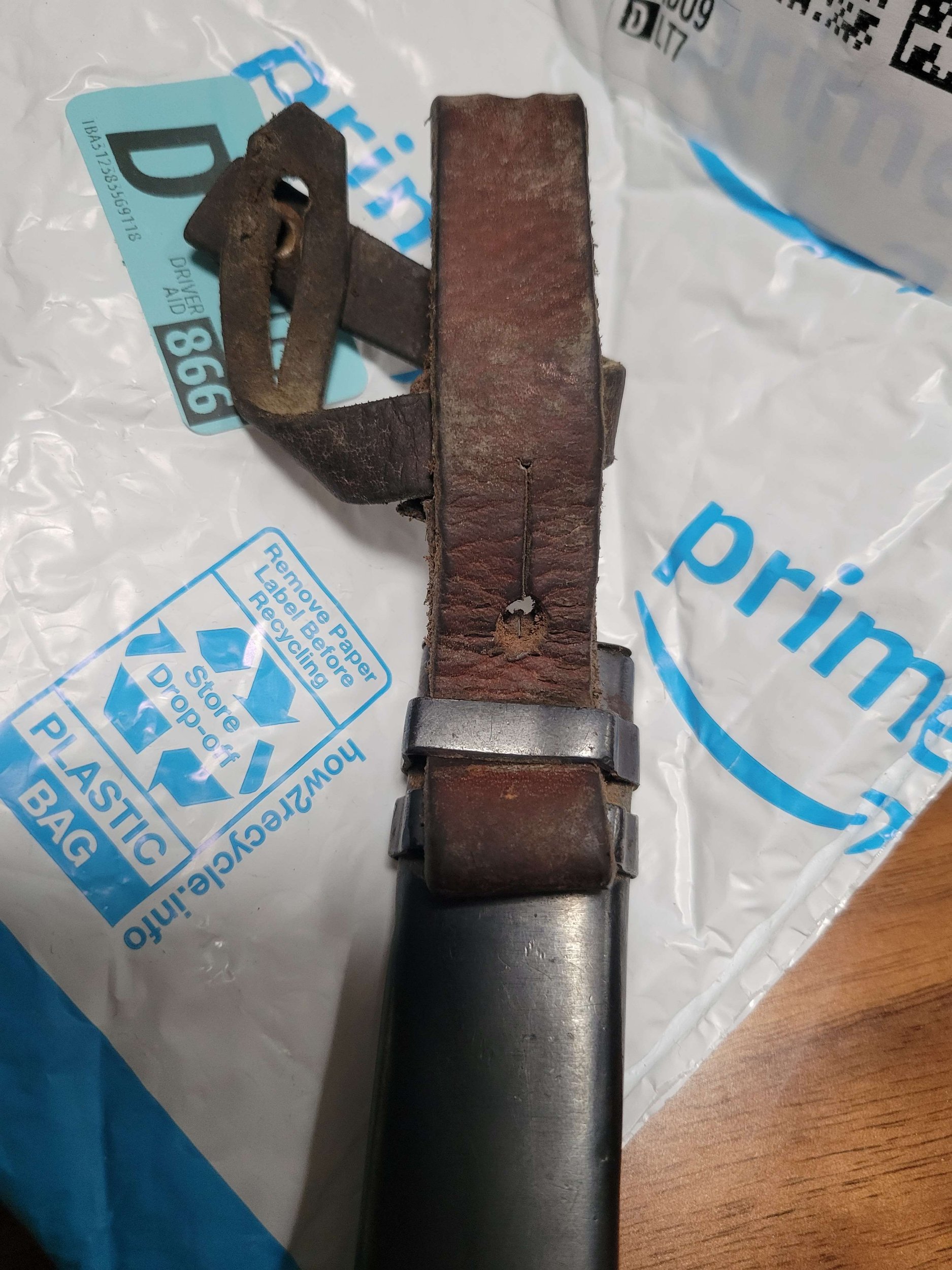

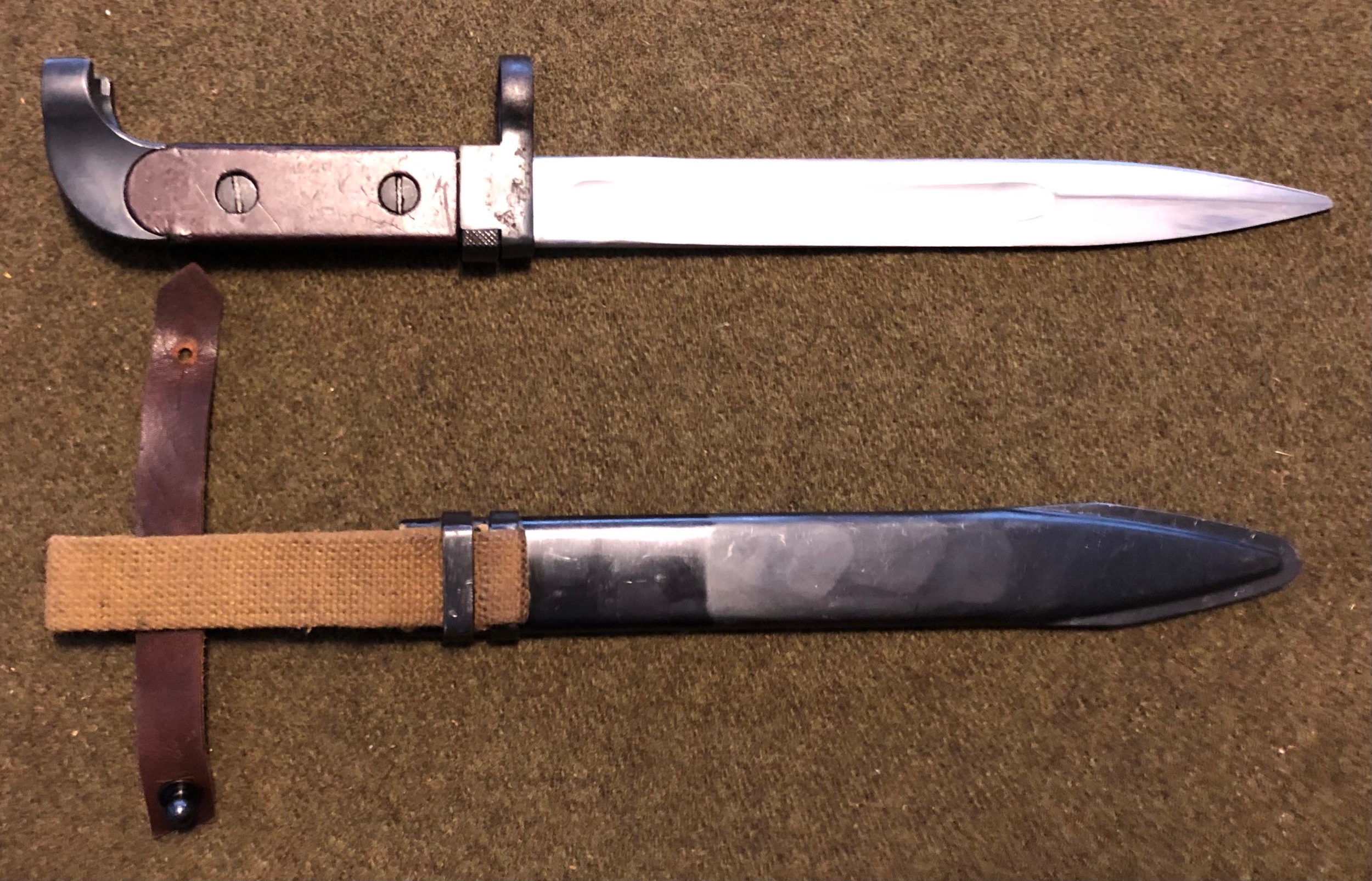

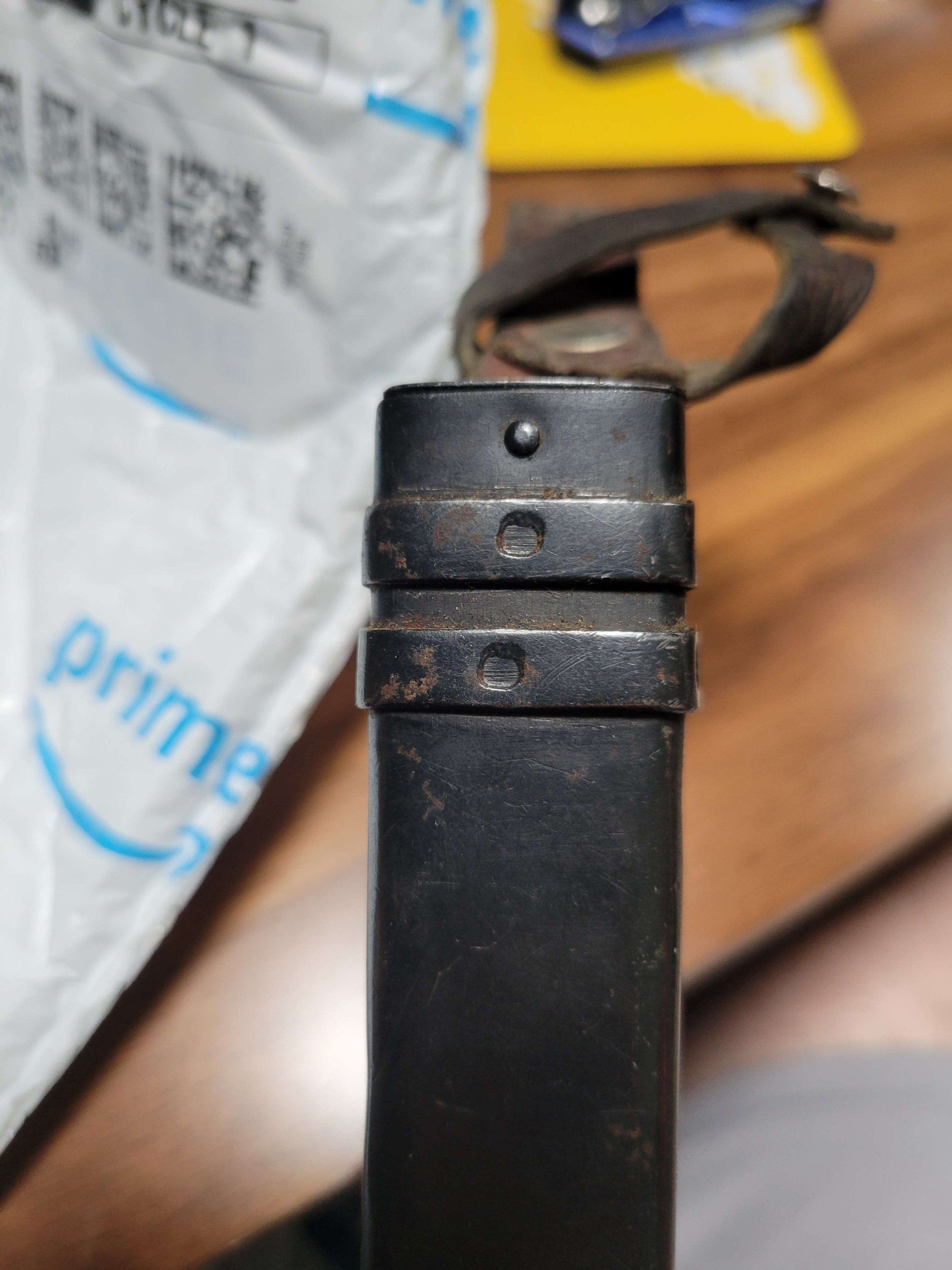

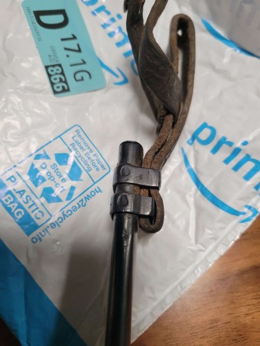

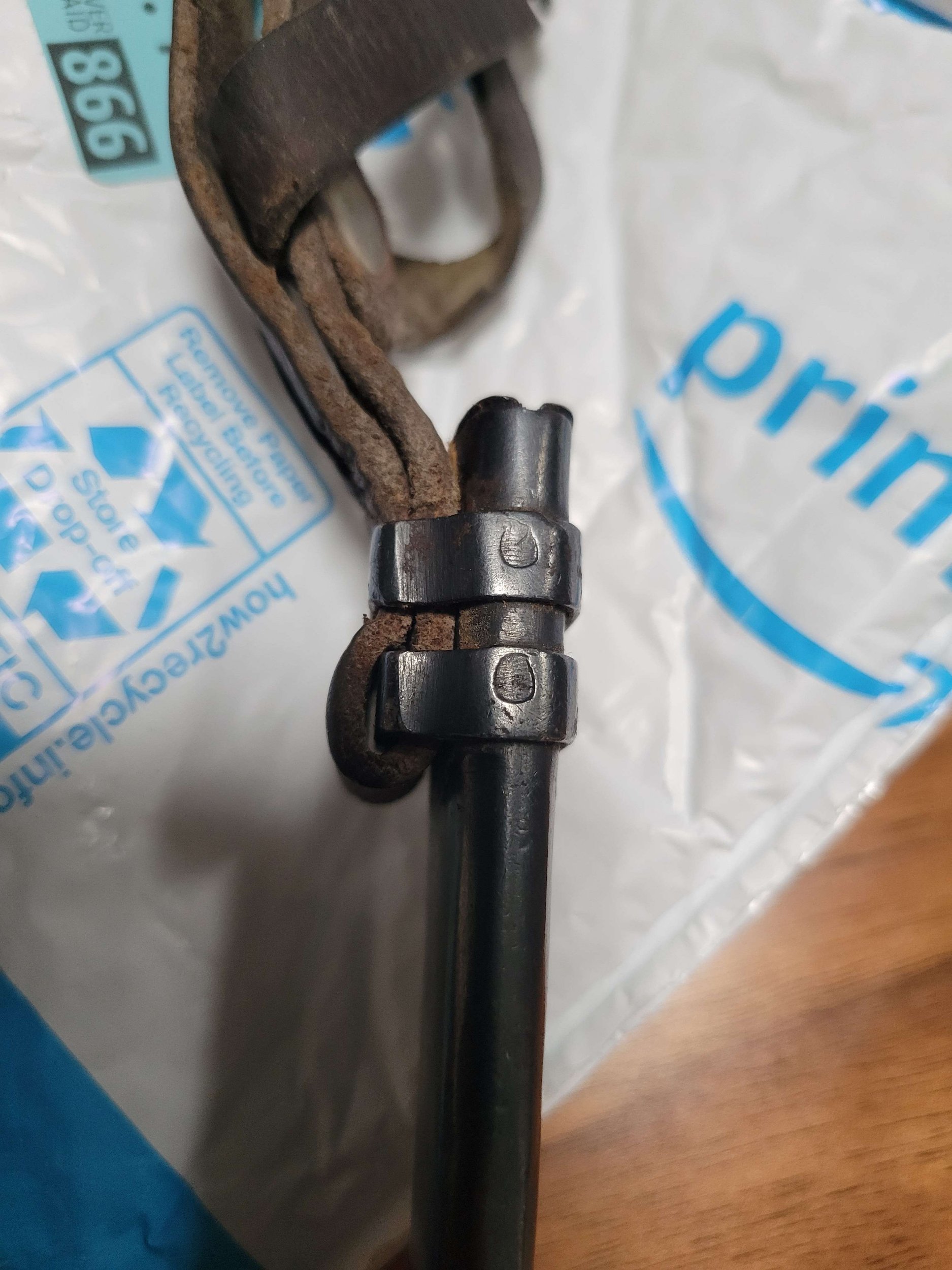

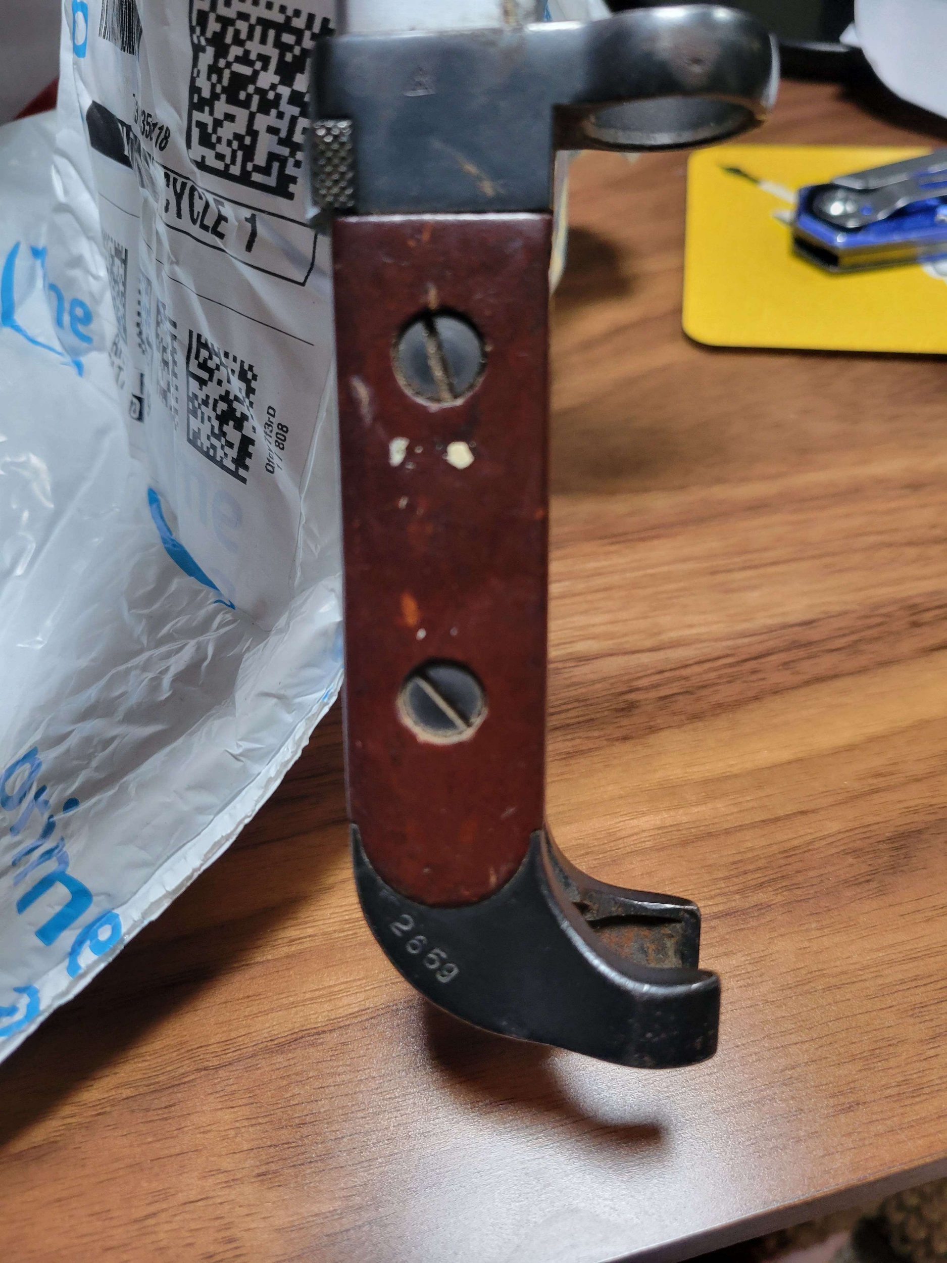

Hey Mike and Lance, I recently picked up what I believe to also be a Finnish contract bayonet. The hanger is throwing me off and I would appreciate any input that you two have. Here are the images. As always, if you need additional details/pics, please let me know!
Re: Russian AK47
Let’s start with the scabbard. The body could be a Finnish 1st contract with the two band hanger bracket. Also the Finnish scabbard is usually without a drain hole, (not visible in your pictures). The belt hanger is not Russian or Finnish. I have never seen one like that before. It appears to be hand made from spare pieces of strapping. Field repair/replacement. Usually the Finnish have little if any wear.
The bayonet could be Finnish or Russian. The key thing to look for is the flattened diamond containing a “CB”. This is the Russian military acceptance stamped on the right side of the pommel. Without that stamp is was made for Finland or another export contract. can not tell if this stamp is there from your pictures.
There is no sure way to I.D. a Finnish bayonet. If all the keys are there, it is probably is Finnish. If not all there, it may be a matter of best guess. In my best guess the bayonet may be Finnish if the “CB” is missing. The scabbard may be Finnish if it does not have a drain hole. The belt hanger is all wrong and makes the whole bayonet and scabbard suspicious? Cheers, Mike

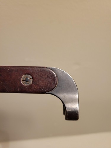

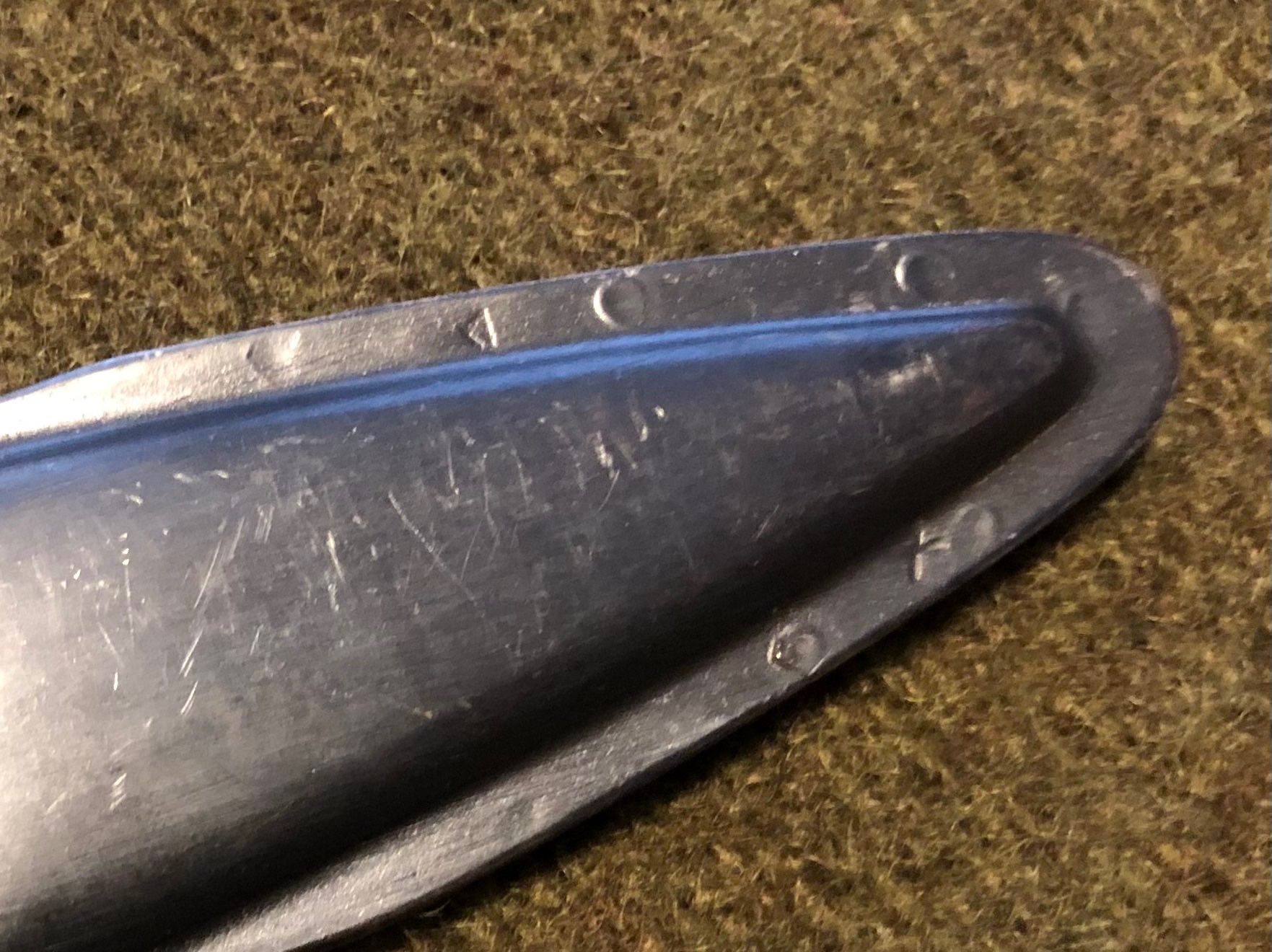

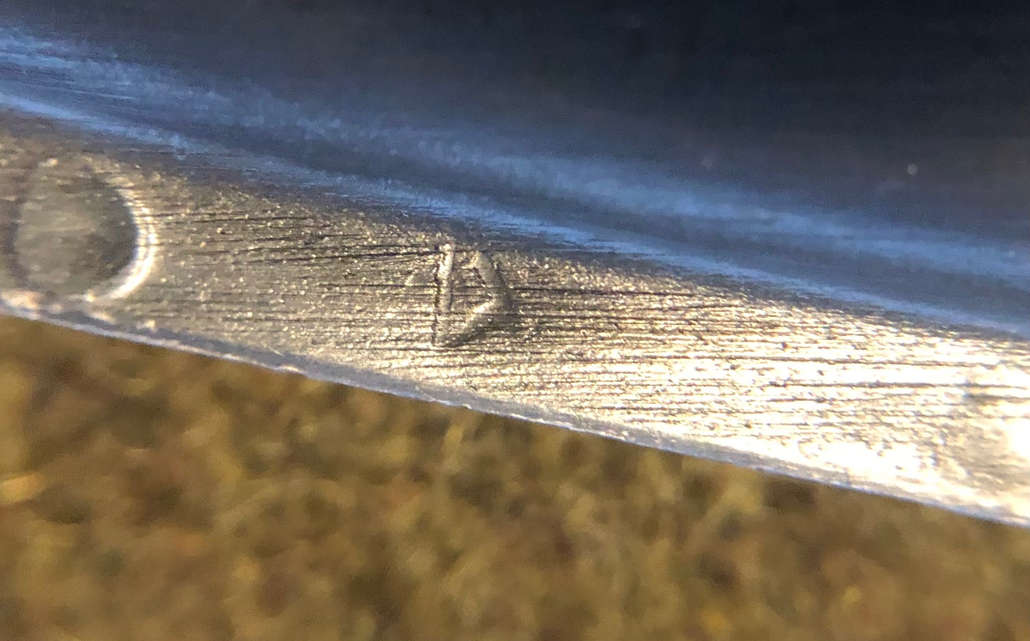

Re: Russian AK47
As always, thank you for the input, It is always appreciated!

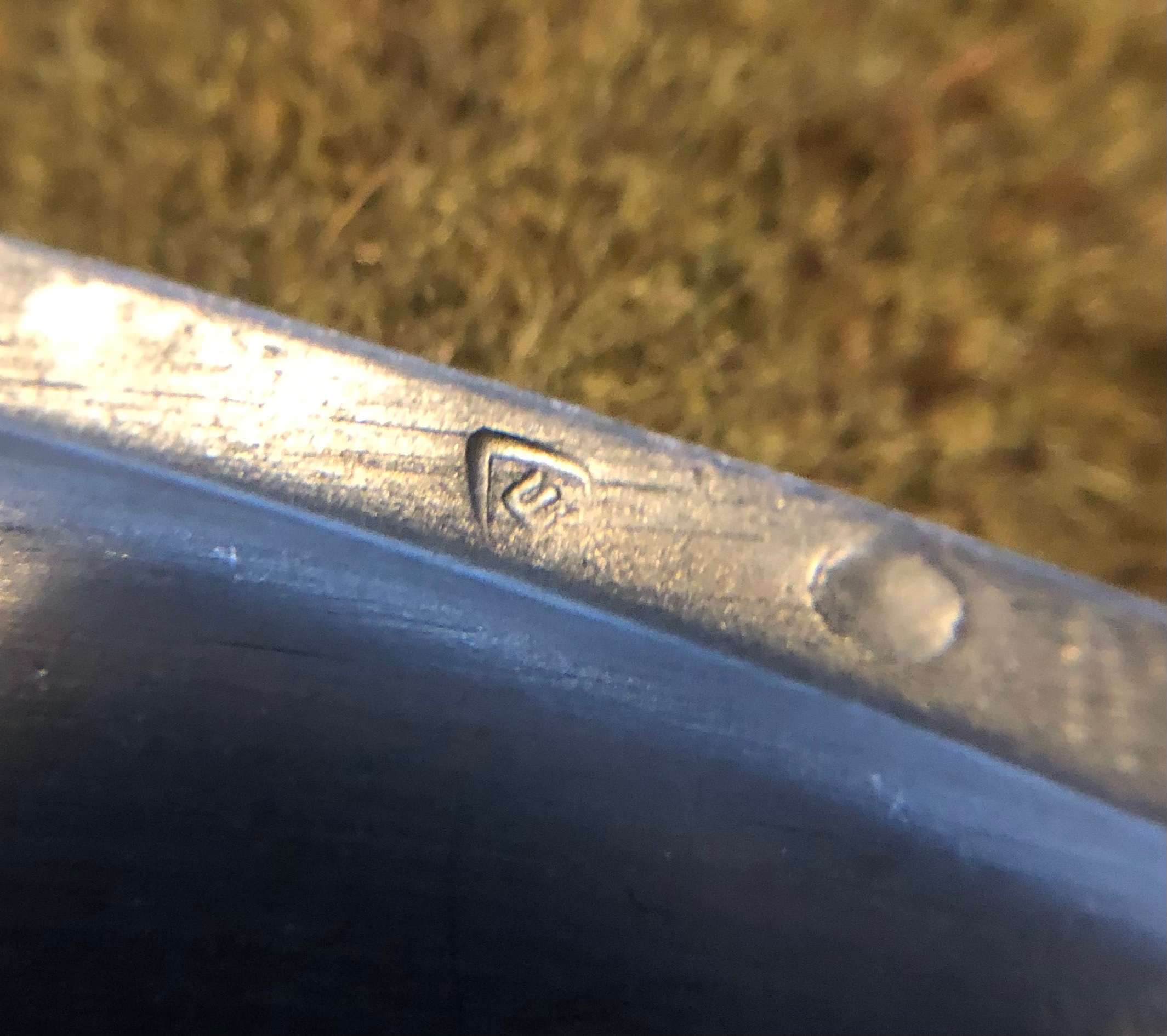

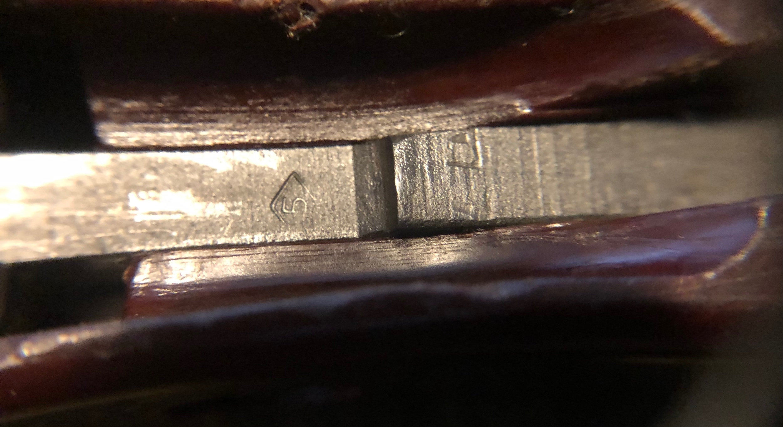

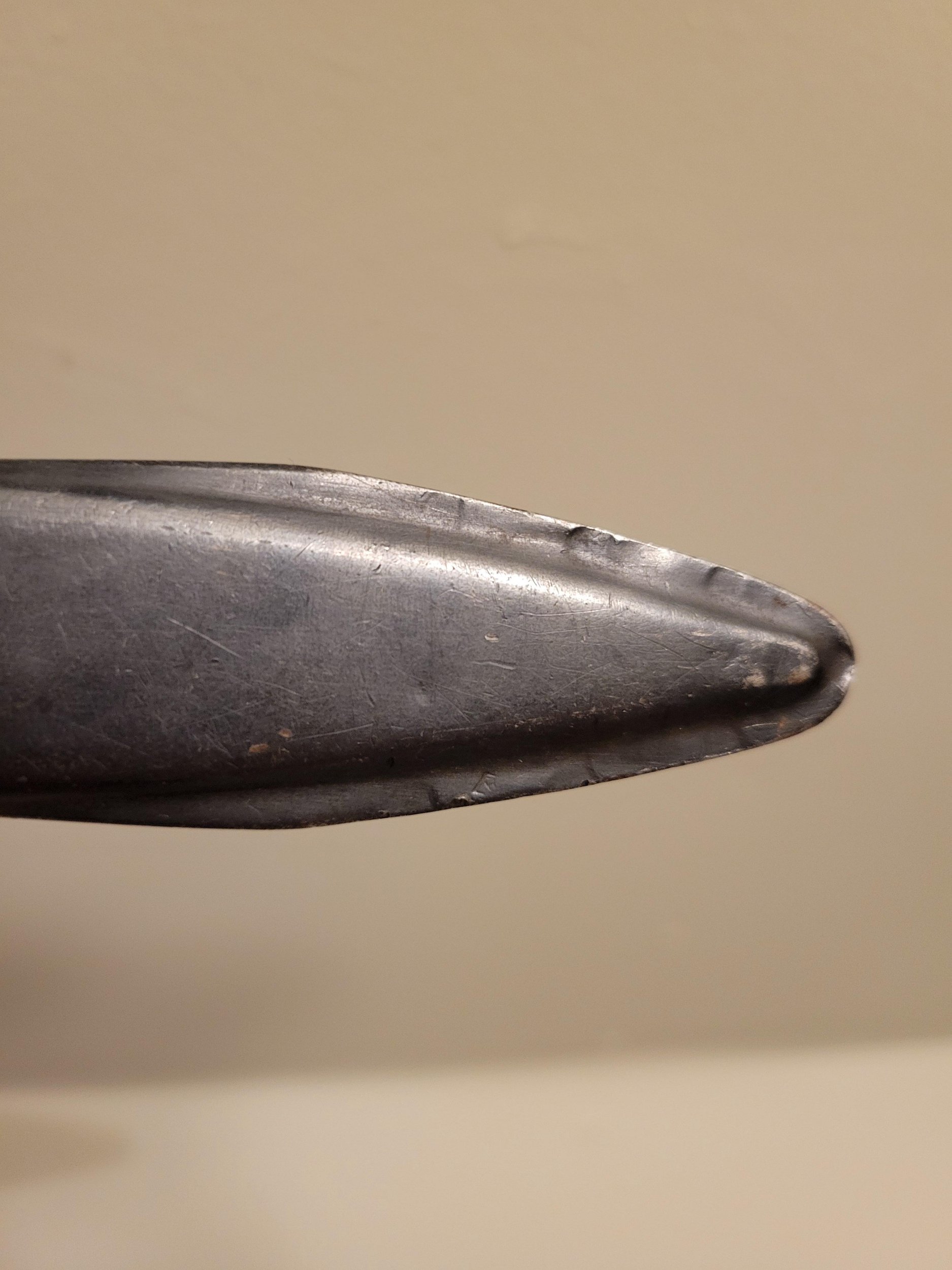

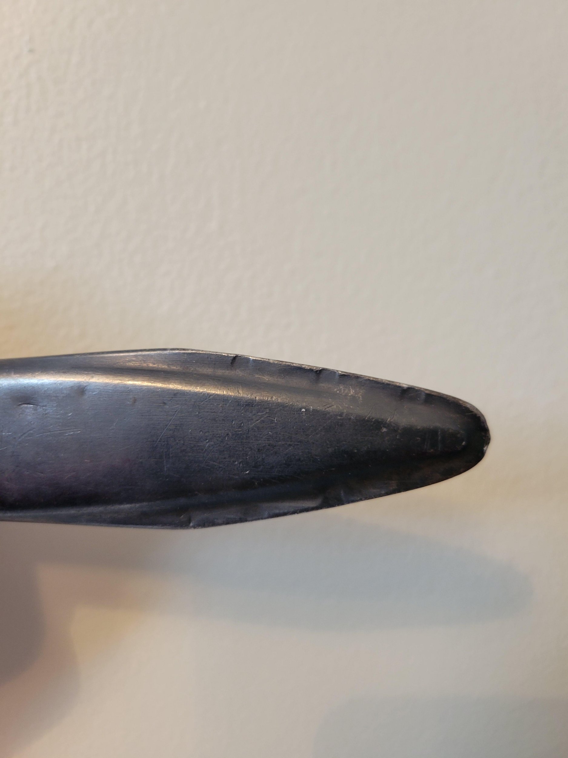

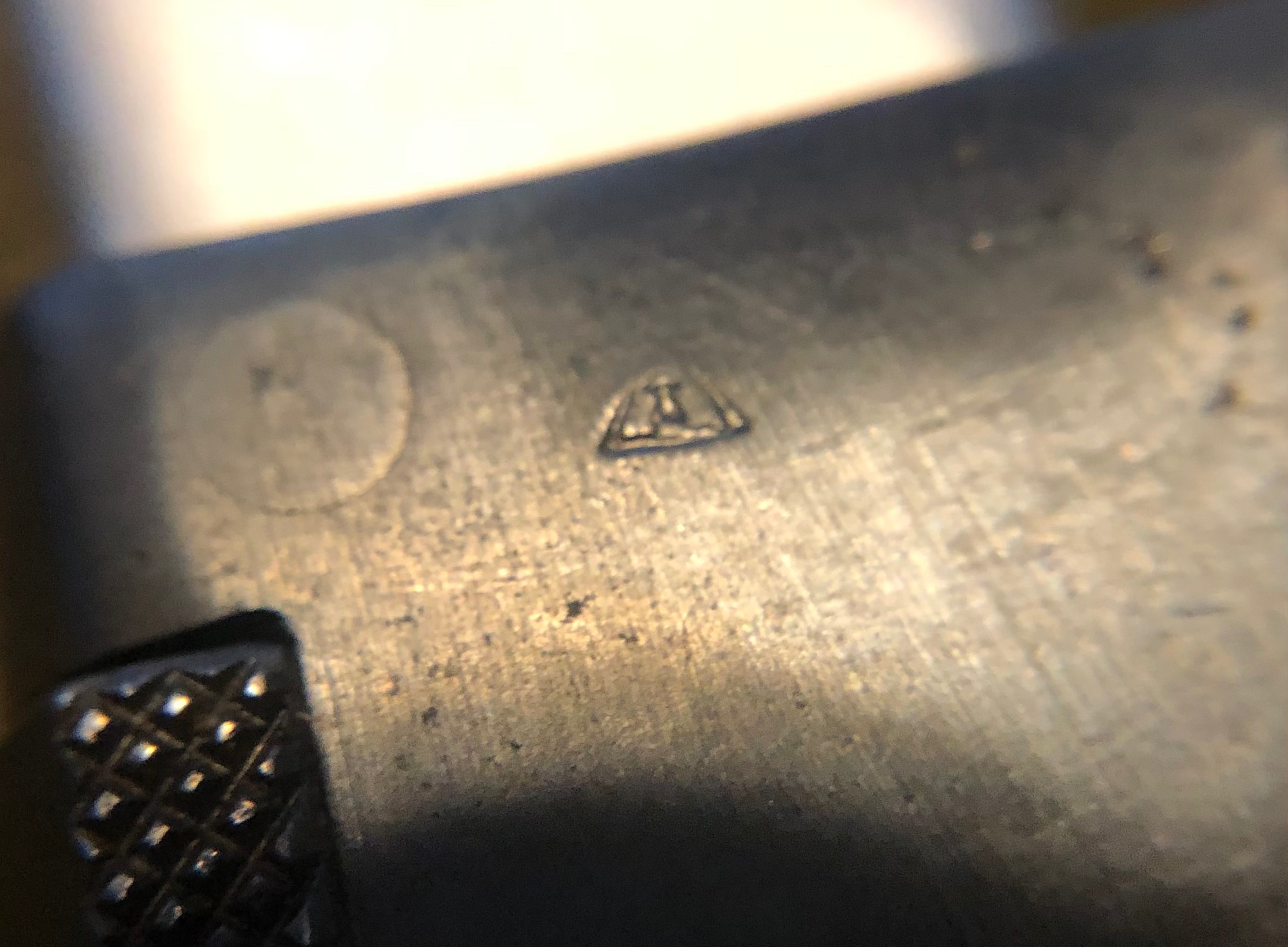

I took more pictures of the bayonet. There is no drain hole on the scabbard and I was able to spot part of a stamp. It looks like a partial diamond but the letter inside does not look like "CB". As for the right side of the pommel, it appears there are no stamps.
Re: Russian AK47
The bayonet and scabbard are Russian made at the izhevsk arsenal. Not for internal use. Made for a contract or provided to another country. Most likely the 1st contract for Finland. The correct belt hanger would have helped confirm it. A nice bayonet and scabbard unfortunately difficult to find and install a correct hanger Regard, Mike
