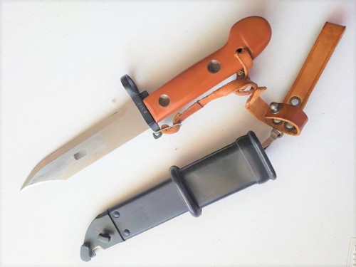

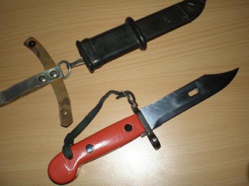

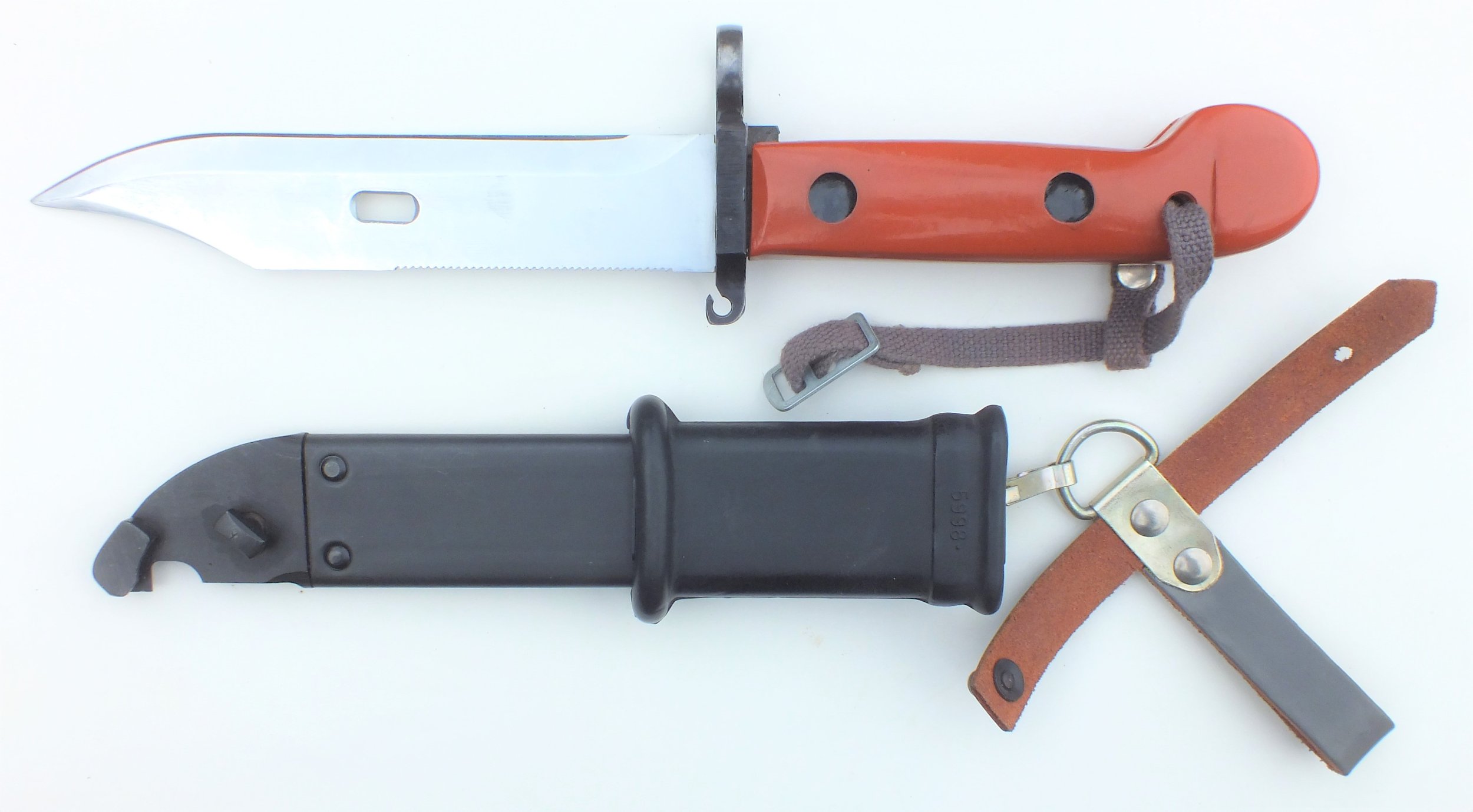

Top one appears to be East German and the other one Polish.
Where did you see these? To me they seem quite rare.
Re: Unusual AKM Type I Bayonets?
Hi Alexander, You are correct, as far as you go. The top one is an East German, (DDR-NVA), AKM 6X3 Type I bayonet and scabbard with all the correct accessories. Also known as the M.59 version in Germany. The lower one is a Polish AKM 6H3 Type I bayonet and scabbard also with all the correct accessories. Both of these items are in separate private collections. The pictures provided by the owners. They are rare, but the existence of both is documented. Both are very unique! What is special about them? How to identify them?

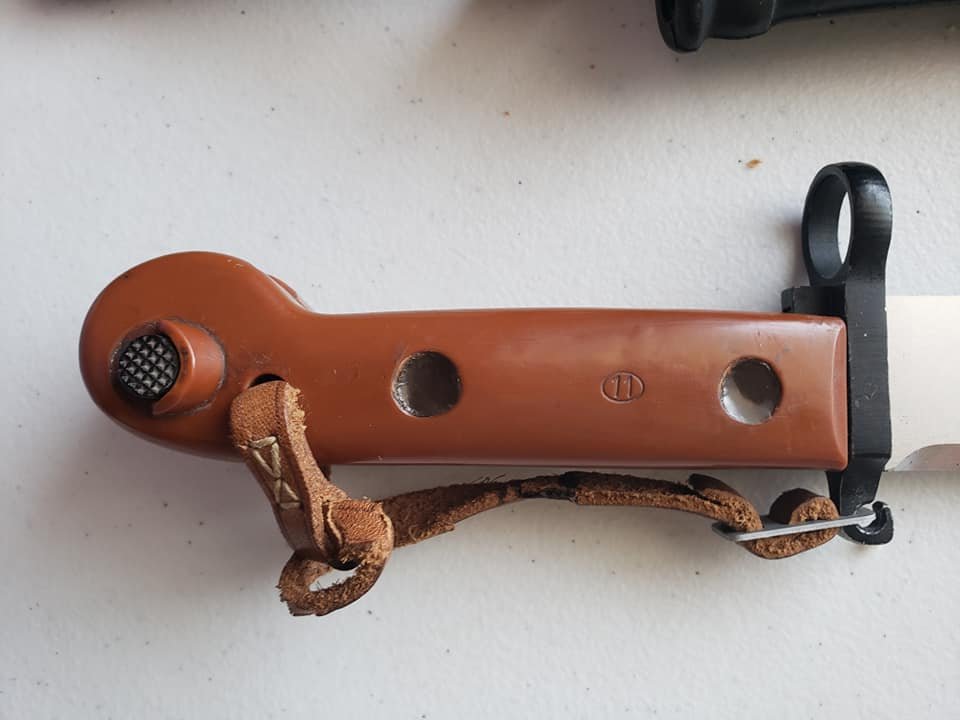

The Polish however I have only heard little about and I would be interested in hearing more about it. To me it appears to be out of a very small production run and if im correct its also marked with “11” on the grip. The same markings are found on the backside of Polish prototype 6x4 plastic scabbards, in the place where we have our usual “arrow in triangle”.

Yes, the Polish one has an 11 in oval arsenal mark on the right side grip panel. Mike

Although these German and Polish bayonets and scabbard appear different they do have something in common. The orange color of the grip panels may appear different in the picture. However, they are the same color and texture when compared. Perhaps the same material used to mold the grip panels?

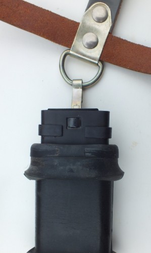

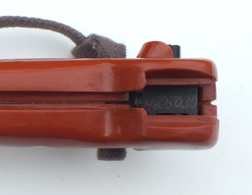

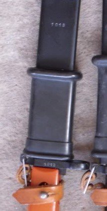

Below are more pictures of the DDR bayonet and scabbard. Both the bayonet and scabbard are in new condition. The bayonet has the standard hand etched inventory or issue number in the pommel mounting slot. The scabbard has no numbers.

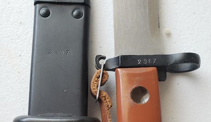

Here are pictures of a couple of the Polish versions of this bayonet and scabbard. Note that they are both in new condition with matching stamped numbers. How many were made?
