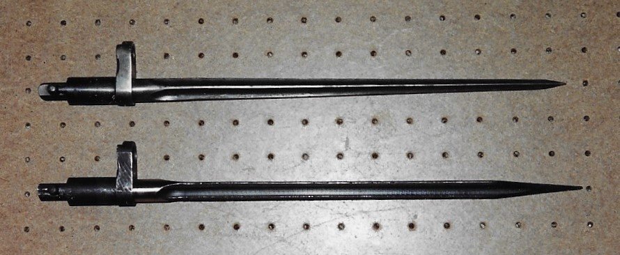

Postby NICO56 » Tue Sep 15, 2020 7:55 pm

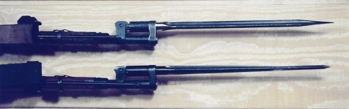

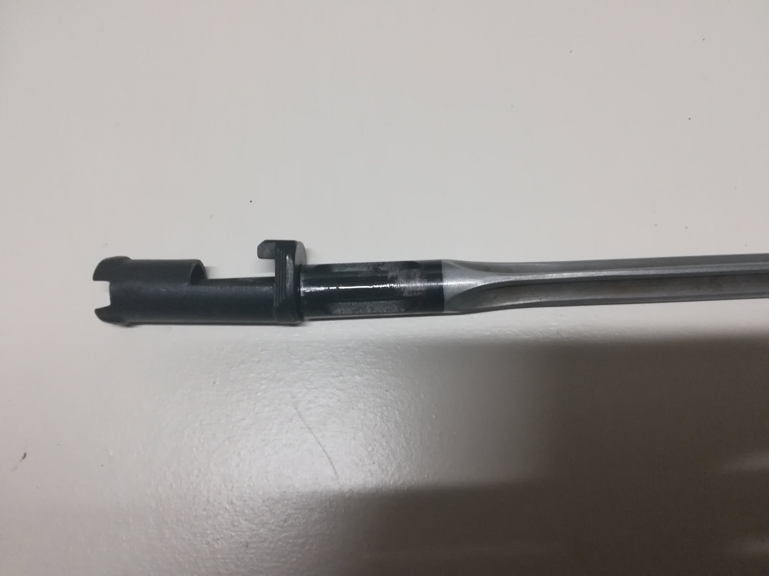

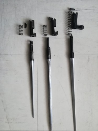

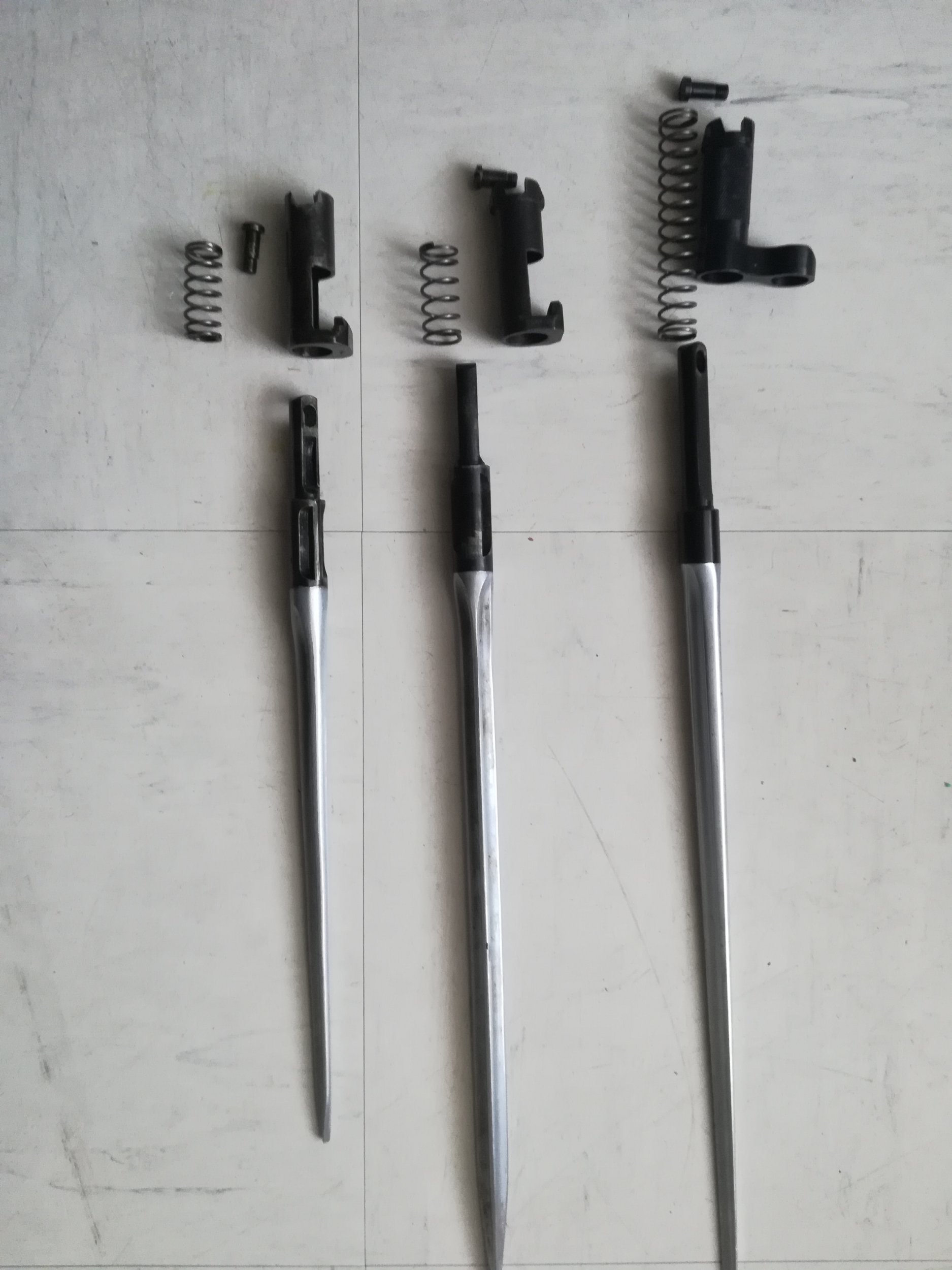

I present to you the bayonet of a little known rifle, type 63/68. This weapon is the cross of type 56 (SKS) and type 56 (AK). It looks like an SKS but its system is taken from that of the AK. It is therefore closer to a point seen technically closer to Ak than to SKS.
Its bayonet has a dimension close to that of the SKS but with an Ak type fixing.
The end is pointed unlike the other two bayonets

I found very few documents on this weapon. To tell the difference between a Chinese and an Albanian model will surely not be easy. What is certain is that my bayonet is identical to the one presented in this reference book
Re: Type 63/68
Postby Mr. B. » Wed Sep 16, 2020 10:06 pm
I also have that reference and I agree. It looks the same. I have seen Type 63/68 rifles in a collection, a military museum and various pictures. The ones I have seen all had bayonet blades that appeared to be similar to the ones on the Chinese Type 56 SKS rifles. I just assumed that they were all the same. Yours and the one above are the same and very different at the point. Interesting! Early vs late production? Mike

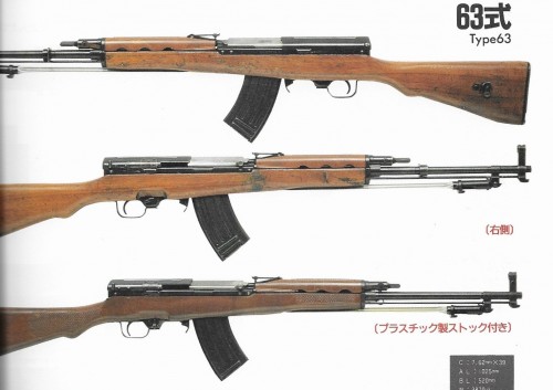

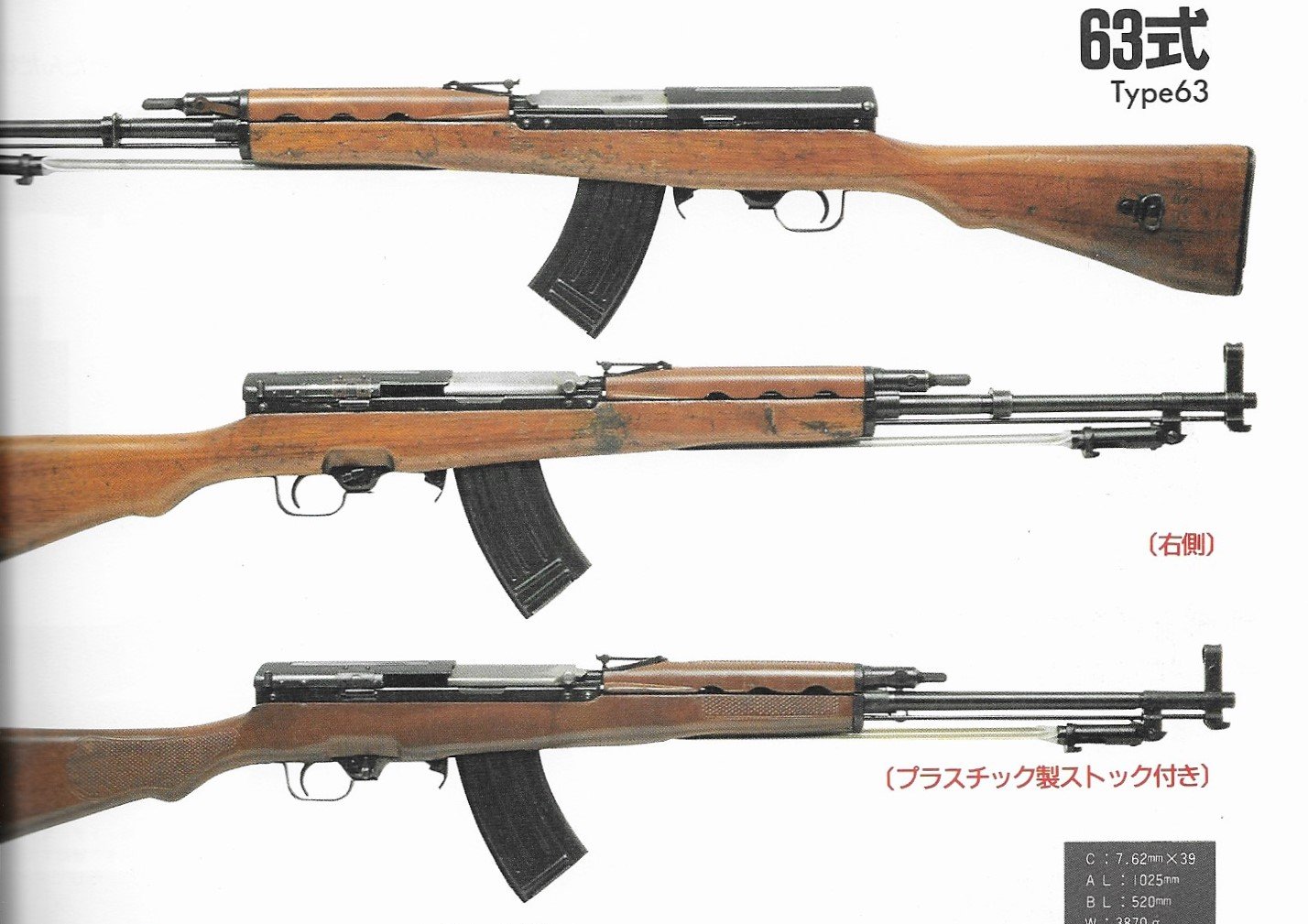

Here is a picture of the Chinese Type 63/68 rifle as a reference for those not familiar with this rifle. It was produced and used by the PLA from 1963-78 as a replacement for the Type 56 SKS rifle. It added the option of full auto fire and replaceable magazines. It was not intended as a replacement for the Type 56 (AKM). Mike

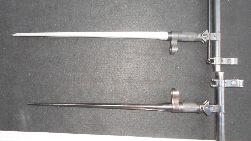

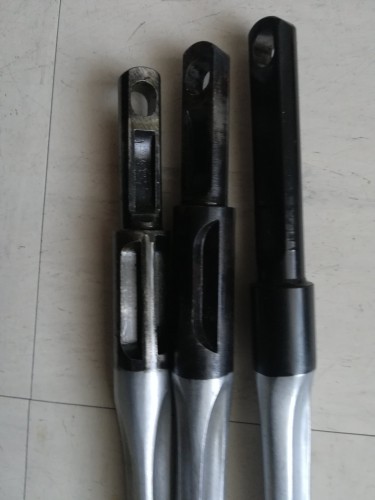

I have a question about the differences between the SKS, AK and Type 63 bayonets. Over the years I have owned several SKS rifles from various countries. Including both the blade and spike versions. I have also owned several Type 56 both AK and AKM versions with the folding spike bayonets. I had always wondered if the blades were interchangeable between the sliding hilts. They were not. The diameter of the round blade section where it meets the hilt are different sizes. The AK versions were on a smaller diameter.
I can not till from the pictures presented above. Is the Type 63/68 bayonet blade the same diameter as the SKS or the AK bayonet? The sliding hilt appears the same as the ones on an AK. is it the same internal diameter as an AK or SKS? Mike
Re: Type 63/68
Postby Mr. B. » Wed Sep 16, 2020 11:14 pm

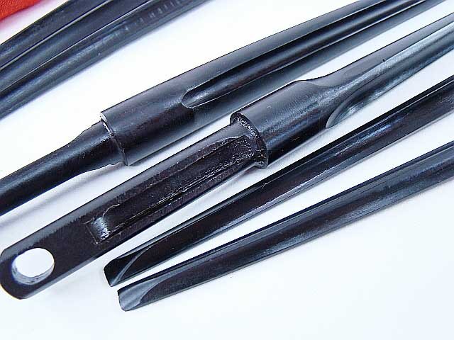

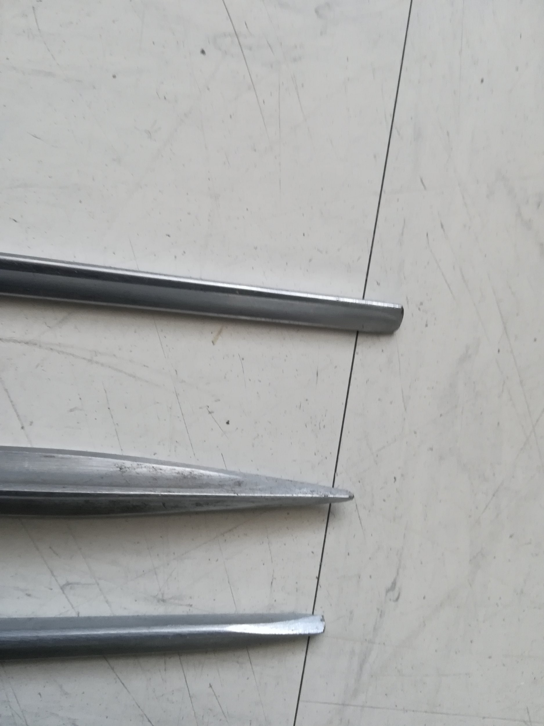

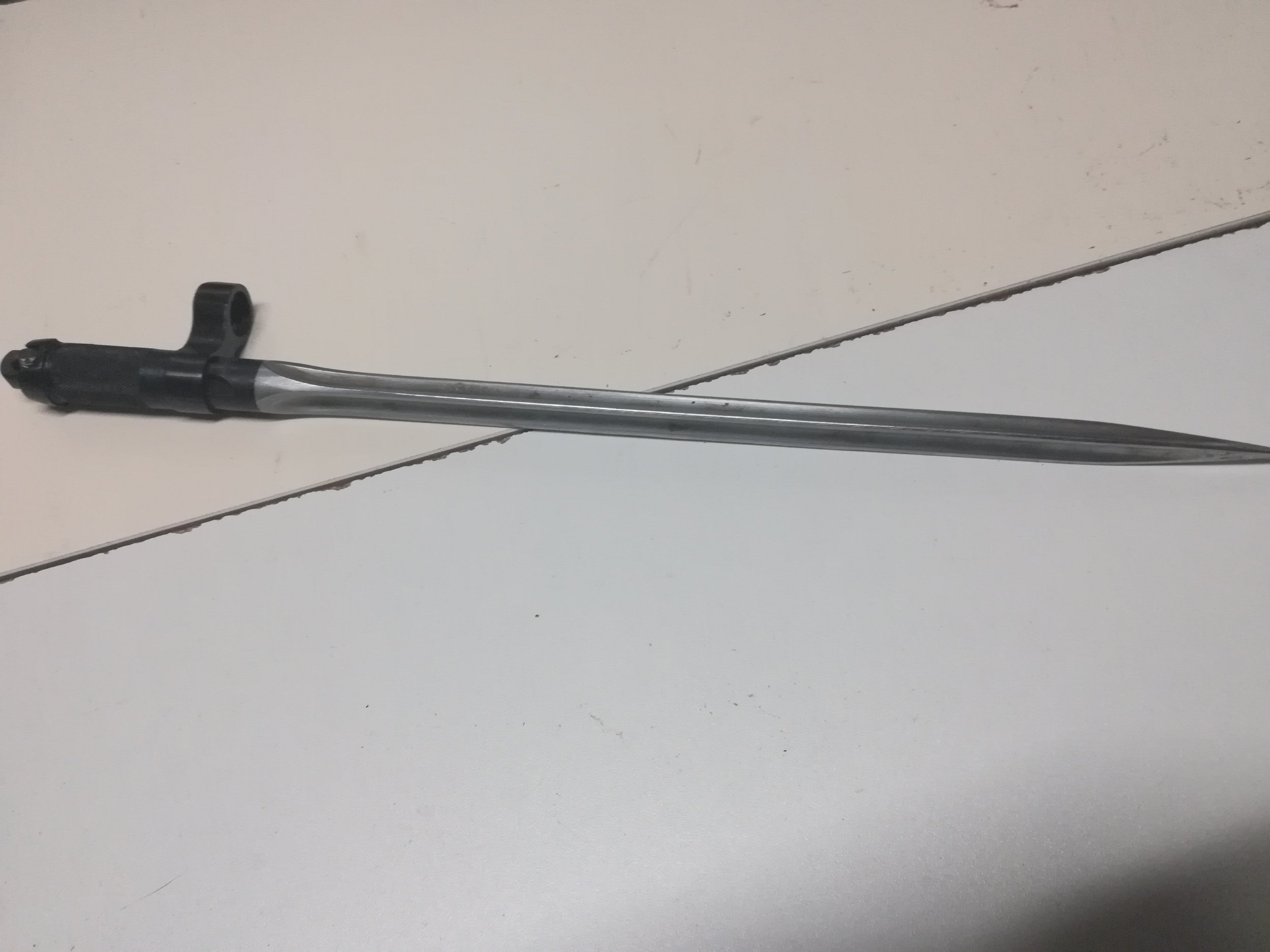

Here is an interesting reference for the unusual bayonet blade on the Type 63/68. The Type 56 (both AK and SKS) folding spike bayonets had the same general shape and appearance. The were triangular in section and had chisel, (screw driver), points. The Type 63 bayonet pictured at the start of this thread has a shape needle shape. There is a precedent for this blade size and shape from China. I acquired an Chinese Type 53 rifle, (Bolt action, 7.62 x 54r, carbine w/folding bayonet), with an unusual bayonet in Viet Nam. The usual ones were like all the other M44 carbines. They had a quadrangular section and a chisel point. This one had a triangular section and a very sharp point very similar to the Type 63 blade. Evidentially the Chinese had experimented with different blade shapes in the past.
Pictures from my previous collection comparing a standard Type 53 bayonet with the unusual sharp pointed ones. Mike

Postby NICO56 » Thu Sep 17, 2020 9:20 pm
The diameter of the bayonet type 63 is very close to that for SKS but much larger than that of the AK
Re: Type 63/68
Postby Mr. B. » Thu Sep 17, 2020 9:38 pm
Thank you. Great pictures and information. Just as I suspected. The AK is a smaller diameter blade and hilt than the SKS and Type 63/68 bayonets. I would also suspect that the early versions of the Type 63/68 would have used the same blade as a carry over from the Type 56 SKS. The sharper pointed blade would possibly be a later version. Or perhaps the Chinese version would have the original SKS blades and the export, (Albania and others), would have the different sharp pointed blades. ???? Maybe a way to tell them apart. ??? Mike

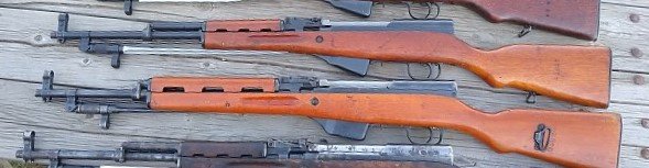

Here is some additional background information about Albanian rifles and bayonets. Albania originally imported SKS and AK rifles from China. As time went on they started manufacturing their own versions of these weapons. Here is the difference between the Chinese and Albanian SKS bayonets. Slightly different shapes, lengths and finishes. The Chinese one on top with the flat chrome finish and the Albanian with the blued/black finish below. Mike

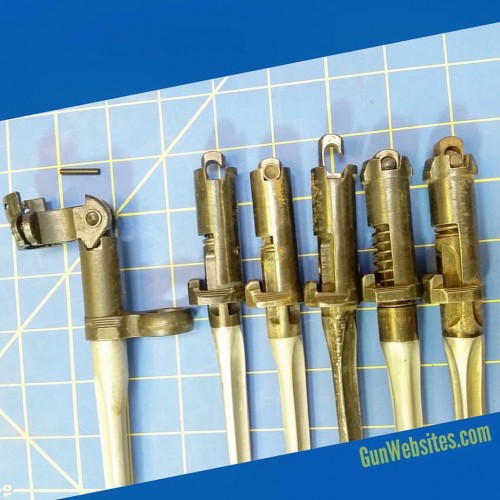

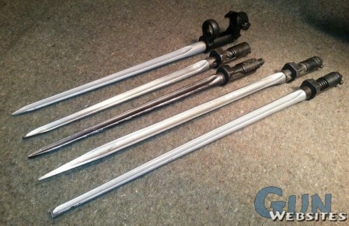

I also went back through my files and found this picture from Gun Websites. These were listed as different AK folding spike bayonets. I identified them as follows, (top to bottom). The top one is a Chinese bolt on conversion for AK and AKM rifles made without bayonets. The second one is a standard Type 56 for the AK and AKM rifles. The middle one is what I believe is an Albanian made copy of a Type 56 (AK AKM) bayonet with a blued / black finish. The forth one is what I believe is a late style of a Chinese Type 63/68 with the sharp pointed blade. The bottom one is the carry over or early style Chinese Type 63/68. Mike

Re: Type 63/68
Postby Mr. B. » Sun Sep 20, 2020 2:16 am
My apologies. I had reservations when I posted that first Gun Website picture. I had questions and concerns about what I could and could not see. After seeing that second Gun Website picture, my concerns were confirmed. Only the Type 63/68 on the right side is real and correct. The on a one on the left is a FAKE. It will not mount on any Type 63/68 or any other rifle. The sliding hit piece may be correct, but the blade appears to be from a Type 56 (SKS). The blade is not milled /cut to be able to engage the legs under the front sight base. There is no way to support or lock in place the front part of the bayonet. The spring is also too long and apparently from an SKS as well. It would also prevent the hilt from engaging the FSB legs and locking in place. The SKS bayonet is designed to be mounted and locked in place using a muzzle ring like the clamp on AK bayonet on the far left.
There are also discrepancies on two of the Type 56 (AK-AKM) bayonets pictures. The one with the black blade is also a FAKE.
