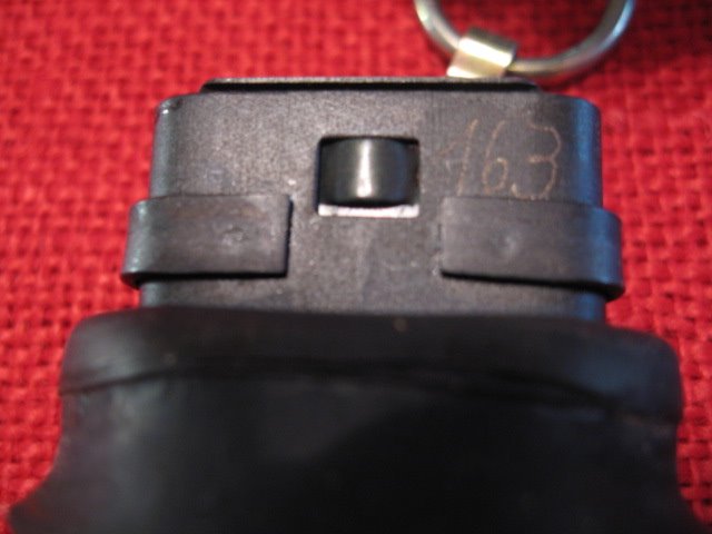

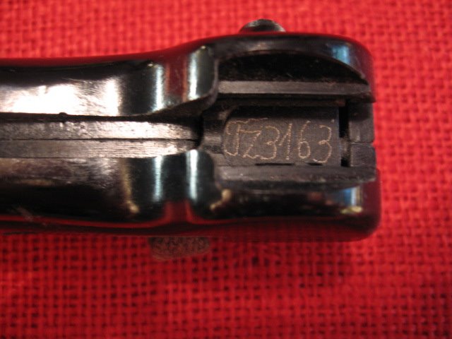

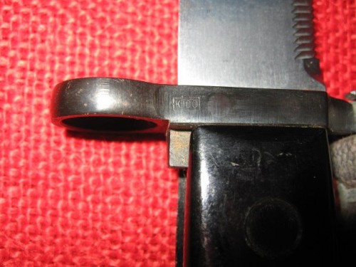

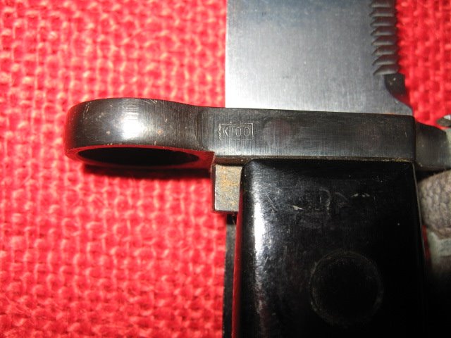

I will verify that it is a legit East German, (DDR), AKM 6X3 type I bayonet and scabbard. It is a later issue and most common Type I before they went to the Type II scabbard. Your rubber insulator is a later issue 5998 followed by a dot. The earlier ones did not have the dot, they are different. The bayonet serial number is in the mounting groove on the pommel. The painted 6 or 9 on the pommel is none-standard personal, rack, or unit number. The "N" and "Z" are assembly proof marks. The "K5" in the rectangle on the cross guard is the manufactures mark. They were manufactured by several different companies. The "B" and "E" on the scabbard and cutter plate are also assembly proof marks. The scabbards are usually marked with the last three digits of the bayonet serial numbers. They are hand etched on the top front of the scabbard body hidden from view by the rubber insulator. Yes, they should be matching if possible. Below are pictures of a similar bayonet & scabbard from my collection. Hope this answers your questions. Mike

Just one quick follow-up question: Is it possible that the scabbards were sometimes not electropenciled with the serial number? I didn't not remove the insulator, however I looked on both sides and on the upper an lower "lip", but no electropenciled number.

The Germans were very consistent in their markings. When a bayonet and scabbard where issued they were both numbered to a rifle. The placement and style of numbering was usually the same. A scabbard without a number could be a replacement for a damaged or missing scabbard. If this was an official DDR replacement though it would have been numbered. However lots of new un-numbered scabbards were available after the DDR collapsed and were sold along with the bayonets and used by several other countries. The scabbard could have been replaced at any point. Mike
