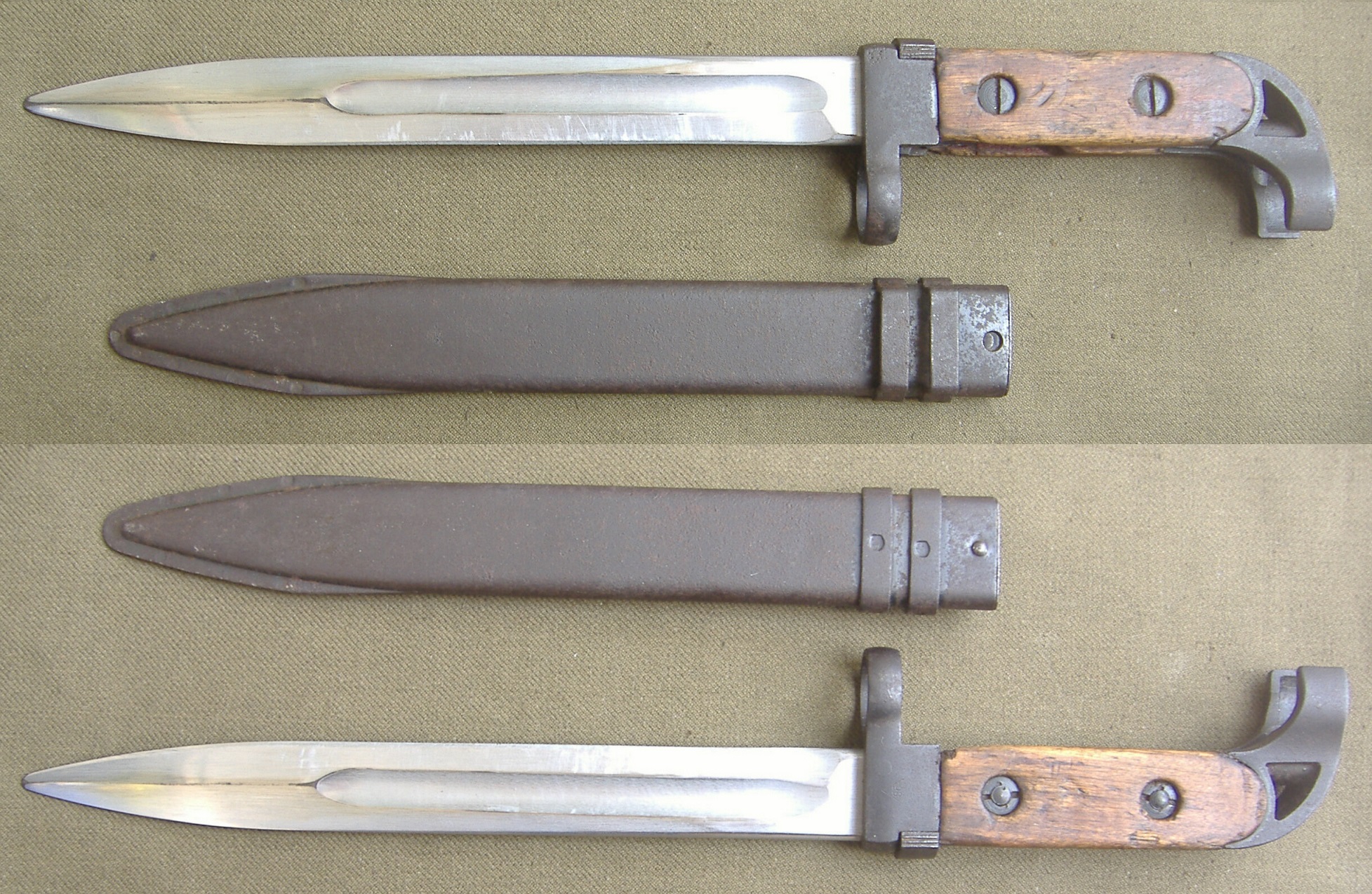

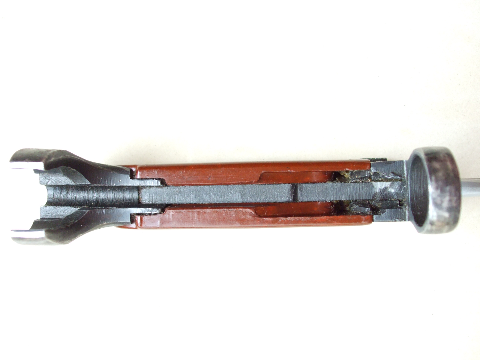

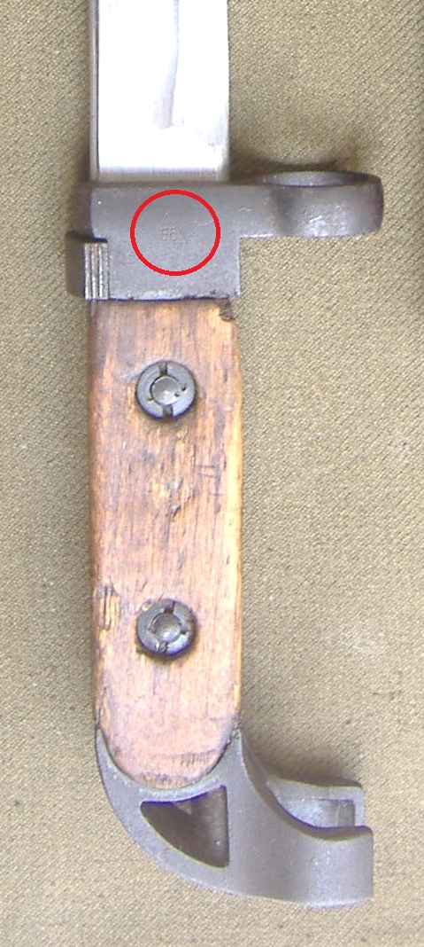

One of these AK47 bayonets was pictured on another site recently. It was identified as being Chinese manufactured and issued. I found no reference to them in my Chinese PLA military research. I dug through my other references and found the second picture. Does anyone have one of these bayonets or any information about them? They would make an interesting topic for pictures and details here. It would be interesting to see more detailed pictures including the scabbards and hangers. I have discussed them with several collector and heard several theories. Chinese, North Korean, Indian, Pakistani or ????? Commercial, contract, military, fakes, reproduction or copies ?????? MIke

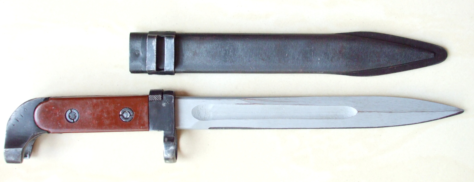

I have examined the few pictures that are available and discussed this bayonet and scabbard with a couple collectors from Europe and Asia that own them. Both of these samples supposedly came from China. The question is who made them and how did they get there. China may have imported small quantities of Russian AK47 rifles and bayonets along with the machinery and a license to build them. However, as they started production of their version, the Type 56, they went with the attached folding spike bayonet and supposedly never produced or issued a blade bayonet. No evidence exists indicating that the Chinese ever purchased the machinery or manufactured a traditional flat blade AK47 bayonet. One would also assume that any AK47 rifles and bayonets imported from Russia or any other ComBloc county would have had that countries markings. For example the Russian marks found on the Finnish, early East German and Bulgarian AK47 bayonets and parts.
The two bayonets with the swastikas appear to be quite similar in materials and manufacture/assembly and are the same pattern as the European versions. They both have reddish colored molded plastic(?) grip panels, natural finished blades and blued metal hilts. The machining, fit and finish of the metal parts, is somewhat crude compared to other manufactures. Neither scabbard sample has a hanger attached, but both are conventional flattened or folded tube crimped on the end with a one piece flat metal hanger bar spot welded in place. This hanger bar almost meets on the front side.

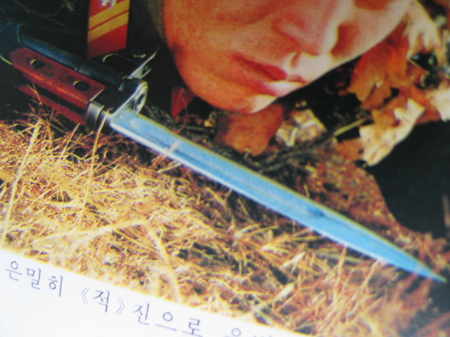

It is my observation the these bayonets and scabbards bare a strong resemblance to the North Korean AK47 bayonets in my collection. Could they have been made in North Korea, possibly for export or contact sales to other countries or fractions? Pictures to follow. Mike

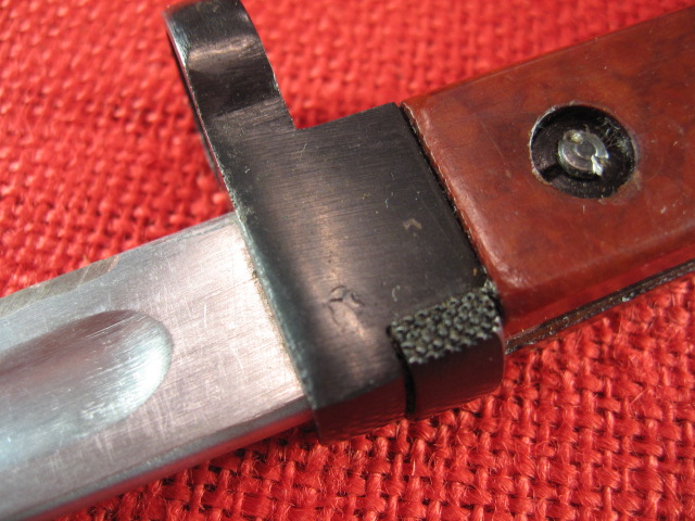

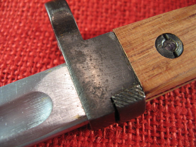

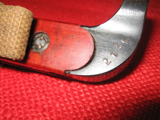

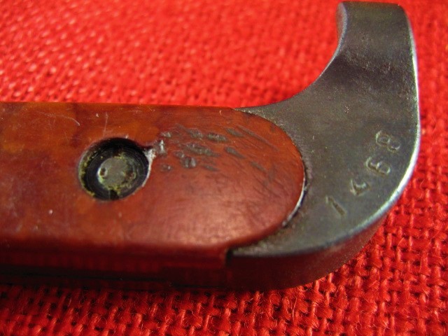

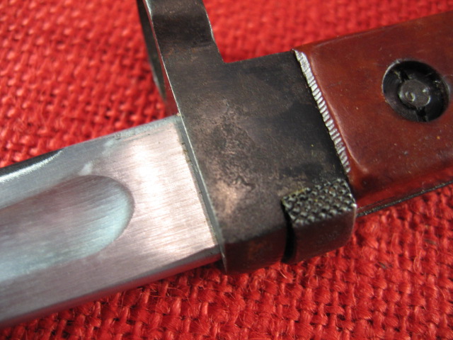

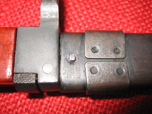

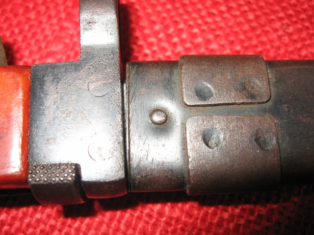

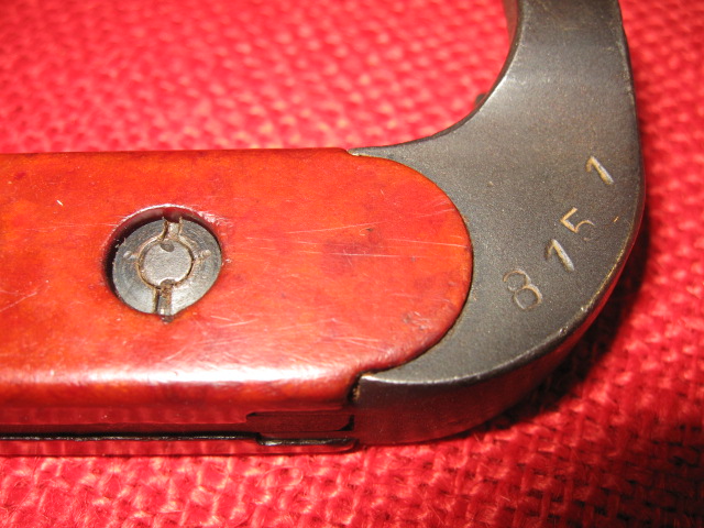

Below are pictures of North Korean AK47 bayonets and scabbards showing similarities with the unknown Chinese(?) bayonets with the swastikas. Size, orientation and position of the stamped star on the left side of the cross guard. The stamped four digit block numbers at an angle on the left side of the pommel. The color and attachment of the grip panels. The size, shape and attachment of the scabbard hanger bar. Is it possible they were made in North Korea for export or contract sales to other Asian countries?
Keep in mind that the Chinese did manufacture a copy of the AK47 bayonet and scabbard to export with the civilian export AK47 rifles during the 1980s. However these bayonets were in my opinion much better made and finished and do not resemble the swastika bayonets. I am also reminded that in the past few years hand made copies of AK47 bayonets have appeared on the market from not only China, but also India, Pakistan, (Kyber?), and possibly other countries in eastern Asia. Let us not forget about the AK47 bayonets from Indonesia. Does anyone else have any information, ideas, opinions about the swastika bayonets? Mike
Re: AK47 Bayonet with swastika mark ?
Continued North Korean AK47 bayonet and scabbard pictures for comparison. Mike

My apologizes MDI. Your reply was posted in the middle of my rant. I agree with the North Korean assessment. It would be nice to see more detailed pictures of the swastika bayonets and scabbards for more identifying details. Possible unseen or hidden markings. scabbard construction and drain hole. Also I do not see a rivet/attachment for a scabbard drag? Construction/assembly details from all angles would certainly help. One strange thing I noticed is that both of the two samples appear to be in VG/EXC condition with little if any wear, but yet neither one has a hanger, which were usually permanently attached. For some reason I keep thinking of the hand made copies/fakes that were on eBay a few years ago. However both owners are knowledgeable collectors and claim they came from reliable sources in China. Mike

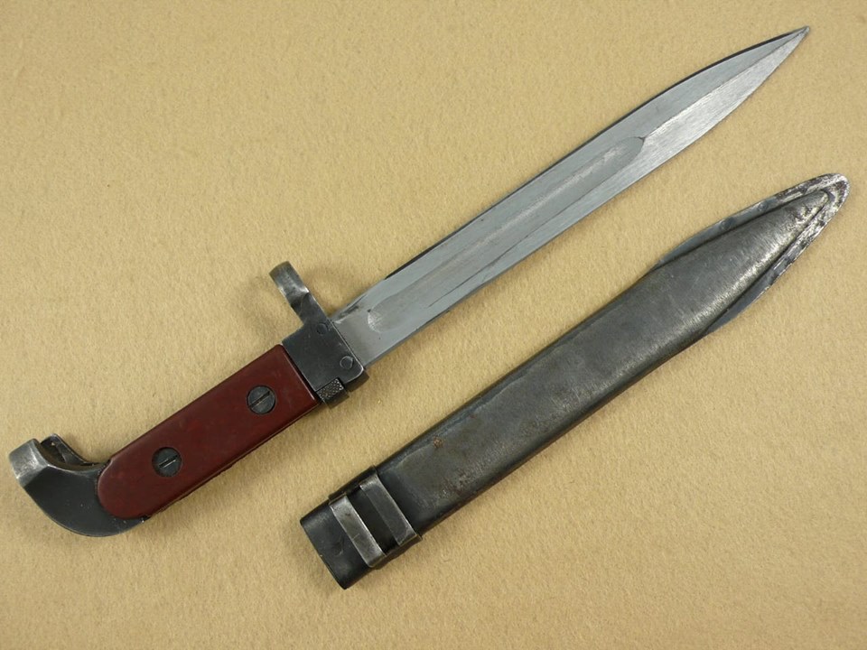

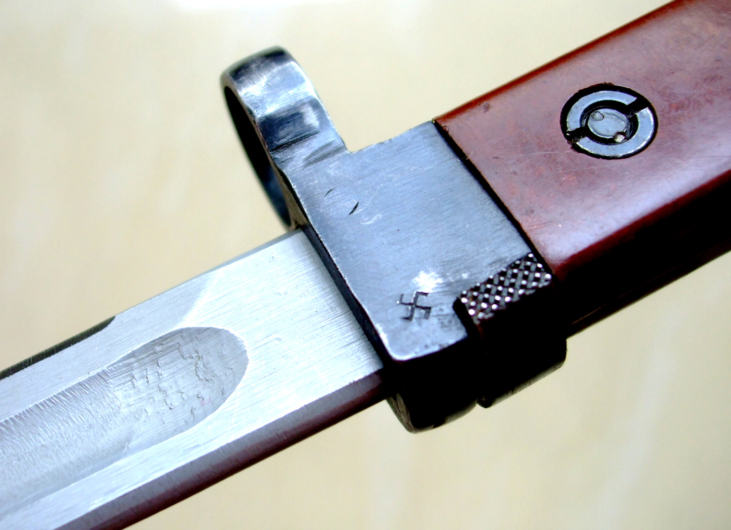

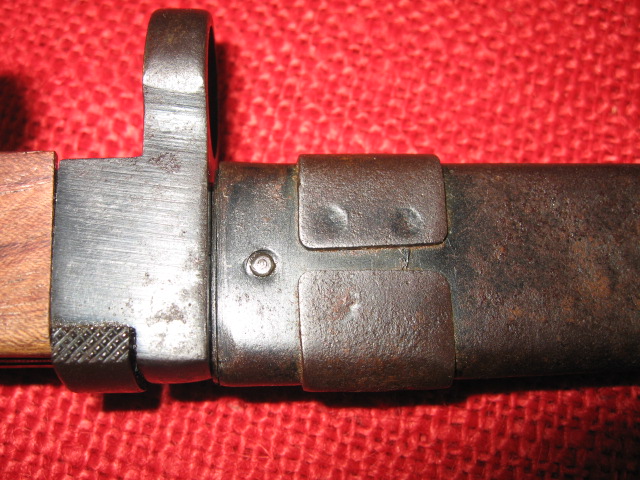

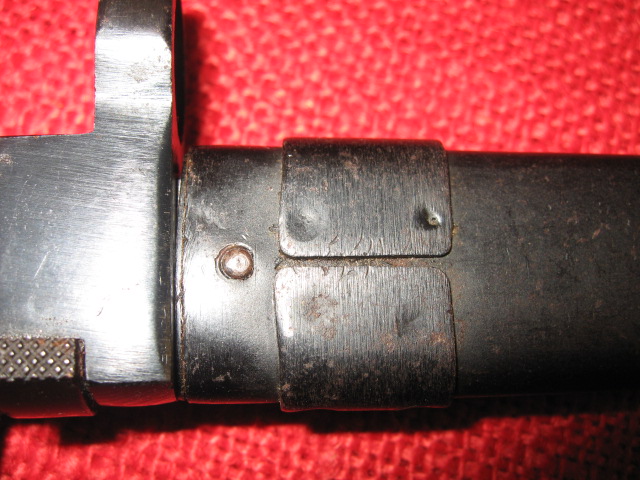

Here is a better picture of one of the swastika bayonets and scabbards. It goes with the closeup picture of the marking that is roughly stamped on the cross guard retaining pin/rivet. Note that due to the heavy marking stamp on the pin/rivet, that it has been driven out of position on the opposite side and protrudes slightly. I wonder why they would choose that position to stamp a marking after grinding the pins/rivets flush. Perhaps the swastika stamp was applied as an after thought at some point in time after it was made? Mike
Another note: If there is a drain hole on the scabbard it must be on the unseen front side of the scabbard. The North Korean ones have the drain hole on the back side. Mike

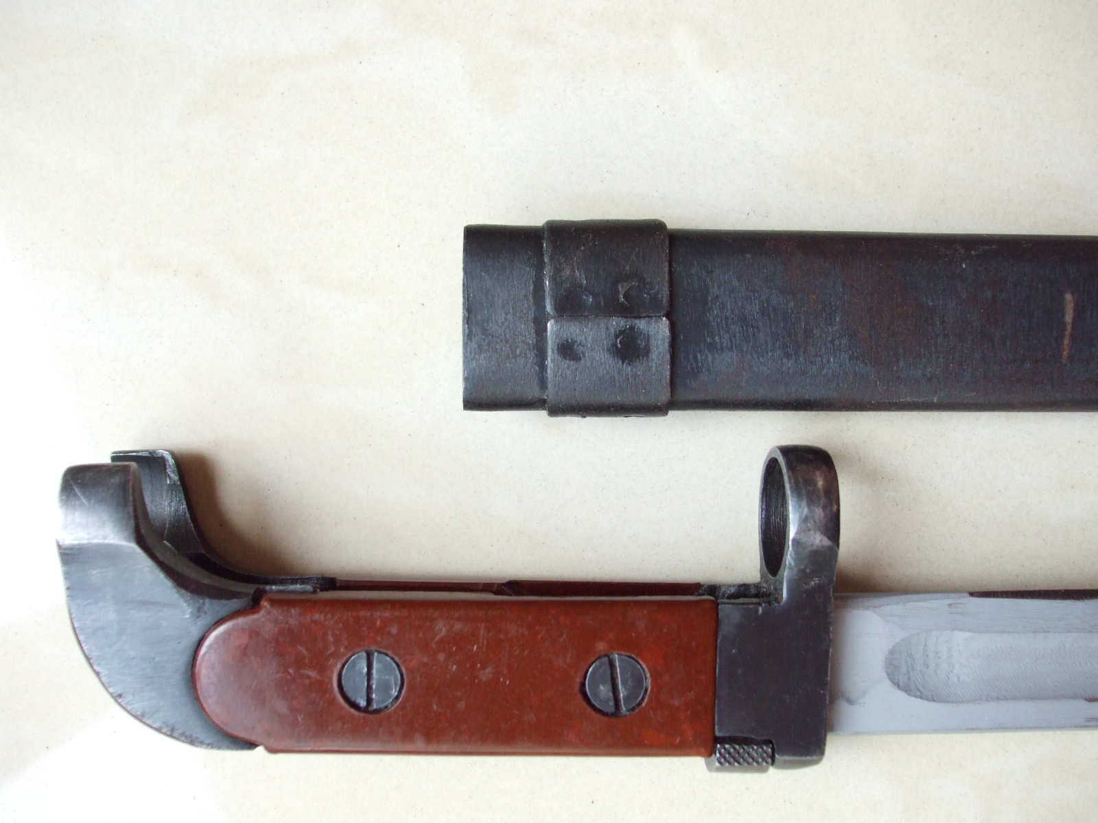

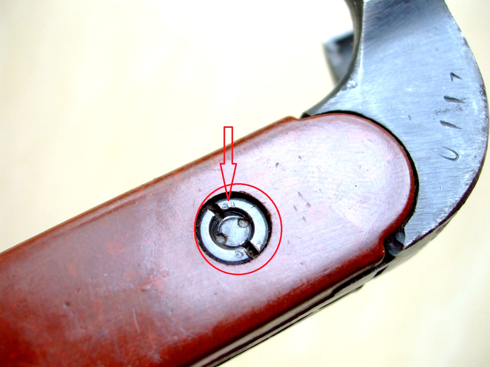

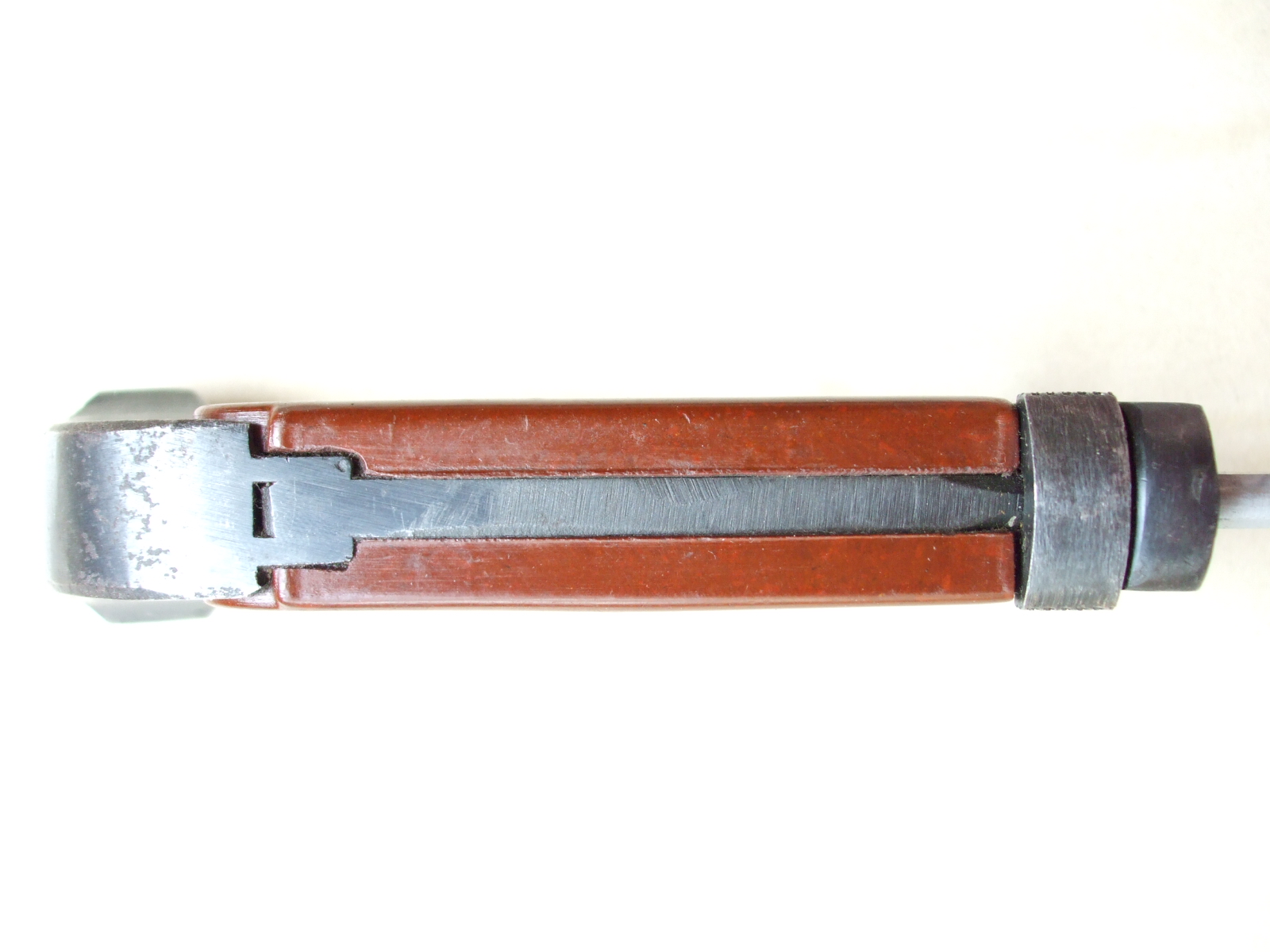

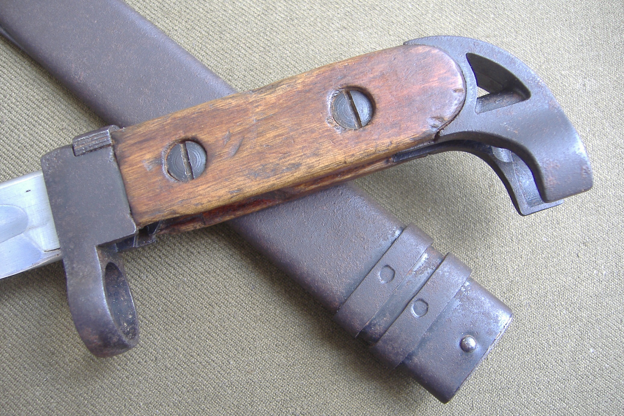

I show a variant of the Ch. M.47 bayonet, which was also brought by a friend from China.
Ich zeige noch eine Variante des Ch. M.47 Bajonett das ebenfalls von einen Freund aus China mitgebracht wurde.
Gerhard
Gerhard
