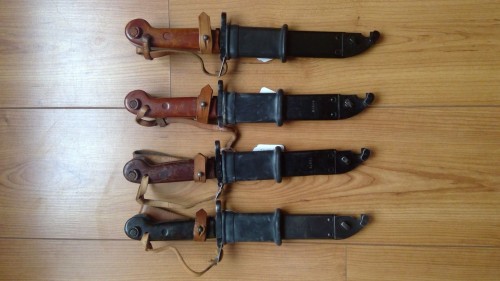

Once again, an excellent tutorial.
So, from what I have read, the black and dark brown grip 6H3's in my collection would be the early production and the light brown grip 6H3's are the later production?

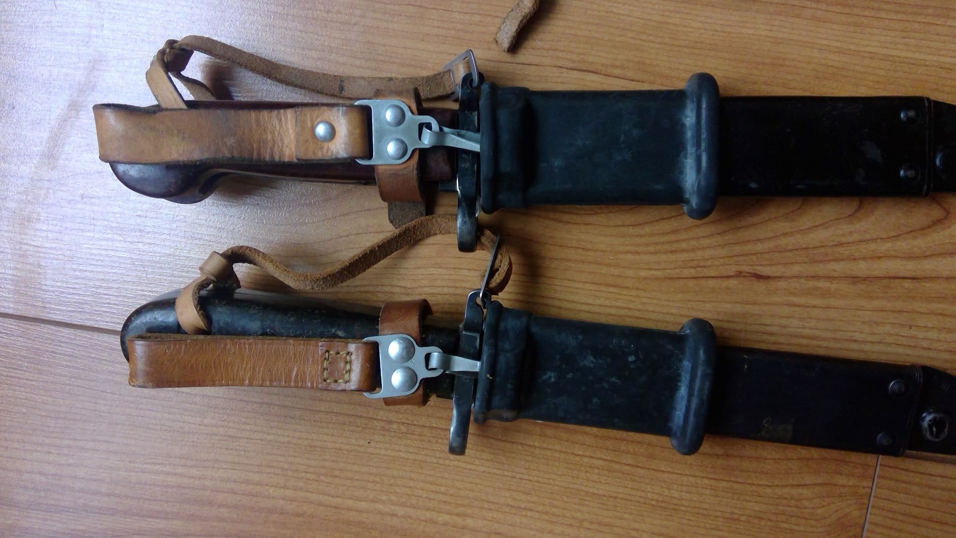

The black grip 6H3 also has the sewn version of the hanger rather than the riveted.
One of the light brown grip 6H3's does not have a serial number, all the others have matching five digit serial numbers.
Thank you all once again.

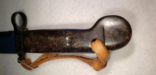

As a result of my recent research involving Polish AK bayonet and scabbard production I re-examined Gerhard's post and pictures above. In combination with the translated information from several references, I decided to re-evaluate the AKM 6H3 bayonets in my collection. These bayonets were only made under license from Russia for approximately 4 years, (1968 - 72). The only major variation was in the materials and colors of the molded grip panels. Originally Poland decided to use their own material known as "Modofen". This was a thermosetting plastic which required the use of a filler, (cotton fiber?), to be added. I have been unable to confirm which colors and combination of fillers were first used or how long the Modofen was used. At some point in time Poland switched to using the Russian supplied AG-4W material to replace the Modofen. This changed the color and appearance of the grips, eliminating the visible filler material. Below are close-up pictures of my 6 bayonets showing the visual differences. The order and differences have no real distinction, just differences in production and materials. I tried to post them from what I consider early to late, but with no actual confirmation. Mike
Re: Polish 6h3 "Type I" Handles

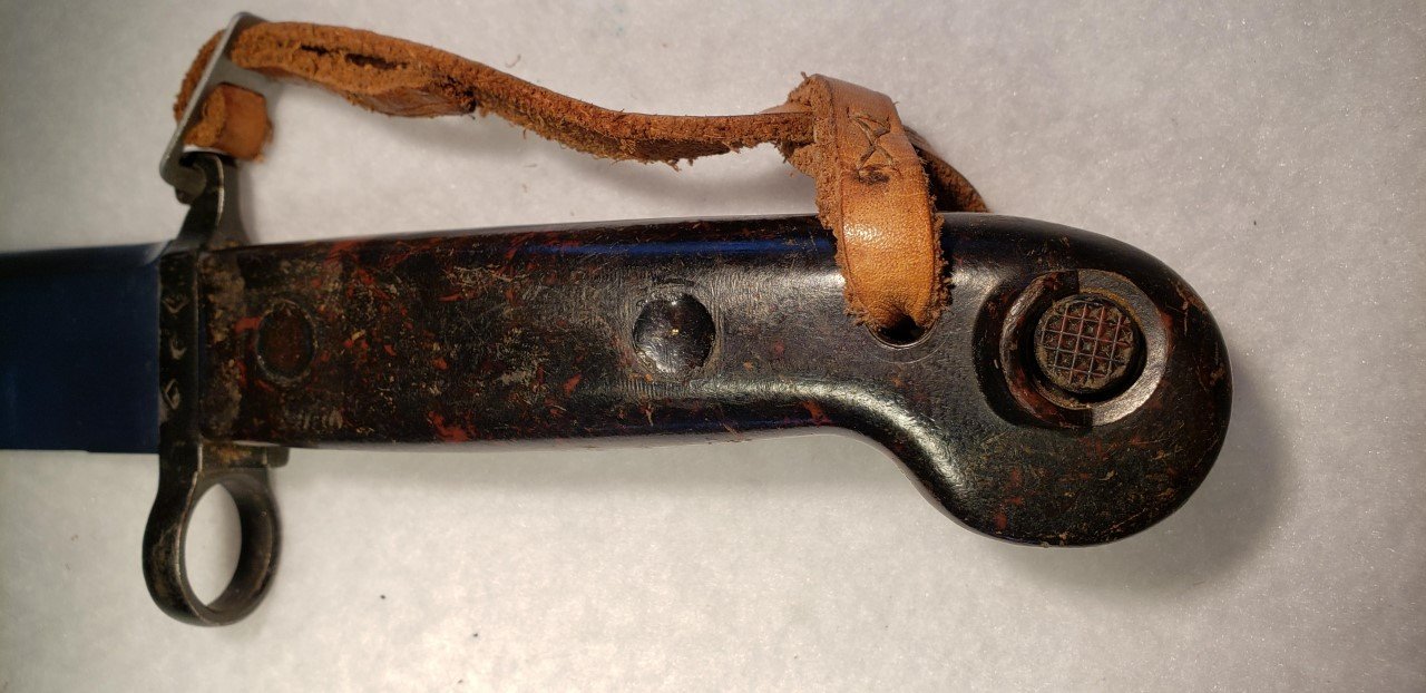

Here are the Polish AKM 6H3 bayonets from my collection. As a note, the earliest examples have been found with blued finished scabbards. Later scabbards were painted black similar to the Russian 6X3 production. I have an early blued scabbard, but unfortunately it came with a miss-matched bayonet. This makes the bayonet age undeterminable.
The first bayonet below is what is considered to be the first variation. The grips appear near black with red flakes. Closer examination shows more of a transparent material, (Modofen), with embedded reddish colored fabric filler. Mike

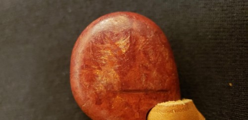

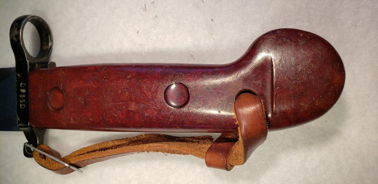

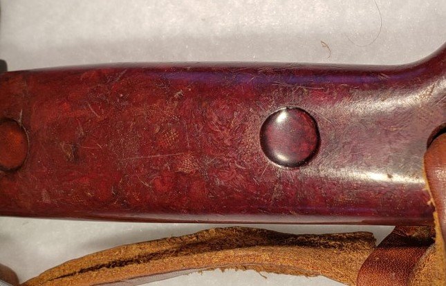

Here is the second variation in my collection. The grips appear to be a dark reddish brown material, (Modofen). The visible fabric filler material also appears to be reddish in color. Mike

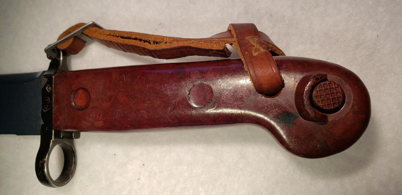

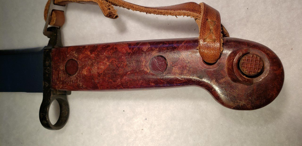

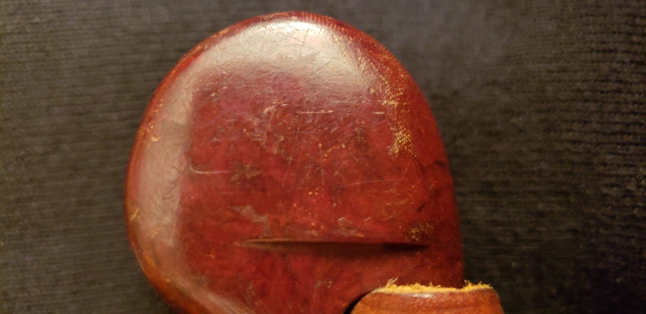

Here is the third bayonet from my collection. This is the one with the miss-matched blued scabbard. It is possible that this may be the earliest/rarest bayonet because of the scabbard, the stitched dark hanger and Gerhard's comments in the previous posts. It has grips that appear dark brown transparent material, (Modofen), with lighter colored fabric filler material. Mike

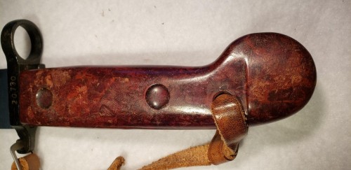

This is the forth bayonet from my collection. I am unsure what the grip material is, Modofen or AG-4? In my opinion I believe it is still reddish orange transparent Modofen. However it has a different filler material. It is lighter colored and much coarser/chopped. I presents the appearance of being larger solid pieces embedded. It is not "marbled" as usually seen with AG-4 material. Mike

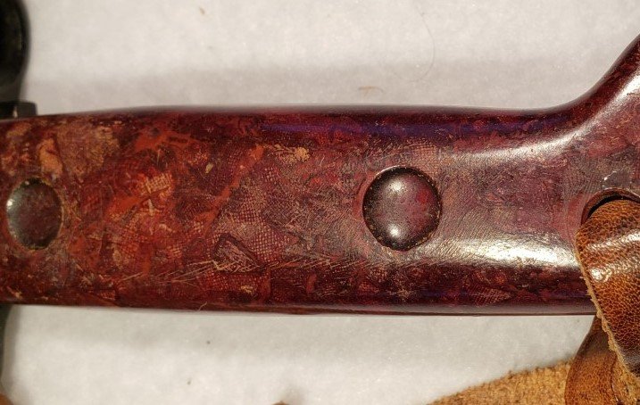

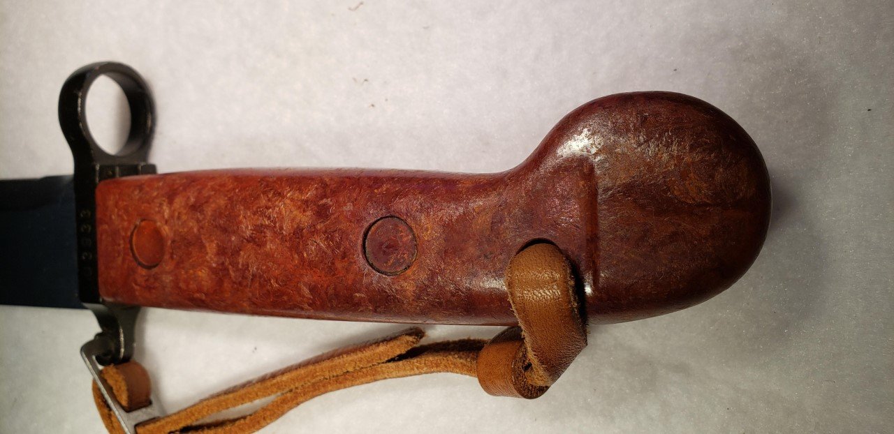

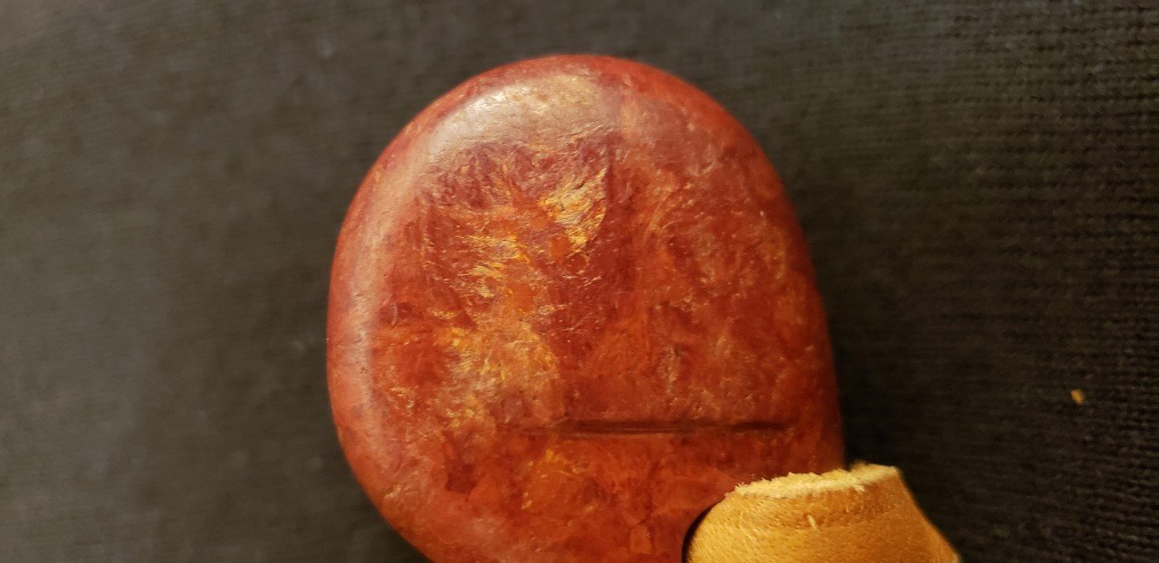

Here is the fifth bayonet from my collection. This grips on this one appear to be AG-4 material. It has a solid marbled appearance where the colors blends/flows during the molding process. It is the same appearance as the the Russian and Bulgarian bayonets and scabbards using AG-4. This represents late 6H3 production and carries over into the molding of 6H4 hilts starting in 1972. Mike

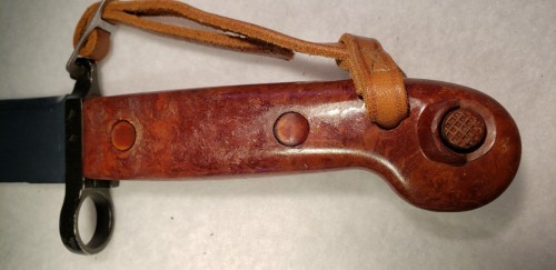

This is the sixth, and last example from my collection. It is very similar to the last one and appears to be molded from AG-4 material. It shows the different marbled appearance of the molding. It appears that the dyes/coloring used with the AG-4 base material do not fully blend as it is heated to be injected into the molds. These last two bayonets and scabbards are un-numbered and in unissued/like new condition. Possibly un-needed late production and replaced by 6H4 bayonets. As a side note the change from 6H3 to 6H4 involved only the bayonets, the scabbards straps and hangers remained the same. The earliest 6H4 production even carried over the 5 digit numbers from the 6H3. Mike

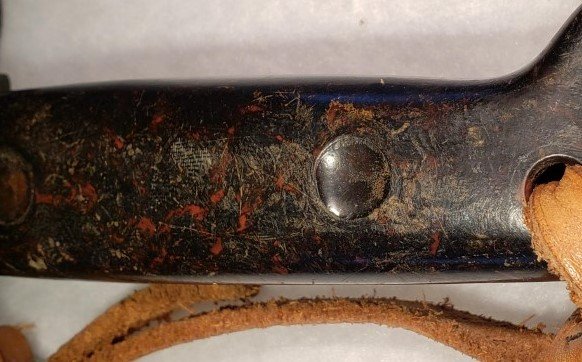

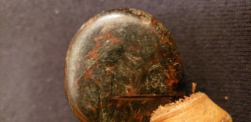

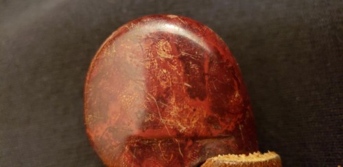

Here are enlarged pictures of the first three bayonets above. I believe these three are molded of Modofen plastic and have visible fabric filler. This filler is apparently small pieces of light colored woven fabric, (cotton according to one reverence). Below are samples of Black, Dark Reddish brown and Dark Brown. The fabric pieces are most visible in these pictures in the center area of the grips. It is difficult to get the lighting and angles just right for the pictures. Mike

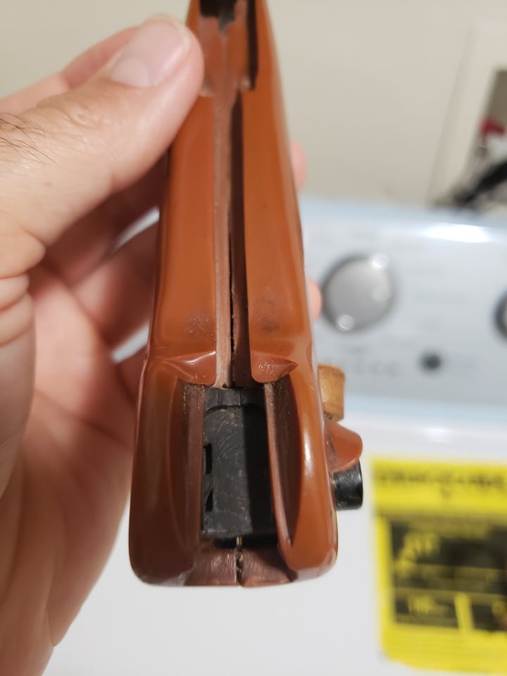

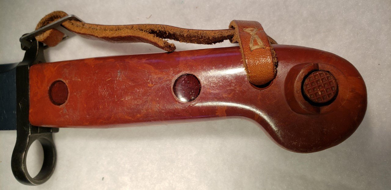

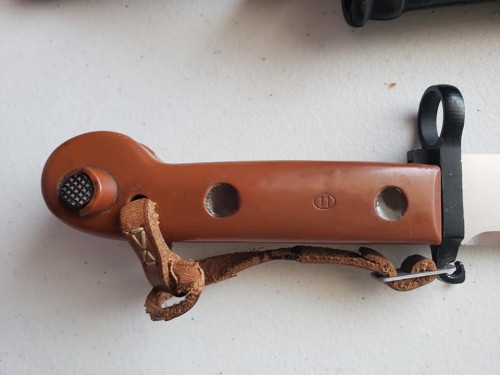

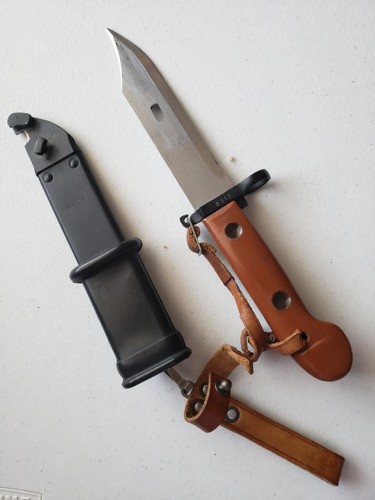

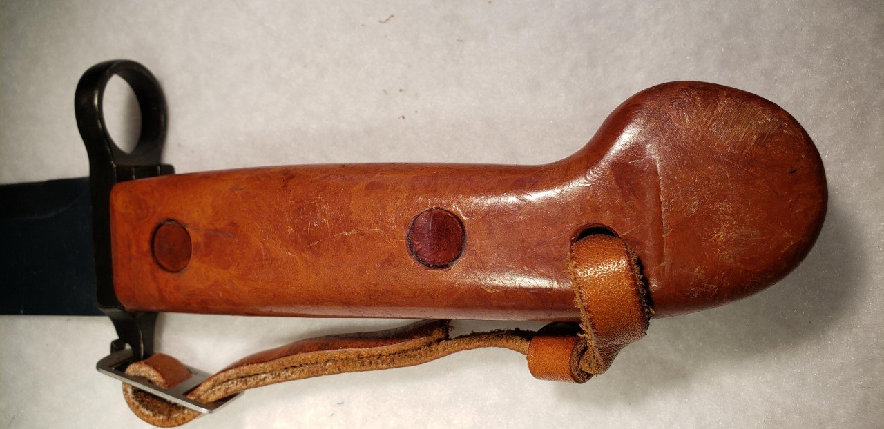

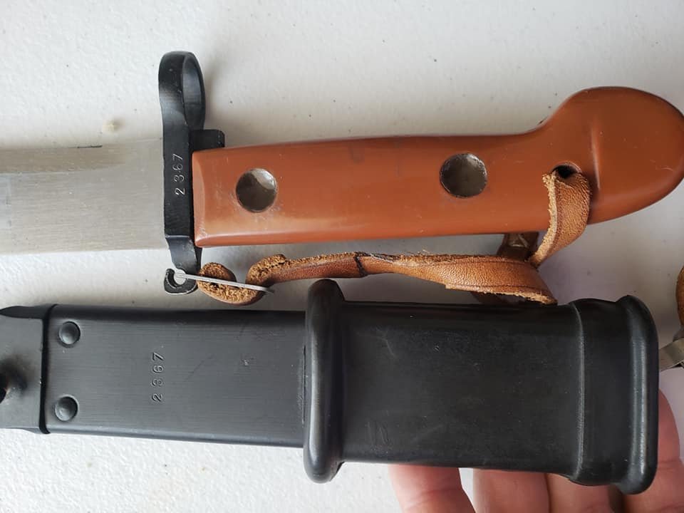

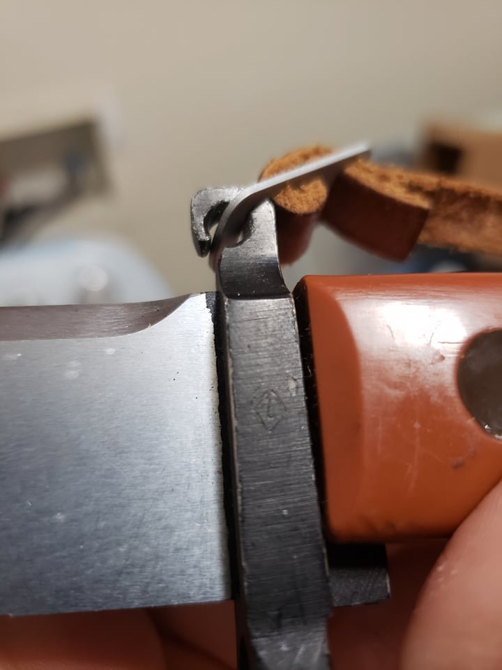

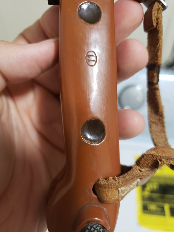

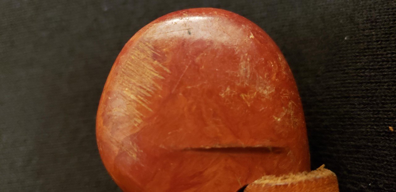

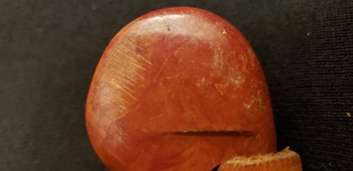

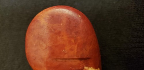

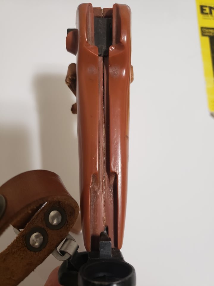

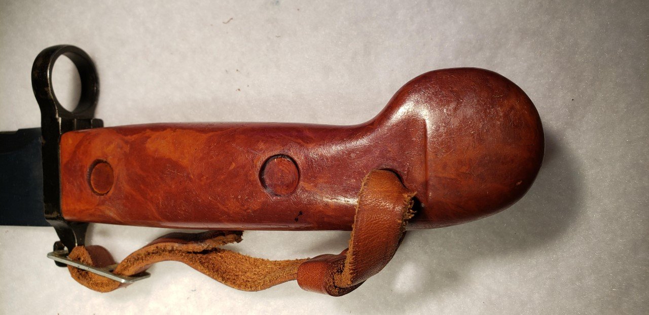

Here are better pictures of one of the Polish AKM 6H3 Type I bayonet and scabbard in the 1st post on this subject. I have also heard that the solid orange grips are from being replace during rework. The pictures below were posted today on an AK Bayonet Collector FB page. (Thanks, C.H.).
Both the orange handled bayonet at the start of this post and the one below seem to be like new with original matching numbers. Hard to believe that they are reworked in any way. Note both sets of numbers are low, 1013 and 2367. I have 4 Polish reference books and none of them refer to these orange arsenal, (oval 11), marked grip panels.
I have seen other pictures and information about these grip panels in various places. I, as well as others, believe that Poland was experimenting with different materials to mold the grips. They started with Modofen, (Duroplast) with filler material and the switched to the Russian AG-4W which was solid with a marble appearance. The grips below appear to be a solid smooth plastic material made for testing as prototypes and possible issue for field testing. Never adopted, replaced by the other materials or the new 6H4 bayonets.
Does anyone else have one of these or any information about them?

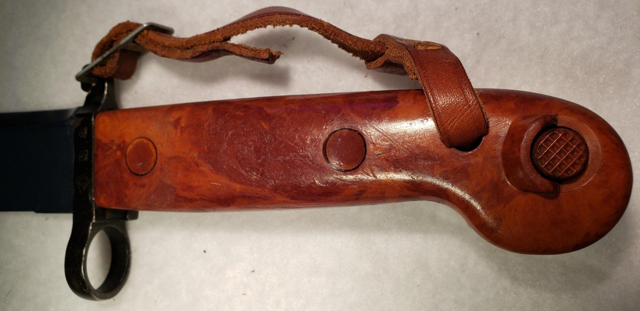

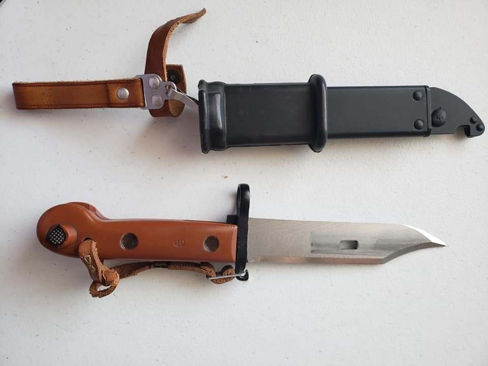

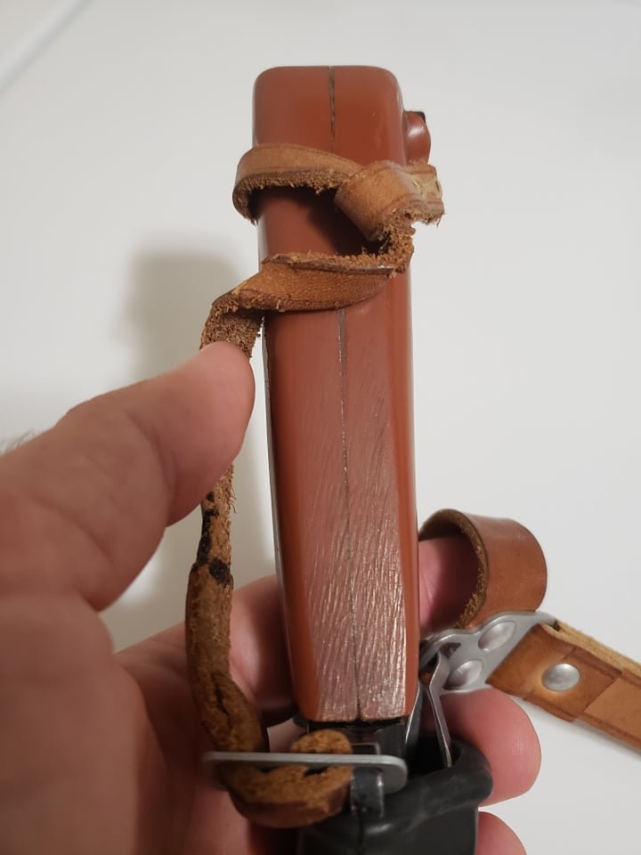

Here are a few more pictures of the experimental orange handled bayonet. Mike
Polish AKM 6H3 Type 1 Orange Circle 11 6.jpg (43.95 KiB) Viewed 23371 times
