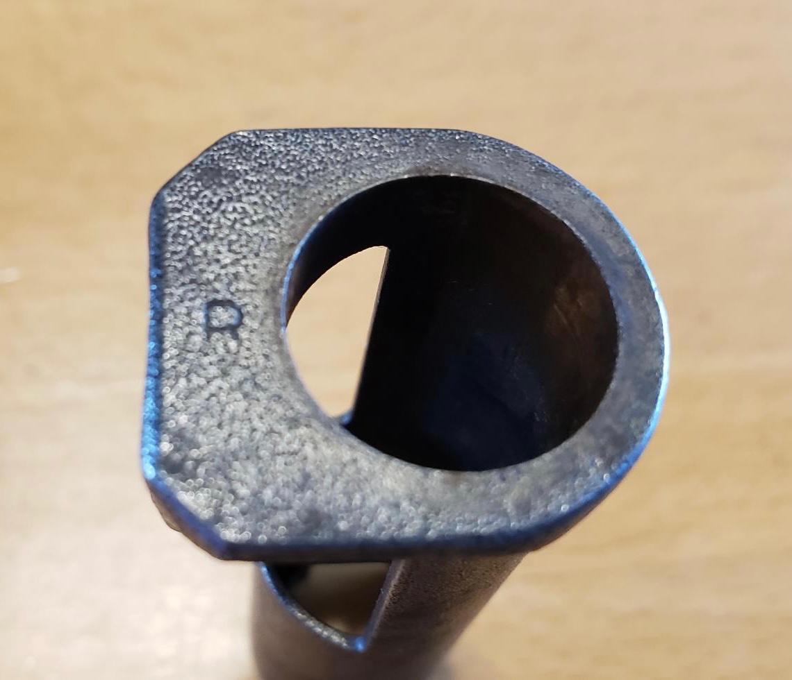

I directed him to the topic on our Forum and then asked what identified one as Albanian. He replied that he had read in reference books that there was a letter “R” marked on the locking part.

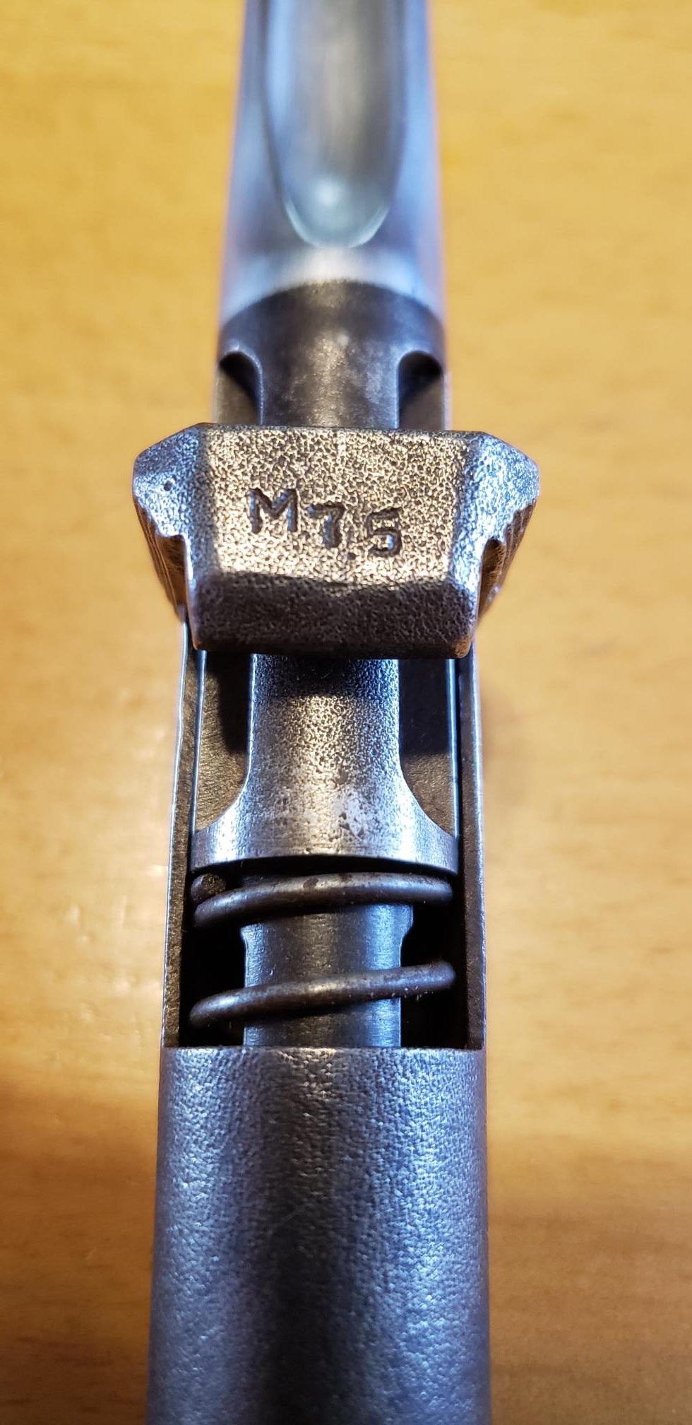

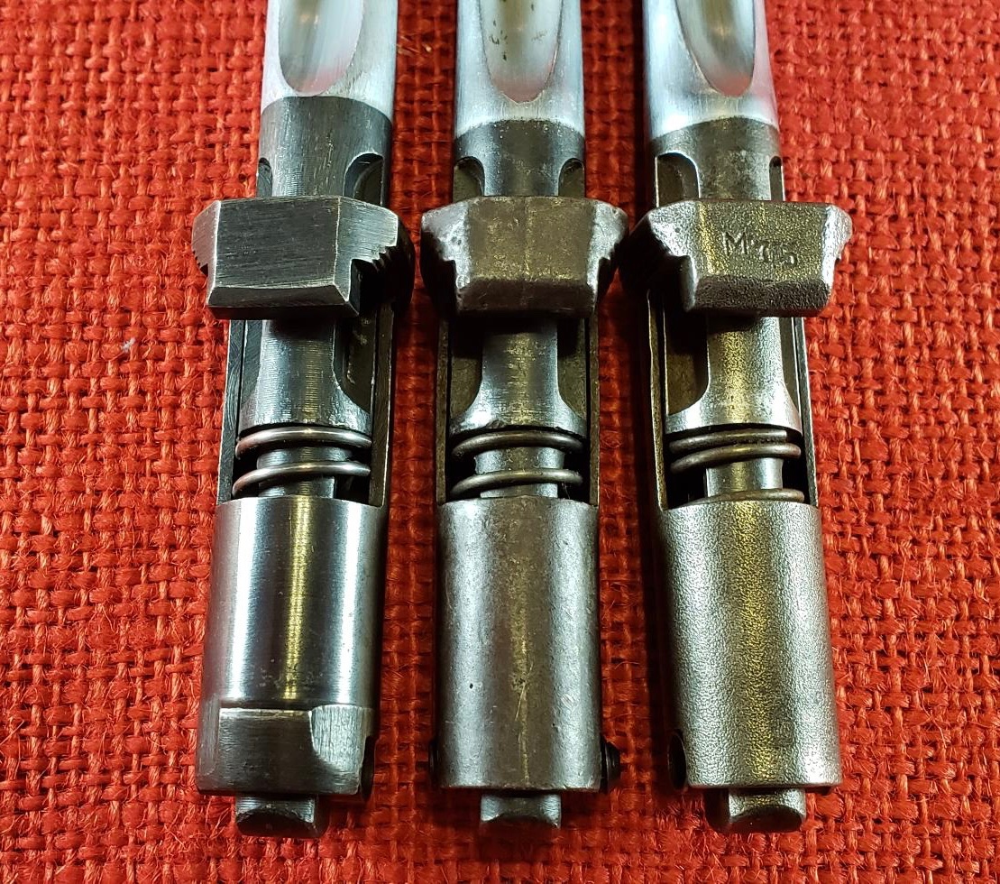

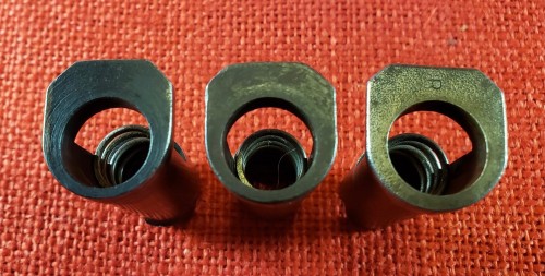

I then closely examined the 17 spike bayonets currently in my possession. No two were the same. Different points, casting, machining, finishing and other details. Only one had any markings. One that came back from the Balkan Conflicts in the late 1990s. The sliding hilt had a “M75” stamped on the top of the hilt and what appears to be an “R” stamped on the front.
Is it possible this is an Albanian made bayonet? Does anyone have any reference material, pictures or other information? Thoughts or opinions? Thanks, Mike

Yes, I have that book too. I had missed the “R” stamp. I didn’t associate it with the one I have. The “R”s do look the same. I guess if I trust this book I may have an Albanian spike? I have asked for confirmation from other sources which may help. Several of the ASH 78 parts kits have been imported into the U.S.. I have asked owners to check their bayonets.

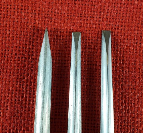

I am not sure I trust this book or read Russian. Also I have found several other errors / misinformation in this book. Note they call this one an ASH 82? Also note the bayonet pictured has a vertical point, mine has a horizontal point?

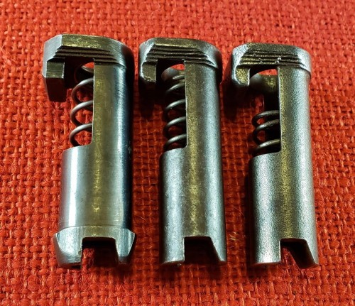

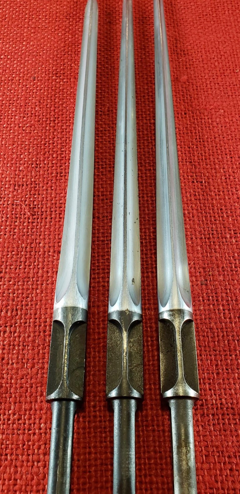

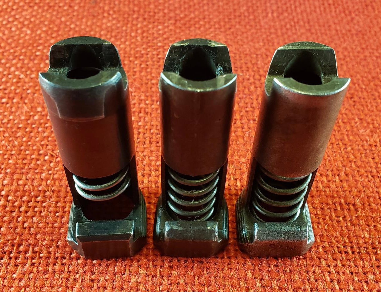

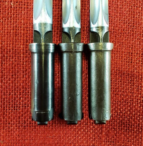

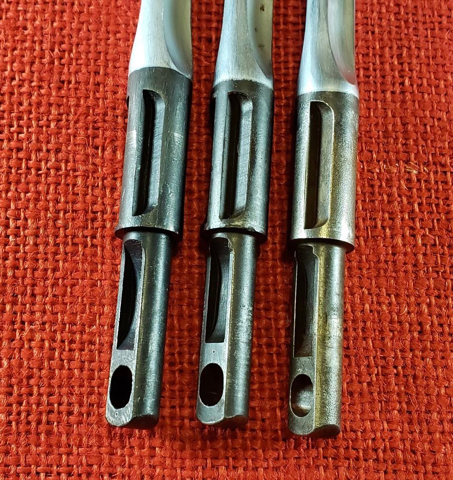

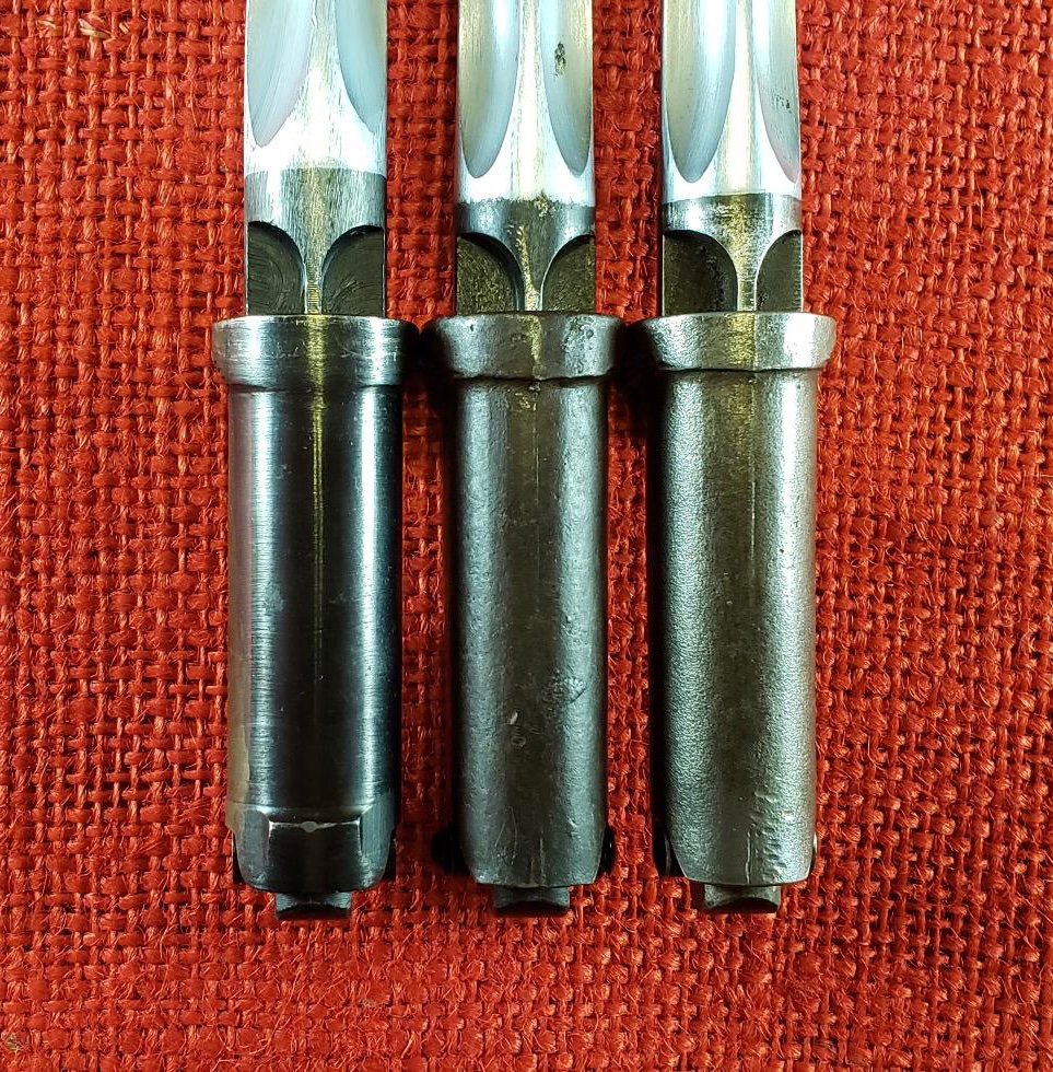

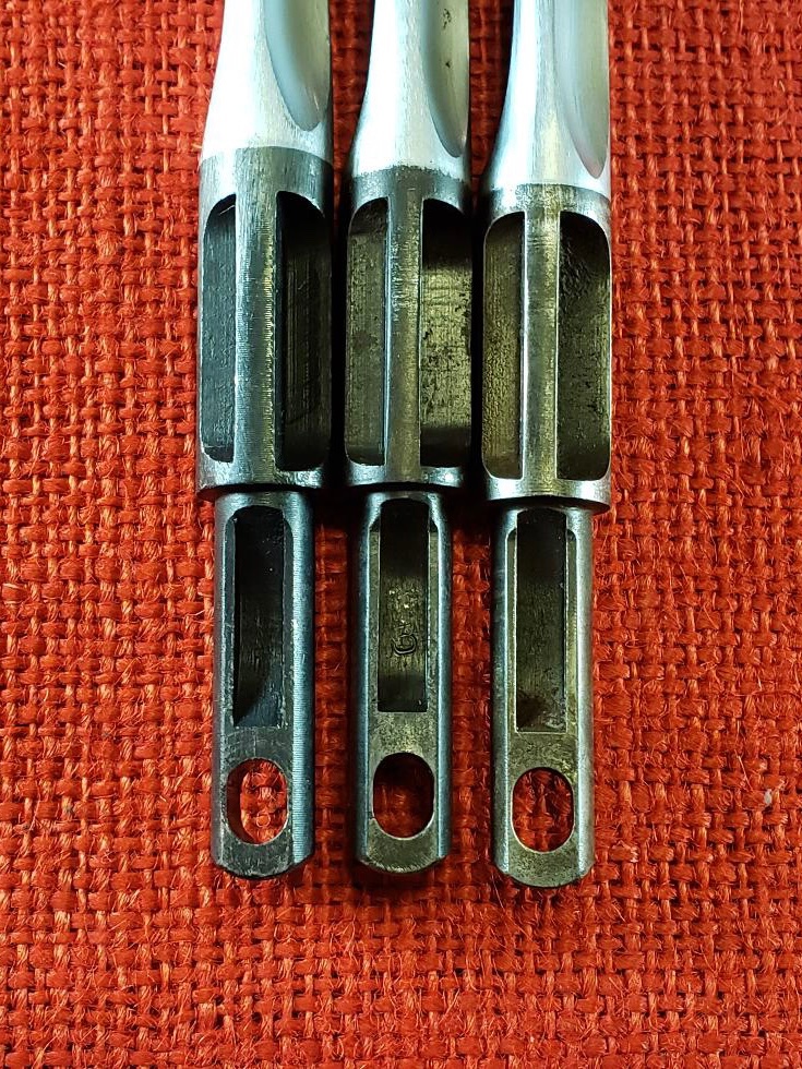

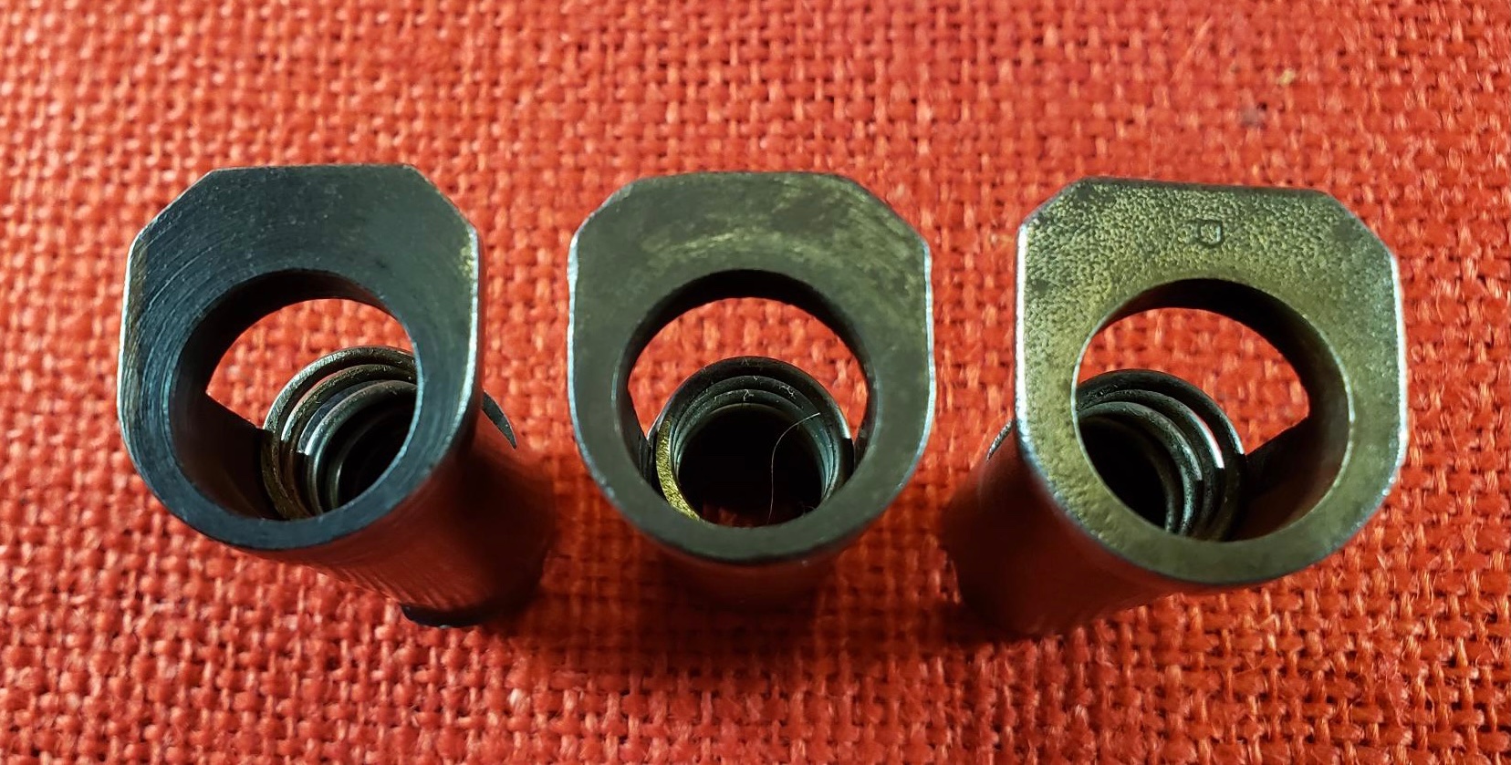

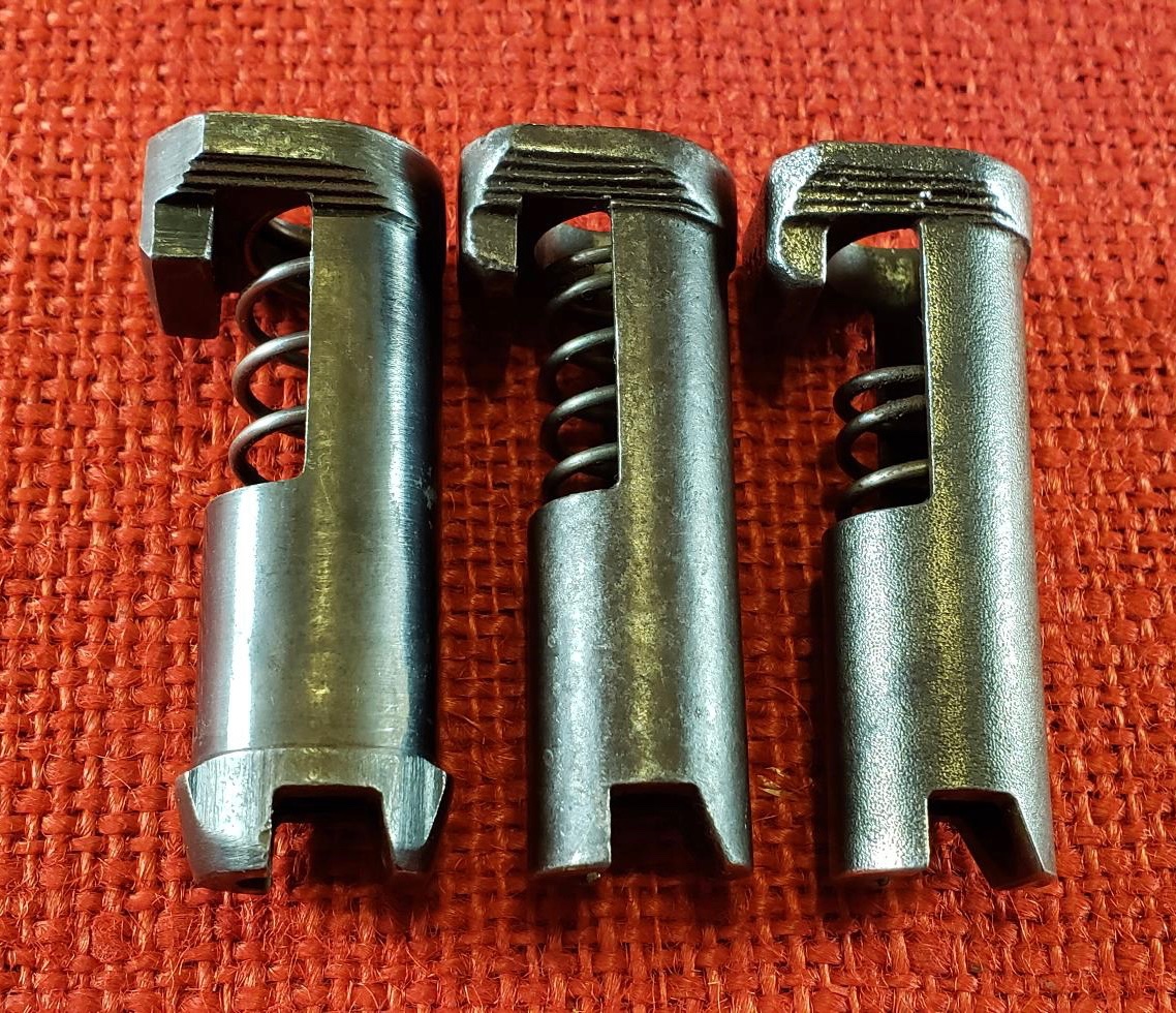

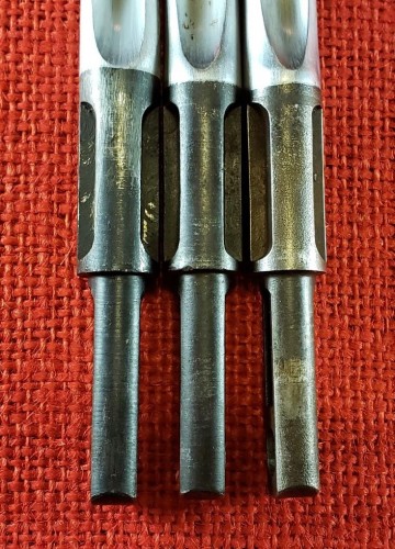

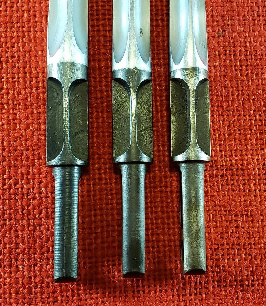

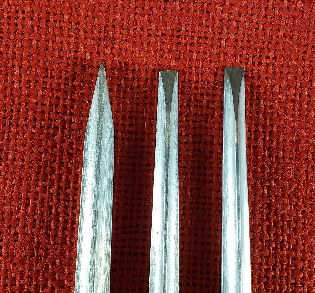

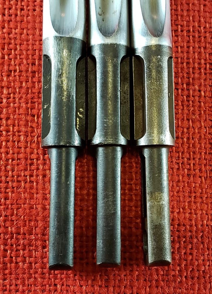

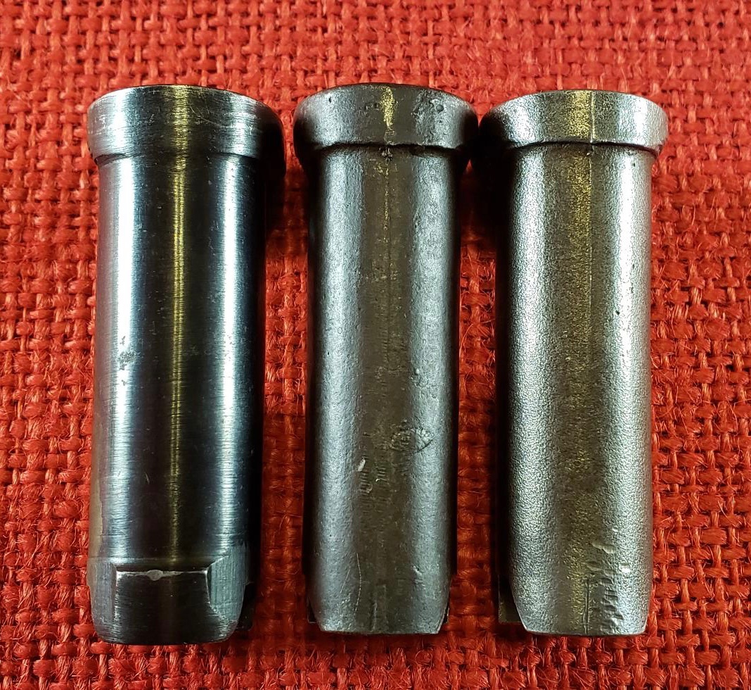

Hi Marc, Here are some detailed pictures of what is suspected to be an Albanian ASH 78 bayonet. Left to Right in all pictures are an early Chinese T56 with milled/machined hilt, a later Chinese with a cast hilt, and the Albanian cast hilt. What appears to be corrosion on the Albanian are from the rough casting of the hilt and the blade tang, Even the front of the hilt is not machined. Mike

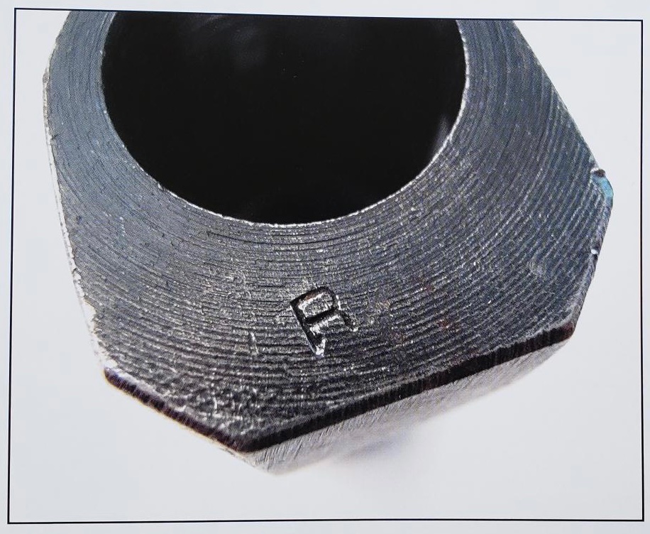

Here is a picture from the Russian reference book compared to the one in my collection. Note, the one in the book has rough circular machining on the front. Mine is as cast, no machining on the front. Mike
