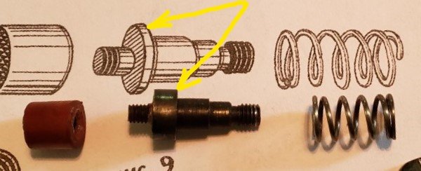

AK bayonet collecting has been slow lately and i have been curious about the Romanian AKM 6X3 bayonets with the flat sided pommels. These bayonets are similar to the AKM 6X3, 6H3 bayonets produced and issued by the other ComBloc countries. In 1963 Romania designed and started producing a unique variation with grip panels ending with a thicker, bulbous pommel shape. This wider pommel also required the release catch to be lengthened to protrude past the wider grips. This was done by machining a longer shaft and possible a longer button as well. This bayonet with the bulbus pommel was produced continuously until superseded by the AKM 6X4 bayonets.
However, for some unknown reason the Romanians also intermittently produced batches of the more standard bayonets with the flat, narrow sided pommel. These bayonets were made in small amounts from 1964 through 1966. They not only had the narrow pommels, but the scabbards were painted black and they appear to have been issued with either a one or two piece snap hook hangers. Mike
