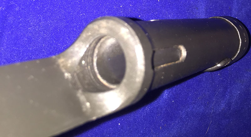

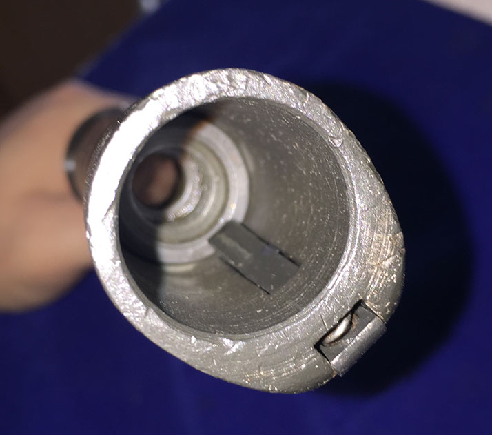

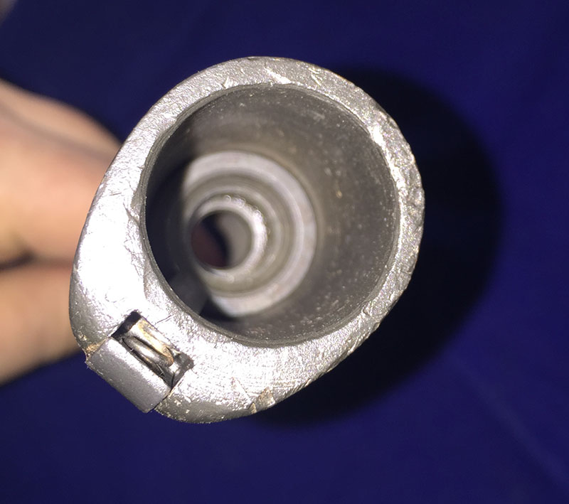

3- This is the one that is the subject of this post. This is the one seen in a few pics of troops on parade, that look like they have R1 bayonets fitted. There is a hardened steel tube inserted and fixed permanently inside the bayonet. This closes off the R1 flash hider slots, and also lets the R4 muzzle break stop inside, to the point that the R4 muzzle break sits where the R1 catch will just nicely lock in behind it, and keep the bayonet secured.
Yes, the bayonet can rotate, but it fits securely and locks on.
Often confused with the regular R1 bayonet, the steel tube blocking the slots gives it away.

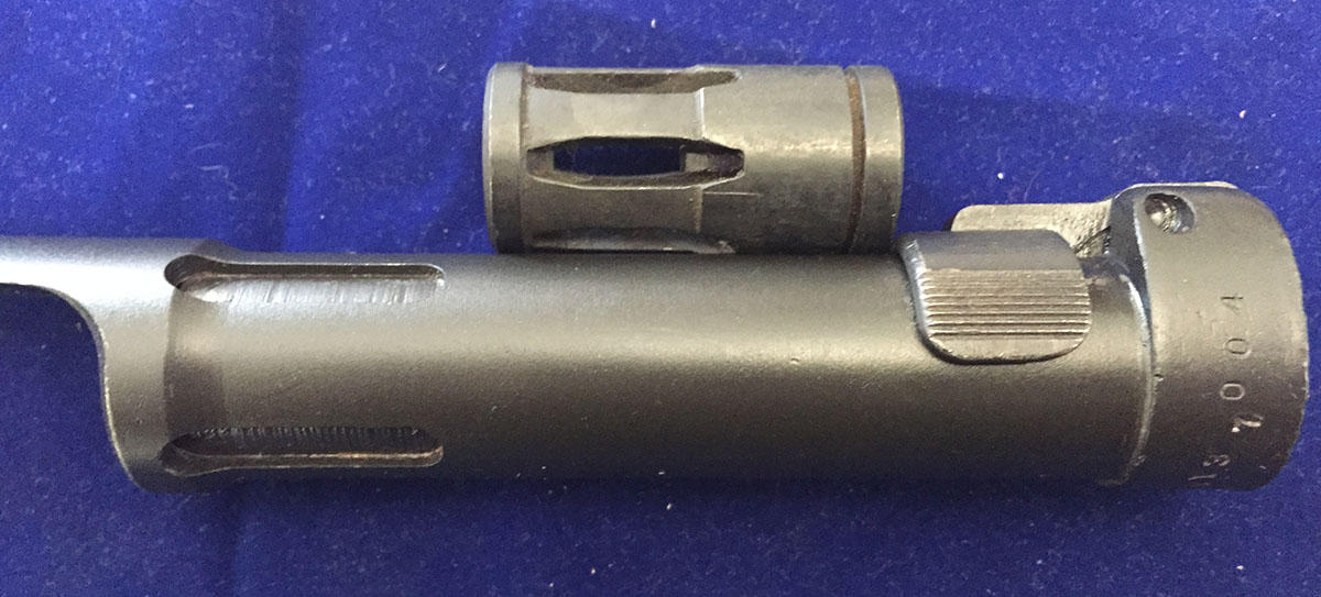

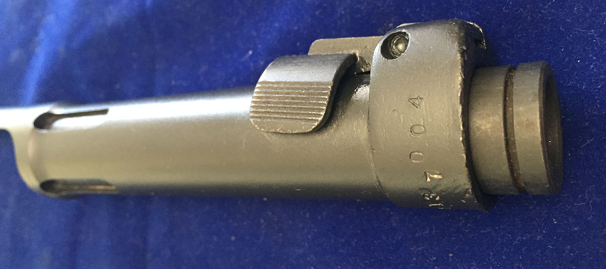

I have taken a pic showing an R4 muzzle break on the outside of the bayonet where it would sit inside. Then a pic of the muzzle break being inserted, and then one where the muzzle break is inside the tube, and locked in by the R1 bayo catch.
