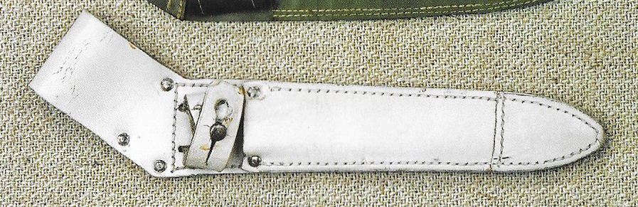

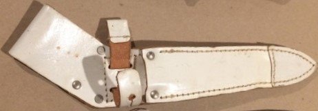

The first manufacturer that made the early scabbards used a slightly different method of attaching the belt loop to the scabbard body. This is known as the 5 rivet version. it looks the same as the 6 rivet version made by the other companies, but uses only 5 rivets. Another variation is the 6 rivet version made of white lacquer faced leather, (patent leather), and bright rivets for ceremonial purposes. Only a limited number of these were made. As more were needed the standard scabbards were simply dyed or painted white.

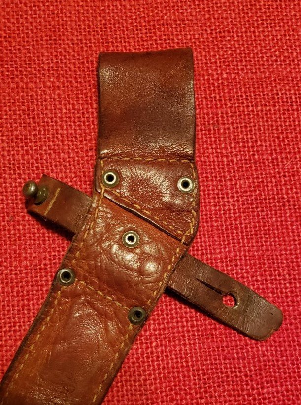

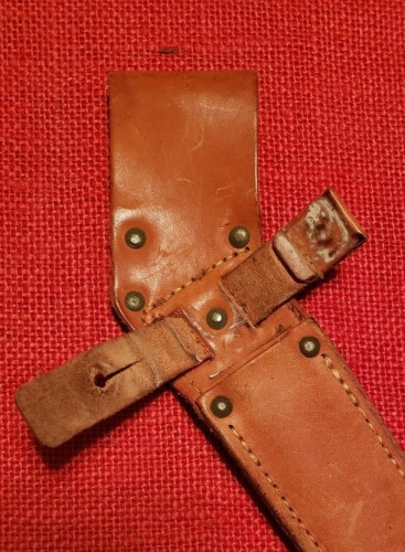

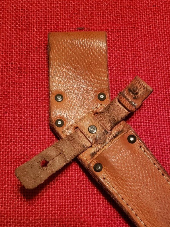

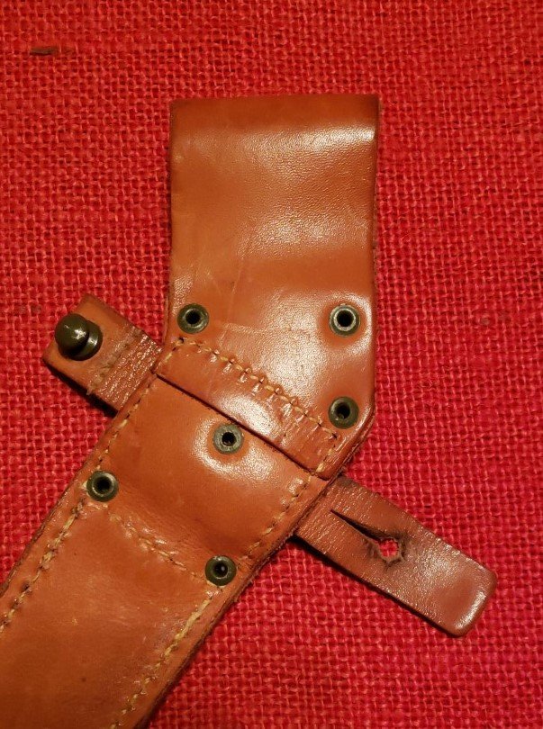

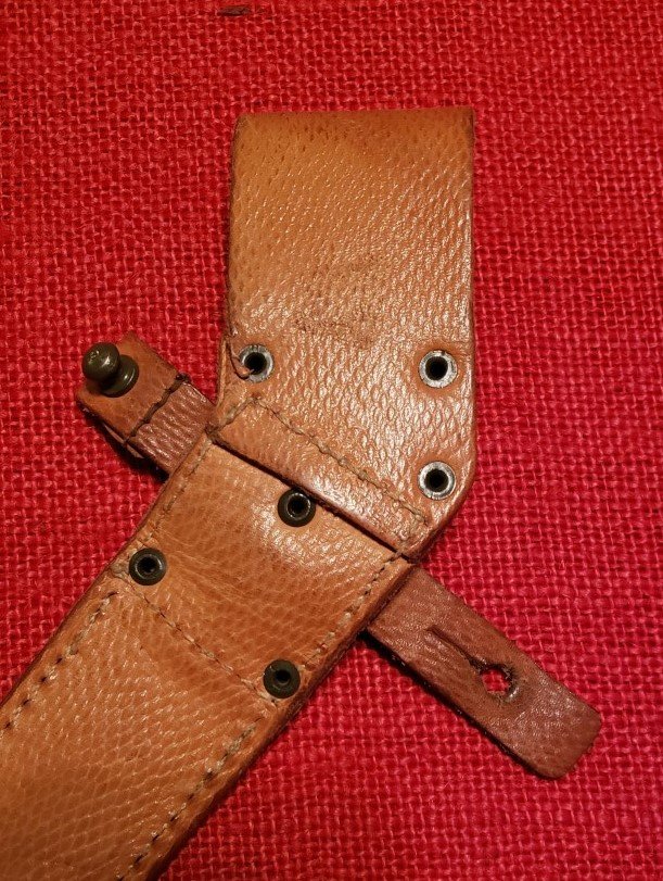

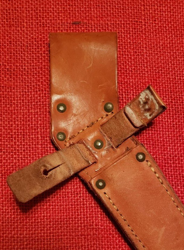

Here are pictures of the 6 rivet Czech VZ58 scabbards. The first one has the early embossed/textured finish. The second one has the standard smooth finish. Mike

Interesting stuff. I thought you posted a picture of a left hand scabbard recently. Need to look and see if I can find who posted that and where. I am still looking for a white scabbard and a gray NBC scabbard for my collection. I have a variety of 5 and 6 rivet leather scabbards dating from 1961 to 1985, most without visible dates.
Re: Czech VZ58 Leather Scabbards Variations
I am also missing the grey NBC scabbard and would like to find one. Not really my cup of tea, but would also be interested in one of the original white faced leather dress scabbards. The painted or dyed ones would be too easy to fake. I would also like to have a better example of a 5 rivet scabbard. Mine is well used and has some wear and tear.

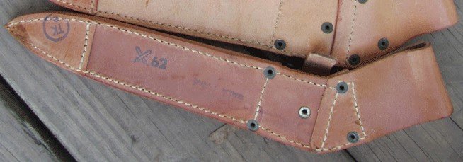

Here is a picture of a VZ58 scabbard made by Galanta in 1962. Each of the various manufactures had there own way of marking the scabbard, different information in different styles and positions, but all the same basic info. Galanta was the first manufacture and the only one making the 5 rivet variation. Below you can see the GALA 62, (inverted), the Crossed Swords 62, (military acceptance), and the circle on the tip with the final proof marks. Mike

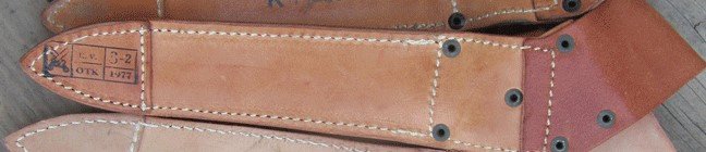

For comparison, this is a 6 rivet VZ58 scabbard made by SNAHA, ("S"), in 1977. The Snaha marking had all the same information in rectangular box on the scabbard tip. Mike

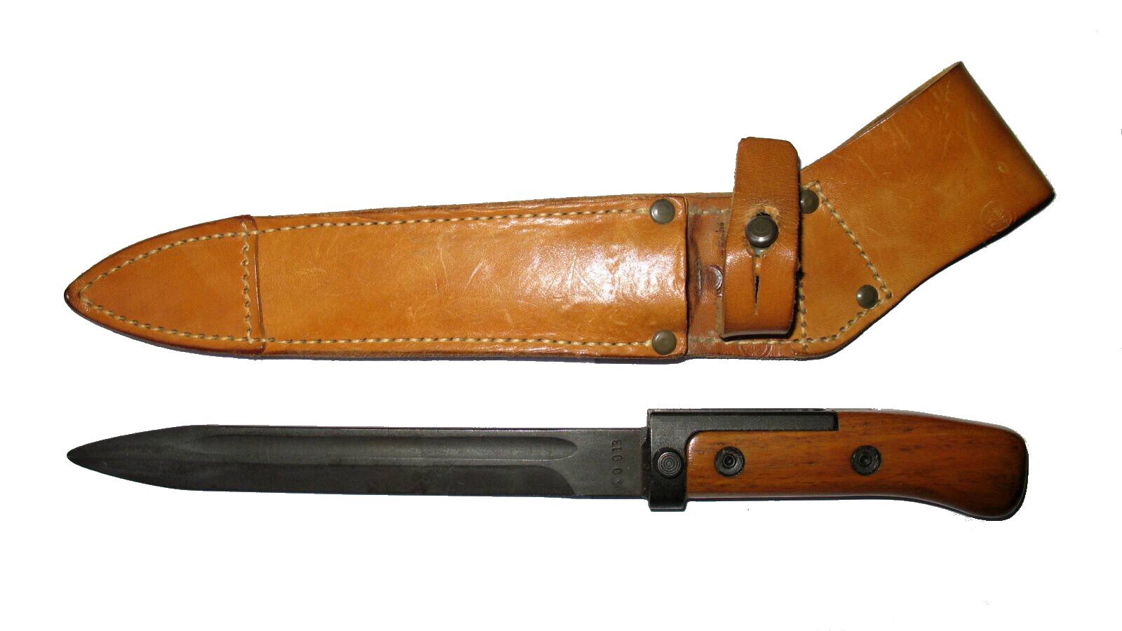

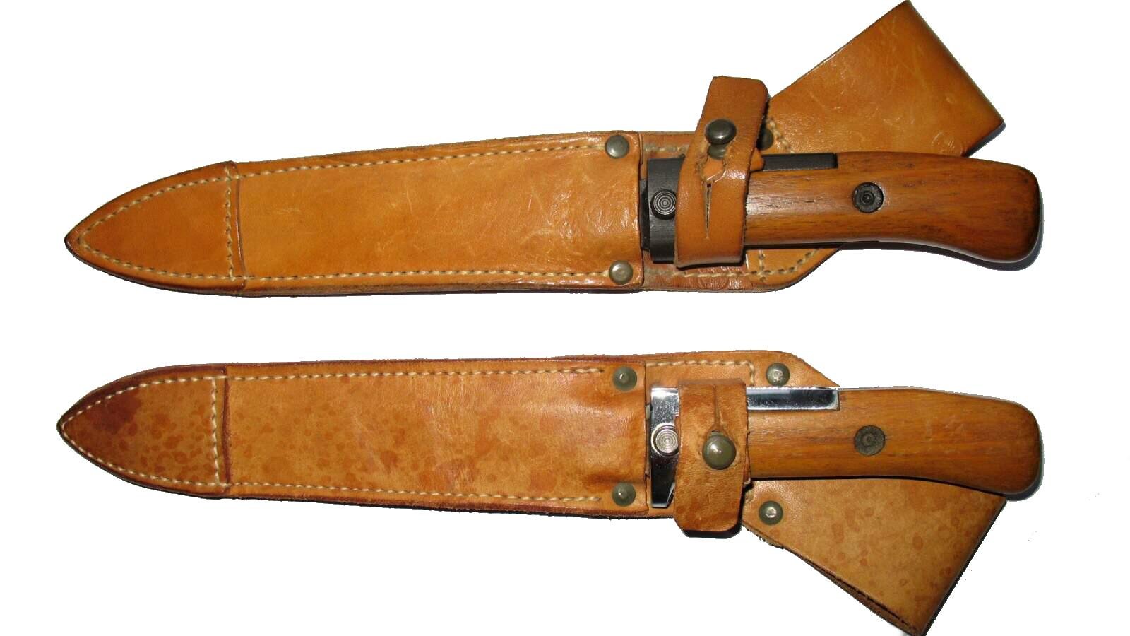

I recently found pictures that I believe confirms the existence of the early 5 rivet LEFT HANDED scabbard made by the original manufacturer Galanta. This scabbard is shown with the correct VZ58 Type I bayonet. The second picture shows the comparison with the Left hand version on top and the more common Right hand version below.
