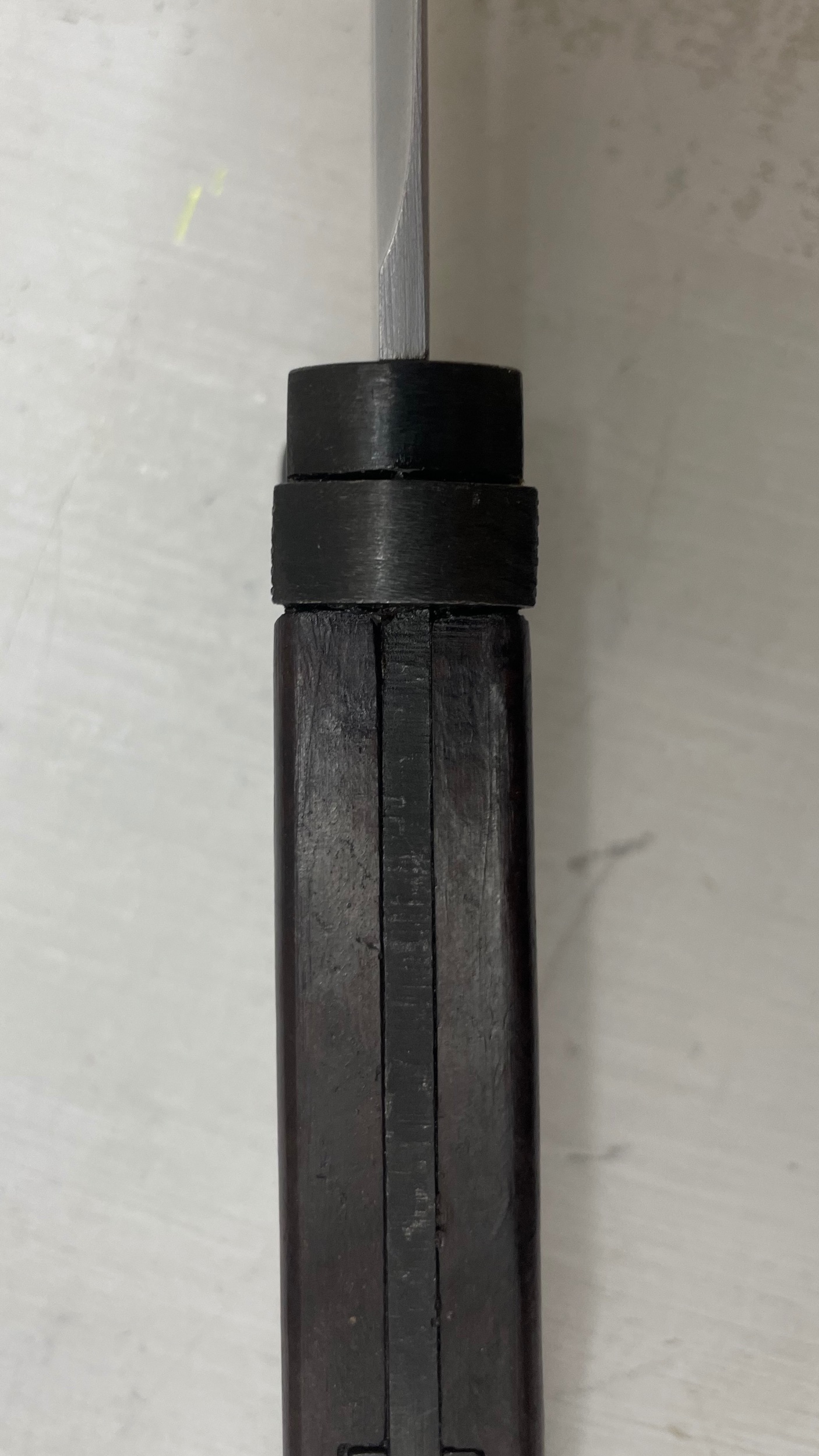

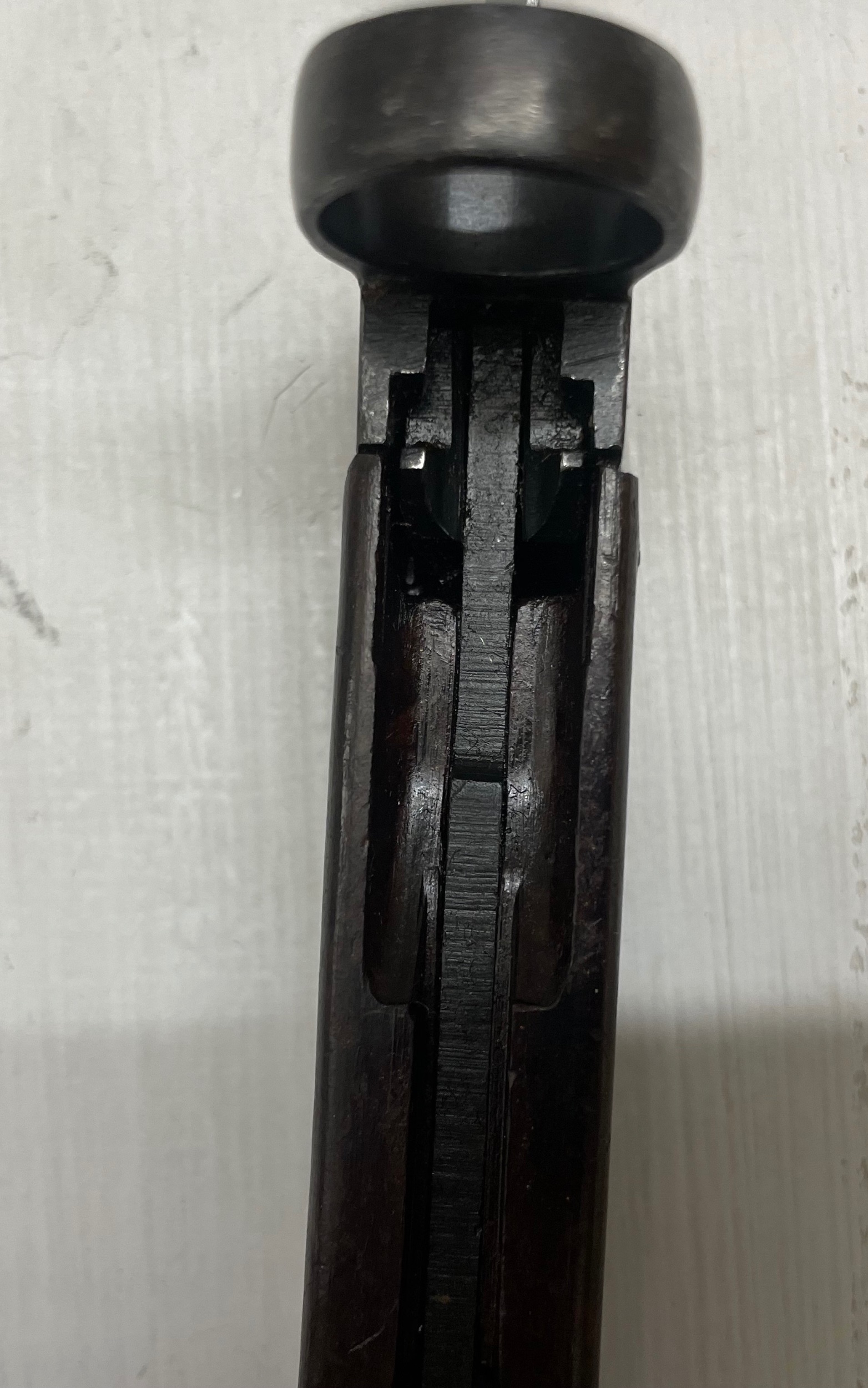

Postby Mr. B. » Thu Jan 25, 2024 8:26 pm
I recently received some new barrowed pictures of a T58 (AK47) to T68 (AKM) transitional bayonet. Comparing these new pictures with the pictures of the T58 and T68 we already have gives us a better idea of how they were made. The main change was the machining of the crossguard and latch block. The hole for the blade tang was made thinner, taller and squared at the top and bottom.. The original T58 sliding latch lock and spring were retained. Behind the crossguard the T68 tang was machined to match with the T58. Then the thinner tang was shimmed on both sides to be able to reuse the T58 grip panels and pommel.
One of the pictures is of the front of the crossguard on one of my T58 bayonets. Compare with the one of the front of the Transitional. Note the similar proof marks. Mike

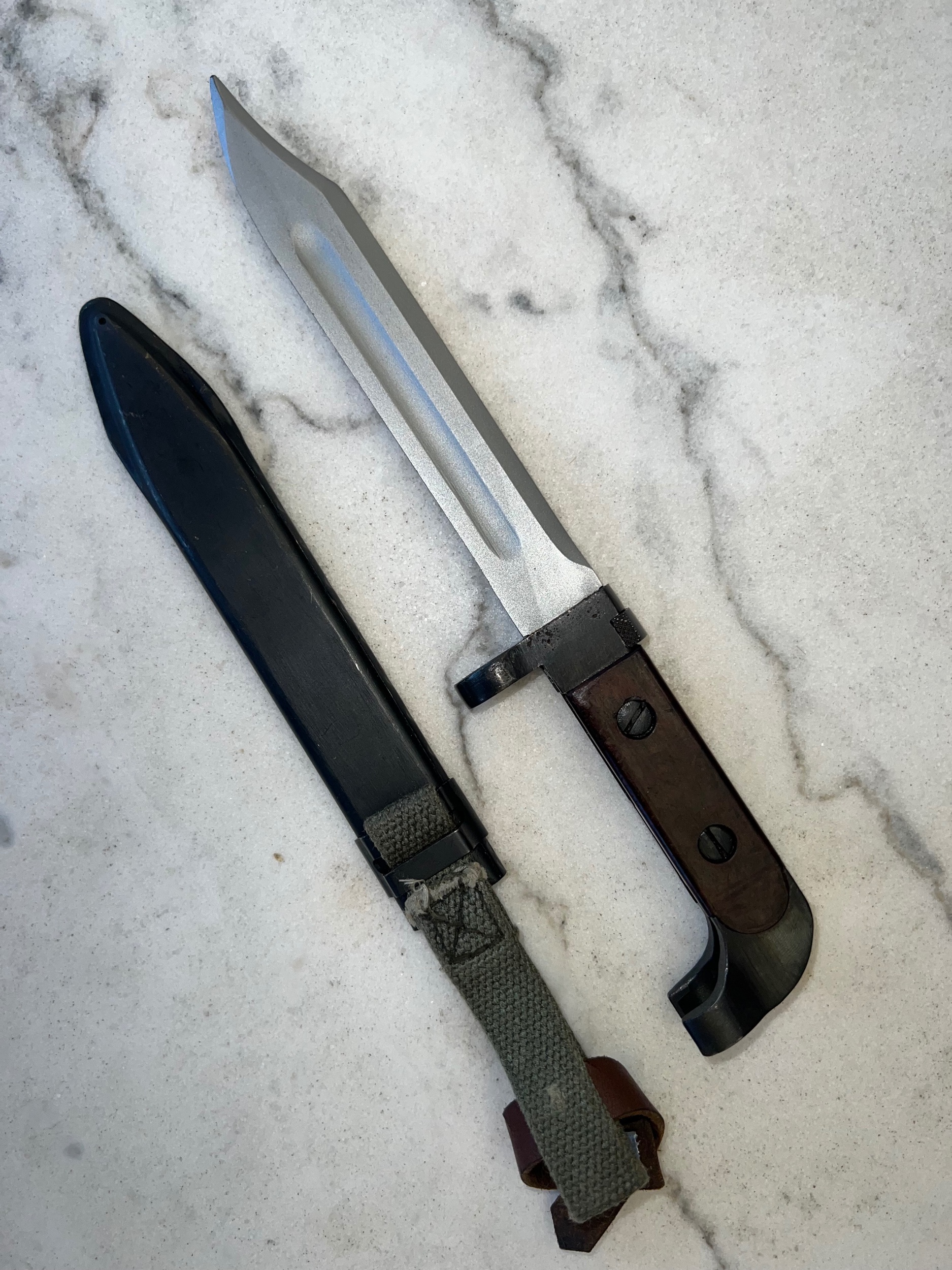

Postby Dragur2791 » Wed Apr 02, 2025 6:48 pm
Finally the happy owner of one of these scarce NK transitionals.
Im still wondering about the story behind these.
A cool specimen to add.
Postby ilian » Wed Apr 02, 2025 10:21 pm
Very Nice like always! I will need some pics of this one too ;)
Postby Dragur2791 » Thu Apr 03, 2025 9:38 am
Sure!! Just let me know 👍👍👍
