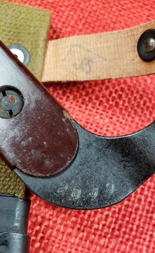

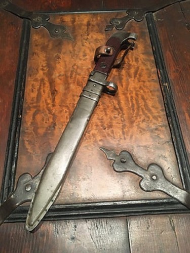

This Russian 6x2 AK47 Bayonet... Was this one made for the Russian army or for the army in Finland.
What do you think? I should really appreciate any opinions at all...

As usual, not enough detailed information in the provided pictures. What information that is there is conflicting and confusing. Not sure where to start. First it appears that the bayonet and scabbard are miss-matched.
Let’s start with the scabbard. It is the early style with the two band hanger brackets. It has no visible drain hole at the tip. The Finnish scabbards do not have holes. Some early Russian scabbards did not have drain holes, but most were added during ongoing inspection, repair and rework over the years. The Finnish 1st contract (early) scabbards had two tone sanded body that was then blued. The appearance was similar to the Bulgarian scabbards. The Russian scabbards had no sanding and were painted black. Both the early Finnish and Russian scabbards had a tan/khaki woven fabric belt loop. They also both had a leather hilt loop. All the Finnish ones had the loops connected bay sewing. Some Russians were also sewn, but most were connected with a single rivet. The Finnish ones used a green thread and had a different sew pattern than the Russian ones. REGARDLESS of sewn or riveted, the hilt strap CROSSES THE WRONG WAY, to be Finnish or Russian. They cross from left to right >>>. The one in the pictures crosses right to left <<<<<, Bulgarian style? Not sure what’s it is, possibly repairs or replace at some point?
The Bayonet is definitely Russian made at Izhevsk, (arsenal mark). Usually the Russian numbers are uneven and follow the curve of the pommel edge. The Finnish numbers are usually in more of straight line at an angle. These numbers could be either? Best way to tell Finnish from Russian is if there is a Russian acceptance stamp on the right side of the pommel. The Finnish contract bayonets do not have this stamp. It indicates acceptant for the Russian military.
Like I stated before, I am unable to identify either the scabbard or bayonet from the pictures provided. Mike

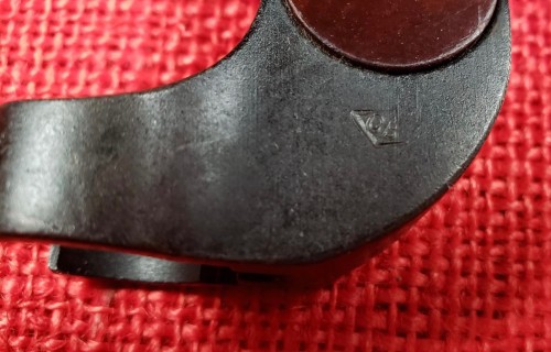

This is the Russian military acceptance mark on the right side of the bayonet pommel.
Check out the posts and pictures on this Forum in the Finnish and Russian sections.

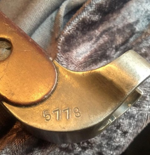

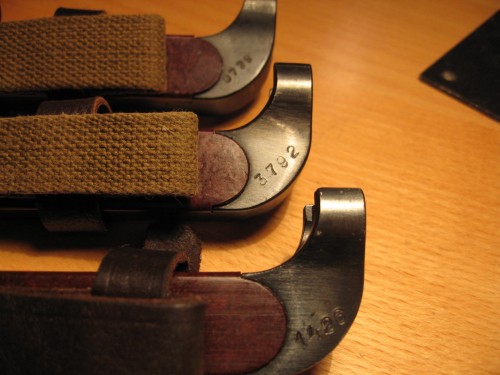

First picture is of typical Russian numbering. Second picture is of typical Finnish numbering.
