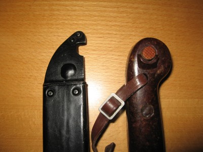

This is an early Romanian Type I (6X3) with the flat side pommel. It is also different from most Romanian Type I bayonets in that it has the two piece, two snap hook hanger and a black painted scabbard. M.

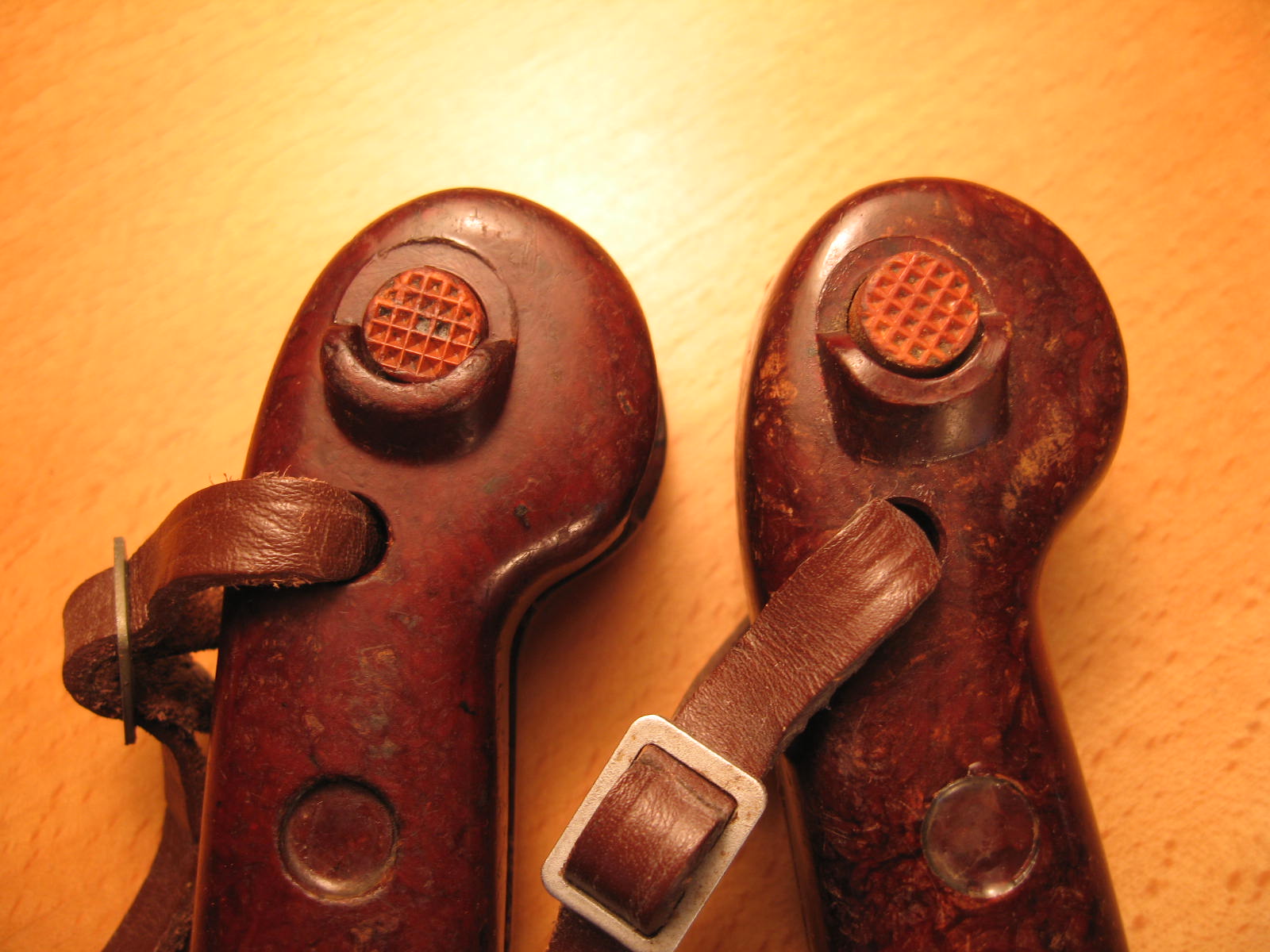

Postby Mr. B. » Sat Dec 19, 2015 8:43 pm

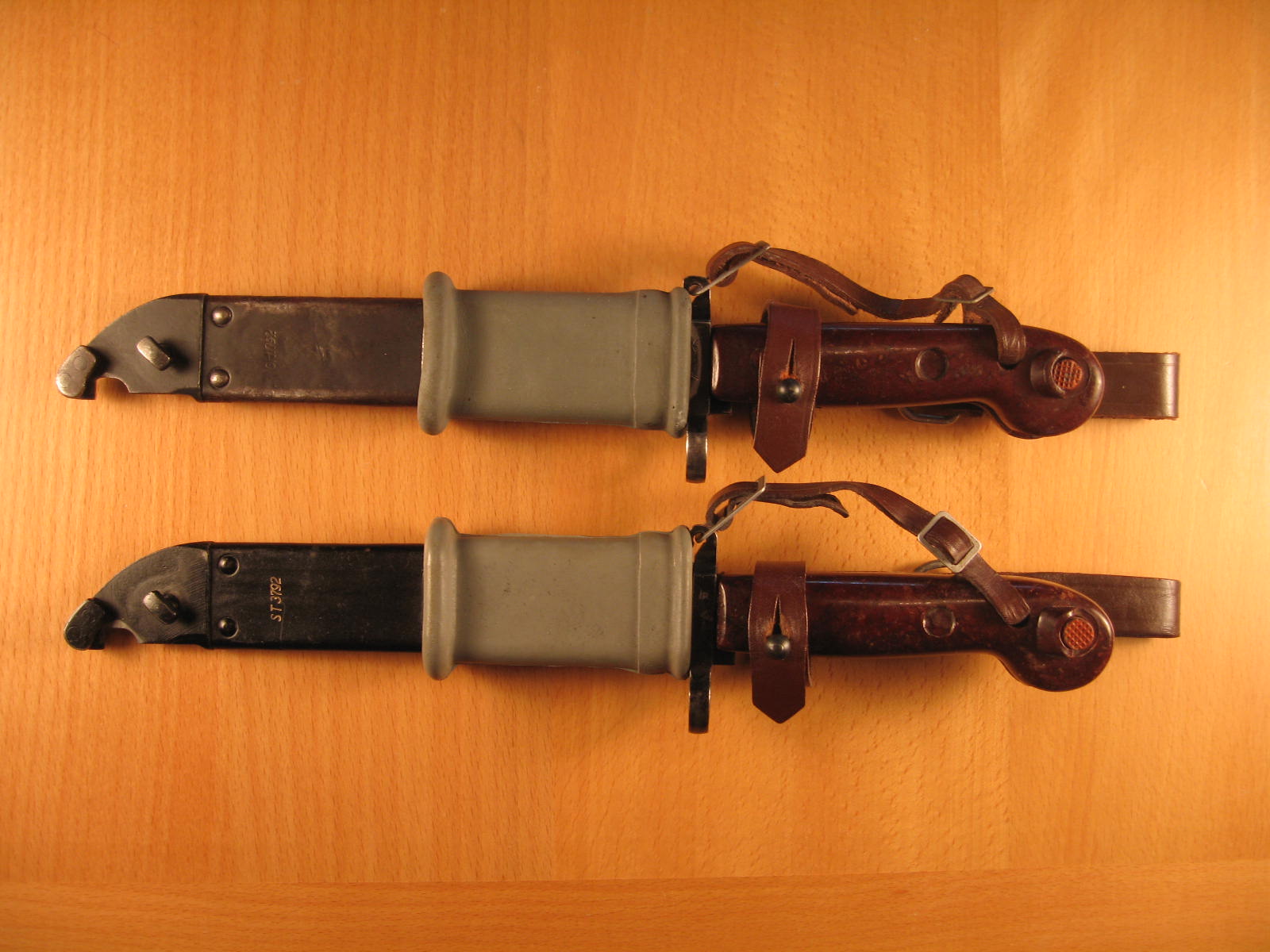

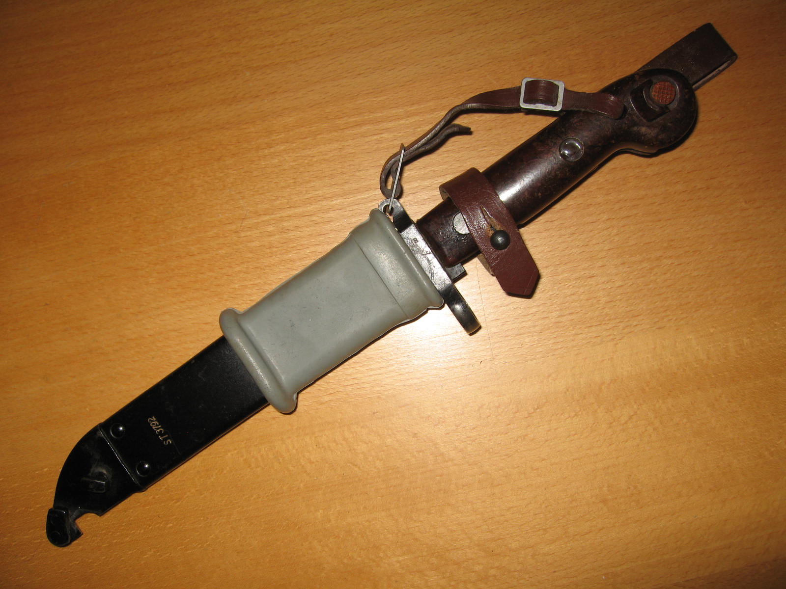

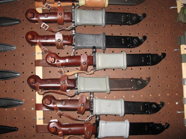

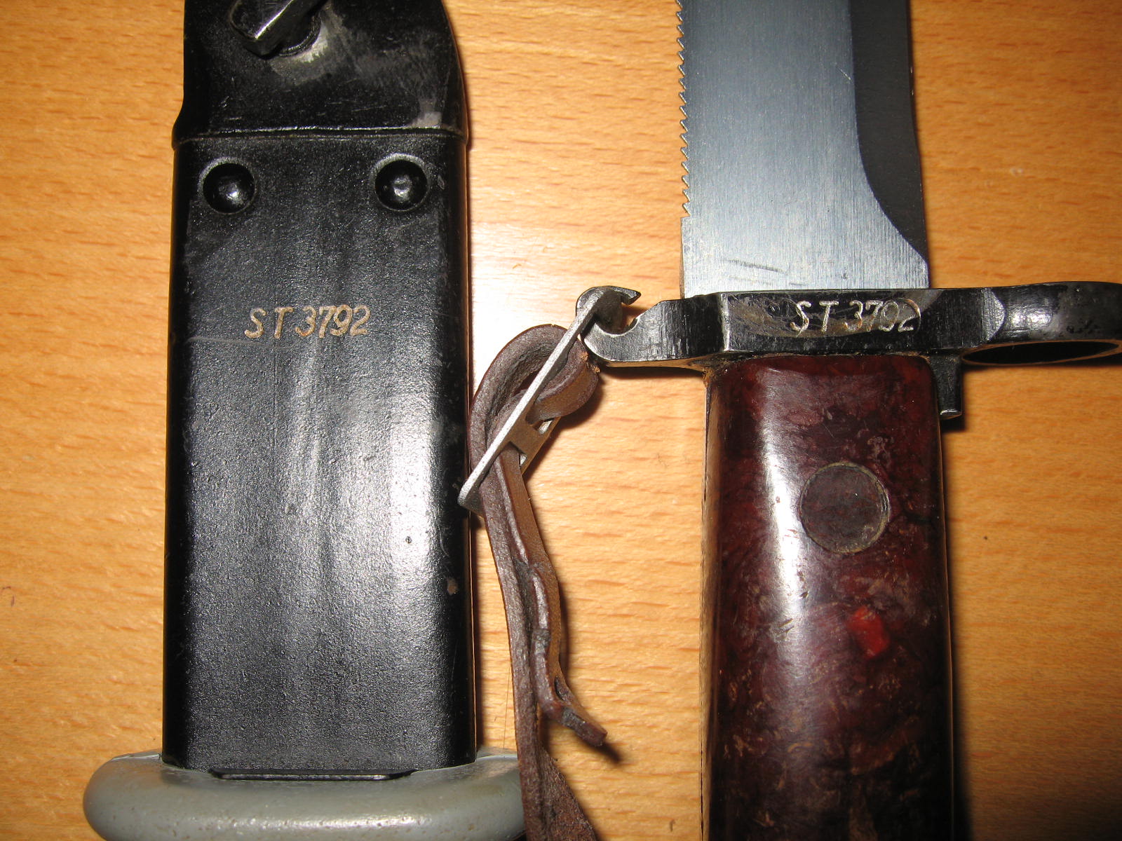

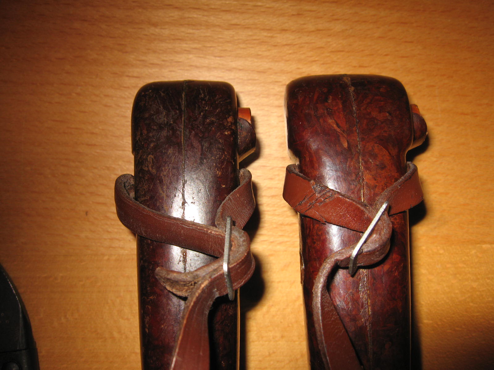

There are actually two different versions of these flat pommel bayonets. They differ in the shape of the pommel and the ridge around the catch button. The one I'll call an earlier version has a GH xxxx serial number. Although the serial prefix does not necessarily indicate age. I call it earlier as it is more used/aged in appearance as well as being different than the other serial numbers associated with the flat pommel, i.e. RS & ST. Also note that the GH has a scabbard that is not painted. Below is my GH and an ST for comparison.

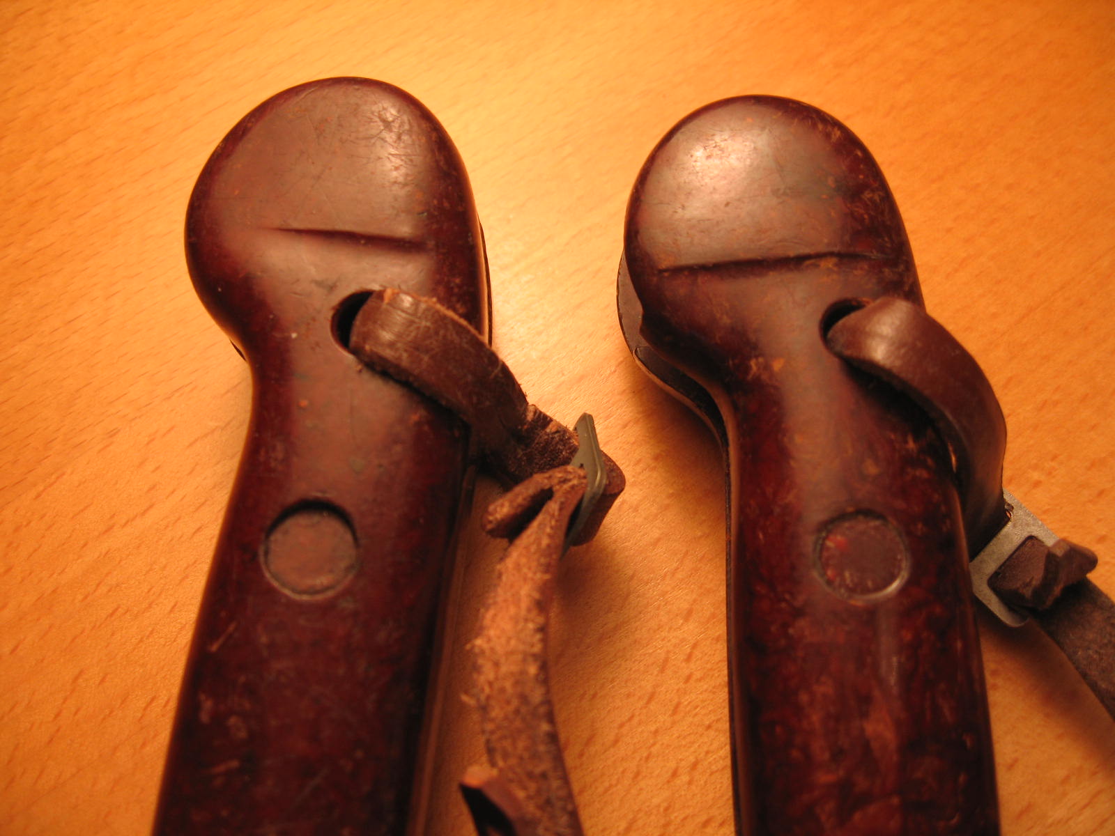

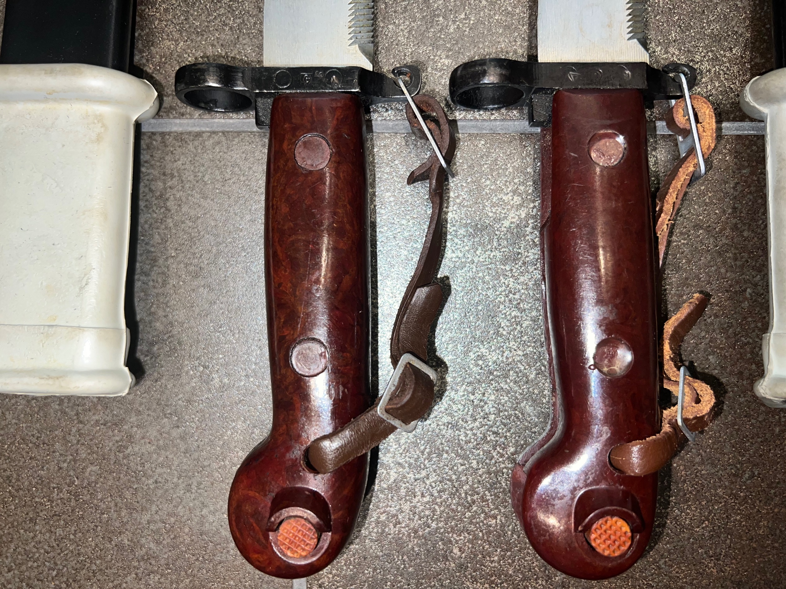

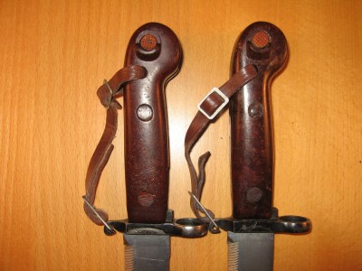

Postby Mr. B. » Sat Dec 19, 2015 8:47 pm

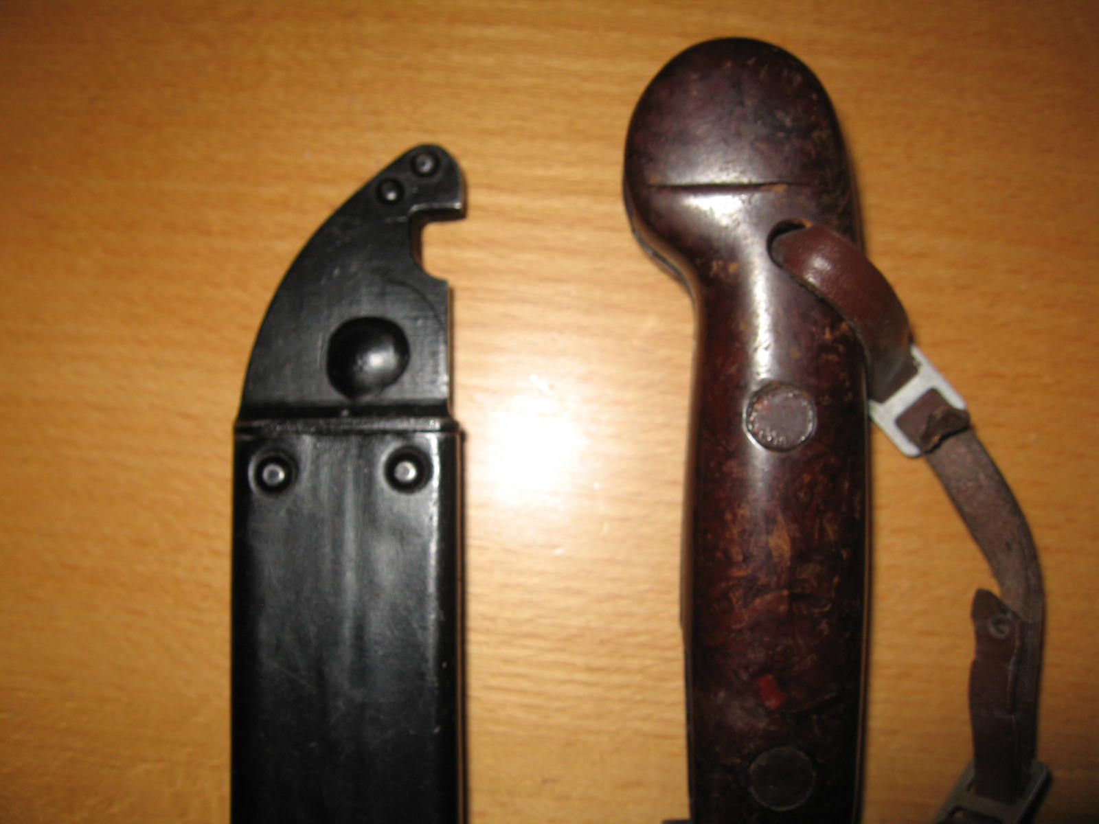

here's one last picture of the left side of the pommels. The ridge around the catch button is round in shape on the GH and more squared off on the latter version. The small ridge on the opposite side is also a different shape. M.

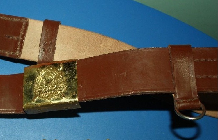

Postby Mr. B. » Mon Jul 17, 2017 5:16 pm
I'm not sure where to post this information. It's here because the two piece, two hook hanger is associated with the flat pommel early Romanian AKM Type Bayonets and scabbards. It seems the lower part of the hanger with the hooks is issued with the bayonet & scabbard as they have been found packaged that way. The top belt loop is more difficult to find as it is issued with the leather belt. Below is pictured a Romanian military belt with the top loop of the hanger as issued. Mike

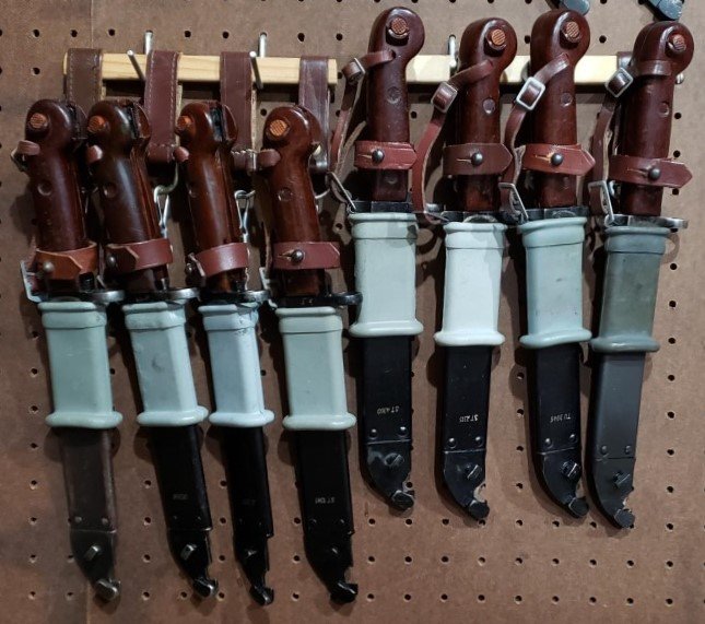

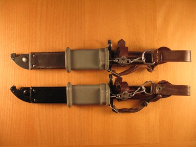

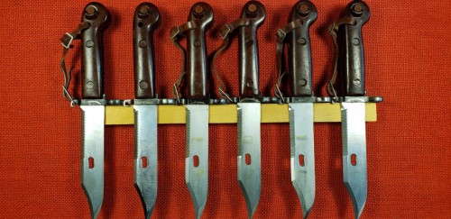

Postby Mr. B. » Fri Sep 20, 2019 1:20 am

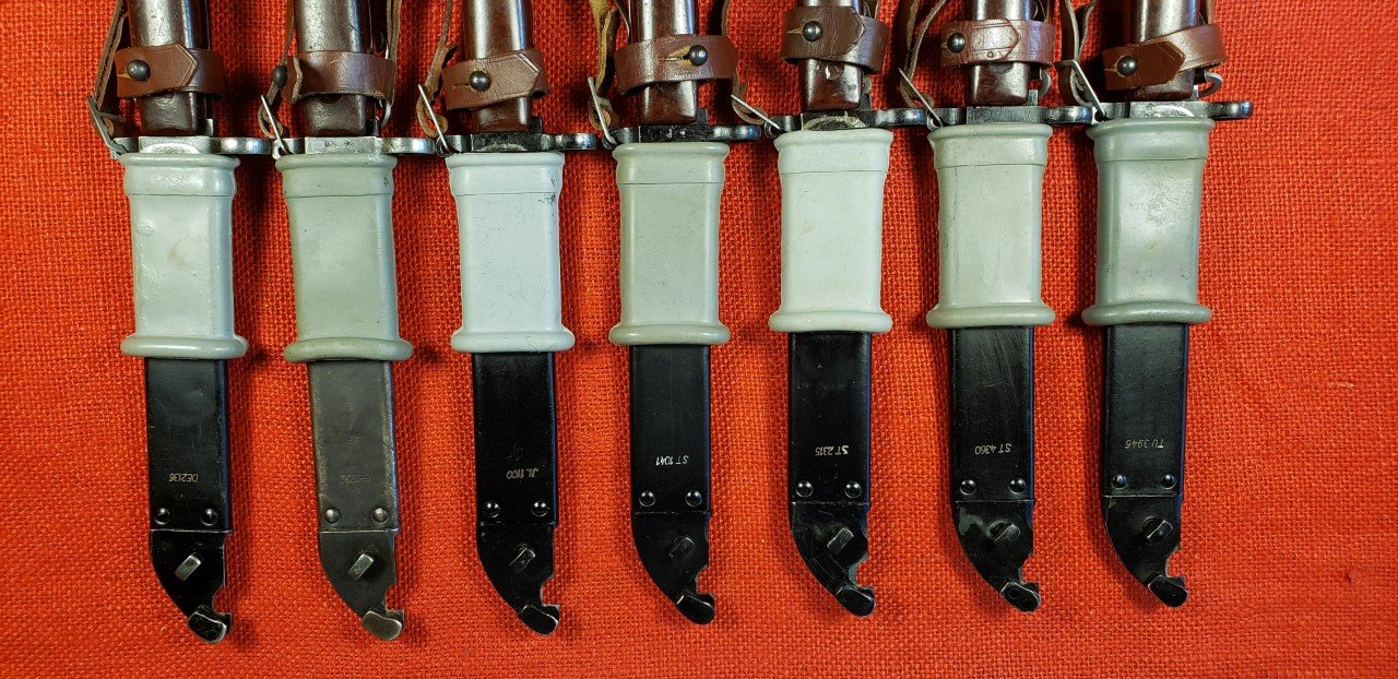

Here is a group picture of Romanian AKM 6X3 Type I Flat Pommel bayonets and scabbards. These show the black painted scabbards, wear marks from the snap hook hangers on the cross guards. The two different style hangers, (1 & 2 piece), and several different serial number groups.

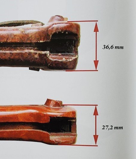

AK bayonet collecting has been slow lately and i have been curious about the Romanian AKM 6X3 bayonets with the flat sided pommels. These bayonets are similar to the AKM 6X3, 6H3 bayonets produced and issued by the other ComBloc countries. In 1963 Romania designed and started producing a unique variation with grip panels ending with a thicker, bulbous pommel shape. This wider pommel also required the release catch to be lengthened to protrude past the wider grips. This was done by machining a longer shaft and possible a longer button as well. This bayonet with the bulbus pommel was produced continuously until superseded by the AKM 6X4 bayonets.
However, for some unknown reason the Romanians also intermittently produced batches of the more standard bayonets with the flat, narrow sided pommel. These bayonets were made in small amounts from 1964 through 1966. They not only had the narrow pommels, but the scabbards were painted black and they appear to have been issued with either a one or two piece snap hook hangers. Mike

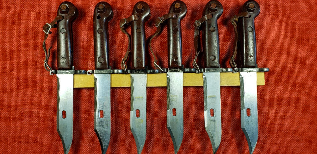

Postby Mr. B. » Thu Aug 27, 2020 6:30 pm
These are the Romanian AKM 6X3 Type I flat pommel bayonets currently in my collection. Attempting to find a representative samples of each production series. Mike

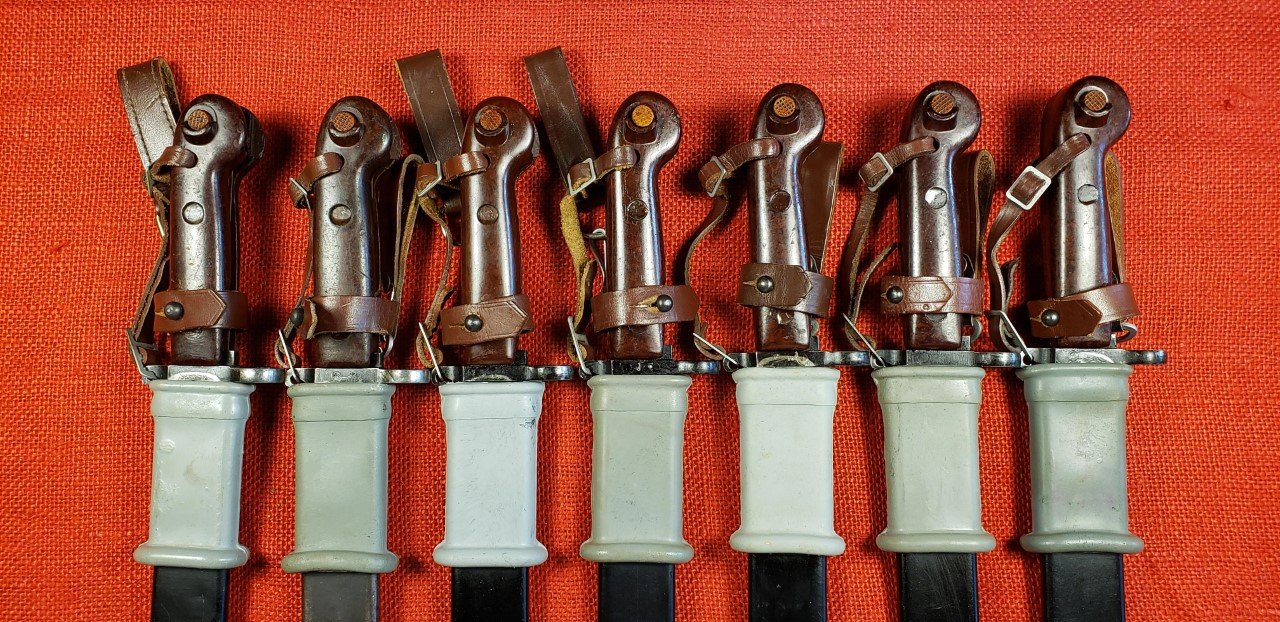

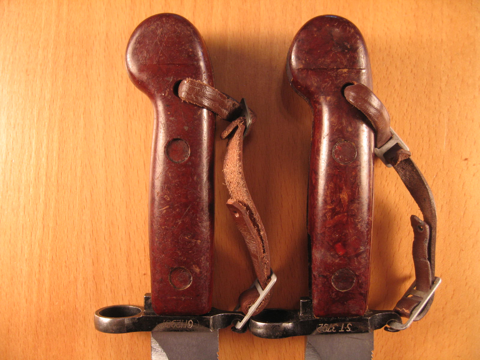

Postby Mr. B. » Thu Aug 27, 2020 6:41 pm

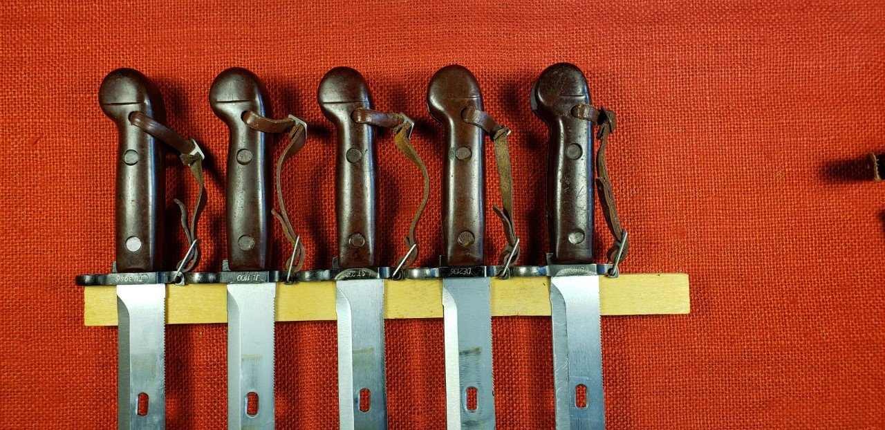

Here are pictures showing the reason I believe that the flat pommel bayonets and scabbards were issued with the one or two piece snap hook hangers rather than the standard wrap around style hanger. Notice the circular wear marks on the side of the cross guards from contact with the snap hooks. Almost all the flat pommels I have seen have thes wear marks on one or both sides of the cross guards. The only exception I have found is a couple of like new ones that appear to be unissued or worn. Mike

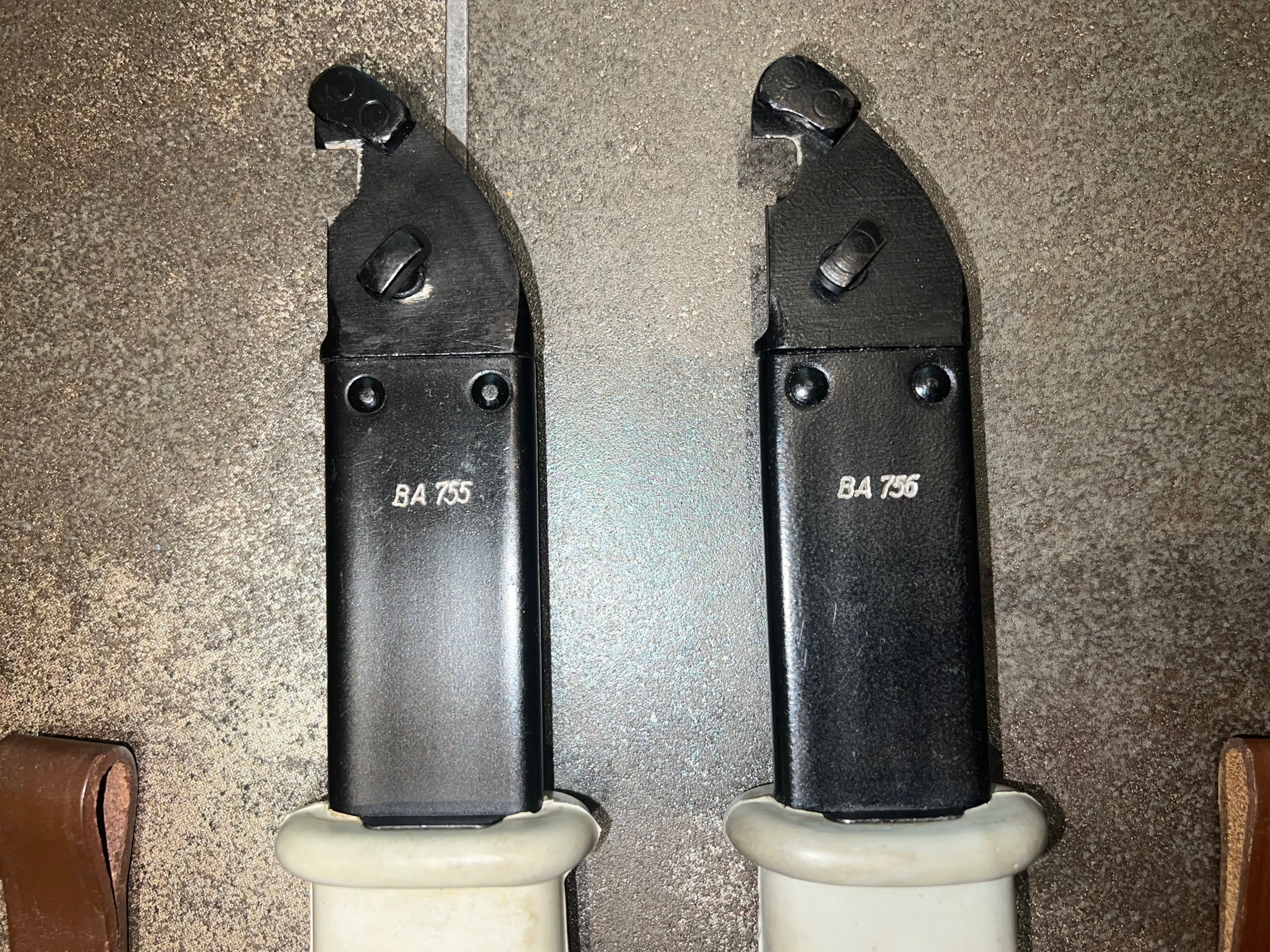

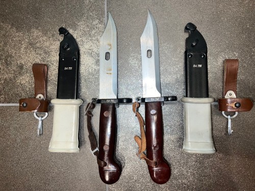

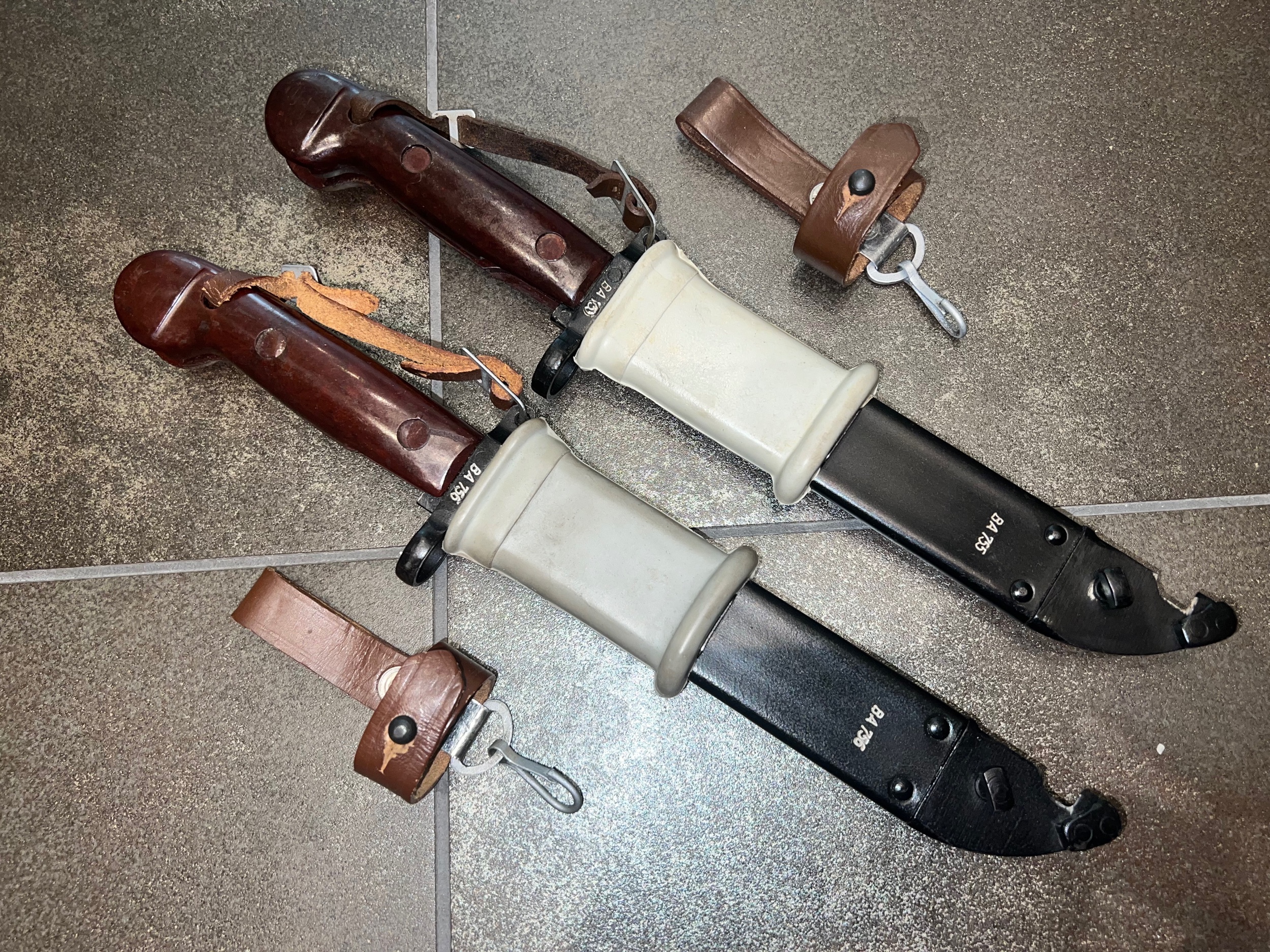

Postby Dragur2791 » Mon Oct 17, 2022 7:03 pm

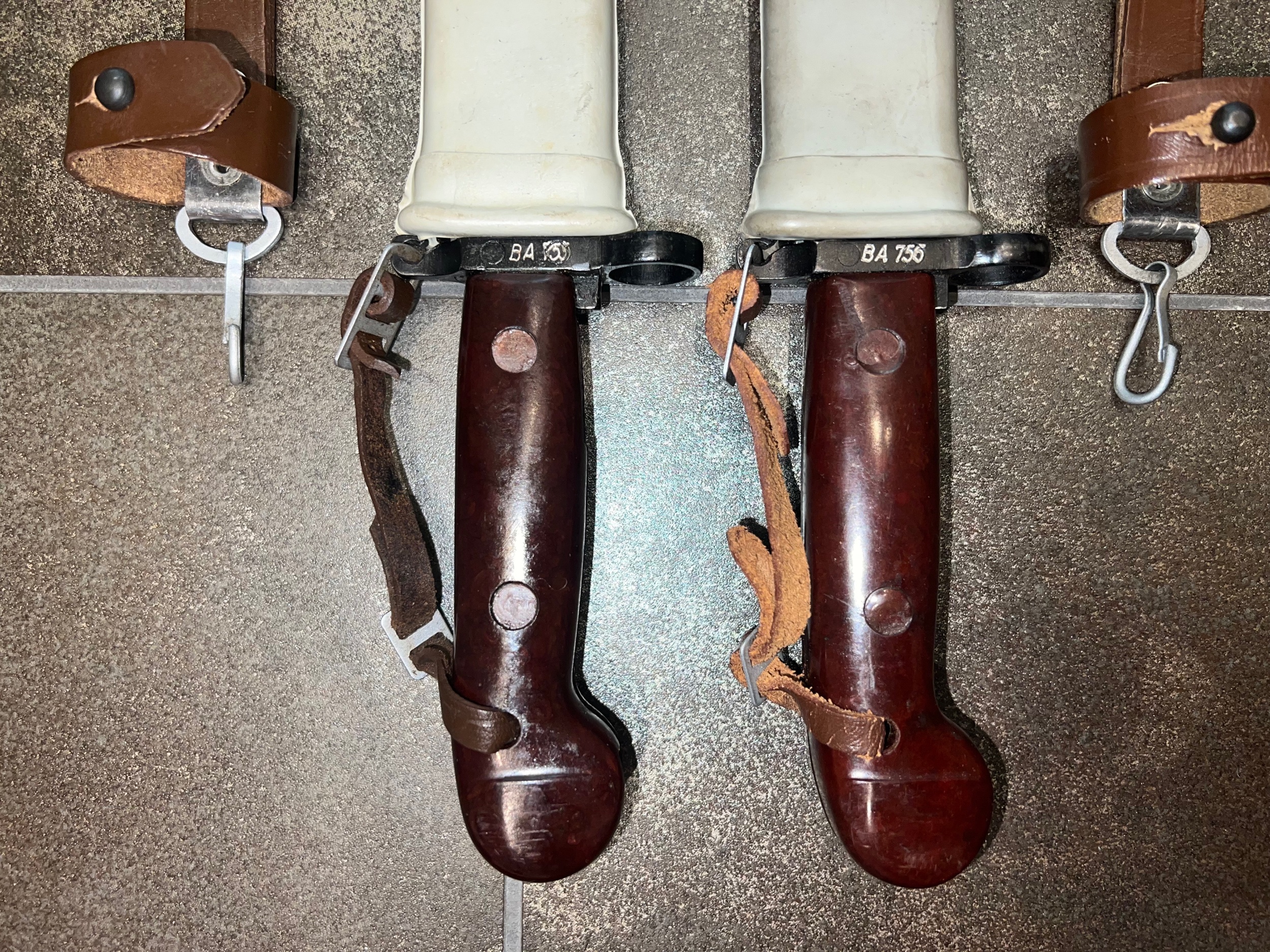

Adding to this topic my two examples. They would then be a 1965 production. They appear quite unused with single piece leather hangers.
Postby Mr. B. » Mon Oct 17, 2022 7:58 pm
Super nice! Original and like NEW with consecutive numbers! Very nice find. For me these two set the standards for the flat pommel bayonets. Also note that the BA series is unique as all the ones confirmed have only three numbers. Probably a little more scarce that the others?
