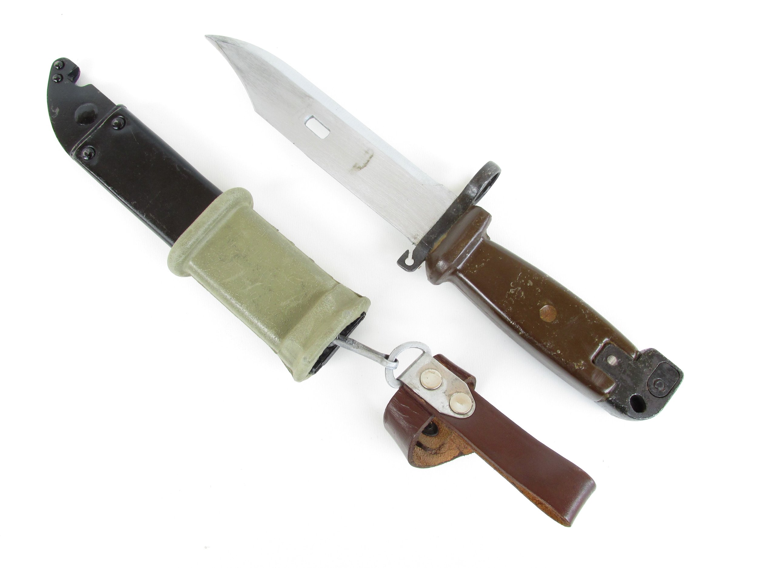

One of our new members, Marco, recently posted pictures of an Egyptian AKM 6X4 Type II bayonet with a Type I scabbard. It was originally posted under "General Discussion - AK Bayonet Discussion - My Bests". It appears to be a very interesting and unusual variation as it is without saw teeth. I have taken the liberty of adding it here so that it can be discussed and compared to other Egyptian bayonets. Mike

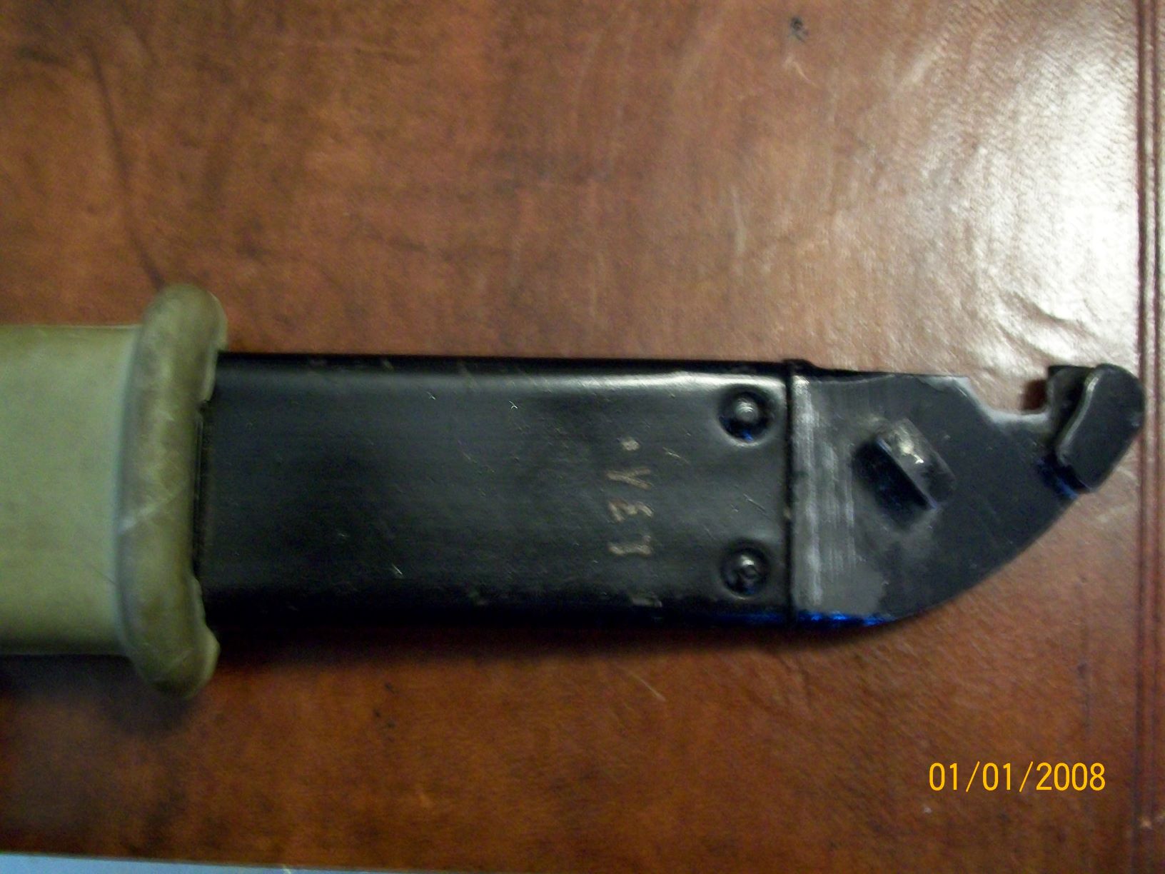

"Two pictures of a maadi with a white rubber and no sawteeth." Marco

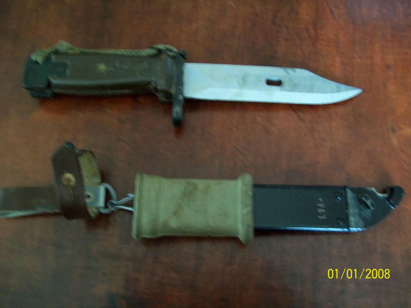

Here are a couple more pictures posted by Marco. Mike
"My Maadi without saw" Marco

I have never seen this variation and find it very interesting. I would like to see more detailed pictures, especially of the Arabic numbers on the bayonet crossguard. They appear to be there, but difficult to read. They do not appear to be matching with the ones on the scabbard. They do however appear to be consistent with the style and placement with other Egyptian bayonets and scabbards. Does anyone else have any knowledge or documentation of this variation? Mike

A very nice example of whatever it is!? Almost too nice to be Egyptian production. The blade is much better made and does appear to be Polish. Same with the crossguard. I believe that the assemble was imported to Egypt from either Poland or another ComBloc country and made cheaper by eliminating the saw teeth. The brown grip appears similar to other later Egyptian production. The molded edges are more rounded and not as crisp as others. Also note the sloppy glue/filler where the grip meets the crossguard, typical Egyptian. The pommel seems a little nicer than most, perhaps early production? But also note that the pommel retaining screw has been crudely sawn or cut off on the left side, again typical. The scabbard also seems to be imported from another country. It has a shorter body and the machined cutter plate not found on the ones made in Egypt. The light-colored rubber insulator may also be imported as it is a cleaner mold than the usual black Egyptian ones. I have also seen these gray/tan insulators on the Egyptian made scabbards. To me they seem like the Romanian ones. Perhaps this is because I have Egyptian bayonets that appear to use Romanian sawteeth blades. Different contours and grinding finishes. Also note that the hanger appears more Romanian than Egyptian. Both in materials and construction.
