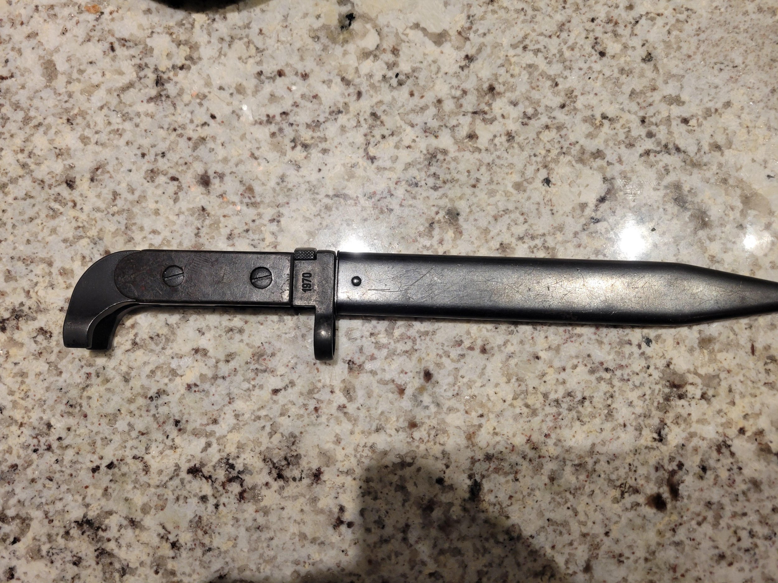

Here is a 1970 I recently received
Here is the gallery of pictures: https://imgur.com/a/UXhyWnn
I can get additional pictures if requested. There is a distinct lack of proof marks on this bayonet compared to the 1958s I have. The stamp on the spine reads "29 - 76"

Hi Dange, Nice find! The Polish AK47 bayonets and scabbards with the 1970 dates are somewhat scarce. This post section is primarily concerning the “P” “A” and “Z” production / serial numbers. If you are interested in more info and pictures of 1970’s go down to and click on “ Poland” on the home page. Scroll down and click on to the heading “Polish AK47 Bayonet & Scabbard Variations”. Scroll and Enjoy!
By the way, one of our members in Germany has a Polish 1970 with the numbers 71-76 on the blade hilt. See below. Regards, Mike
