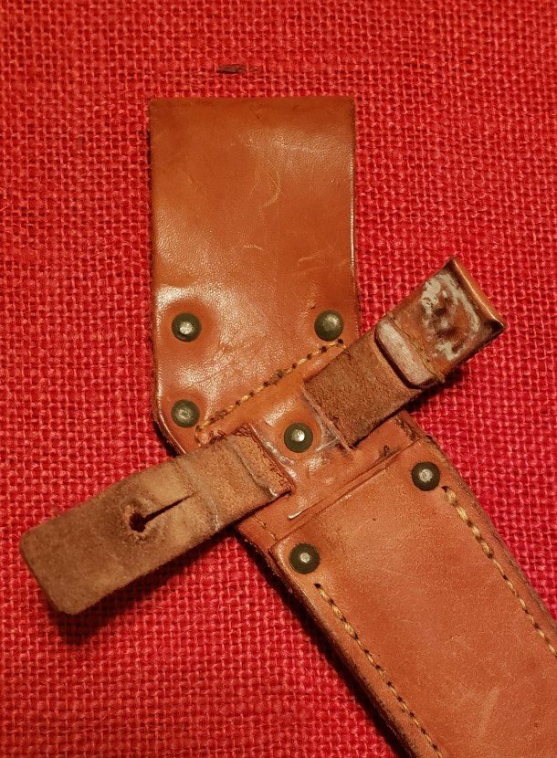

Here are pictures of the 5 rivet Czech VZ58 scabbard. Mike

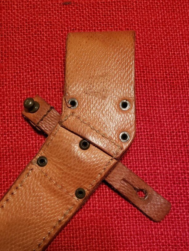

Re: Czech VZ58 Leather Scabbards Variations

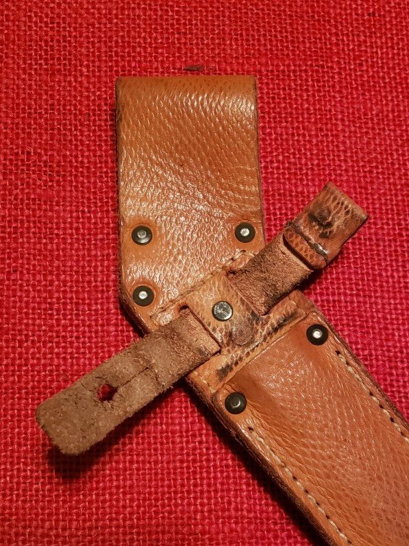

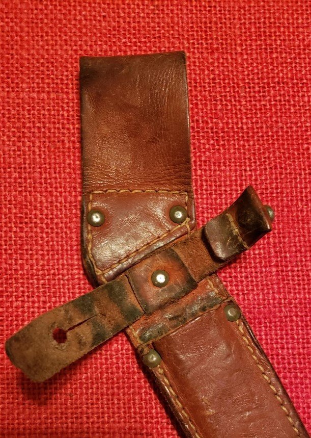

Here are pictures of the 6 rivet Czech VZ58 scabbards. The first one has the early embossed/textured finish. The second one has the standard smooth finish. Mike

PLEASE NOTE; The Czech VZ58 scabbards are not matched or numbered to with any particular bayonet. They are issued at random whether with new bayonets or as replacements over the years. The scabbards are less durable than the bayonets and require frequent replacement during inspections, reissue, repair or rework. The scabbards and bayonets can not be used to identify Types or dates of each other.
If anyone is interested I have more detailed information and pictures of the Czech VZ58 leather scabbards including construction and markings. The stamped ink markings from each manufacture are unique and located in different places and positions on the back of the scabbards. The also changed with different contract requirements over the years. There are many variables, but most contain the crossed swords and OTK military acceptance marks, the contract date and number, the date of manufacture and the ID of the maker. Unfortunately, most of the markings are worn off or un-readable. Mike

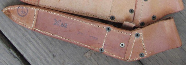

Here is a picture of a VZ58 scabbard made by Galanta in 1962. Each of the various manufactures had there own way of marking the scabbard, different information in different styles and positions, but all the same basic info. Galanta was the first manufacture and the only one making the 5 rivet variation. Below you can see the GALA 62, (inverted), the Crossed Swords 62, (military acceptance), and the circle on the tip with the final proof marks. Mike

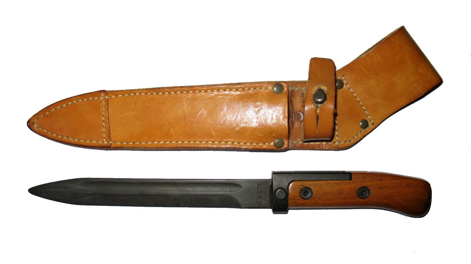

For comparison, this is a 6 rivet VZ58 scabbard made by SNAHA, ("S"), in 1977. The Snaha marking had all the same information in rectangular box on the scabbard tip. Mike

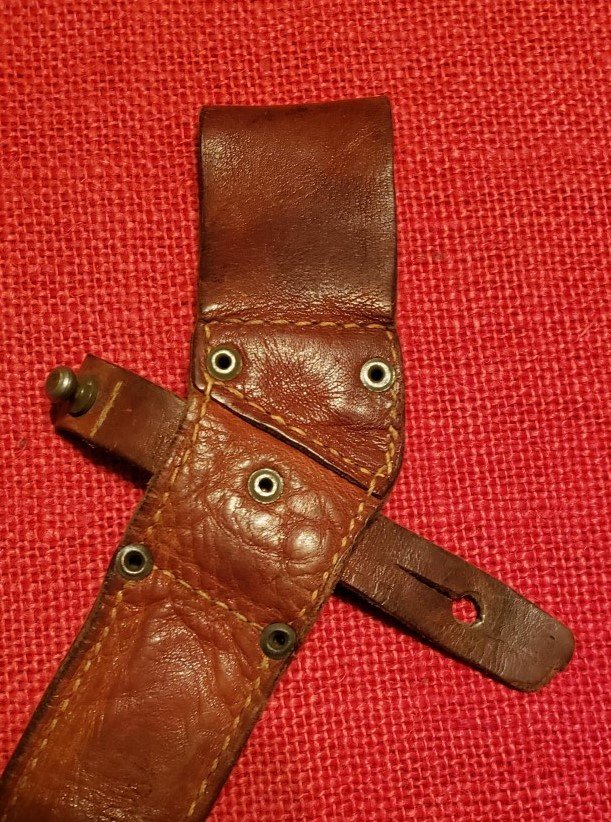

I recently found pictures that I believe confirms the existence of the early 5 rivet LEFT HANDED scabbard made by the original manufacturer Galanta. This scabbard is shown with the correct VZ58 Type I bayonet. The second picture shows the comparison with the Left hand version on top and the more common Right hand version below.
