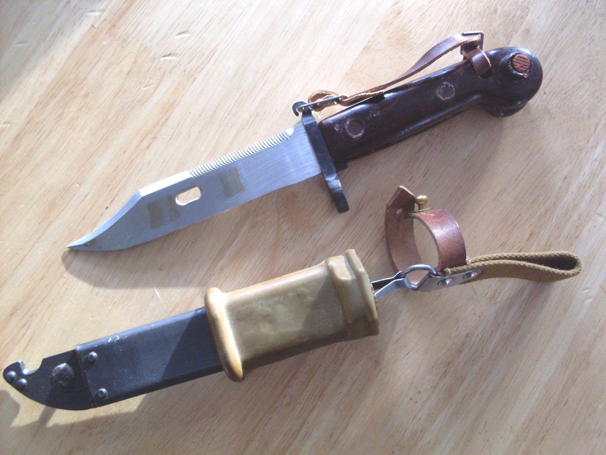

Have a look to this AK first model bayo - I bought it in KABUL flea market approx 10 years ago for 20 bucks and I´ve always thought that it is a russian one.
Now, familiarising myself with this perfecto forum I have some doubts - is it really russian or, for example, romanian or something else?
It has no more markings besides that matching serial and literas "TO" in this serial a both good for latin and kirillitsa..

it's not an AK first model but AKM first model, not the same rifle and not the same way to fit on ;)
Classic romanian AKM type I with russian leather/web hanger

This is a Romanian AKM 6X3 Type I bayonet and scabbard. The "TO" serial number indicates it was manufactured/issued in 1966. It was most probably issued/numbered to a Romanian PM model 63 or 63/65 AKM rifle. The Romanians matched their bayonets to a rifle and used the prefix letter code and the last 4 digits of the rifle serial number. The rifles also had the year of production which enables us to know when the bayonets were made/ issued as well.
The rubber insulator and the wrist strap also appear to be original Romanian. The belt hanger is a replacement and is the type usually found on reworked Russian AKM 6X3 bayonets. These canvas and leather hangers were made up to replace the original all leather hangers. This particular hanger has the round wire "D" ring verses the flattened stamped "D" ring on the earlier versions. Also the hilt loop strap has a brass fastening stud rather than the original blacken steel stud found on the original ones. All that, plus the new unused condition indicates this is possibly a reproduction and a more recent replacement. BTW: The "TO" is English(?), not Latin or Cyrillic. Mike

Mike, I've had a hanger with a canvas belt loop for years. Came off a used Russian 6H3 that I pulled out of a bin Northridge had of them. It has the flattened D-Ring but the thorn is brass.
Re: Wazzit?
You are right Martin. I made a premature assumption about the Russian fabric and leather belt hangers. I based it on the ones I have. The first one with the flat ring, I acquired like you did. Attached to a reworked 6X3 from a large lot of bayonets years ago. The other one with the round wire "D" ring was acquired more recently from another shipment of reworked mixed 6X3 and 6X4 bayonets from Bulgaria.
Prompted by your post I spent some time going through my picture collection and references and have come to the conclusion that there is very little consistency in the materials or assembly of the fabric and leather hangers. Evidently the standards for these hangers involved only overall and key dimensions plus functionality. Most probably fabricated by different people at different times and places to meet orders as required to provide replacements for the original issued hangers.

Thanks for answers about my AKM 1.model that I was thinking it´s russian but this bloody bastard appears to be romanian instead :evil:

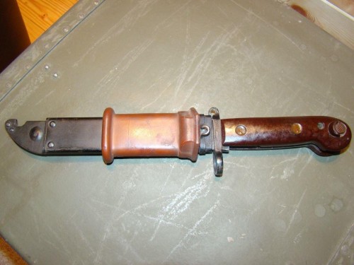

Two more pics from ebay now - are those bayonets russian made or not :?:
