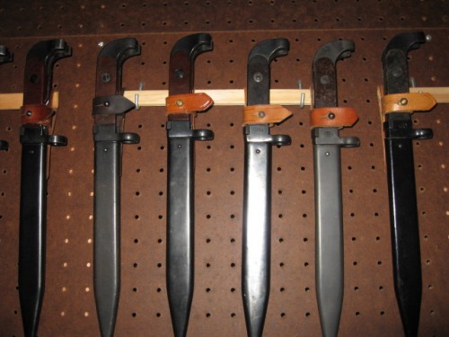

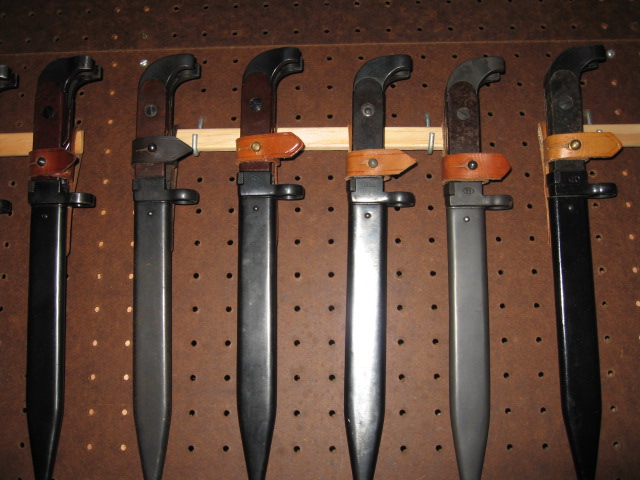

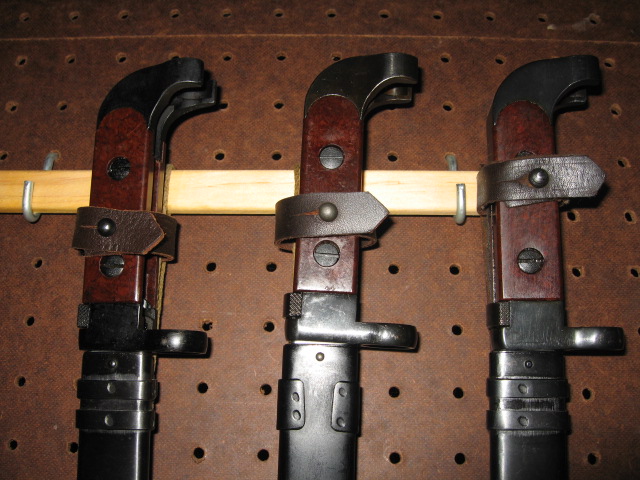

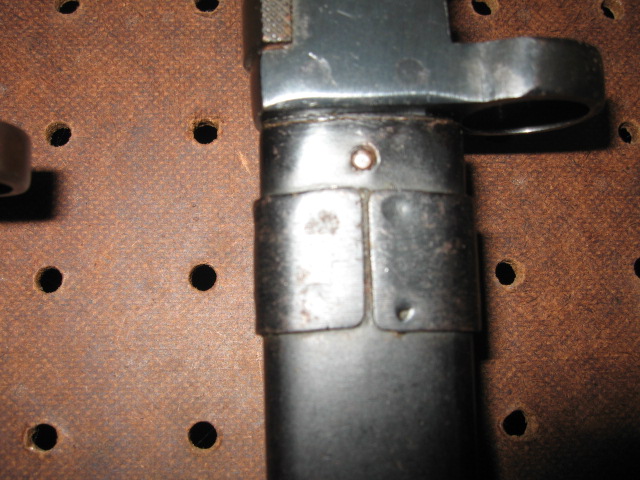

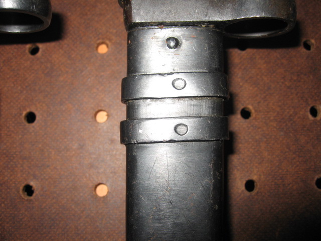

Quick visual identification for me starts with the scabbard as the bayonets are so much the same. Look for the different scabbard front attachment bands. Single split band, (Russia, Finland, Bulgaria, Romania, DDR, N. Korea, China). Double band, (Russia, Finland, Bulgaria, Romania). No bands, (Poland). These are just general rules as there are always accidental, intentional and rework interchanges to be found. Mike
Re: AK47 Bayonet identification

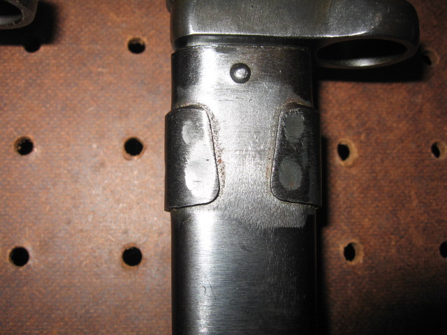

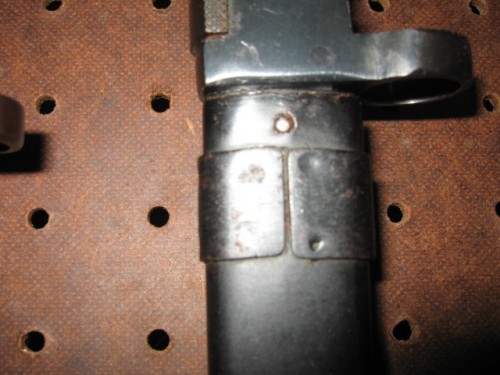

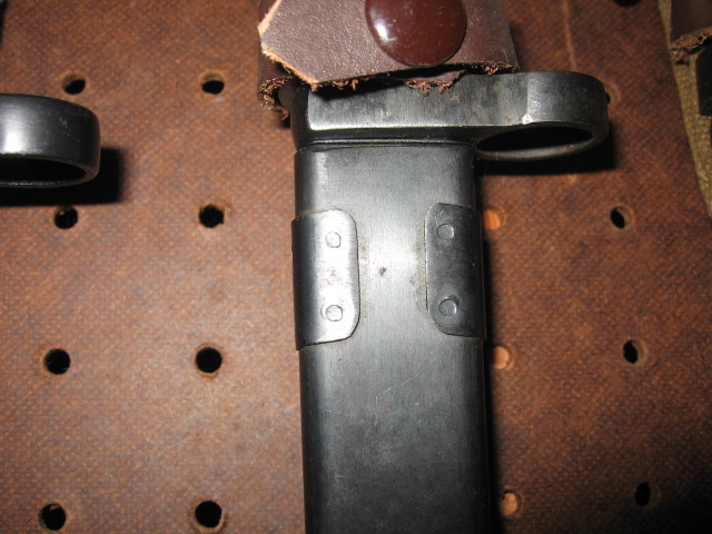

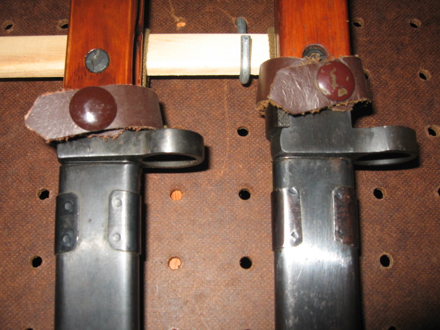

Scabbard hanger bars / brackets (front view) are usually different shapes and are secured to the scabbard by spot or contact welds. Below are single split hangers: 1st is Russian, Finland, Bulgarian, Romanian style. 2nd is smaller Chinese style. 3rd is larger, close together N. Korean style. Mike

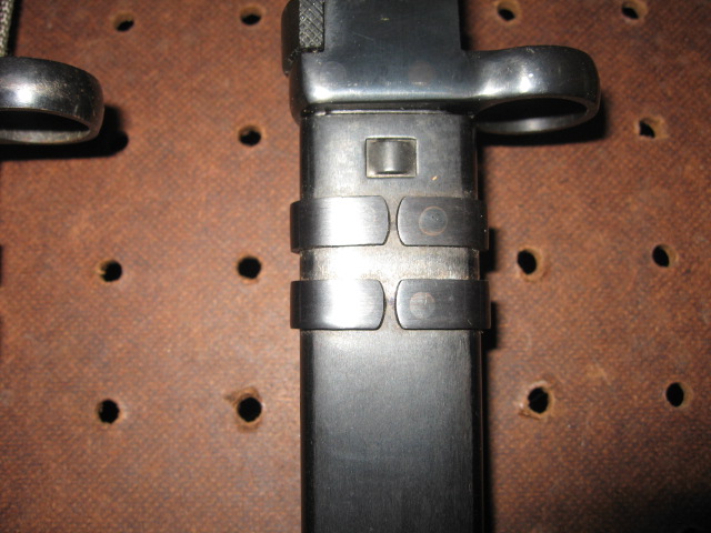

Further AK47 scabbard bar attachment variations: 1st double bar, Russia, Finland, Bulgaria and Romania style. 2nd is split double bar, East Germany, (DDR), only. 3rd is plain / no bar, Poland only. Mike

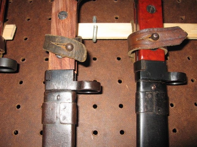

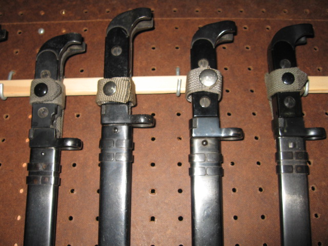

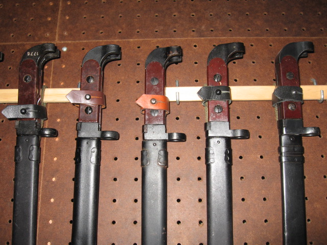

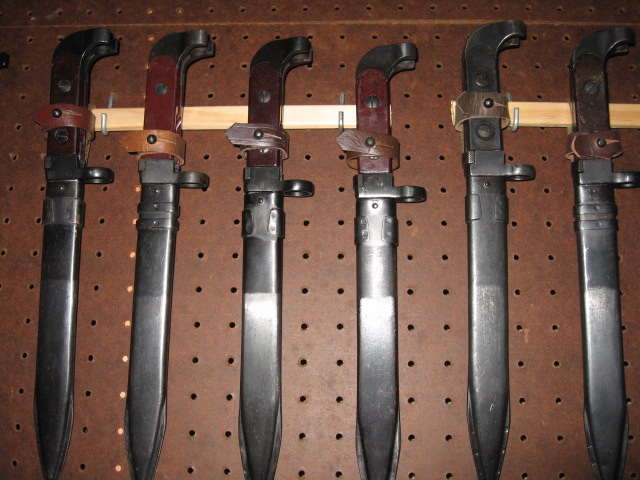

Scabbard hilt retaining strap variations, from the front. Strap orientation. Does the out side strap point right or left. If it points right it could be; 1st Russia, 2nd Finland, 3rd Poland, 4th DDR, 5th N. Korea. Also note the DDR ones have fabric straps with snap fasteners, not studs. Mike

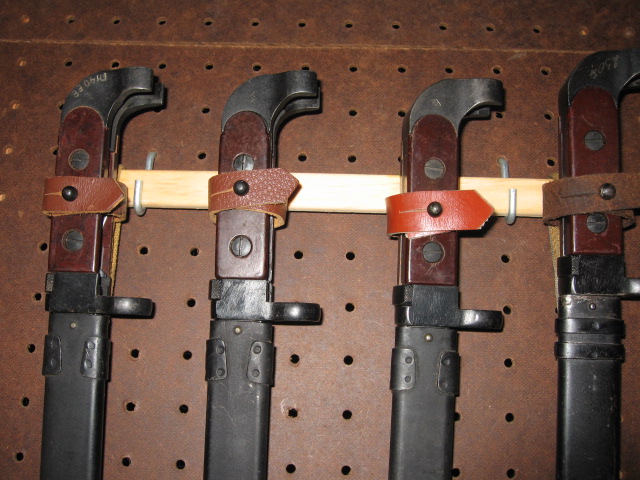

More AK47 hilt strap identification. If the outside strap points left it could be from; 1st and 2nd Bulgaria and Romania, or 3rd China. Also note the Chinese ones have a leather strap with snaps. not studs. Mike

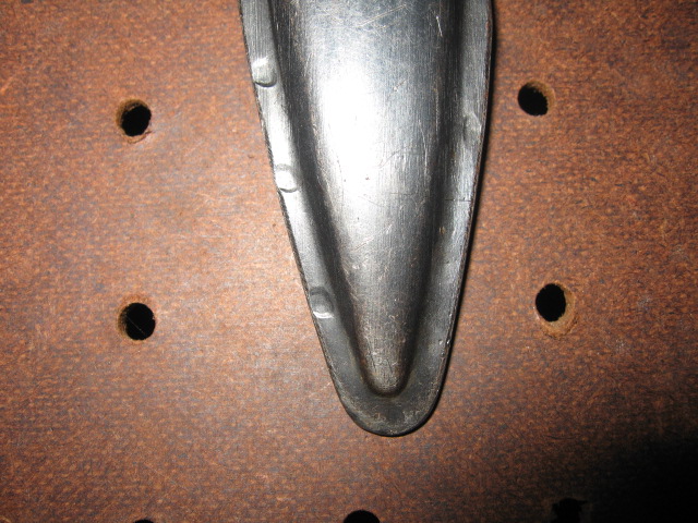

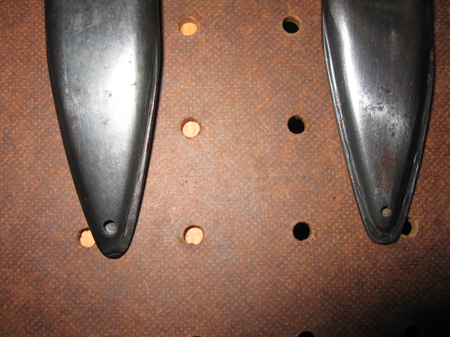

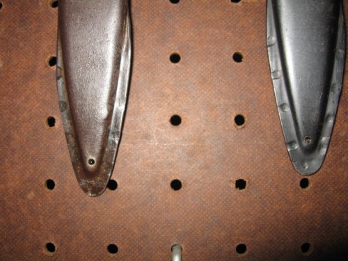

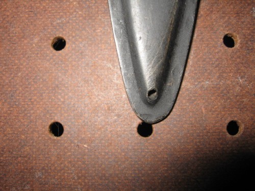

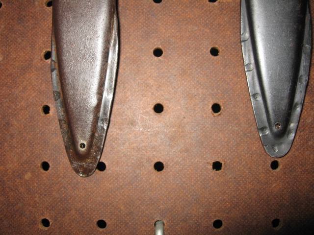

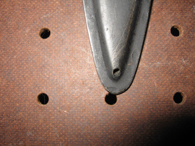

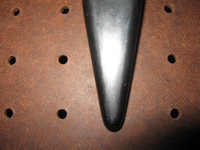

One last scabbard point, (pardon the pun), for today. To identify scabbards, observe the type of point style and the position or lack there of, of a drain hole in the tip of the scabbard. If the drain hole is in the front and it has a large flat flange it is from: 1st Russia, 2nd N. Korea. If it has a small flange and a hole in the front; 3rd China. Large flange and drain hole in back: 4th Bulgaria and Romania. Large flange NO drain hole: 4th Finland and DDR. No flange and no drain hole: 5th Poland. Mike
There are many different finishes on the AK47 bayonets and scabbards. Also many different styles and materials used in the permanently(?) attached hangers. These points are complicated by the amount of interchange, mixing and reworking. One other key method of scabbard is manufacturing the scabbard. The N. Korean scabbard is made from a flat piece of metal rolled and spot welded to form a tube and has a seam down the side. The Polish scabbards are formed by extrusion molding on a mandrel and have no flanges or spot welding. All others are formed by using a flattened seamless tube with pressed, spot welded flanges to form the tip. Mike

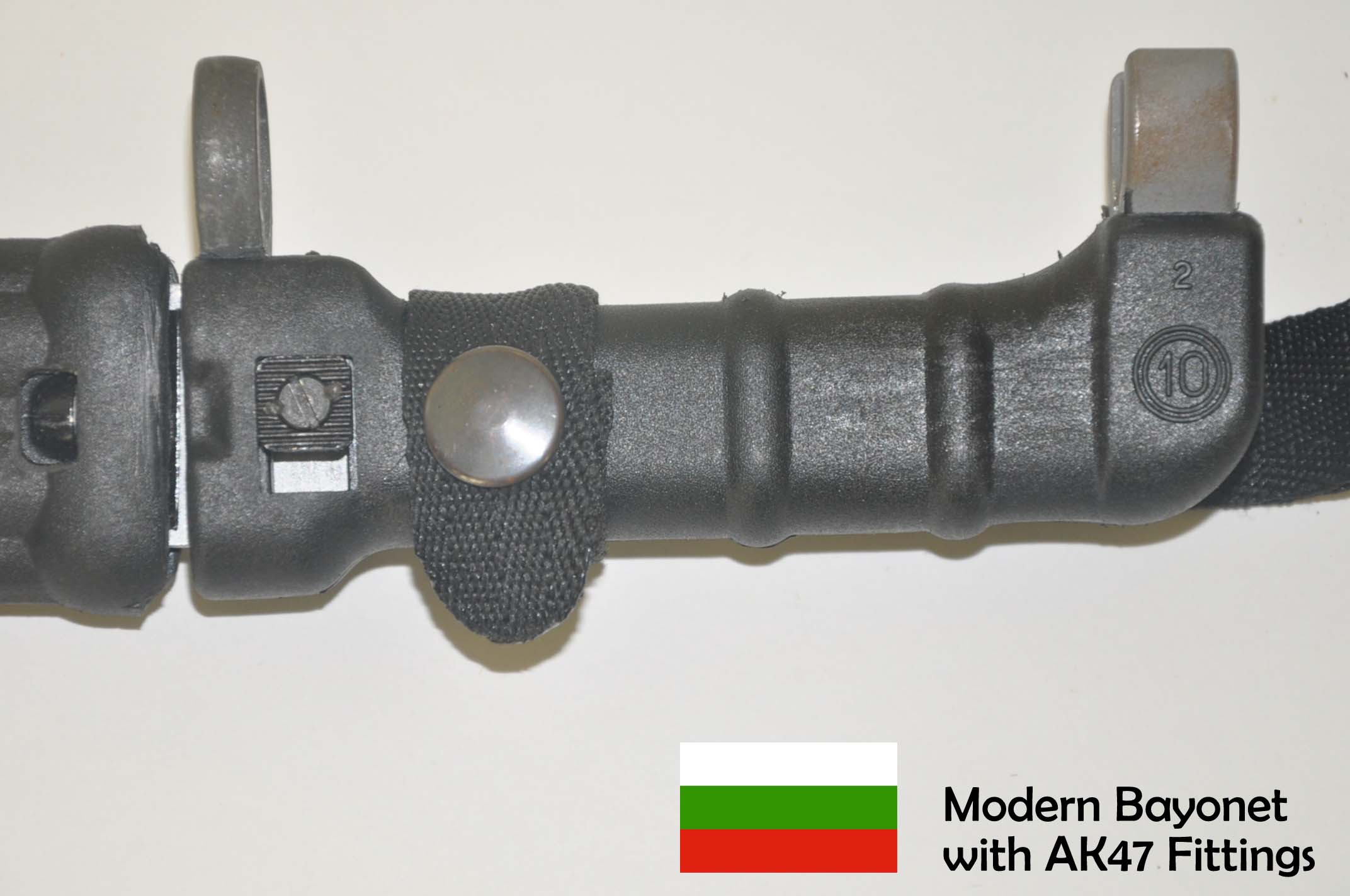

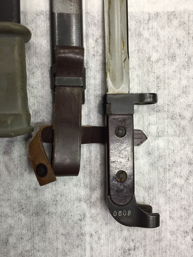

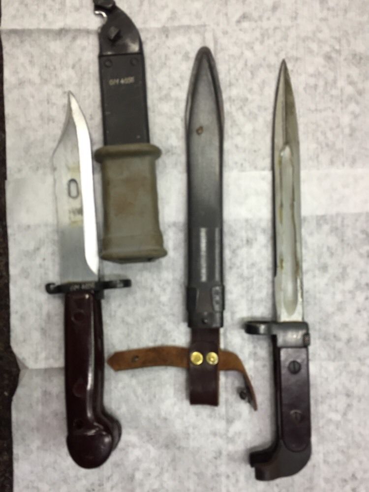

There are also a couple hybrid AK 47 bayonets that I omitted. One is a "transitional" N. Korean bayonet with an AK 47 hilt and attaching method. However it has the blade and scabbard from the newer AKM style bayonet. I do not have one of these so picture is borrowed. The other one is a newly designed and made in Bulgaria bayonet to fit on early AK47 rifles. They have a modified version of the AK47 hilt and the blade and scabbard of a AKM 6X4 type II bayonet. I do have one of these, but for convenience a borrowed picture Mike

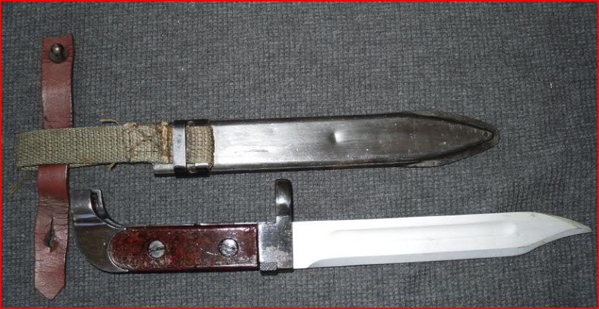

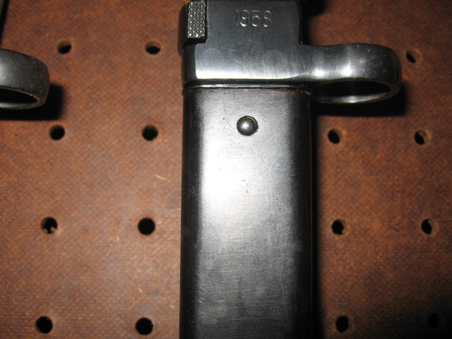

Mike, here is an AK47 bayonet currently on EBAY. By the font, I would categorize it as Romanian per our previous discussions. What do you think?
- Posts: 430
- Has thanked: 24 times
- Been thanked: 12 times
I do hope so....'cos I bought it
Will be a while before it gets to a friend in the USA, and eventually to me, but we will have to wait and see.
