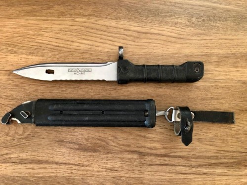

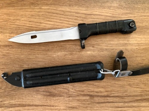

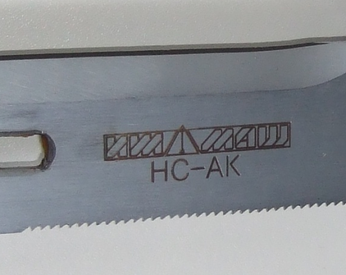

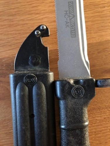

Today i found this bayonet, which is currently offered on an german auction site.
It appears to be an bulgarian circle 10 6H5 bayonet but which has a laser engraved izhmash logo and the letters "NC-AK".
This combination of souvenir markings and bulgarian arsenal markings doesent seem to match up.
Has anyone seen such a bayonet before or has any idea whats it provenance is?
Posts: 1025
Re: (10) 6H5 bayonet with russian souvenir marking
Post by Mr. B. » Mon Mar 23, 2020 10:46 pm

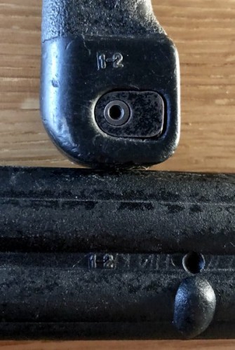

This bayonet and scabbard are not Russian. They both have the Bulgarian double circle 10 molded arsenal marks. Therefor the Russian Izhevsk markings on the blade are definitely fake. Perhaps someone was using this well used bayonet for etching practice? I have never seen one like this before. It is a good example of the type of fakes that are possible. At one time there were good fakes/replicas coming out of China that was an almost exact copy of the souvenir Russian AK74 6X5 bayonet and scabbard complete with a copy of the certification. Mike

Thanks for your response, i also thought this to be a fake.
after looking around a little further, i stumbled upon this german website that seems to sell the same bayonet advertised as made by izhmash for bulgarian Army.
as far as i am able to asses this explanation I find it very unlikely that this would have happend
this is the only picture of the website that shows th bayonets almost identical to that in the original auction.
Posts: 1025
Post by Mr. B. » Tue Mar 24, 2020 6:53 pm
I guess I am too logical and would ask the following questions. Why would the Russian Izhevsk arsenal manufacture bayonets for Bulgaria using Bulgarian arsenal molds? Wouldn't they just use Izhevsk molds? Or provide them bayonets from existing stocks or new production? Why would they bother with the time and expense to engrave the blade with presentation/souvenir markings? Why would the Russians place their logo on the blade of a Bulgarian bayonet? Why would the Bulgarians issue these bayonets for use? The last picture above has the typical Bulgarian issue numbers on the scabbard.
I would personally question the seller or dealers descriptions/explanations and would be hesitant to believe anything they represent. Whether they are just misinformed or intentionally misrepresenting items is questionable.
To me this is an obvious fake and is just wrong in many ways. Mike

6h5 bulgarian fake marked HC-AK are a mystery for me, what is the interest on doing that, bulgy 6h5 were cheaper and more common to their russian cousins for fure.
But russian commercial "civilian" markings on a bulgarian bayonet...

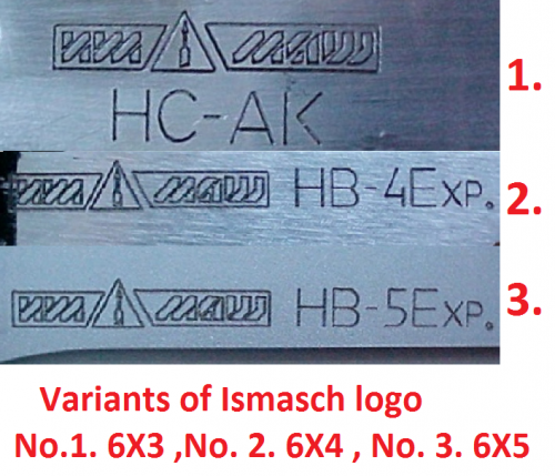

these variants were exported as "HC" collector's knife and "HB" survival knife from Ischmasch only with electronically branded Ischmasch logo !!!
Laser engraved ischmsch logo are fakes.
By annealing the blade, AK bayonets from "CPT" Gost R certification were released for export by other dealers.

diese Varianten wurden als "HC" Sammlermesser und "HB" Survivalmesser von Ischmasch exportiert nur mit elektronisch eingebrannten Ischmasch logo !!!
Mit Laser gravierten ischmsch logo sind fälschungen .

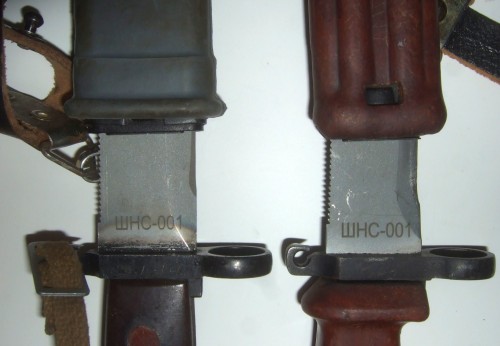

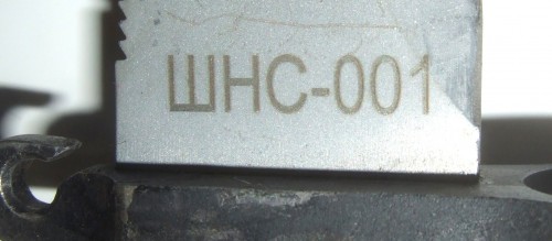

1.2Rus.6X4 Logos im Vergleich  Fälschung und Original of Ismasch logo - Kopie.png
Posts: 84
Post by mill_speer » Tue May 19, 2020 3:36 am

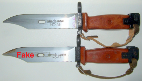

Bulgarian 6X5 AK bayonets with the Ischmasch logo are fraudulent.
Bulgarische 6X5 AK Bajonette mit Ischmasch Logo sind Betrug.

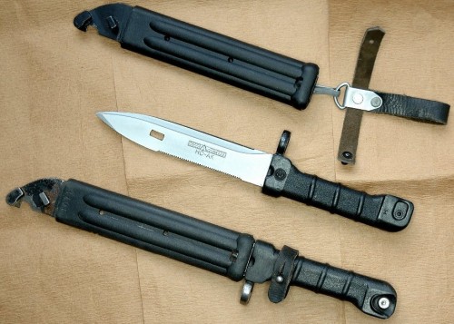

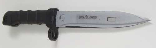

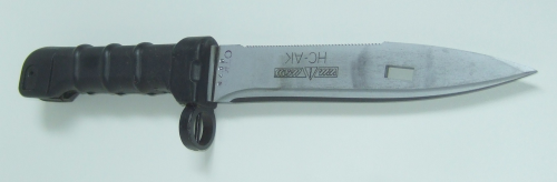

Original collector variants with laser engraving
Weitere original Sammler Varianten mit Lasergravur
Best Regards.
G.
